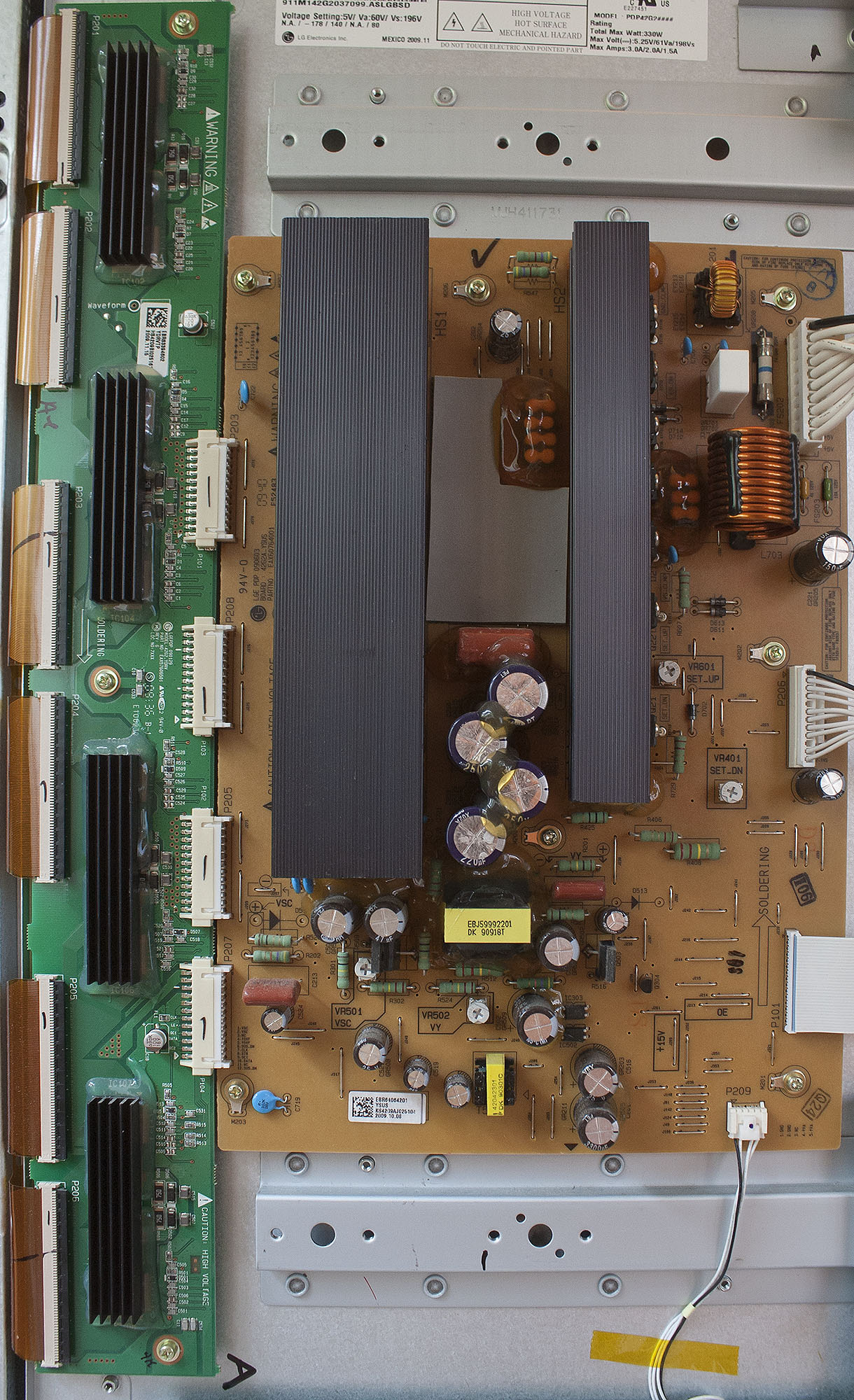

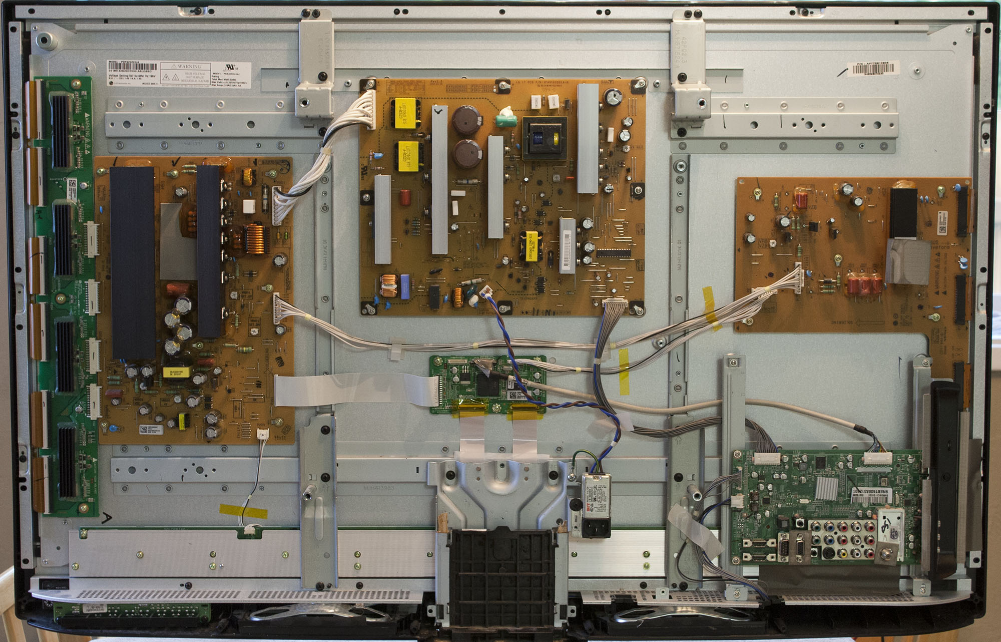

    Picked this one up from the recycle yard yesterday, Pulled the back and there is no visual problems. All found fuses tested good on power supply, ysus, buffer and control, powered it up and all supplies are within spec with the possible exception of the -178v as I didnt find the test point for it yet. And yet I get no panel prime. Per the training manual I checked the crystal on the control and Im getting 24.8 khz which Im assuming is within spec for a 25khz crystal. I can hear relays click on the main when changing inputs.

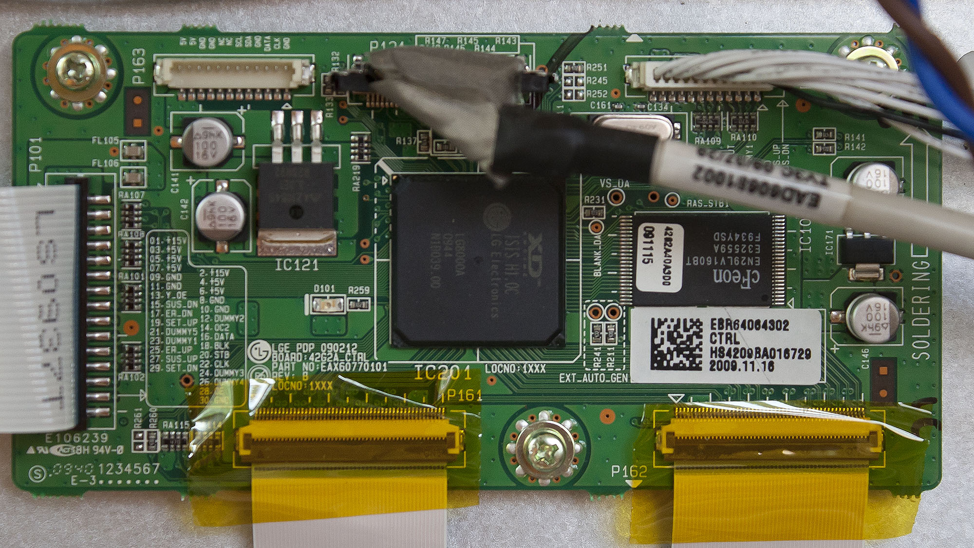

    The only thing I can see thats out of place is there is no light from the diode on the control so at this point Im thinking the control board isnt working properly. But I was wondering if anyone had any other ideas before I order another control (btw the two regs on the control were outputting 3v3 and 1v8)

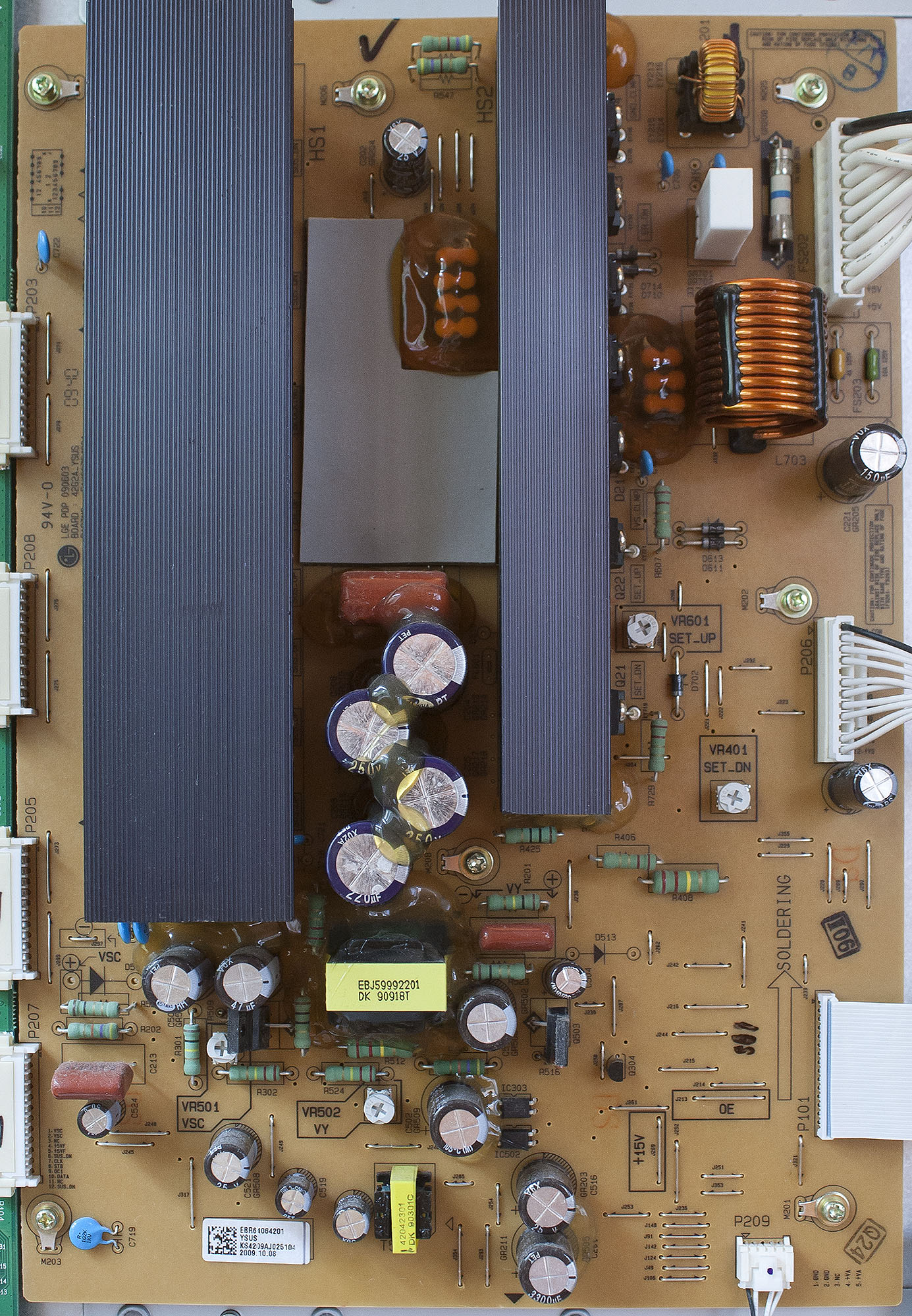

    Measure VSC and -VY across the points on the Y-sustain board, confirm if they meet the sticker ratings.
    If the xtal is oscillating, and power supplies are there, it seems unlikely to be a control board issue. Not impossible, but seems unlikely.

      Ok found the vy test point it measures 178.8, vsc is 140.5, it appears all voltages are ok. I guess the next step is to get out the scope and look at waveforms unless you have another idea for me to try?
      On page 121 of the training manual it states that if the led is no blinking on the control board and 5v supply is present replace board ,although the layout of the control in the manual is different than mine is there another way to check the control? Ive removed the lvds from main and shorted auto gen to no effect. I just checked the second reg again and it is 1.2v I typo-ed the 1.8v above
      and it seems that crystal is supposed to be 25mhz, so I tried measuring again and cant seem to get the frequency counter on my meter to pick it up now.

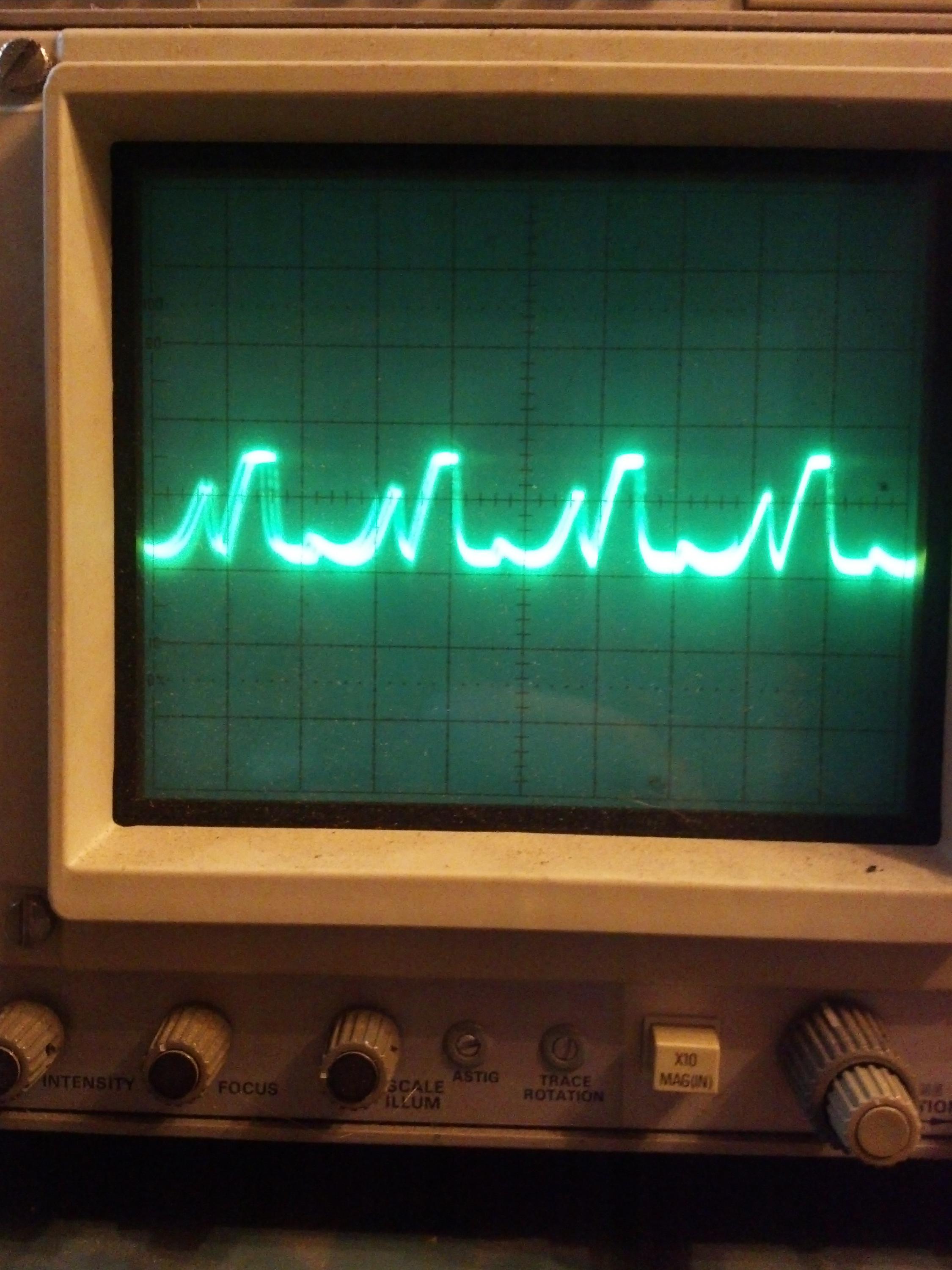

        Yes I would use a scope you can check the VS_UP and similar signals to determine if control board is sending right waveforms. You can also test the output of the Y and Z. You can test the xtal with a scope but you must use a10X probe.

          Ok ysus is outputting waveform to buffers attached pic of waveform, sorry its so blurry trying to hold the probe without slipping and take a picture at the same time. I get no waveform on the zsus test point ( does have 12.5vdc) and am not sure what to probe on the control to verify waveform, there doesn't appear to be any voltage present on the control pin labeled zsuson which Im thinking is supposed to turn on the zsus? as I cant seem to find vs up on the control on which board might I find its test point?

            That's not really what a SUS output should look like, it looks like you have a problem on the Y-main, check the Vsc and -Vy under a scope to see if they pulsate too, and check this with and without the buffers.

                Tested with scope getting less than 1 volt of ac on both vsc and -vy with buffers connected and disconnected, tested the waveform on the buffers again and noticed its only a couple volts. After perusing the training manual some more I found a note that said the y gets its signals from the control board as well- is this not all pointing at the control? what am I missing that you are seeing?

                        I tested the crystal on the control as the training manual said to, In the future I will avoid it.
                        Yes it has sound but appears to be no waveforms being produced by the control board, no Im alive led lit on the control, no shorts found on the ysus or zsus, all voltages appear to be good through each board. We will find out in a few days if the control is responsible, if not it wasn't an expensive board.

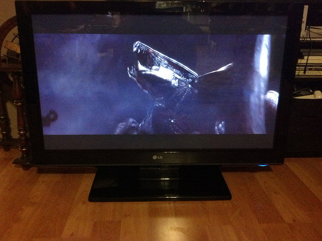

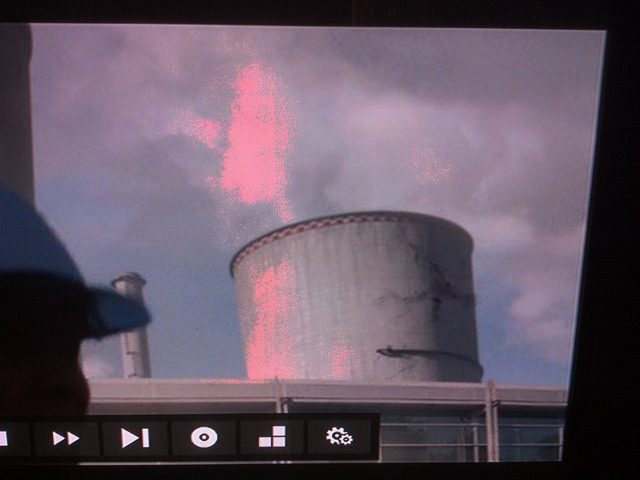

                          My control board came in today and the set is now working. However there is a section of the screen that seems to be prone to red sparklies. Its on the right side of the screen and only is apparent on white portions of the picture. It seems to affect about a 4" wide section the most, will tinkering with the voltages work on this type of fault?
