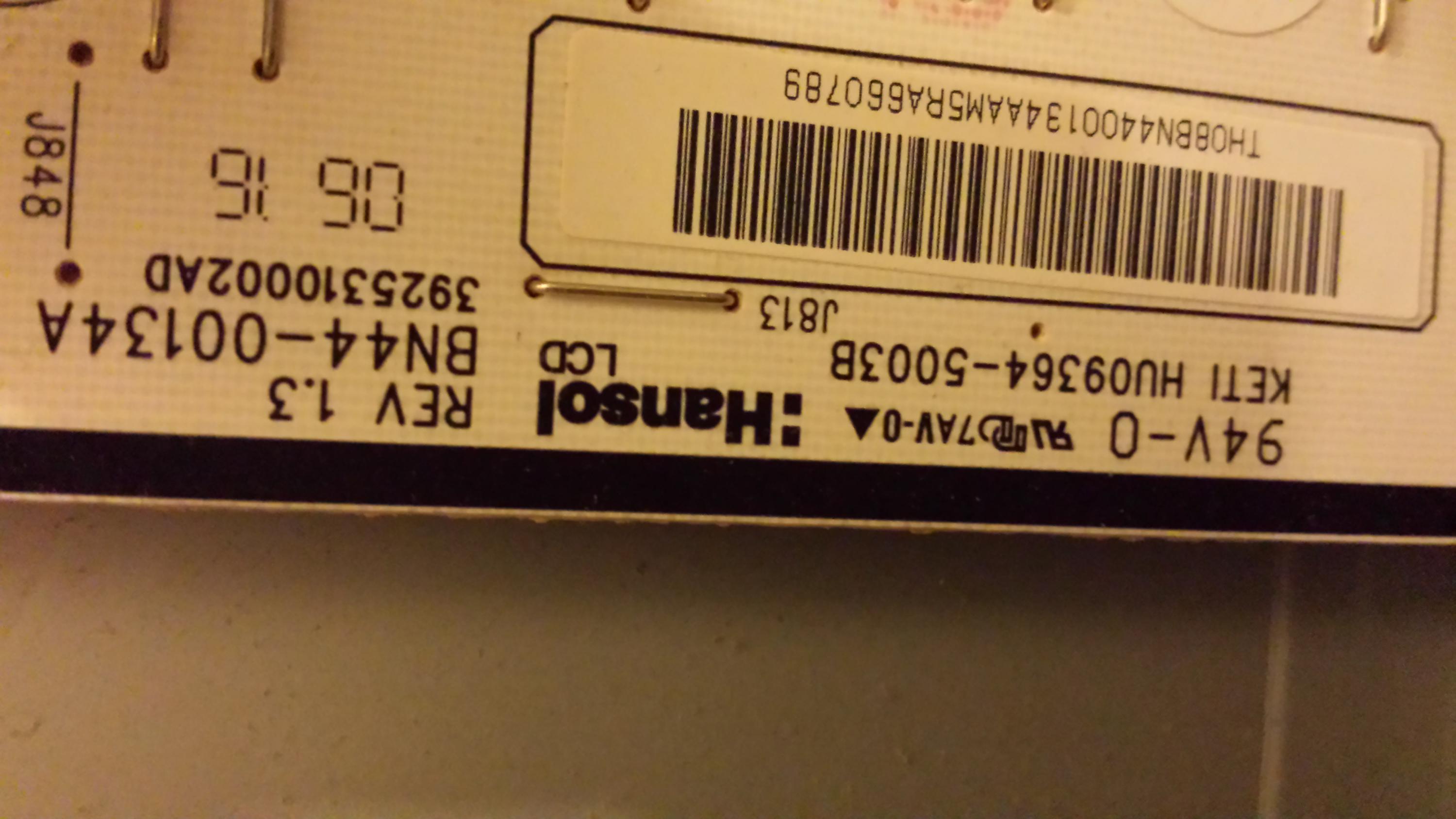

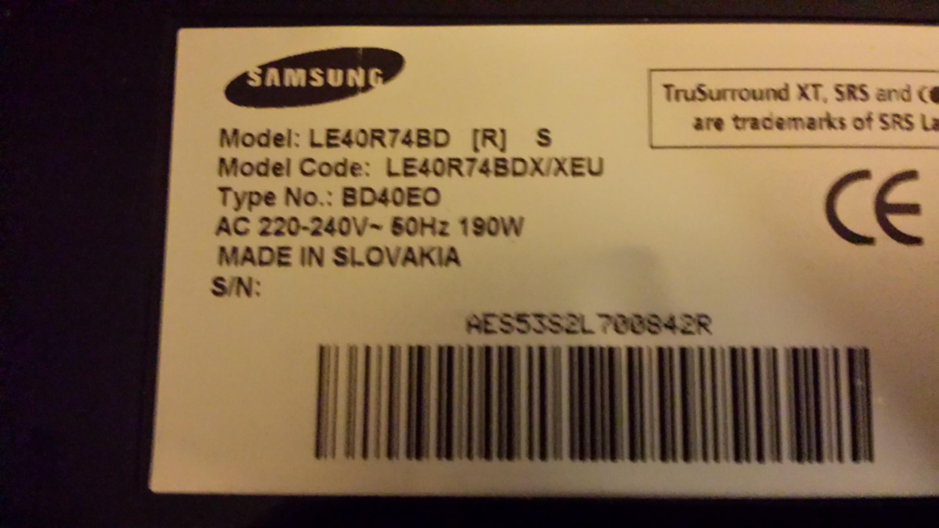

    Hi guys trying to repair a 42 inch Samsung 42" LCD TV. I opened the tv and there was 2 1000uf 16v caps bulging so replaced them. I then plugged tv in with no standby light so checked fuses. Both the fuse in the plug and the fuse on the PSU had blown already. I replaced the fuse in the plug and put a new quick blow 6.3 amp fuse on the PSU. As soon as tv was plugged in the fuse on the psu popped. Was i right to replace with quick blow ?
    Re: problem with 42 inch samsung lcd
    More likely that there is shorted circuits on the board. What is the P/N of the power supply/BN44-XXXXX? Model number of the TV?
      This help ? Thanks
        BN4-00134A, see the diagram attached. Can you read schematic?
