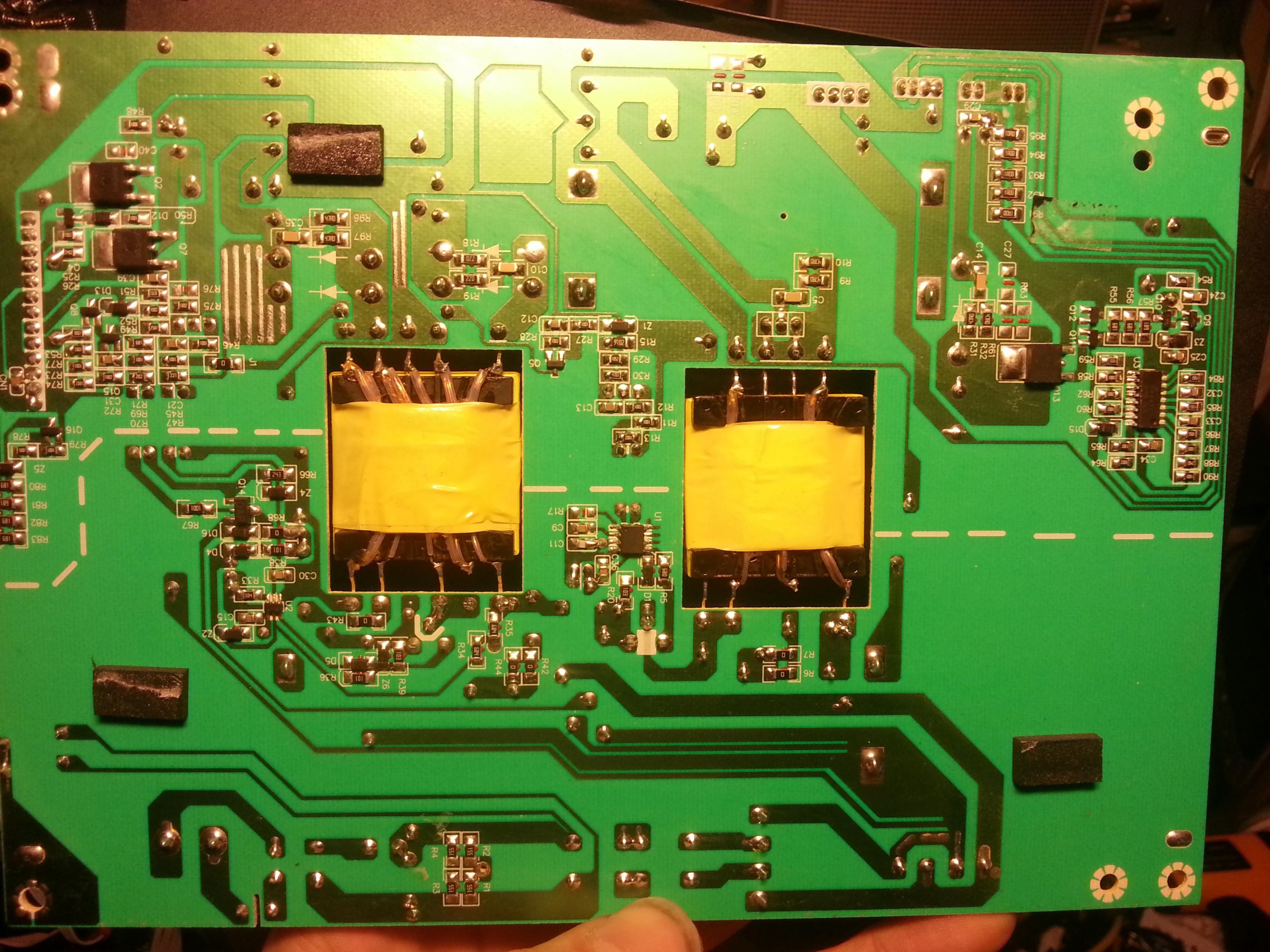

      Here's the back of the board.

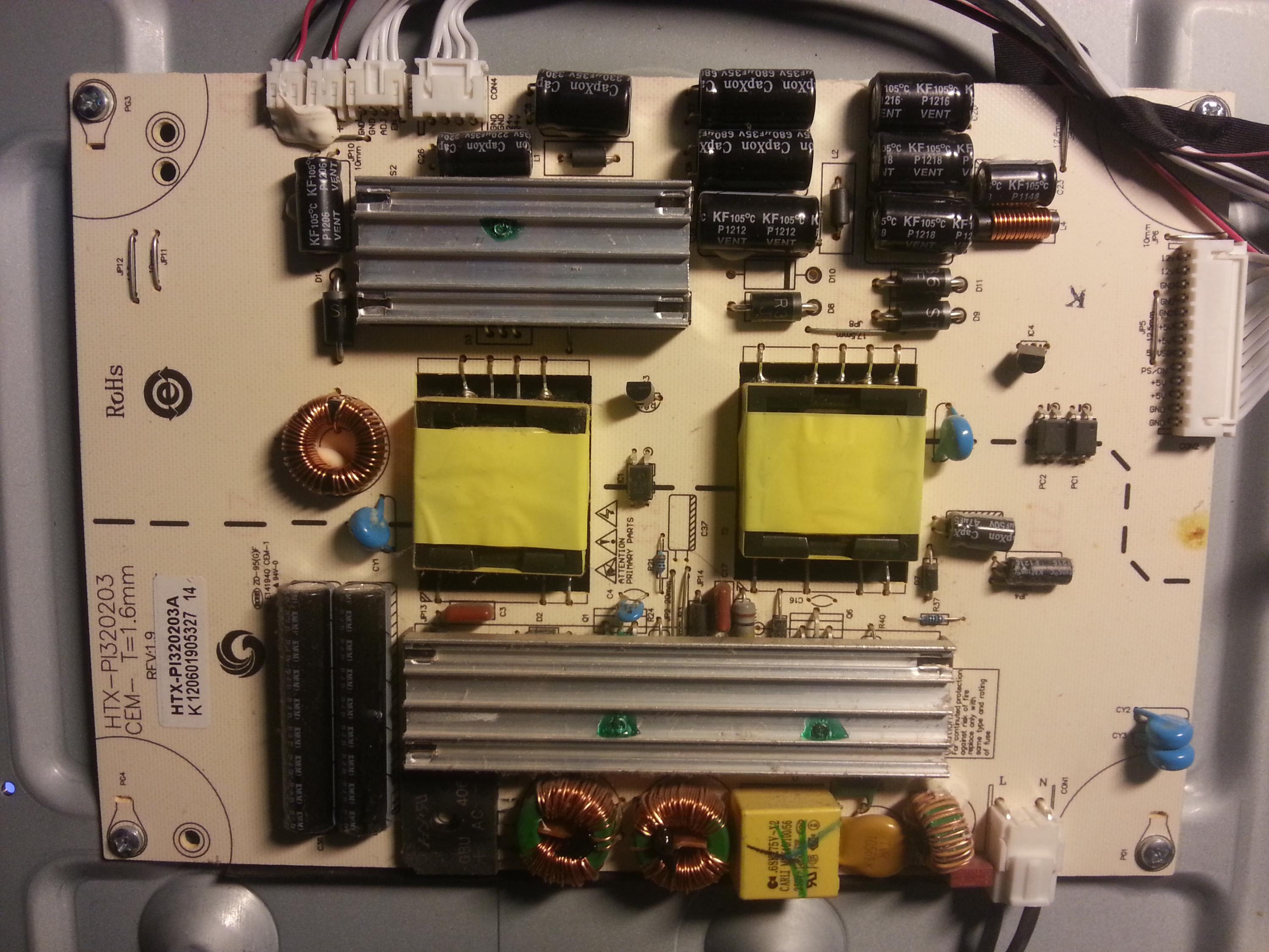

          Seen as the rest of the set powers on fine it sounds like the inverter section on the psu is going bad, looks like the psu has the inverter built on to it take the psu out and get 1000ohm + resistor bridge it to the pson to ground and see if the psu gives the voltages straight away, test it around 10 times.

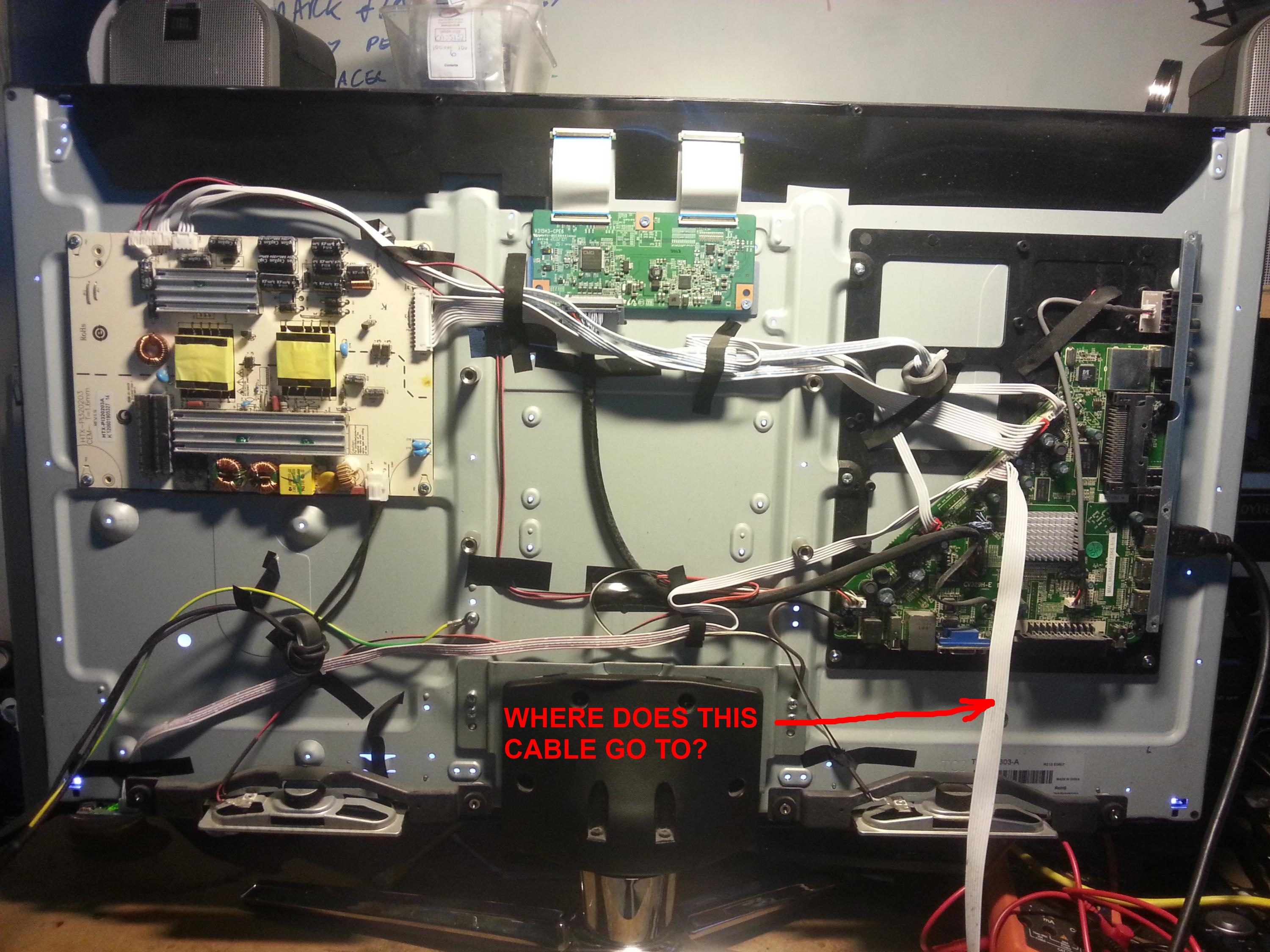

                      Just a quick question where does the wire coming off the psu go, does it go straight to the back light or to an inverter I cant tell from the photo, if it goes to the backlight be very careful as it will have a very high voltage.
                        Re: Bush 32" LED backlight problem.
                        Where does the cable go to in the picture?
                        There should be LED DRIVER circuit/board some where that being fed with 24VDC from the power supply.
                        "PS/ON=4.4v" The PS_ON is present otherwise you will not be getting the 24V. You need to find out if the 24VDC or the BL_ON goes away when the backlights go off. Did you look at the power supply board real close to see if it has any bad solder joints?

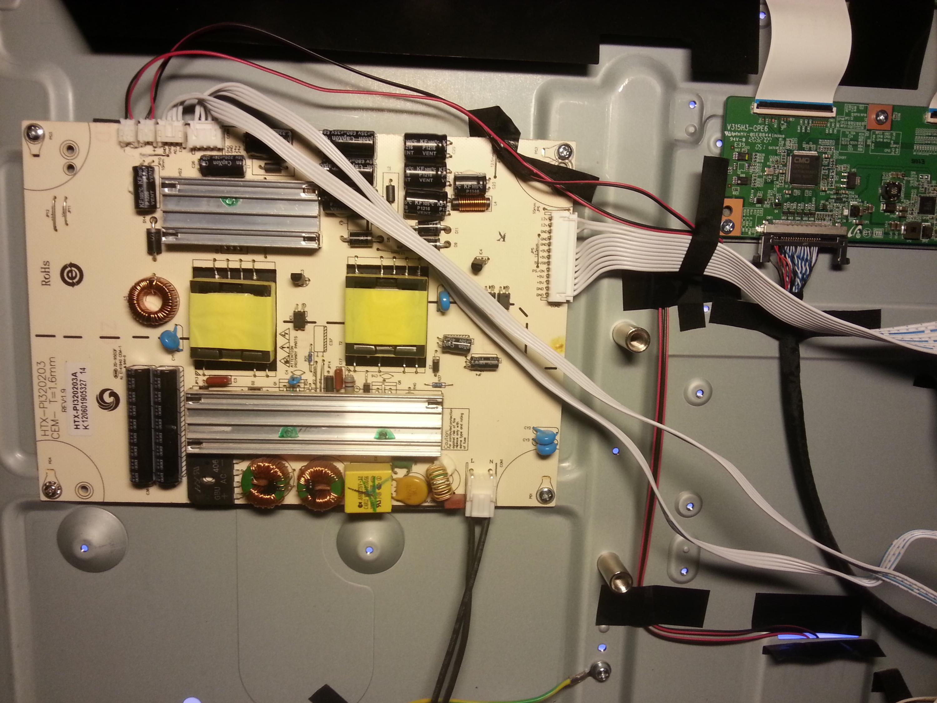

                          Thanks guys, i can't believe i missed it, the wires disappear behind some black tape in the middle of the screen.
                          Here are the measurements from the two connectors.
                          0v, 30.2v | 30.3v, 44.7v power on but back light not powering on.
                          207mv, 19.8v | 19.8v, 38.5v power on, back light working.
                          I've been over the board and resoldered all of the joints. First thing this morning the back lights were not working, but they came on after about 10 minutes. The TV seems to be behaving now it's warm. Turning off then on and the back lights are working.
                          I am going to turn it off and leave it to get cold and come back to this later today.
                          The top heatsink is getting quite warm, i will pull off the cap to the left and measure it first.
