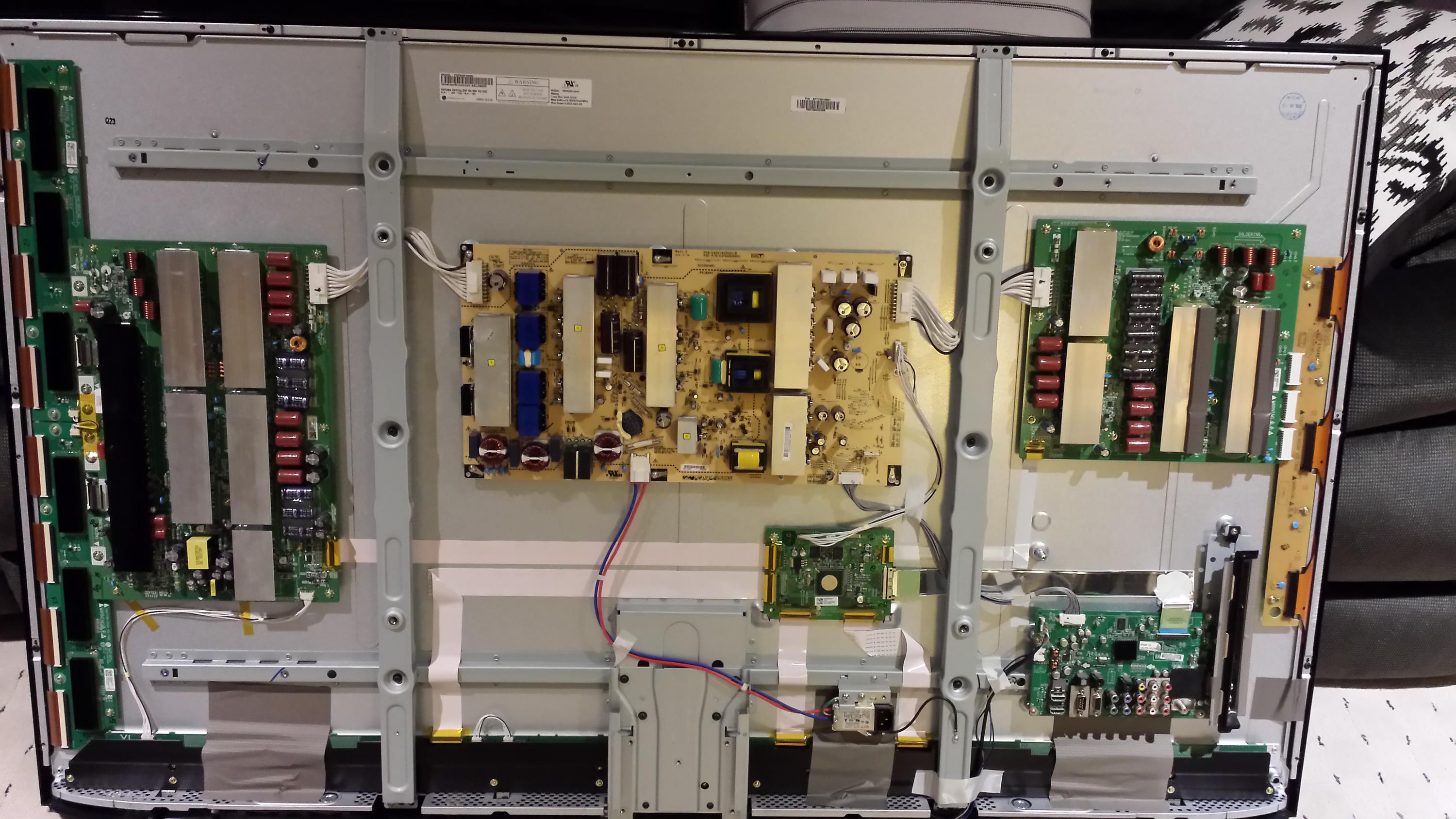

          Can you supply a picture of the TV with the back cover off, and pictures of all visible/easily accessible circuit boards.

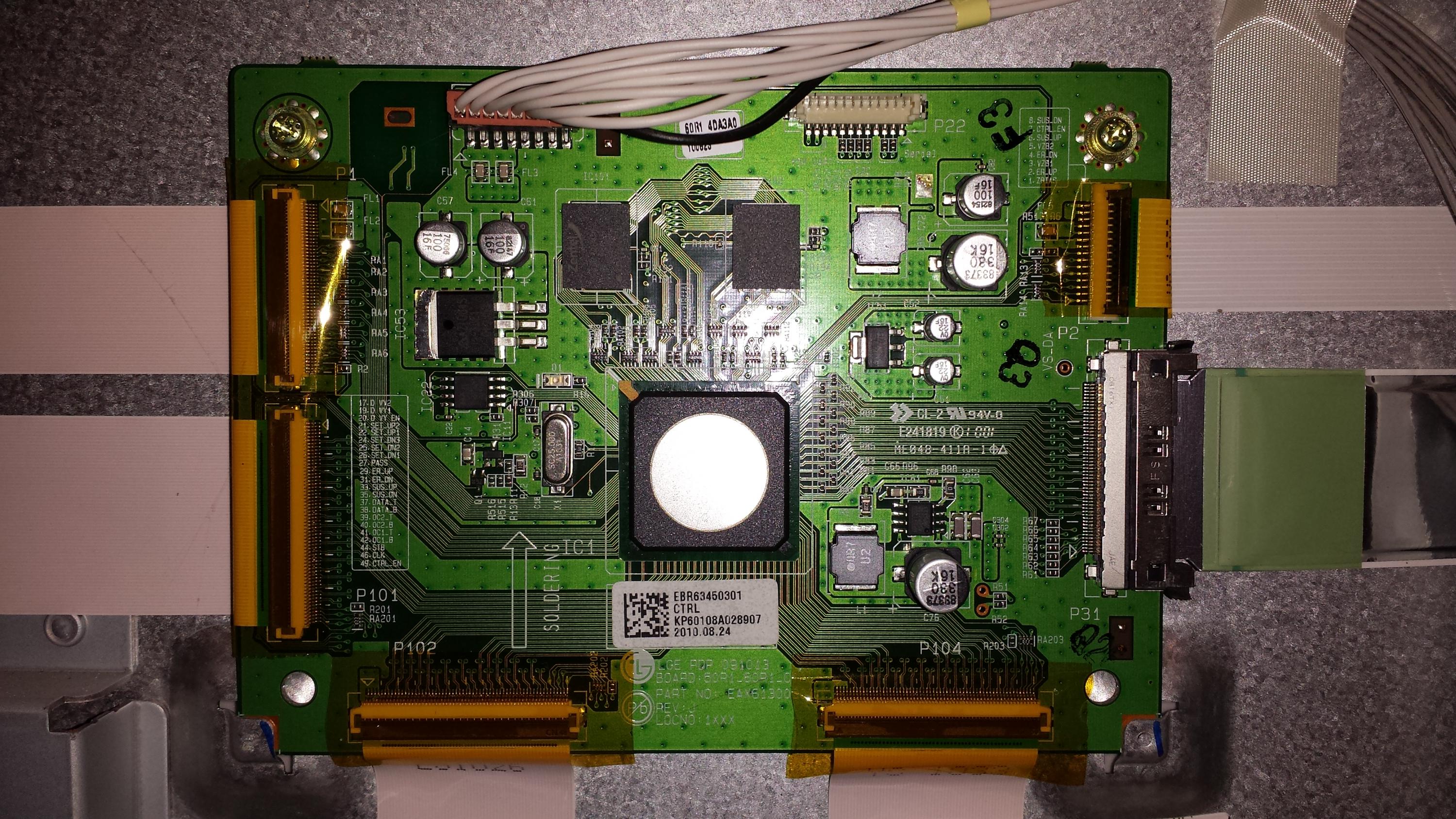

              A small connection point where you can jumper two holes on an internal circuit board, this will engage an automatic test pattern mode. If the mode flickers after some time, it indicates a fault with the Control/Logic PCB. Otherwise, the fault likely lies with the Main AV PCB.

                        Just post the pictures of the boards when you take them, and I will highlight the test point.

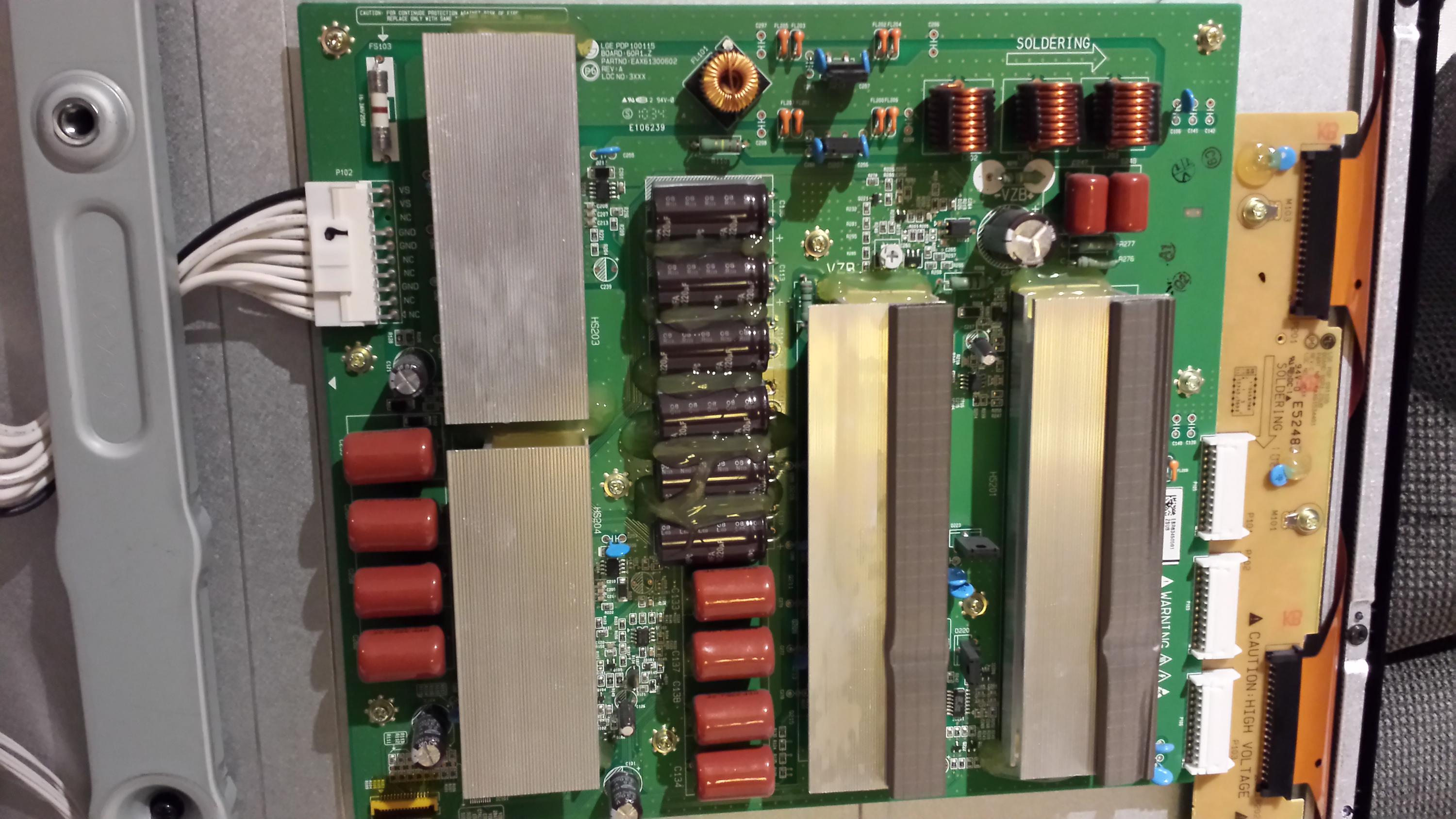

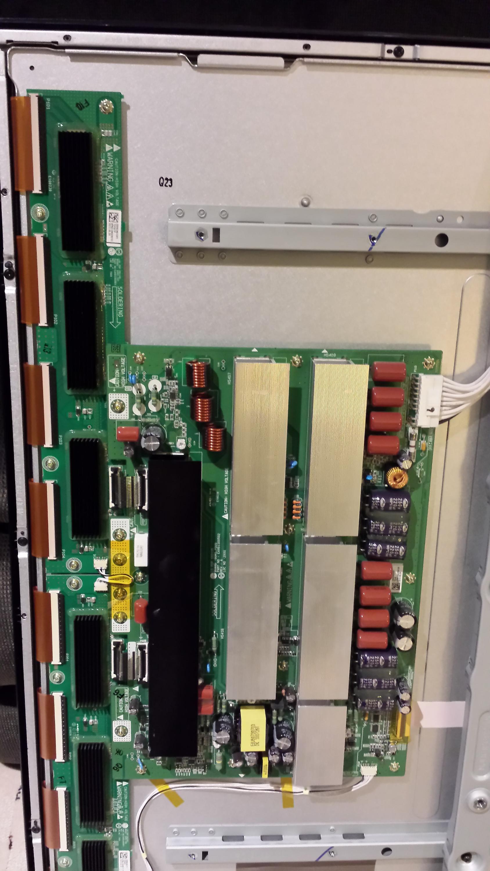

                            So I have the back panel pulled off. There's only 2 boards that appear to have jumpers, which seem to be enabled/disabled by turning them like a screw.
                            Can you tell which jumper it is from these or do I need to take a better picture of one of these boards?

                                Sorry, here is the control board. I'm assuming I need to jump R51/R52 with a wire? Do I need to do anything else like unplug something?
                                  Re: LG Plasma - Thin horizontal line flicker and mirror image
                                  I figured it out and have had the test pattern running for awhile now but did not see the flicker or line. The flashing light on the control board has been green for everything.
