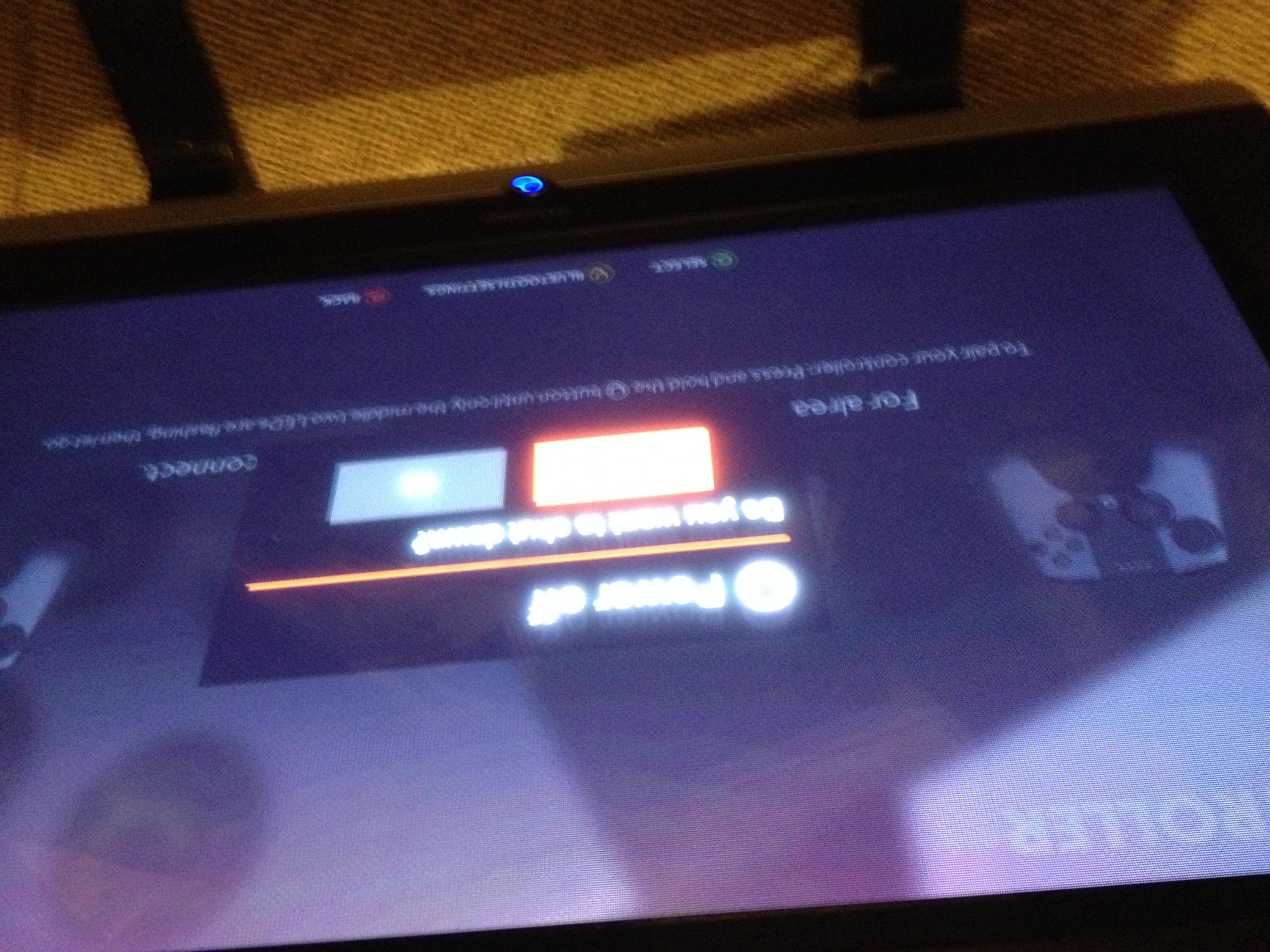

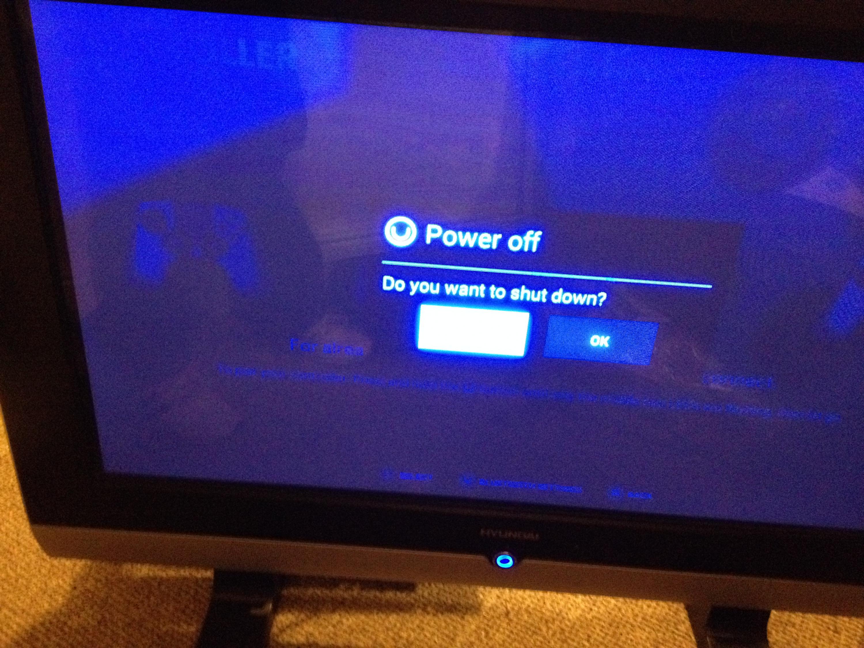

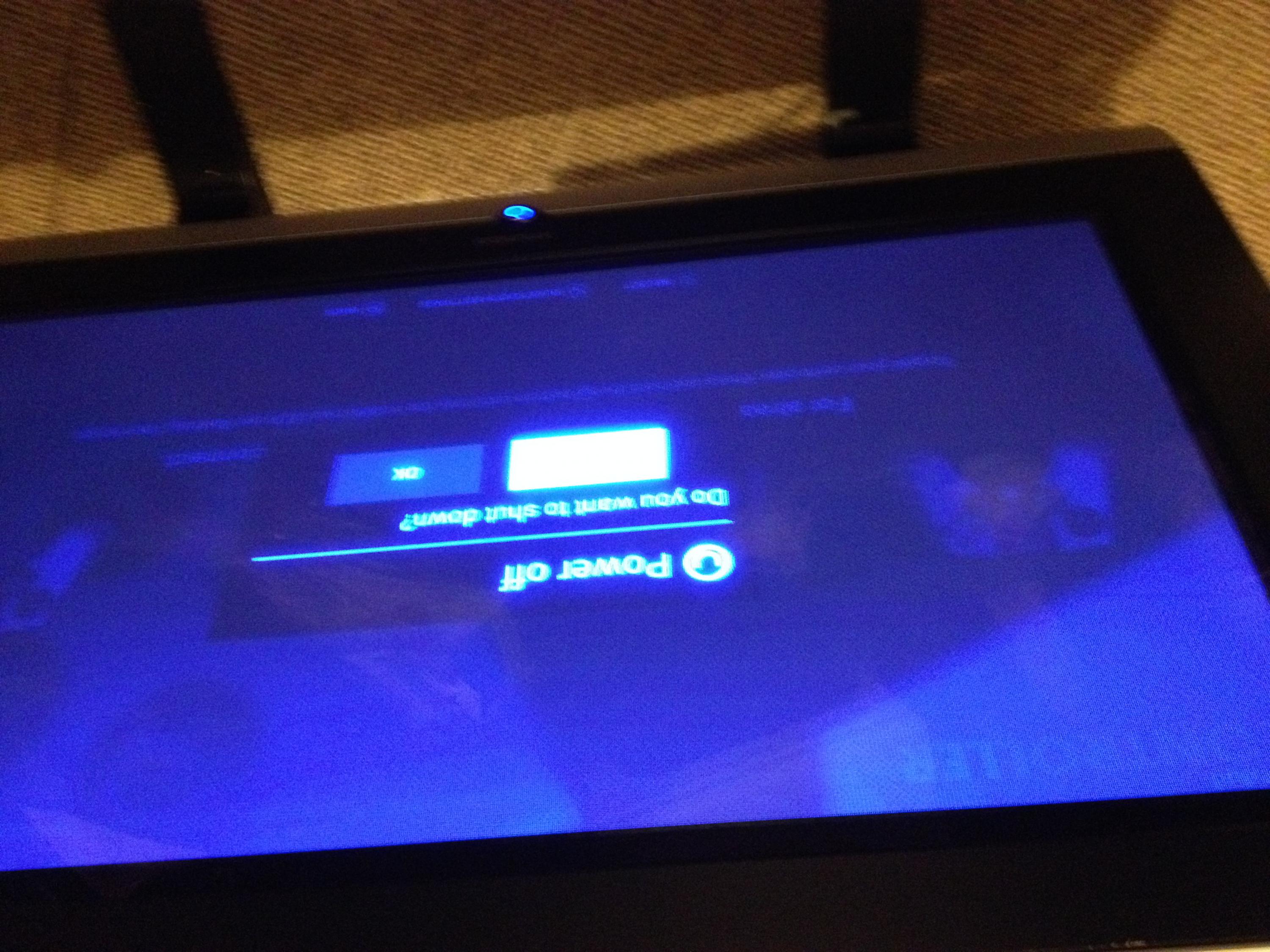

    hi all
    got this one going after a PS problem
    all looked ok but the screen just turned blue after a couple of flickers
    iv reseated everything and cleaned connections
    when the set is blue no amount of poking cables and twisting things changes the colour
    now the strange bit is if i left it off for a few minutes then the picture is normal for a few seconds befor it flickers and goes back to blue
    if you call up the menu that looks normal so im thinking its an issue with the main but can someone confirm ?

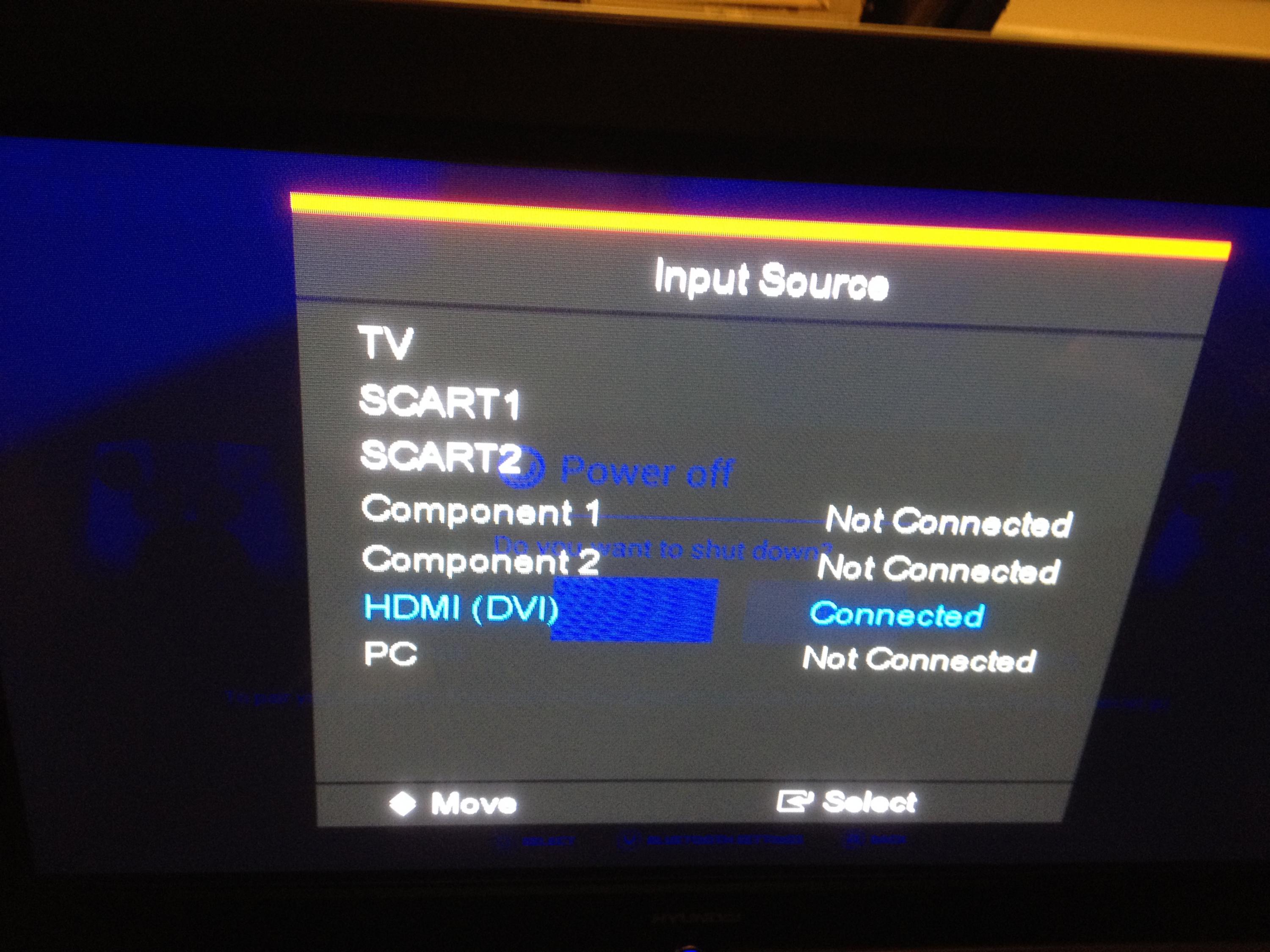

    Re: hyundai hpt-4260 blue screen, main board or control
    it happens on PC input also oh and the analog turner looks normal as well
      Well, you have your answer, the only board that discriminates analog tuner and normal inputs is the main board.
