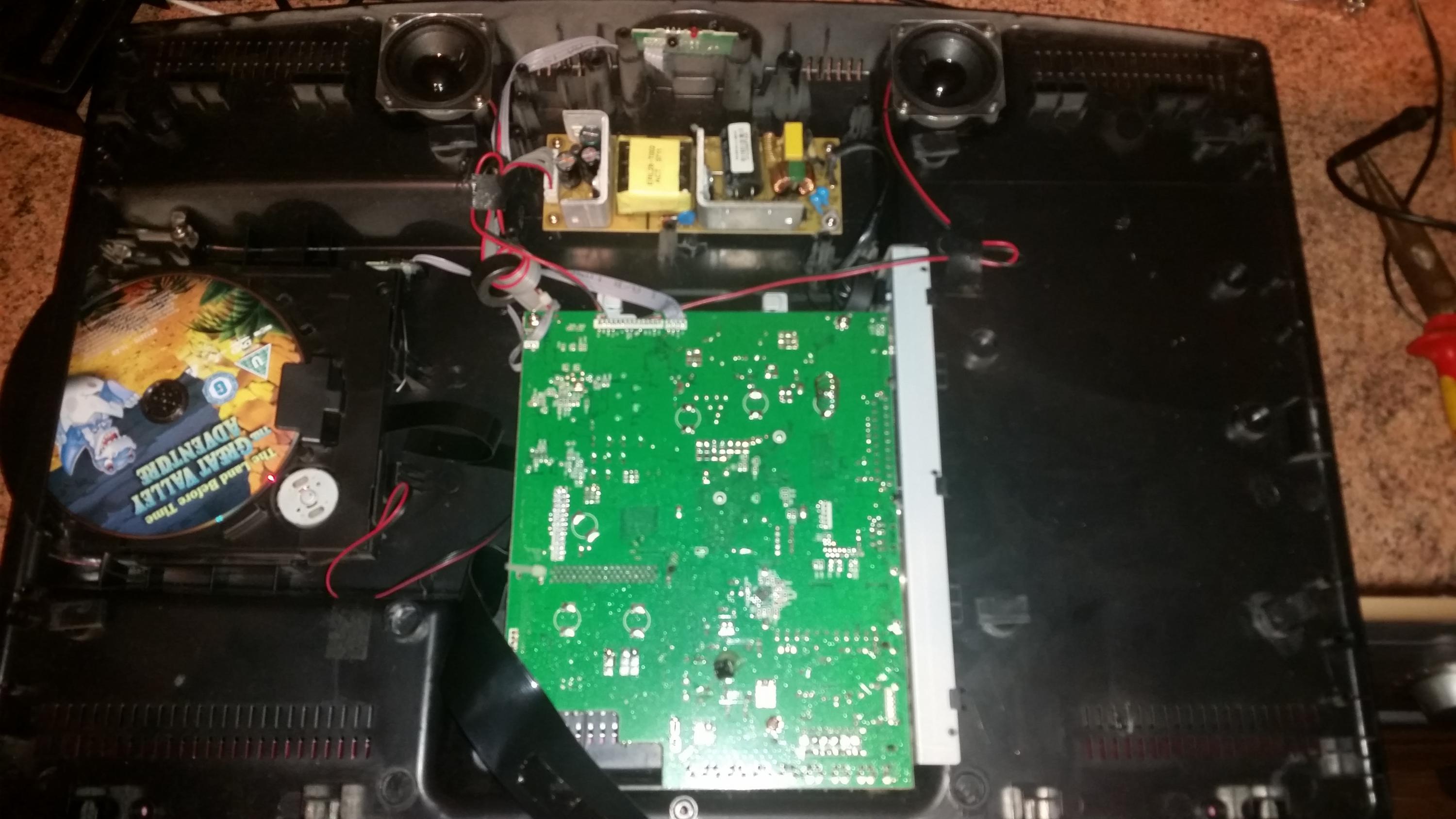

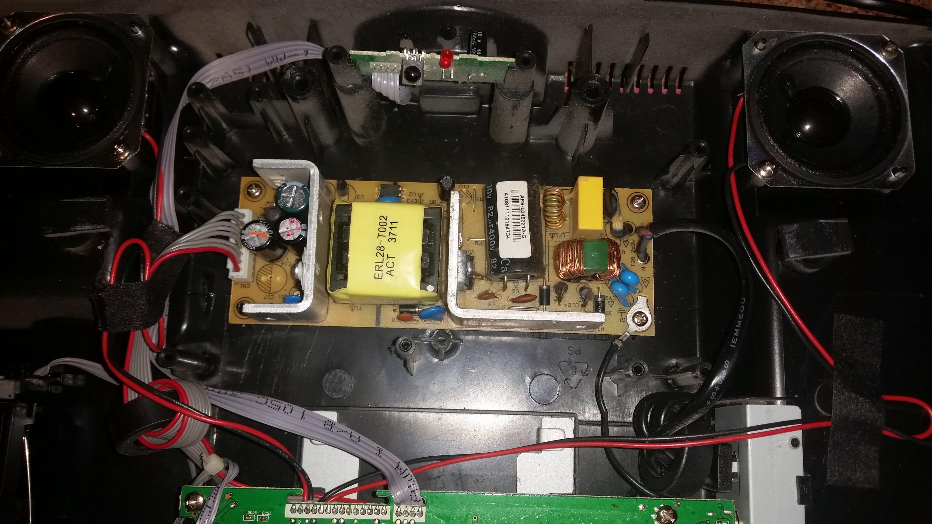

    Bush btvd91216p
    Hello
    testing this tv stuck in standby
    pins 1-3 should be 12 volts im getting 11.83 volts
    main cap is 400 volts but im only getting 322 volts no bulging on the caps etc
    anyone had the same issue before ?
    thankyou
    Re: Bush btvd91216p
    PSU is working.
    322V is OK for non PFC power supply, this is small TV so it will not use PFC.
    11.82V is within tolerance for a 12V rail (11~13V would be typically considered acceptable)
    I'd focus on main board, check all voltage regulators.
