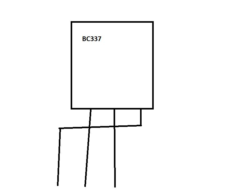

                      Q600- TK10A50D mosfet digikey part number TK10A60DSTA4QM-ND
                      Q601- 2sc2120y transistor can sub bc337 if you wrap emitter BC33740TACT-ND

                        Thanks Caleb, What do you mean when you if you wrap emitter?
                          Re: Parts list for Emerson LC320EM2
                          Pin out is not the same on the bc337 so you have to insulate the emitter leg and wrap it to the opposite side of the transistor to get the correct pin out. Its much easier to use the exact transistor replacement, but if you need to sub with parts all from one source, digikey has everything listed.
