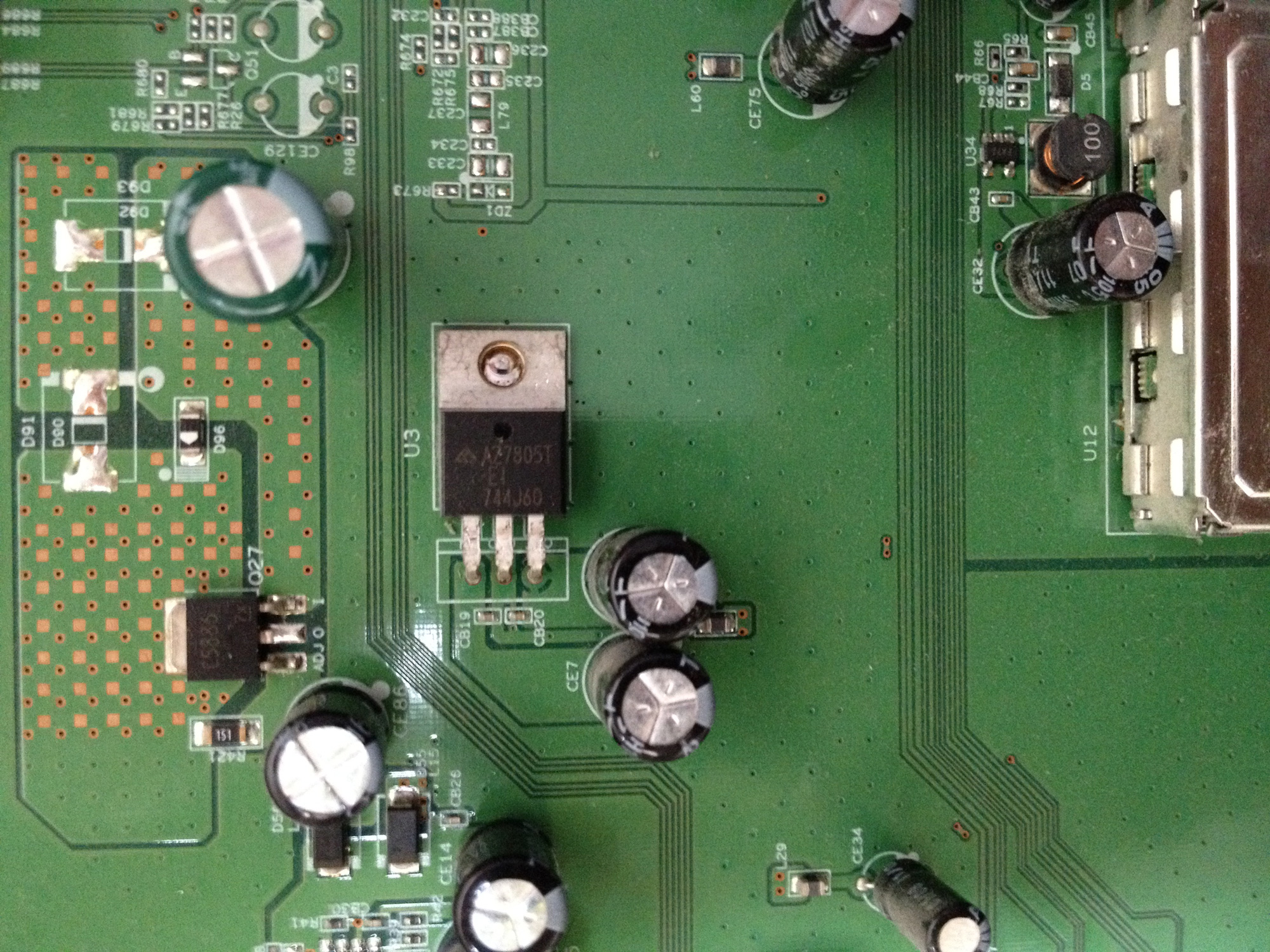

            Re: [UPDATE] VIZIO VO47L FHDTV10A No Video
            UPDATE
            • I have just replaced all capacitors on the secondary of P/S and all capacitors on both inverters.
            • I have also jumped the fuse on the master.
            • TV is on and running great.
            • Just a little buzzing (very subtle) from time to time on the master and slave inverters.
            However - I am still seeing:
            • 2.44V on the (Input Pins) @ Transistor O27 and Regulator U3
            • 11.8V on the (Adjust and Output Pins) @ O27
            • 1.02V on the (Output Pin) @ U3
            • Both the (5V and 12V) fuses on the main-board have correct power on both sides of the fuse.
            Why is the TV functioning and why do I have more output than input on the transistor and regulator?
