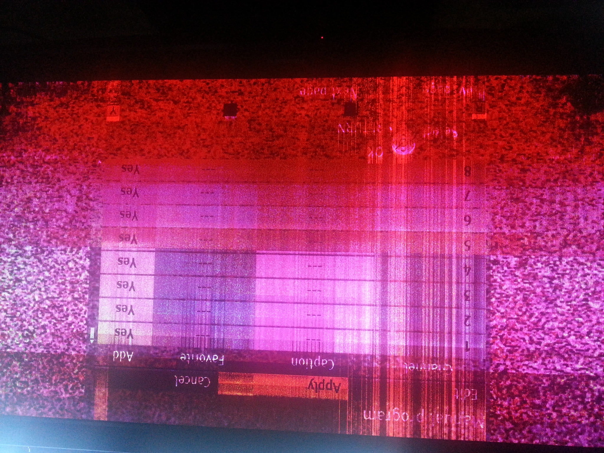

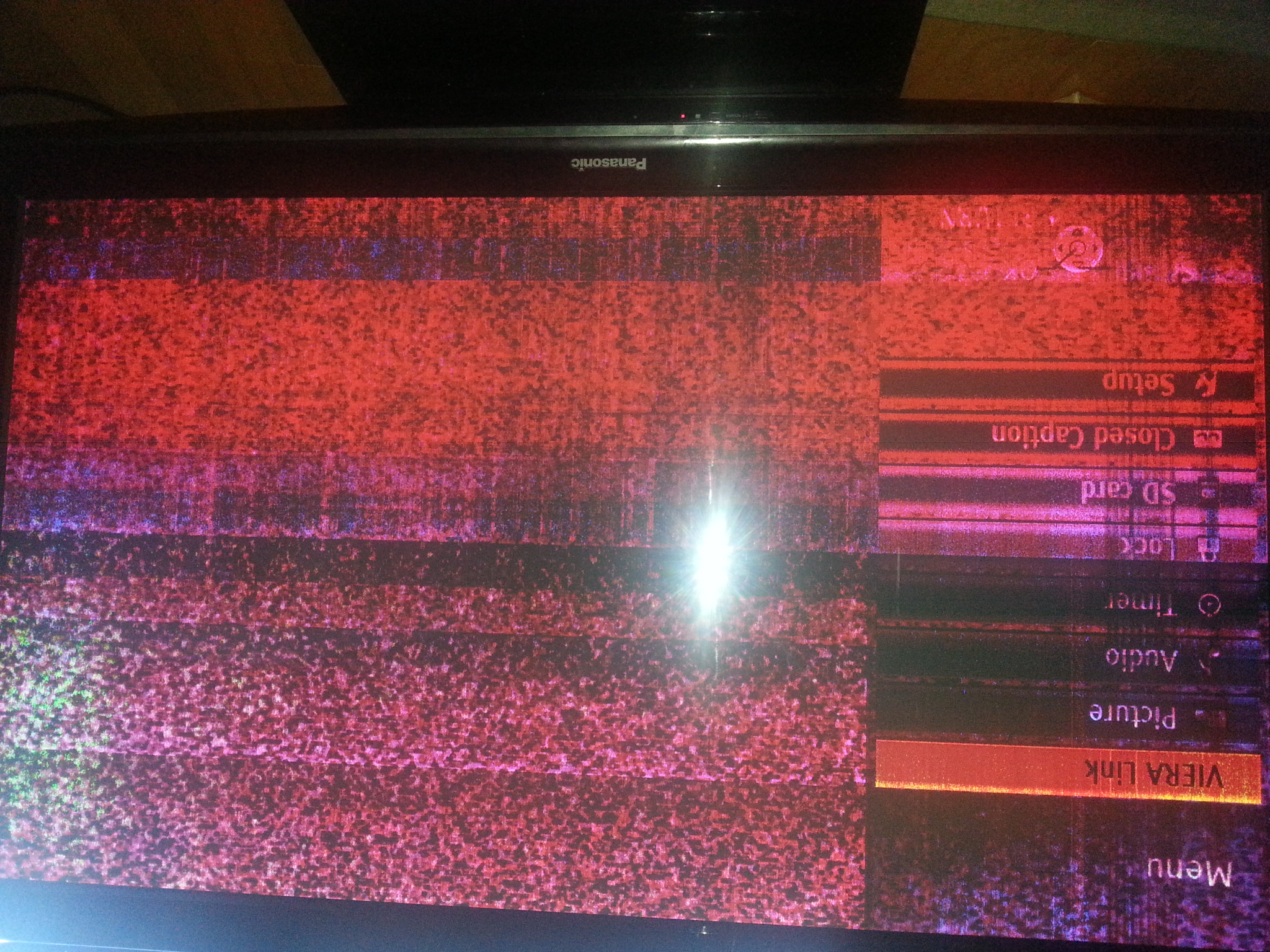

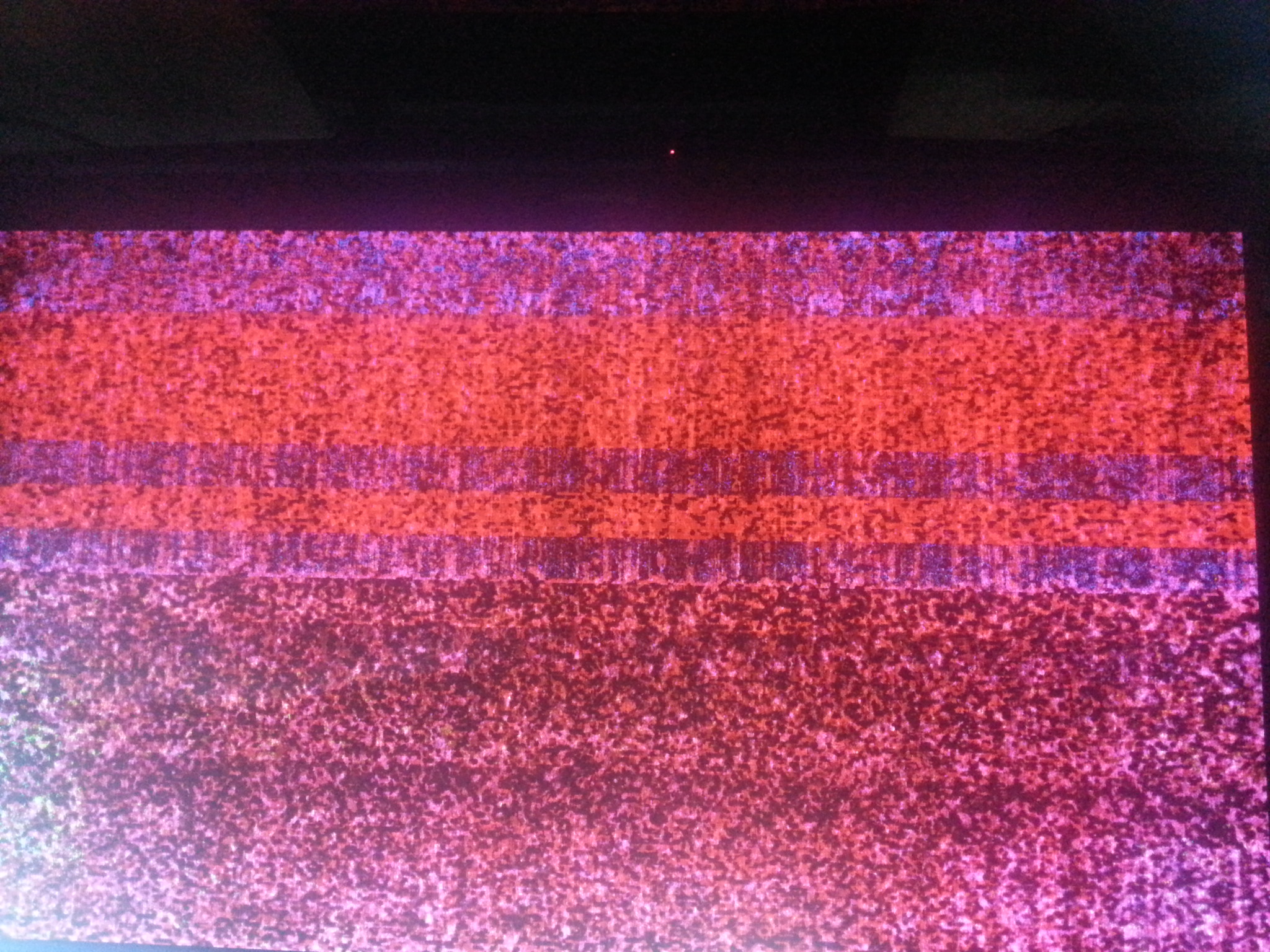

I am at my wits end with this TV. Back story:
2 Sept - TV goes dark with 7 blink pattern. after hours of internet fact finding (this forum included), narrowed it down to the SC board (TNPA4844) .
10 Sept - SC board replaced with used but "guaranteed" working. TV powers back up, WooHoo
....but now shows this:
BOOOO
15 Sept - I went ahead and replace both buffer boards (SD/SU:TNPA 4790&91). Same result. even went through two sets of board to make sure!
25 Sept - Replaced SS Board (TNPA4783). Same result.
So if I'm correct: I've Replaced - Zsus, Ysus, and Buffers.
what the hell else could be wrong?
Never had the picture problem before 7 blink issue
do i have a bad Panel?
FYI: I will never purchase another Panasonic ANYTHING again. Their customer service is shyte.
