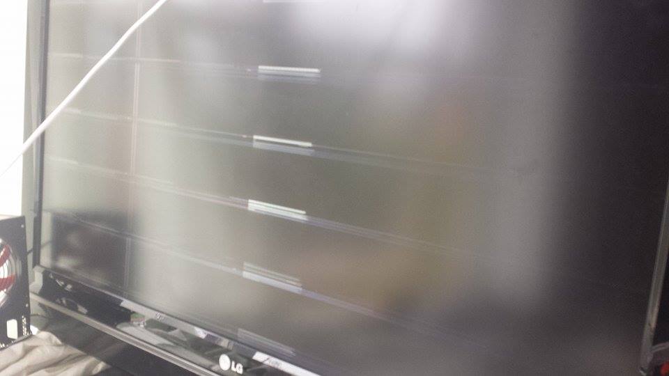

    Lg 37LF65-ZC
    I got a Lg 37LF65-ZC which is working on some sources ie hdmi but not scart or ariel. It also faild to turn off with the remote. I believe it to be the main board at fault, if so does anyone know where I can get one, thanks.

          Re: Lg 37LF65-ZC
          So the backlights stay on but no pictures, then check and see if the T-CON is still getting the voltage to the SMD fuse on the T-CON board, or the main board is not sending the voltage or the signals to the T-CON.

            Re: Lg 37LF65-ZC
            I've changed the main board but now when it goes off it like flickers as if its trying to come back on.
            Think I have a look at the t-con board.

                Re: Lg 37LF65-ZC
                back light stays on,its the signal that goes.

                  Re: Lg 37LF65-ZC
                  This is what im getting after about 2 min.
                  Got sound, flicky pic

                    Re: Lg 37LF65-ZC
                    Changed the t-con board but sill the same as the screen in the last pic after 2min.
                    so its got a new main and t-con boards.
                    Any ideas what else it could be, im starting to think its the screen.
                      Re: Lg 37LF65-ZC
                      For what it's worth I've never seen a bad panel do that.
