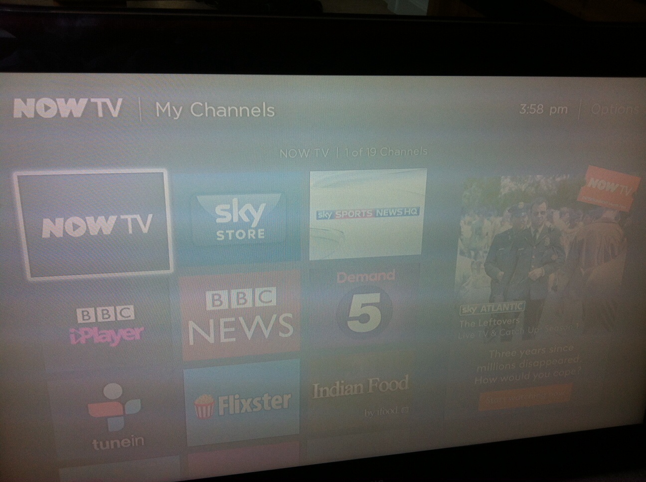

    Hi I have a Samsung LE37A656A1F. The problem is with the colours or no colour. I have attached some samples of the problem. Hopefully someone can help.
  • RJARRRPCGP
    • Jul 2004
    • 6304
    Re: Samsung LE37A656A1F
    The whiteness is more likely a faulty gamma chip.

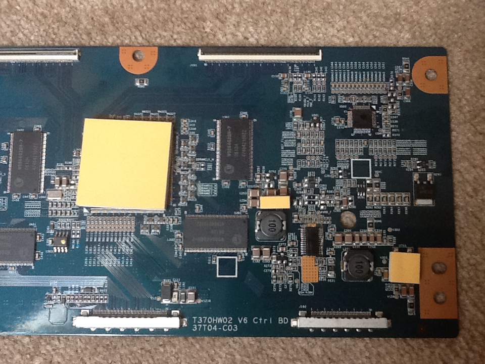

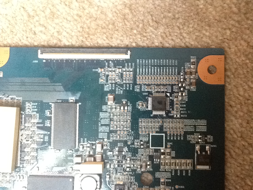

          I have removed the t-con board. The chip that I think is the
          Sg-15 has no writing, it does look a bit burnt. The T-con board is a t370hw02 v6 does anyone know the exact AS-15 chip number for this board ie G U or F etc
            The AS15-F can be used as a replacement for all G/U and F chips Flocko
                They are not identical but they can be used to replace each other on AU Optronics boards. AS15-F was used to replace AS15-U on a Sony board of mine, without issue (AUO 37" 720p panel.)
                To test your board you will need a digital multimeter.
                Board must be installed in TV and fully connected. Make sure to screw it down. Play a video or still image on the screen.
                Then in the top right corner of the board you will see a set of points VGAMA1, VGAMA2...
                Test each of these points (usually there are 18 or 22) and report back the voltage on each point with the number of the point..
                For example:
                VGAMA1 ... 1.03V
                VGAMA2 ... 2.45V
                • diif
                    VGAMA1. 14.78v
                    VGAMA2. 14.72v
                    VGAMA3. 10.3v
                    VGAMA4. 9.64v
                    VGAMA5. 9.34v
                    VGAMA6. 7.27v
                    VGAMA7. 7.21v
                    VGAMA8. 0.15v
                    VGAMA9. 0.15v
                    VGAMA10. 0.16v
                    VGAMA11. 0.15v
                    VGAMA12. 0.14v
                    VGAMA13. 0.1v
                    VGAMA14. 0.11v
                    This was tested with now tv home screen on.
                        The chip is definitely bad (the VGAMA are wrong) so replacing it should be all that's needed.
                        Personally I prefer a hot air gun for removing the chip.
