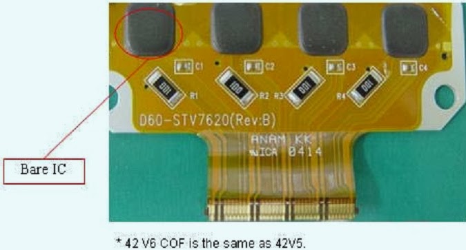

              At the bottom there are buffer boards, i think known as e & f buffers in Samsung. The panel ribbons that connect to these have Ics embedded in the film. Not repairable, so this is known as a panel fault since the ribbon and those Ics are integral unlike the y buffers or e & f buffers.
              With a noisy section like that I would say 100% panel and not the buffers. you could gamble on the buffer board but I think you will be disappointed.
              It's a bugger but that's the way it is.

                Re: ps51e450 fuzzy static middle of the screen
                Old example of what I suggesting but same principle

                    those COF (Chip On Film) chips are a PITA!
                    Seen quite a few older Panasonic 42" with those gone and a few Samsung lately too....
                    These days, I wont spend out any sizable amount on ANY set--With 'Lines' on the display!

                        I scrapped three 42PX60's in one day--with bad COF Chips! All those sets though probably had well over 15,000 hours on 'em. Still a shame though, sets were in great condition apart from the fault....
                        --Seems a common failure with that model.
                        TELEFIX
                          Some early PX70s and PZ70Bs (before the "BA" designation) had that fault as well.
                          From what I've heard, it's a software bug - the control board in certain cases can have the Va remain live when the 5V shuts down, just for a second.
                          This can damage the COF chips eventually, if they go into an undesired "latch up" state.
