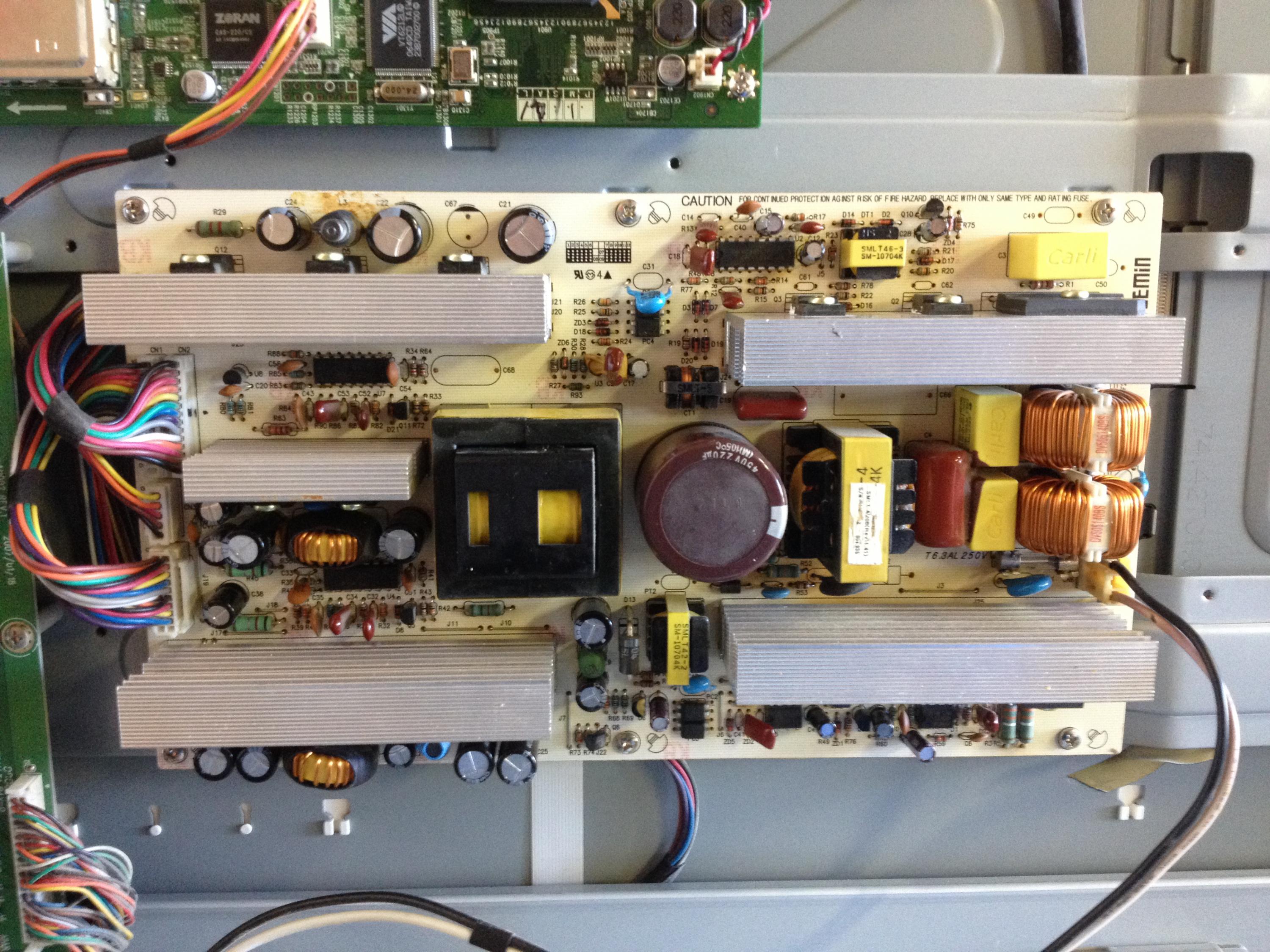

    After a bunch of reading seemed like the power supply was the likely culprit.

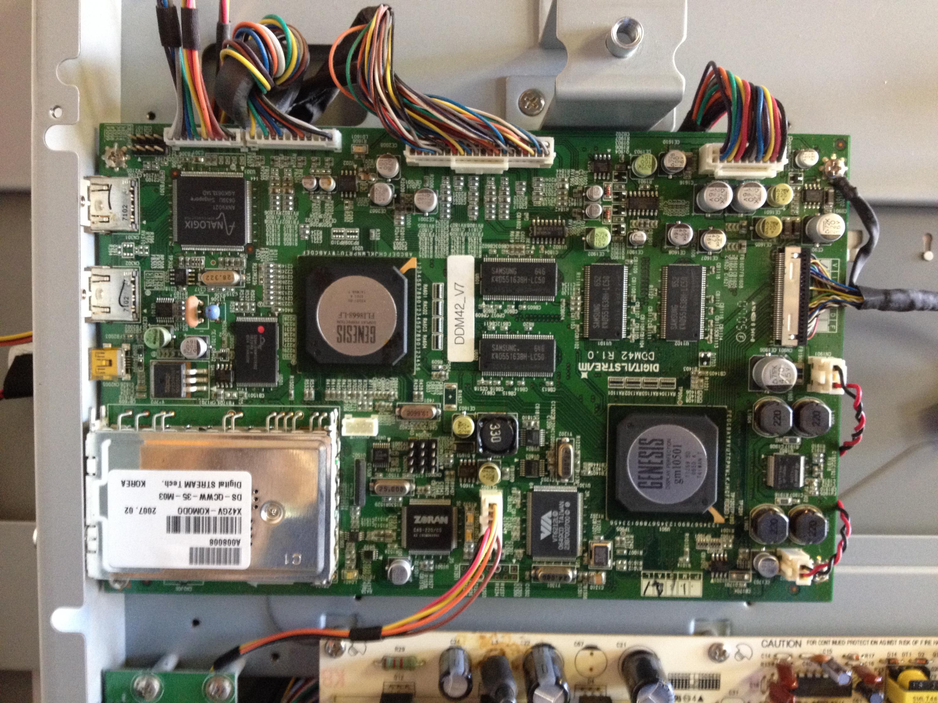

    Removed all the caps from the power supply, ordered replacements, last night put it all back together.
    Initially it powered up and displayed the Sceptre logo on the screen but just stayed there.
    It didn't go to fuzz or say no signal like it normally would w/o a video input.
    Power off/on now just does the same thing, light changes from red to blue but no display.

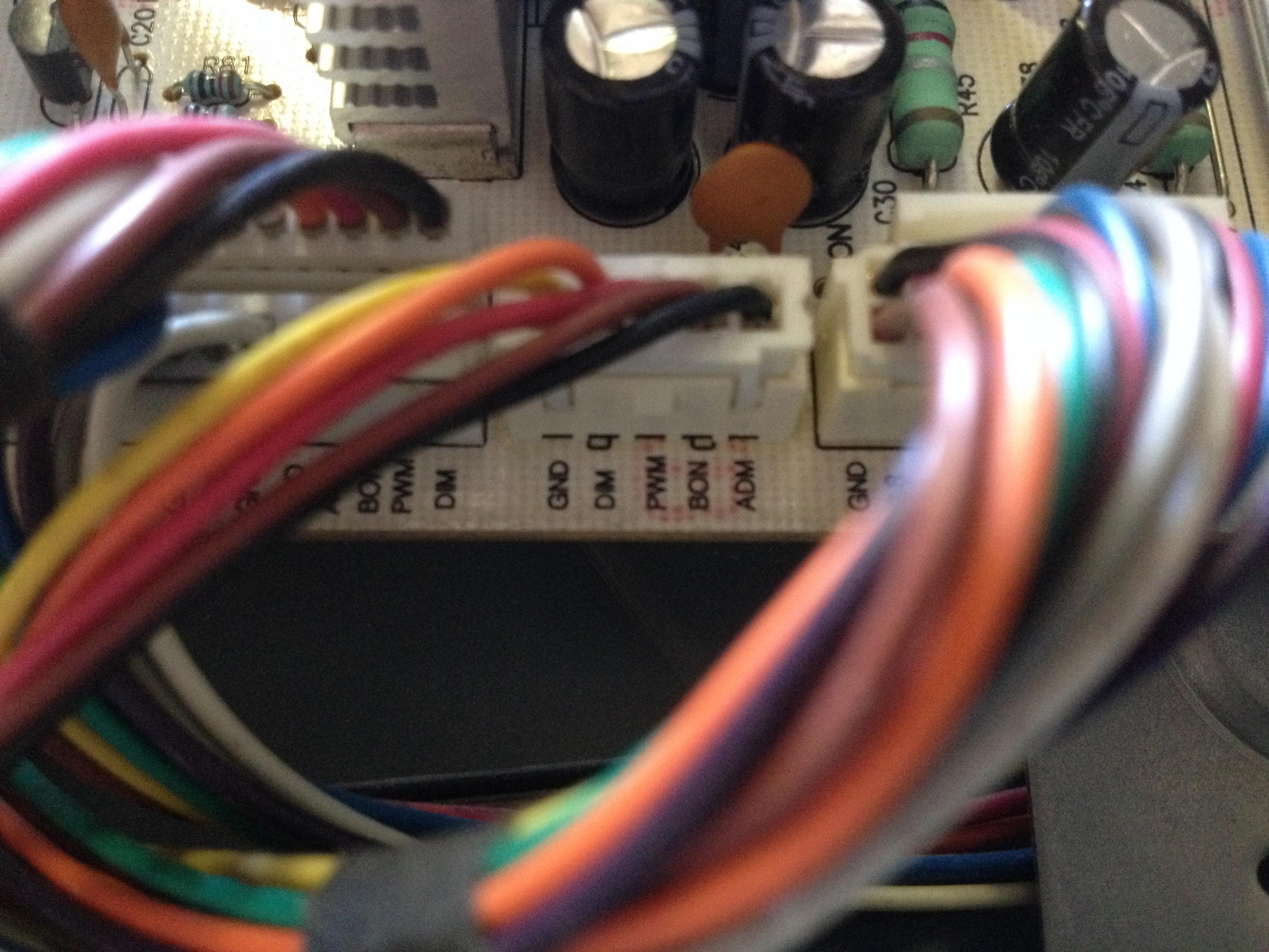

    I measured the connectors on the power supply, and @ the inverters. Seems to be outputting the correct voltage from the pins that are labeled.

    Thinking maybe the motherboard took a dump?

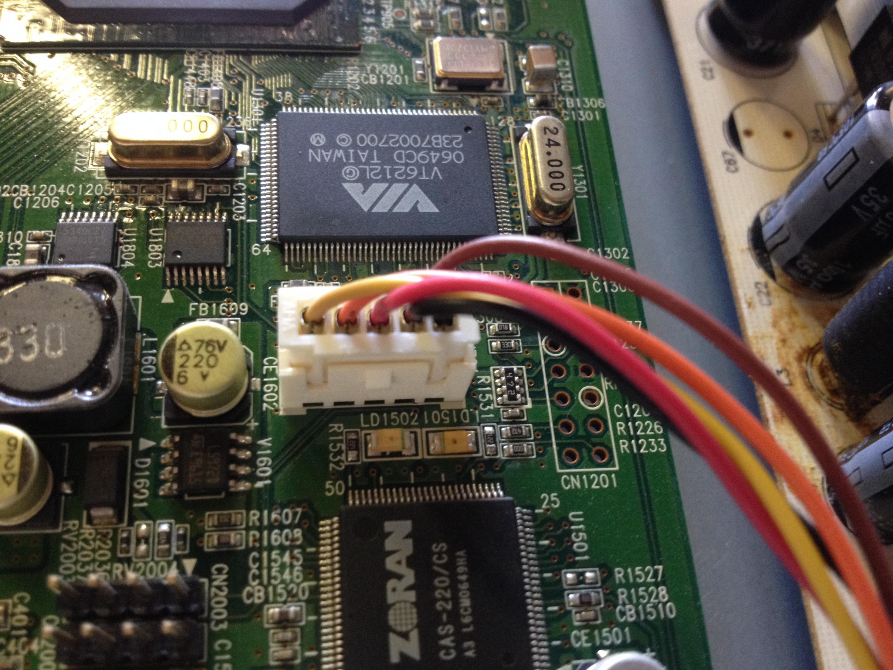

    One thing I noticed is there are 2 led(s) on the motherboard by a small connector. (picture 3 attached)
    They just barely blink when you try to power it on.
    If I unplug it the led(s) blink much brighter, and the backlights turn on (but no normal display or logo comes up).
    Both the power supply & inverter connections have 24v as marked.

      Does anyone know what the voltages are supposed to be on the small connector 3rd pic, that goes between main board and power supply?
      If this is unplugged the inverters power up when TV is turned on.
