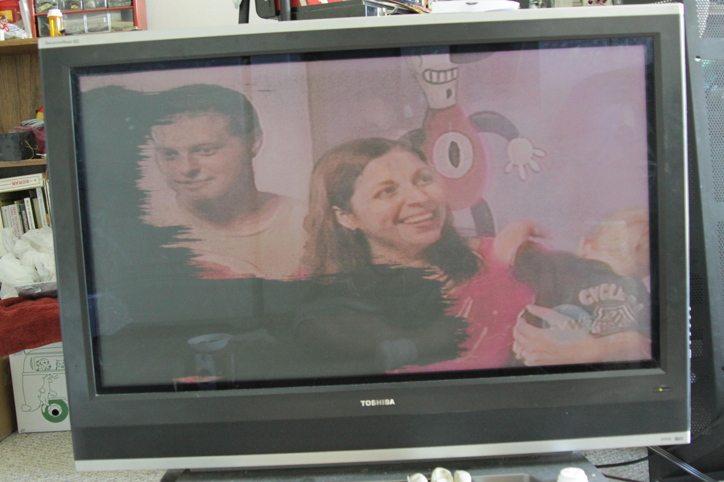

    Hi all, new to Plasmas, could really use some input!
    TOSHIBA 42HP66 PLASMA 8 Yrs old
    All voltages off power supply read good.
    Don't know if it was a slow fail or a quick one. TV was given to me and I would really like to fix it for myself.
    Overall dim picture, with solid black irregular smears, that move from right to left within the first 5 minutes but never completely go away.
    Good sound, and does not seem to have any digital issues, responds well to menu options. Turns right on. Power supply sure seems fine.
    Does this sound like a panel issue? If you think it may be a board, please direct me to where it is located, (plasma newbie issue again).
    VERY experienced in electronics, (Electrical Engineer with all the equipment) just new to Plasmas.
    THANKS!

            Re: Hi all, new to Plasmas, could really use some input!
            Ah,--See....?
            Thats what happens when you post Multiple Threads on the same issues--It Gets Missed!
            So, Have you a scope...? I suggest checking the drive waveforms on Y-SUS and X-SUS boards. Compare with those found in the Training or Service-Manuals for that chassis.
            With all voltages as correct, you may have a Panel fault (Probable by the look of it) or possibly a distorted drive waveform to the panel.
              Looks like a Z-sustain fault to me. Panel is probably OK.
                        PDP 42X3 chassis, Z-SUS IPM failure. Scoping will confirm, Look for square-wave at test-point.

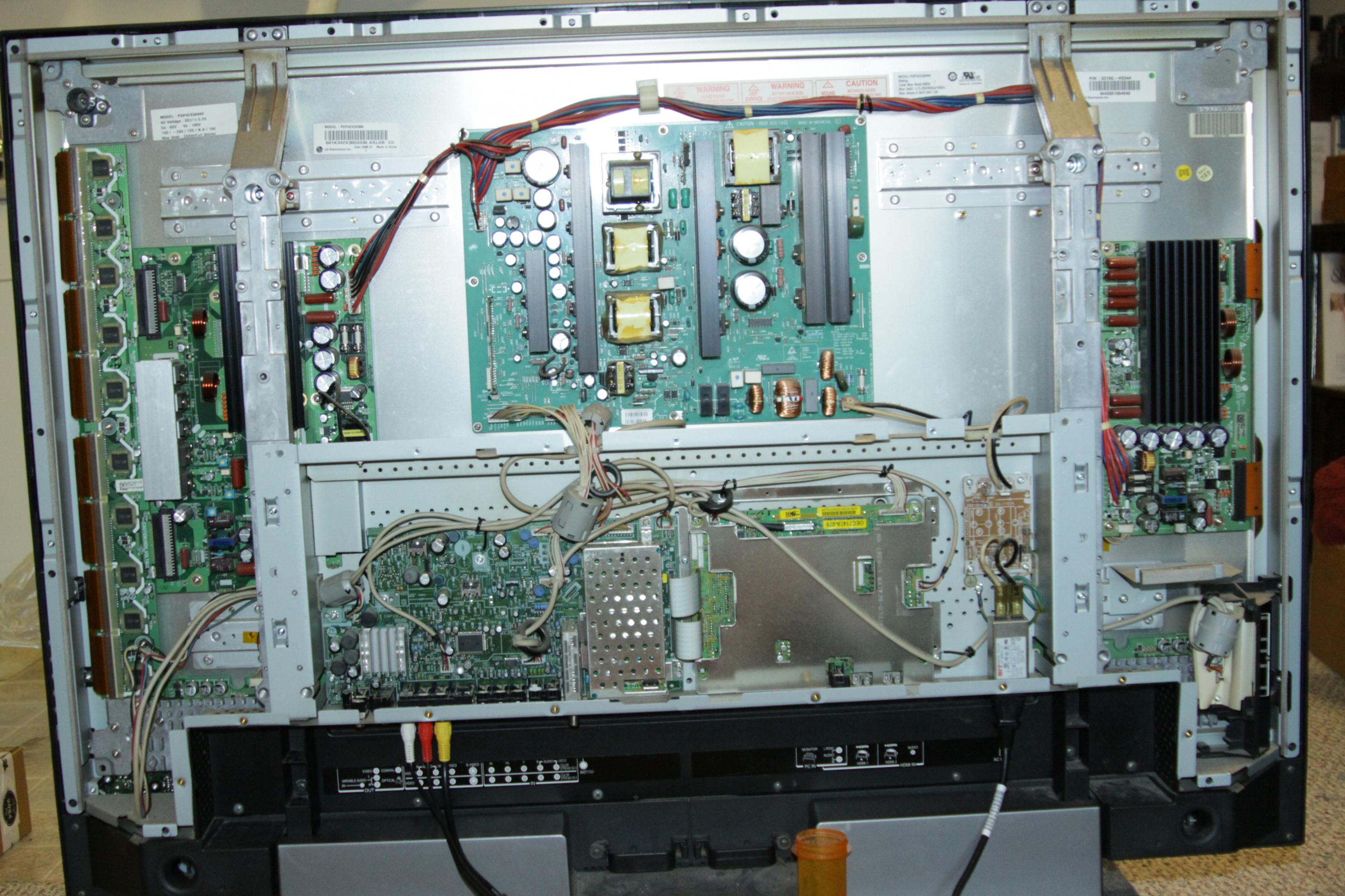

                          as there seems to be a consensus on the ZSUS, I went to the manual to check on the ZSUS signals, and it is the only board there is no schematic for.
                          I did check all 3 fuses on that board, and they are good.
                          If the ZSUS was bad, would it also cause a very dim picture?
                          I am thinking of just doing a board swap, as there is no info on the board.
                          Thanks for your replies.
                            There will be no schematics for any parts made by LG (as the Panel Module manufacturer) with the possible exception of the power supply board.
