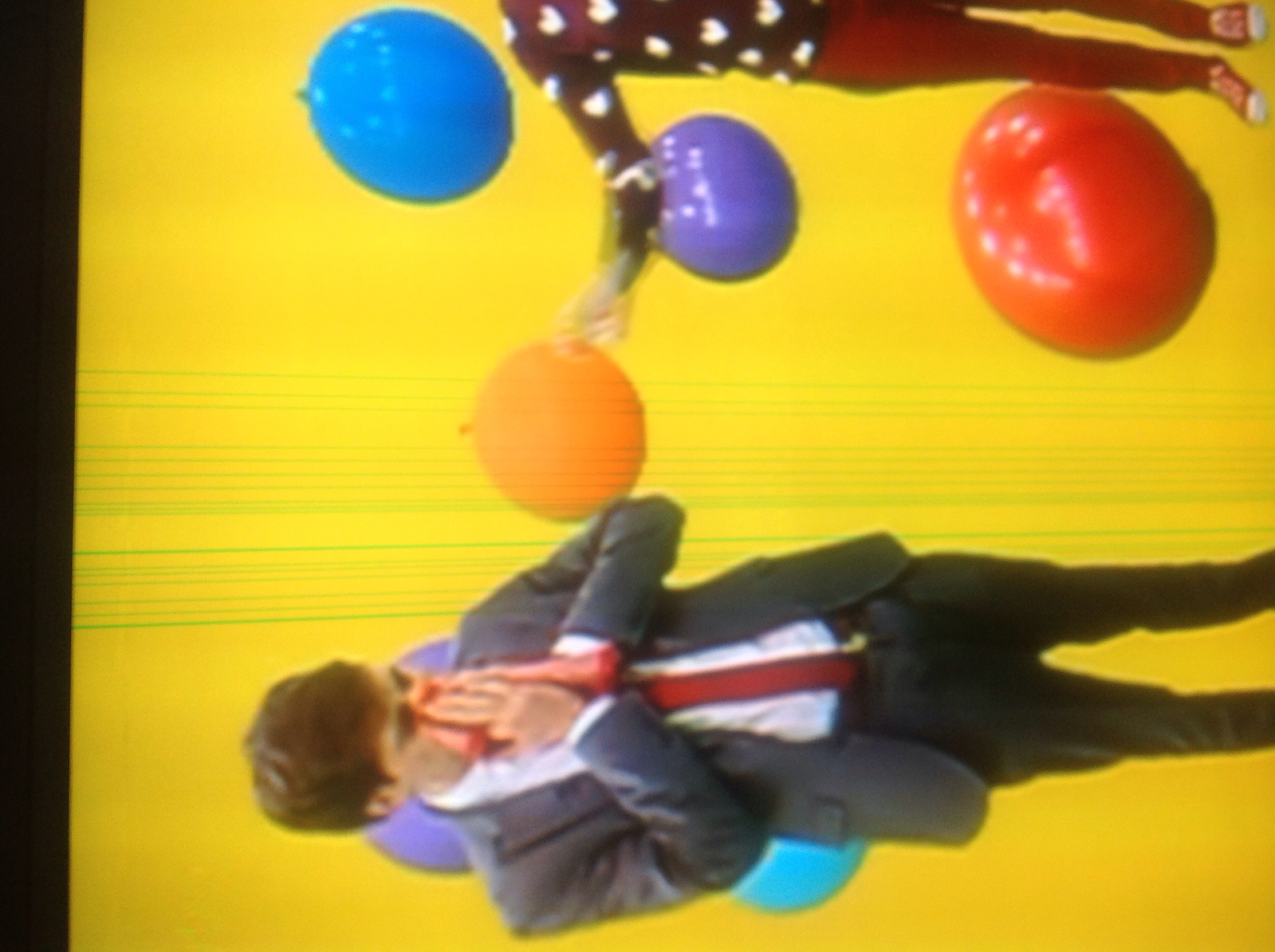

    Hi!
    I got my board and the tv works but there are vertical lines acros the screen.
    I tried cleaning the panel ribbon cables which go to y-sustain board and reseating them but it didnt help.
    Is it a bad panel or is there a chance to repair the tv?

        Re: LG 50PS3000 clicks
        Bad panel I'm afraid.
        Seems a common fault on these and any LG plasma, shame really :/
        Did it have this fault before it failed?
          Ok i thougt so
          I dont know about the fault,i got it in this condition but it was free
          Thanx Tom for your help!
