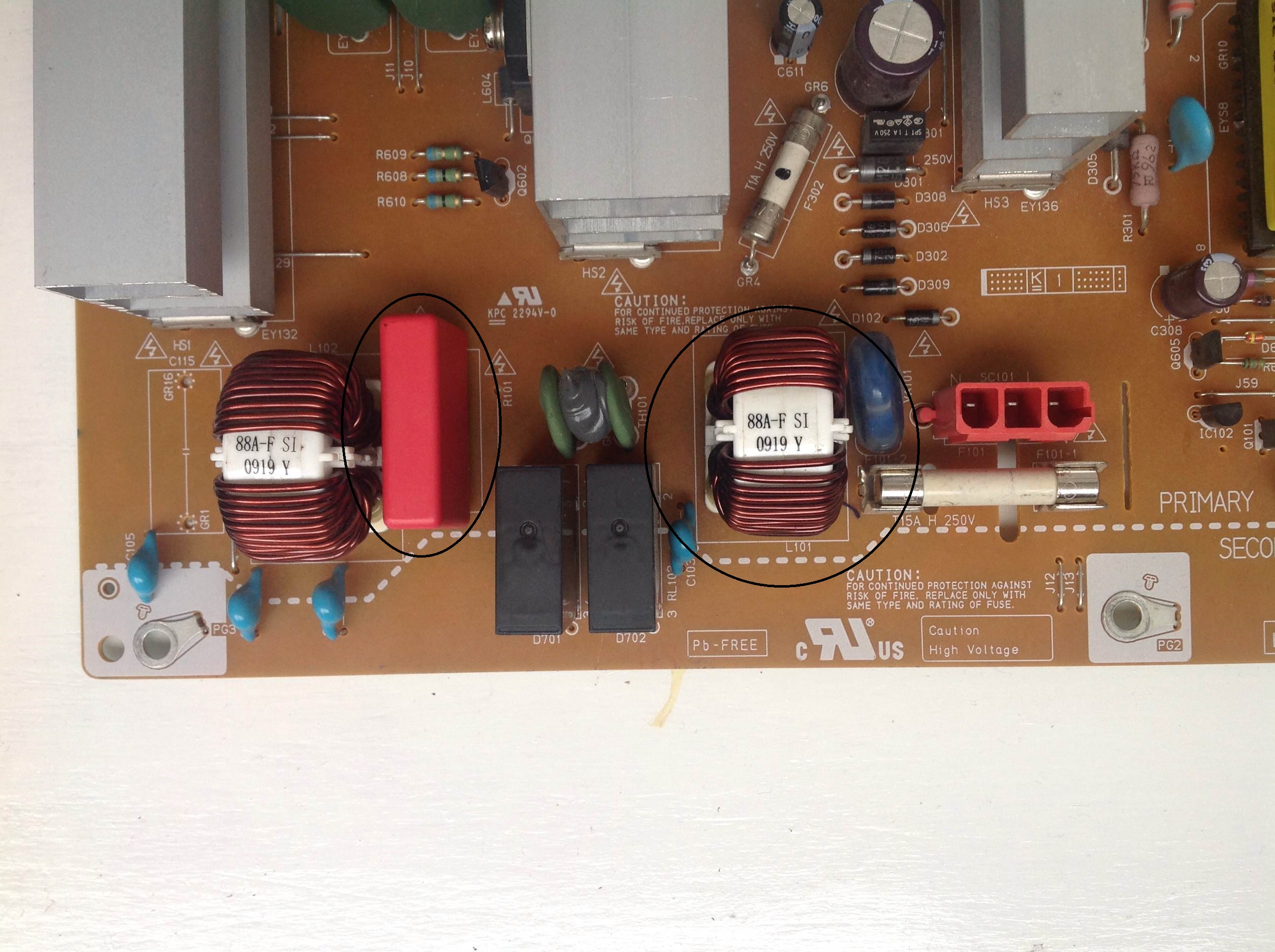

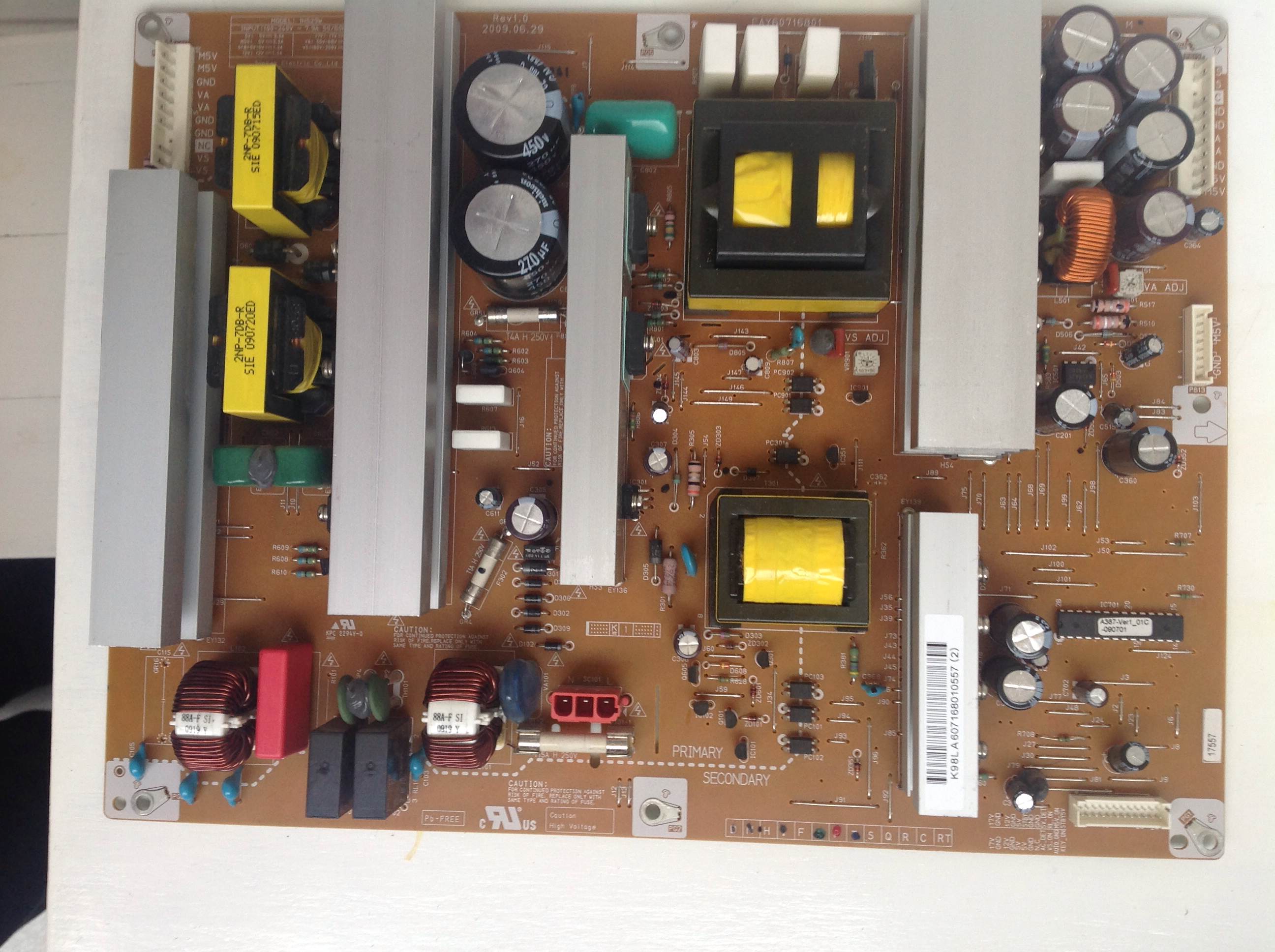

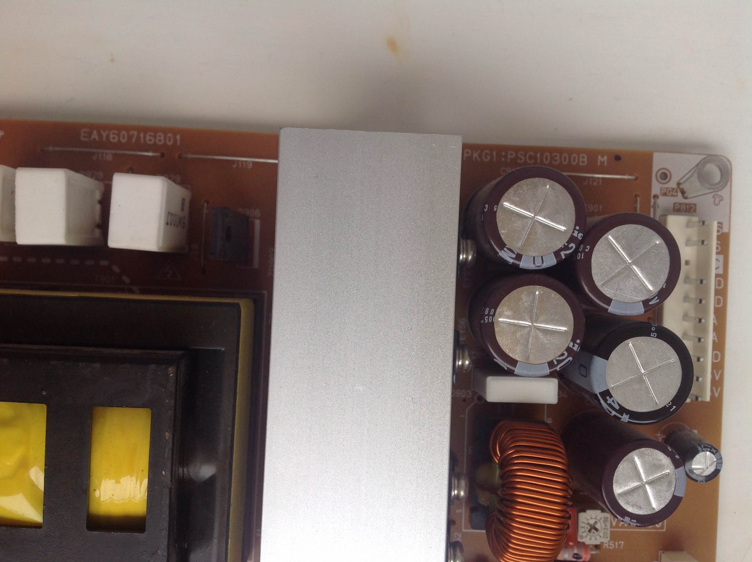

    I'm having problems with my LG plazma 50PS300.
    I'm suspecting the power supply board EAY60716801.
    When I power it on it makes 2 clicks and goes to stand by.
    When I turn it on (button or remote) the LED blinks 6 times blue and then turns red.
    The coil marked on the picture starts to buzz.

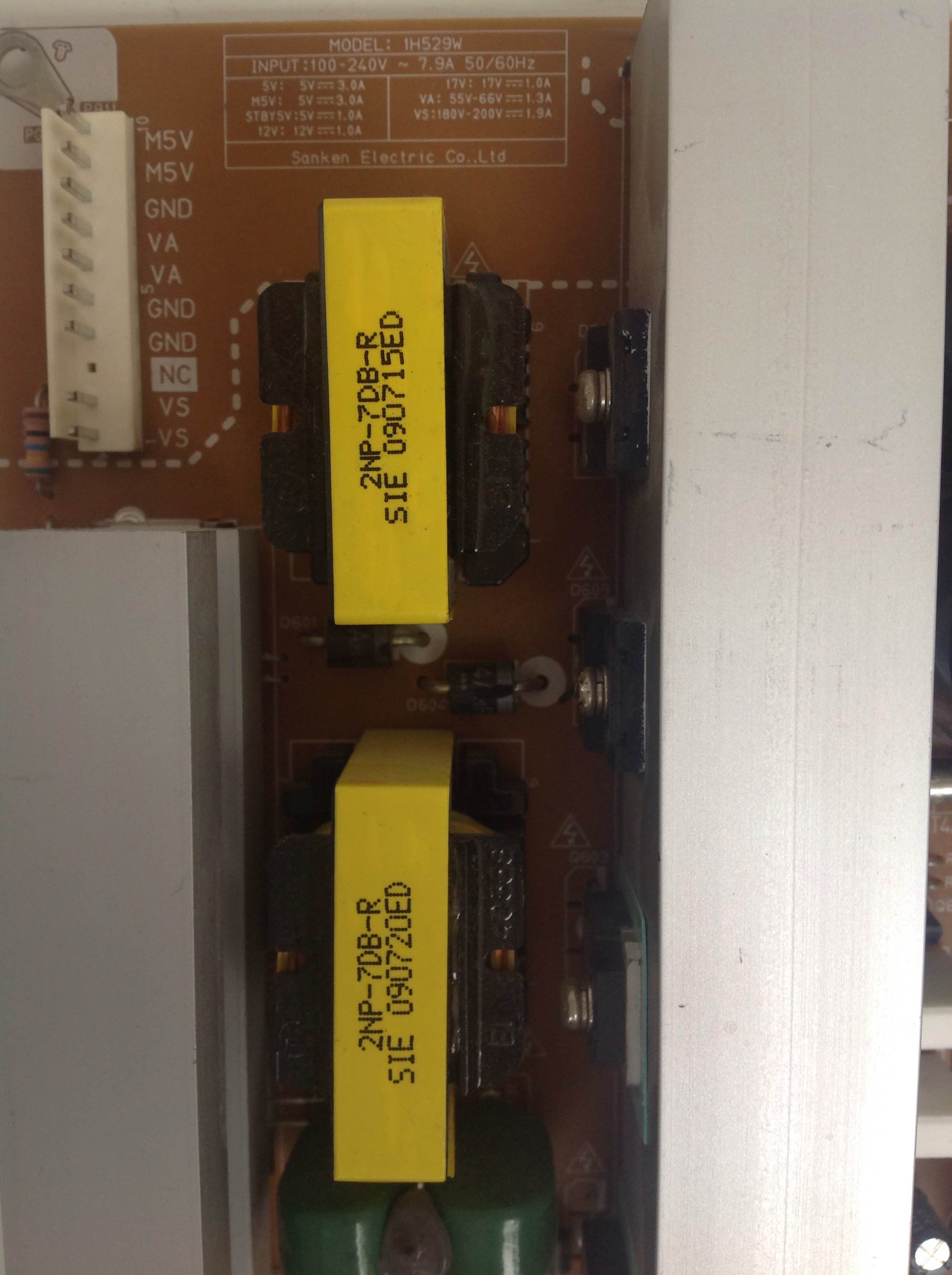

    I mesured the voltages and they are all 0 except stby5v which is 5V.
    Tried with all board connected to PS and all boards disconnected, its the same.
    I also tested all fuses and they are ok.Tested all diodes and i think they are ok (not open or shorted). Also I tried to change the voltage regulator IC301 (STRW6252S) and the red capasitor marked on the picture.
    Nothing changed. Please advise me what to do next.
