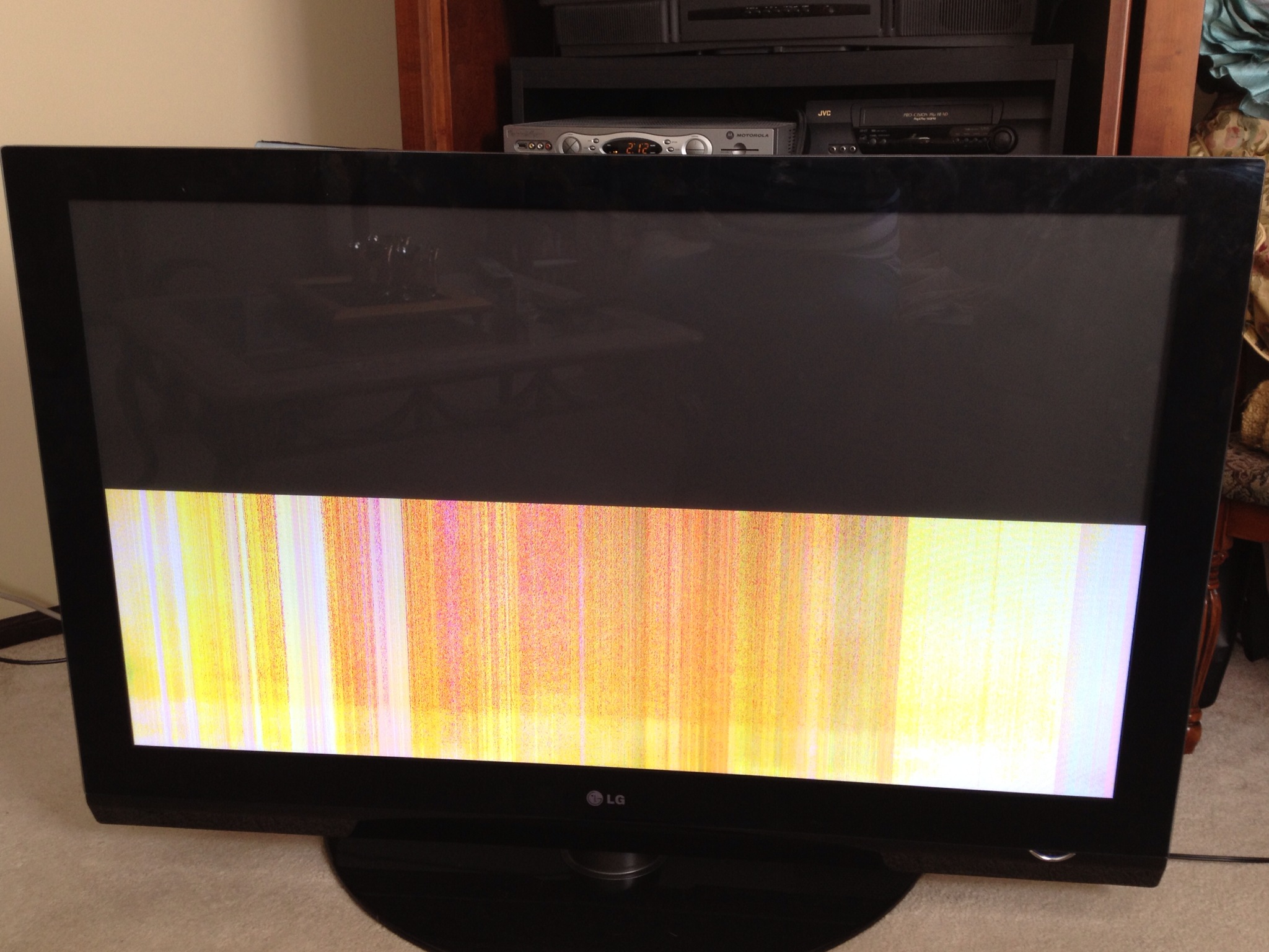

    2. After 3 minutes I get vertical line noise of yellow & orange lines (see picture)
    3. About 10 - 15 seconds after the lines come, the power cuts out competley
    4. The whole thing repeats when I power it back up

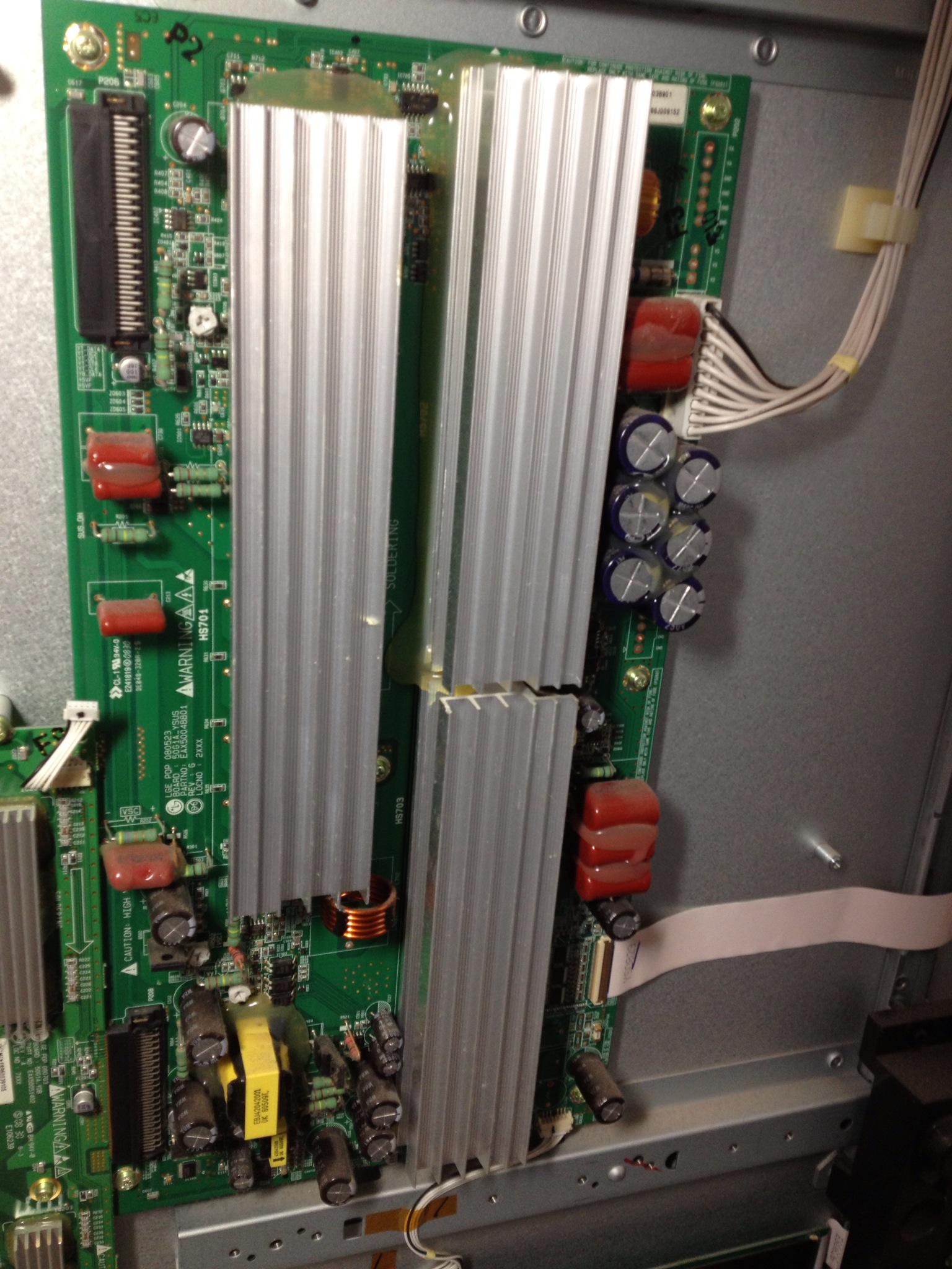

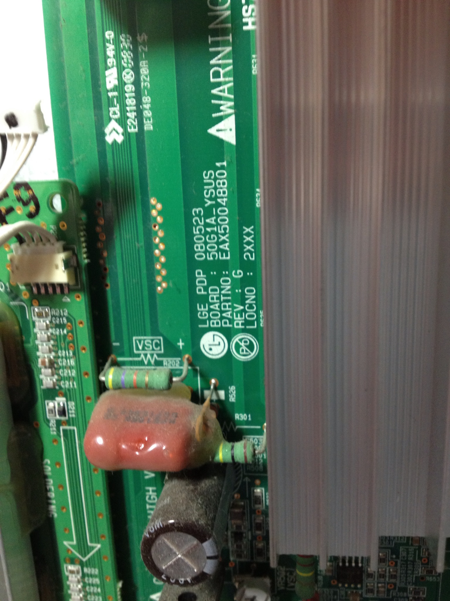

        Probably a bad top buffer board, it's a common fault on these models. Check -Vy and Vsc on Y-sustain with and without top buffer board in.
        Should be approx -180V and 150V respectively.

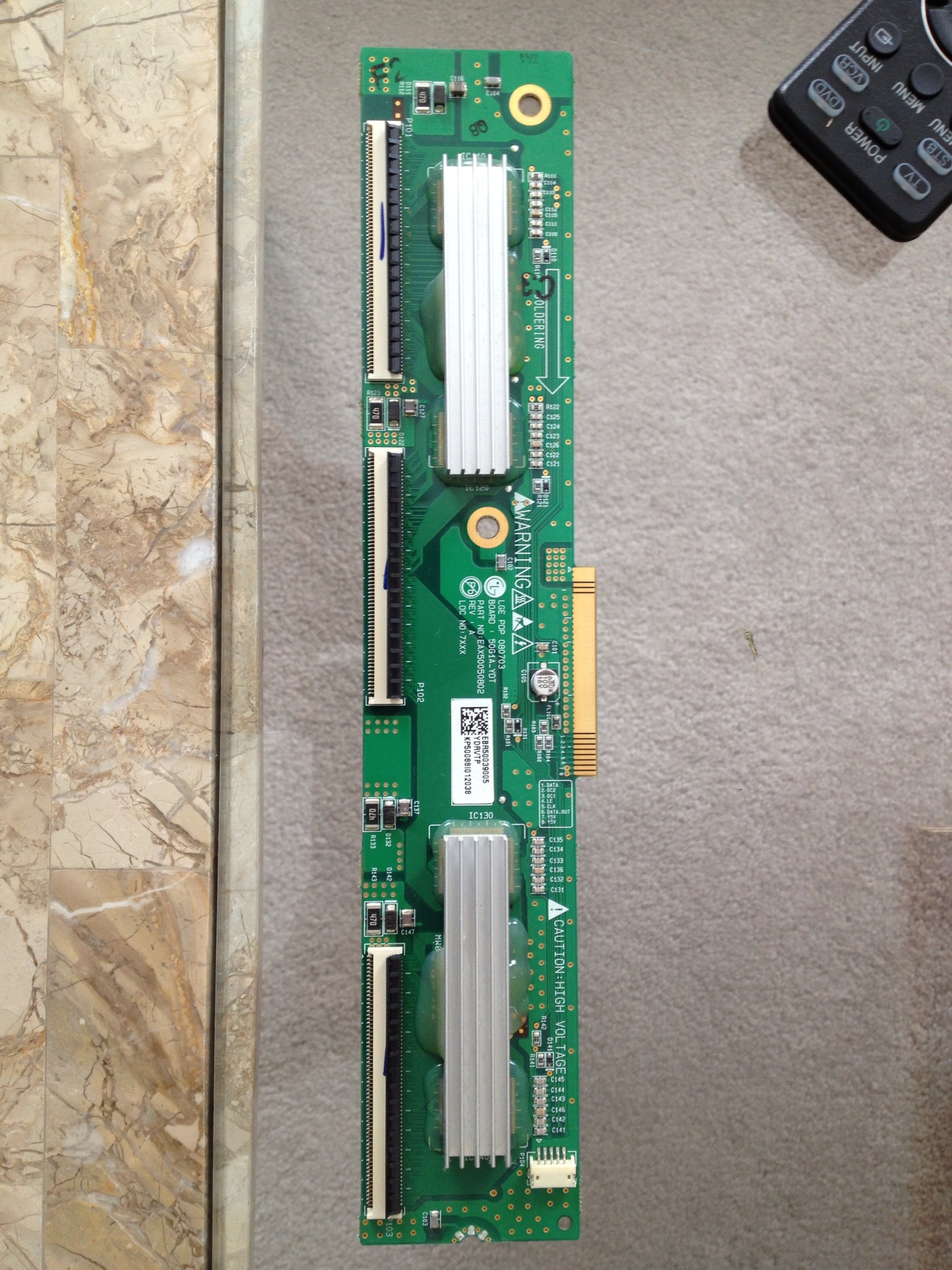

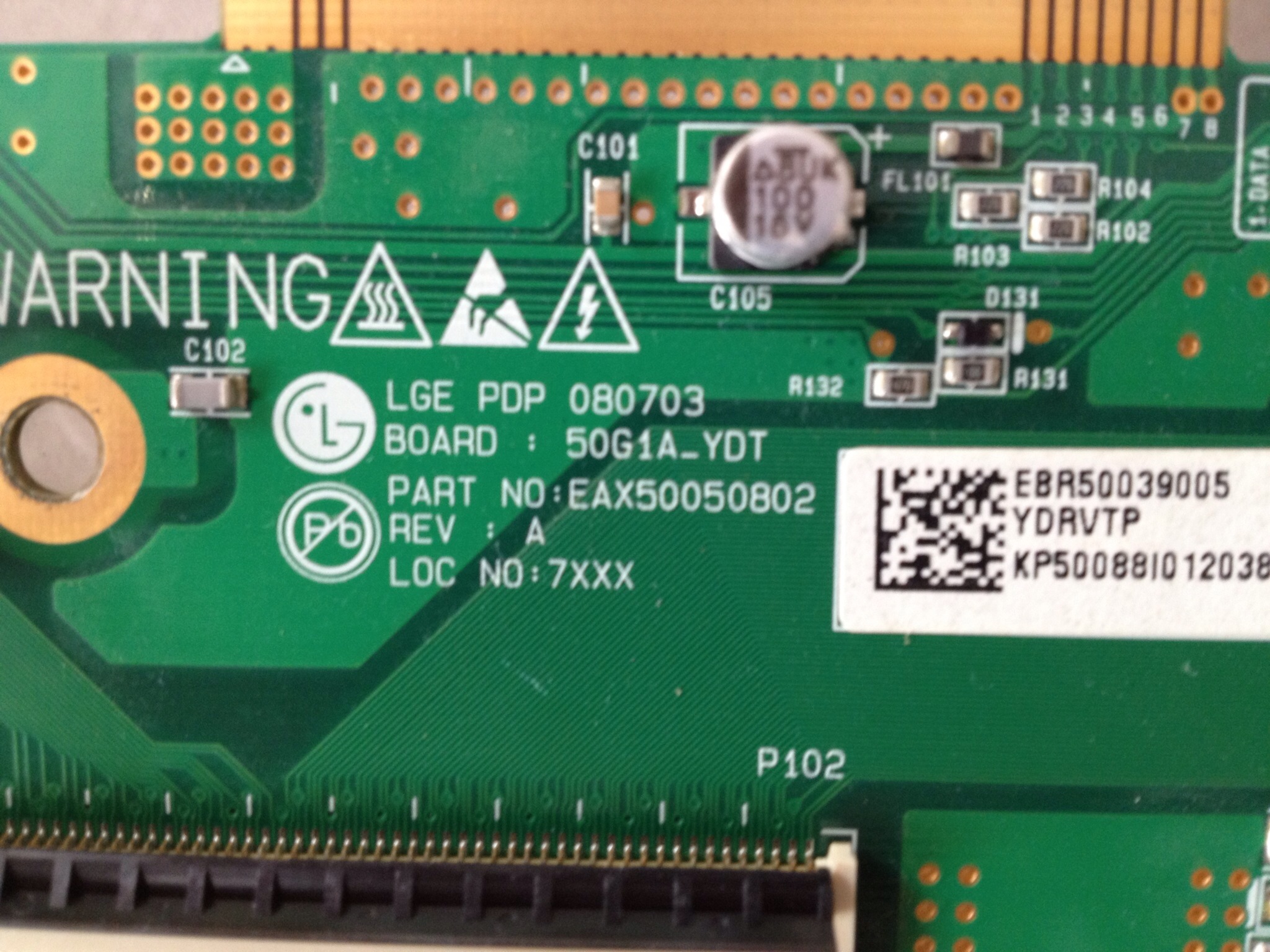

          Upper Buffer & Y-SUS (also close-ups of part # data)

            There may be some other issues, but good chance upper buffer is bad:
            With upper buffer in: Vy = +54 Vsc = +54
            Without Upper Buffer: Vy = -98 Vsc = +48
            Still cuts completely out after 5 min.
            Vs = 190 Va = 58 (in both conditions)

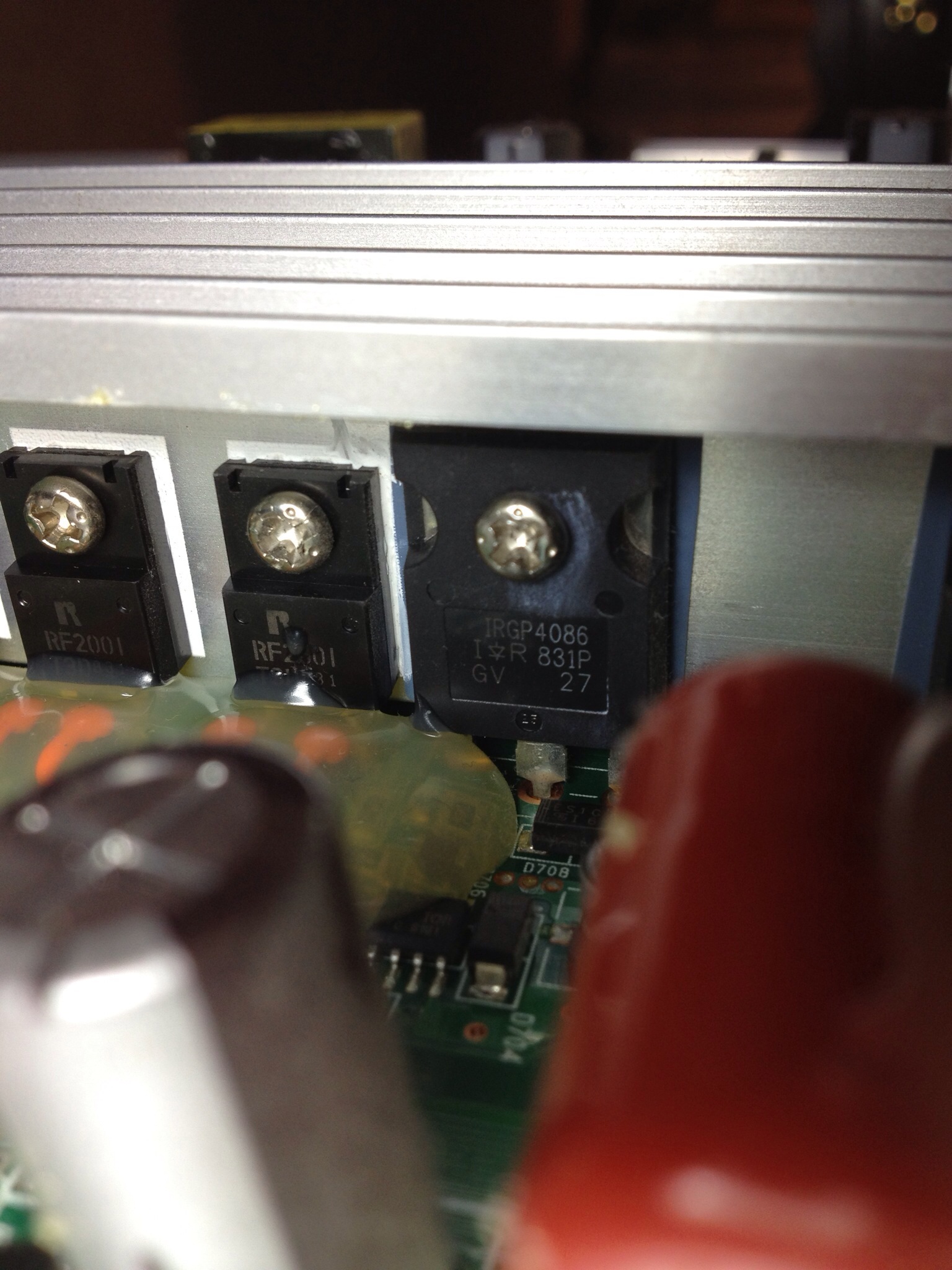

              Also Q772 on the Y-sus looks suspicious. It appears there is some heat or flash discoloration around the screw..

                Replaced the upper buffer board (was reading less than 13 ohms). Now I am getting consistent sound with no picture, but the unit is more stable and does not cut out after 5 minutes. Need to go back and review the main PS voltages.
