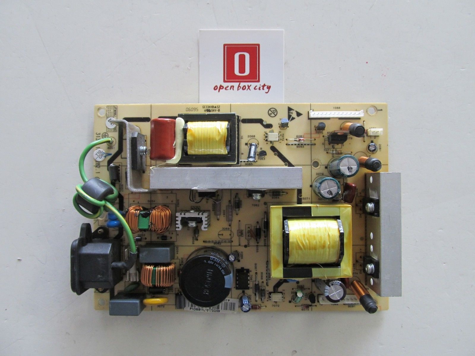

    32MF231D/37 pulsing 24V under load, backlight flashing
    does anyone have a service manual for this guy? 32MF231D/37 found a parts list from elektrotanya but need to see the schematic for the power supply. no load its fine right at 24V. under load of the inverters its pulsing all over and flashing the screen then shuts off. can hear a buzzing from the transformer on the power supply. replaced the power supply already but it was an ebay item. doing the same thing

    Inverter , power supply board P/N? BN44-XXXXXX?

      Re: 32MF231D/37 pulsing 24V under load, backlight flashing
      Pn# 313815866811

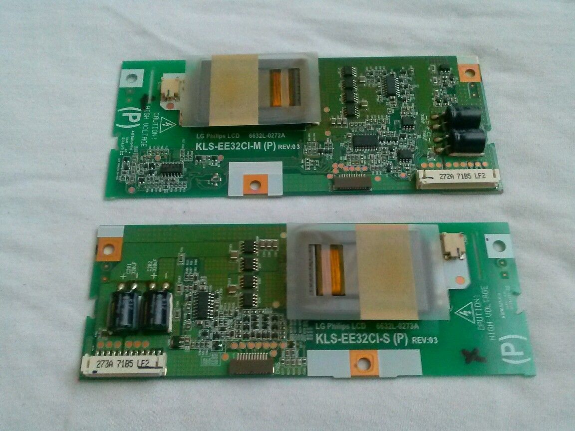

        inveter pn # 996510005766
          There are four SMD MOSFETs (8-pin) on each inverter board. Can you read the P/N to get the pinout to check the Source and Drain pins for shorts?
