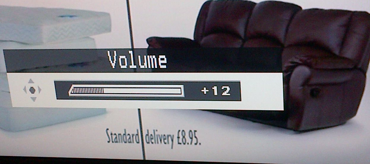

    I've aquired a polaroid TLU-03223B was faulty.
    Repaired the PSU (Bad Caps) on 5v stby
    However it also has a problem with the volume (see attached)
    the max volume i can set it to is 12 bar.
    same on all video sorces.
    Looking for a mean of implementing a factory reset to see if this will cure it
    Can any one help.
    thnx
    E

    i did try the....
    "Polariod *****************************************-
    Hold vol- and chan- or hold vol+ and chan+ (tv is on)"
    But no Joy
