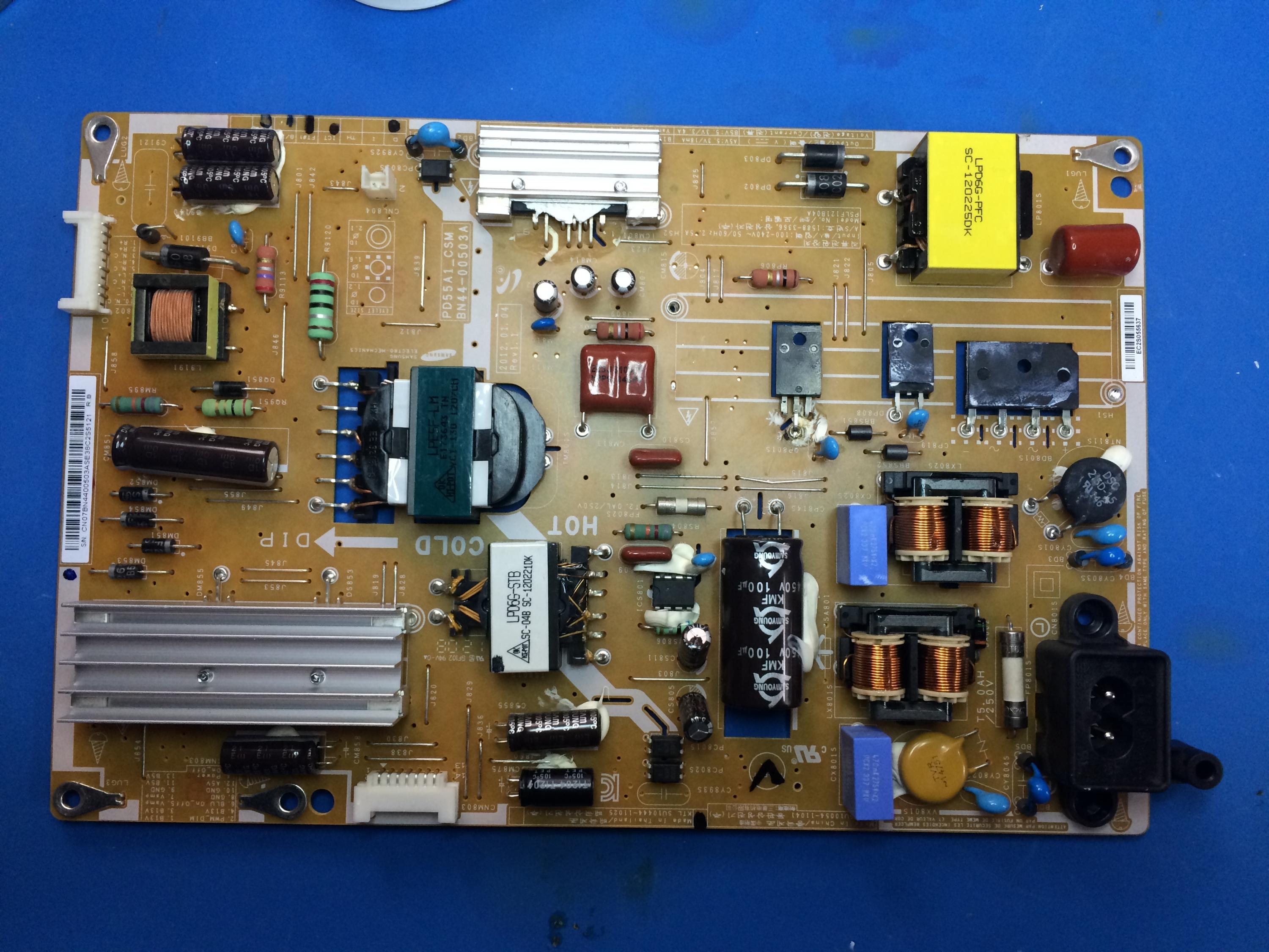

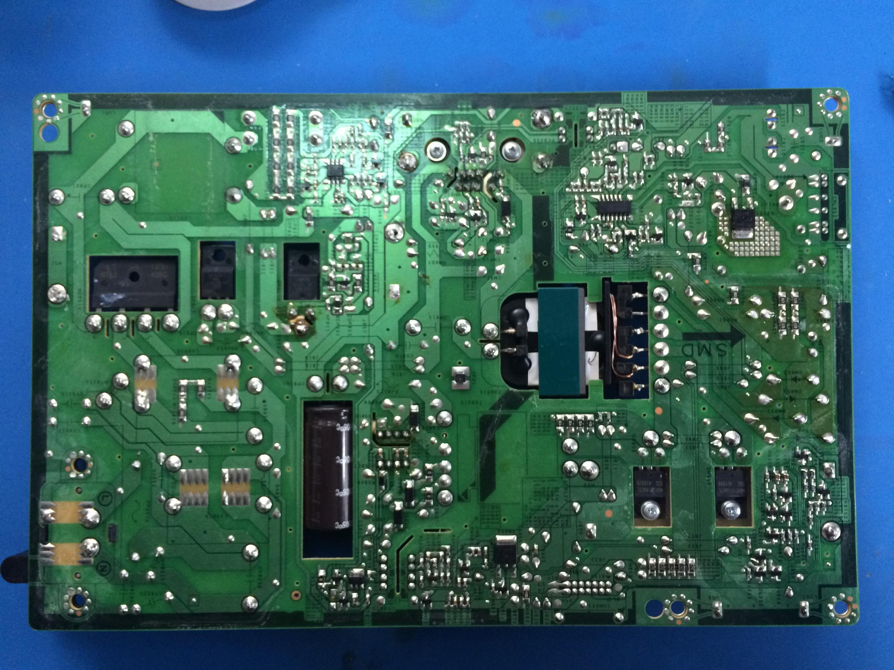

            Have you guys experience a problem with this tv UN55ES6100 (Power board P#: BN44-00503A) where the main AC fluse keeps blowing. I found QP801S (13NM60N) shorted. I replaced QP801S, ICM801 (FSFR1700XCL) and ICS801(D2011K) two times already and fuse, QP801S still blows.
            Any help finding the culprit would be appreciated. Thanks

                UPDATE: Found bad cap location CP819. Replaced and power board working properly again.

                  Good that you fixed the board.
                  BTW.
                  Do you mean high Voltage Cap CP818? which is the snubber cap connected in parallel with the Source and Drain pins of the PFC Power MOSFET QP801S, so if it is shorted out it will cause the fuse to blow, very common failure.
                  The CP819 is the snubber cap connected in parallel with DP808, if the cap is shorted then you will not have PFC Boosted Voltage but will not cause the fuse to blow.
                  http://www.shopjimmy.com/samsung-bn4...led-board.htm#
                    #49
                    Re: Problem with Samsung UN55ES6150F - Wont power up, 10 standby blinks
                    I Though about that. But, yes the defective cap was the CP819. Installed on tv and everything is working.
