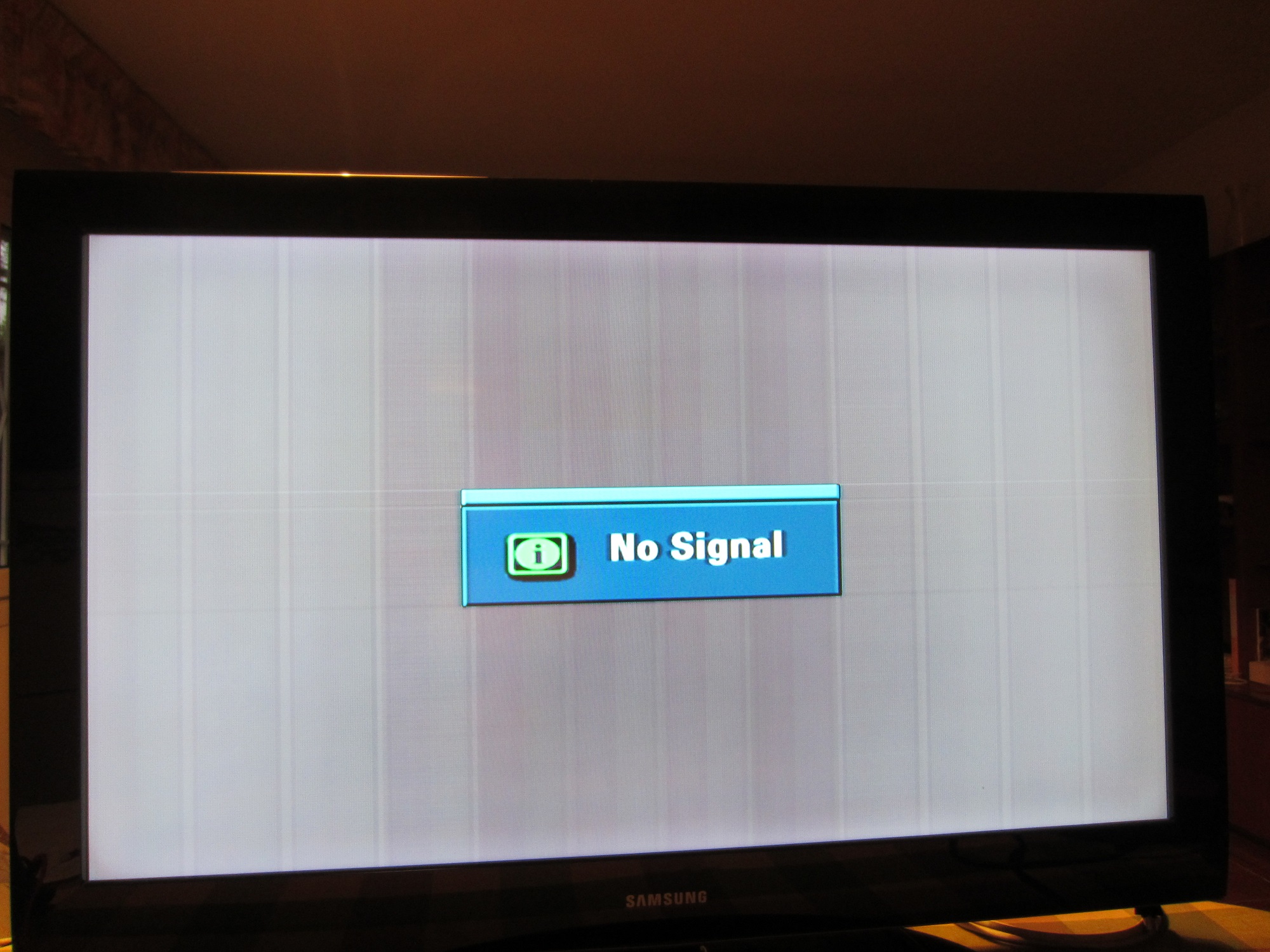

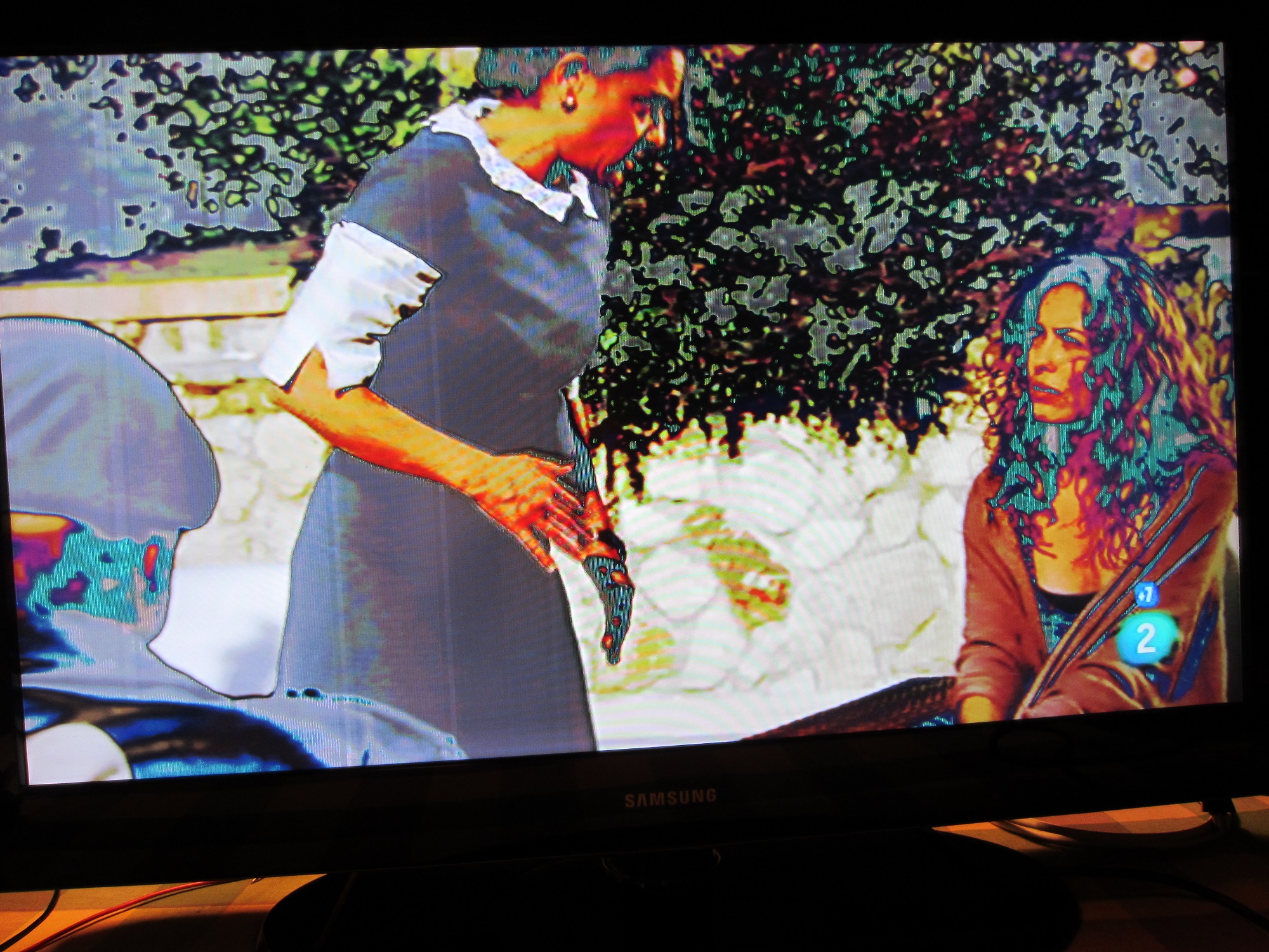

    I have a Samsung LE40A558P3F that has a solarized display. It just happened whilst I was watching over a 2 minute period.
    I read lots on this forum and concluded that the problem was the AS15-F.
    I replaced the little beast, during which I decided that lead free solder is crap!
    However the problem still persists, below are the before and after replacement readings of the gamma voltages.
    Also attached photos of screen with and without aerial plugged in, picture is the same with HDMI inputs.

    I've just replaced one of these, the voltages should go down from pins 1-22. On yours, 7, 8 and 9 are off before and after the AS15-F replacement so that suggests something else has failed on the tcon.
    I'm no expert but it might give you a place to start looking before a more experienced member assists.

      Yes both before and after test are bad. there are a lot of bad AS15-F chips about from sellers on Ebay and China,and if you had to play with it to get it fitted they will not take much heat before they are damaged, I would try fitting a second replacement before anything else Flocko

        Thanks for the replies, I see what you mean with the dip in voltage, but as it applies to both chips the as mentioned by "diif" I suspect the fault is elsewhere, obviously the question is where?
          Re: Samsung LE40A558P3F new AS15-F did not cure Solarized picture
          No, it more than likely is a bad AS15-F. We've seen it before, most likely it's a coincidence the failure occurred in two similar places.

                          Whilst waiting for delivery of the new AS15-F chips to arrive I decided to remove the one I had fitted. After removal I noticed that some bridges between the pads. I cleaned up the area and applied "real" solder to the pads, which looked much neater.
                          Thought I would just have a go at re-soldering the chip I had just removed, I needed the practice.
                          End result TV works perfectly.
