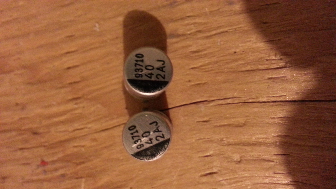

    Can anyone tell me the specs on these caps ? 40uf ?? volts ? Are they called solid aluminum ?
    They are from the address board (E Buffer) from a Samsung plasma I'm working on and were sheared off cleanly when the main board bracket fell from its perch. Thanks

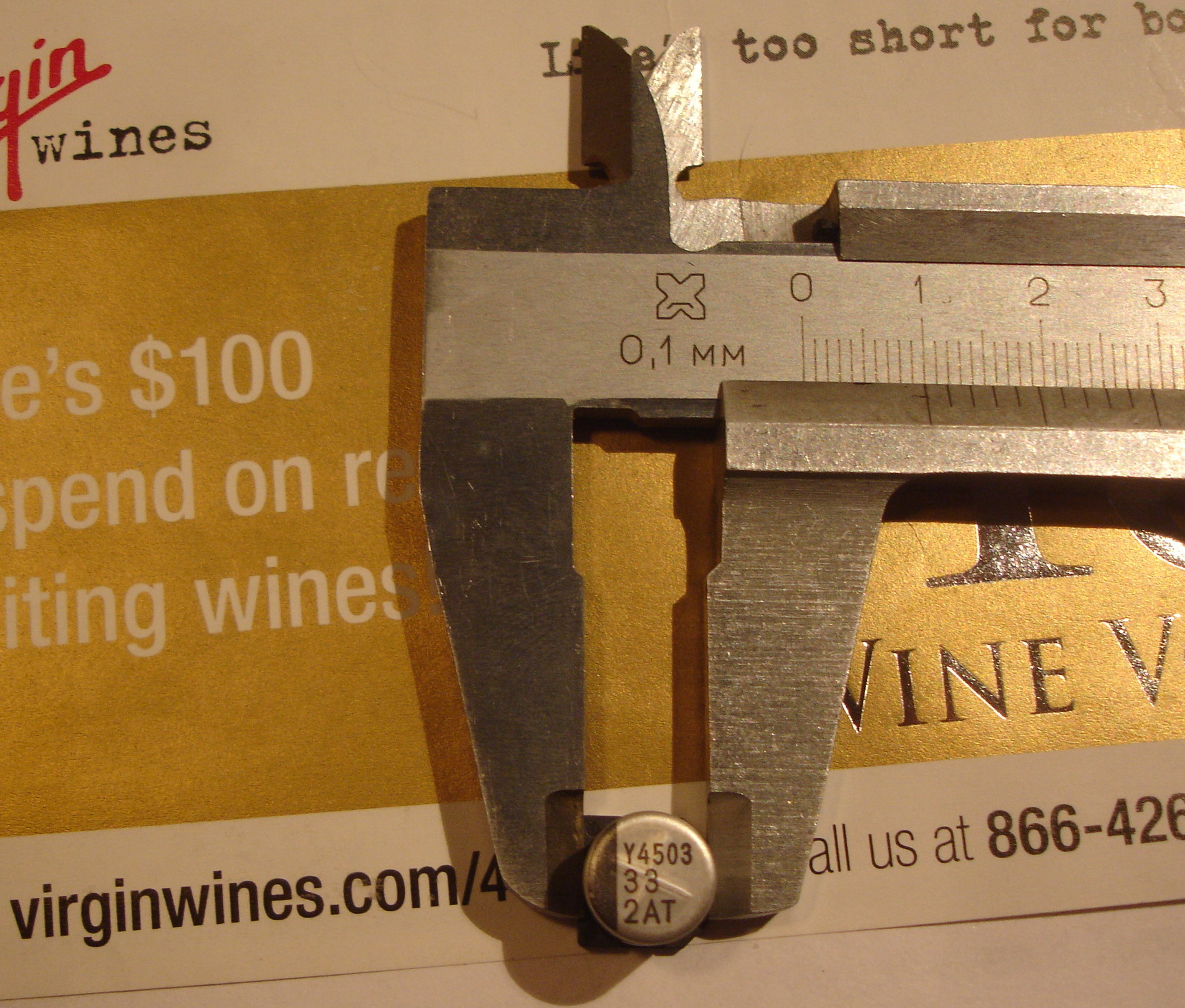

    Re: Capacitor Indentification Help
    What are the dimensions of the capacitors
    • mmartell
      • Oct 2013
      • 3189
      About 10x10mm
        They are a polymer electrolytic type. Do you have a capacitance meter? Unfortunately different manufacturers have their own codes. It's not always easy.
        • mmartell
          • Oct 2013
          • 3189
          I thought the capacitance was as marked (40uf) but will check with a meter. As to the voltage would it be advisable to put a meter across the pads to read the operating voltage ?
            Are you sure? The vent marks on top seem to suggest otherwise.

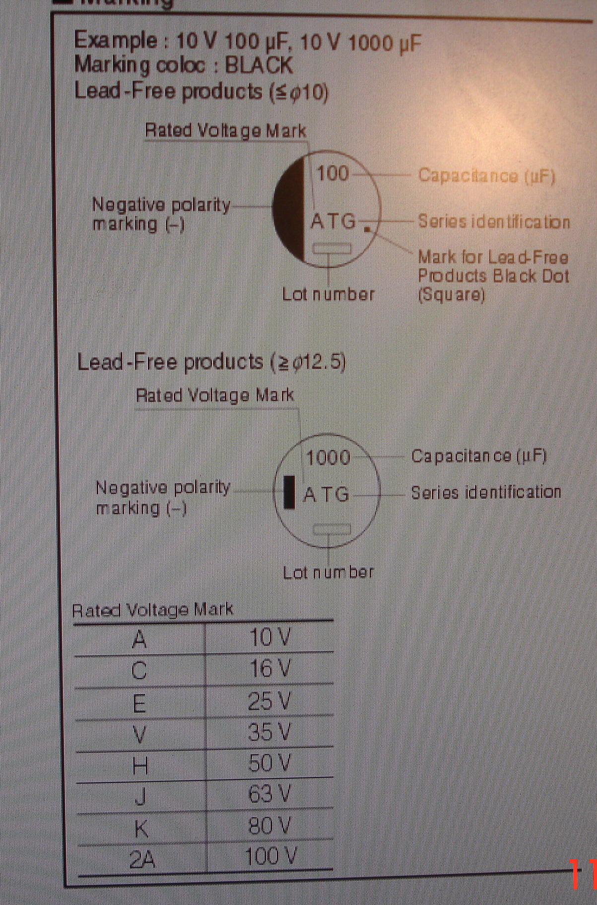

              These cap probably 40uf 100V. In such a board I have is cap 33uf 100v
