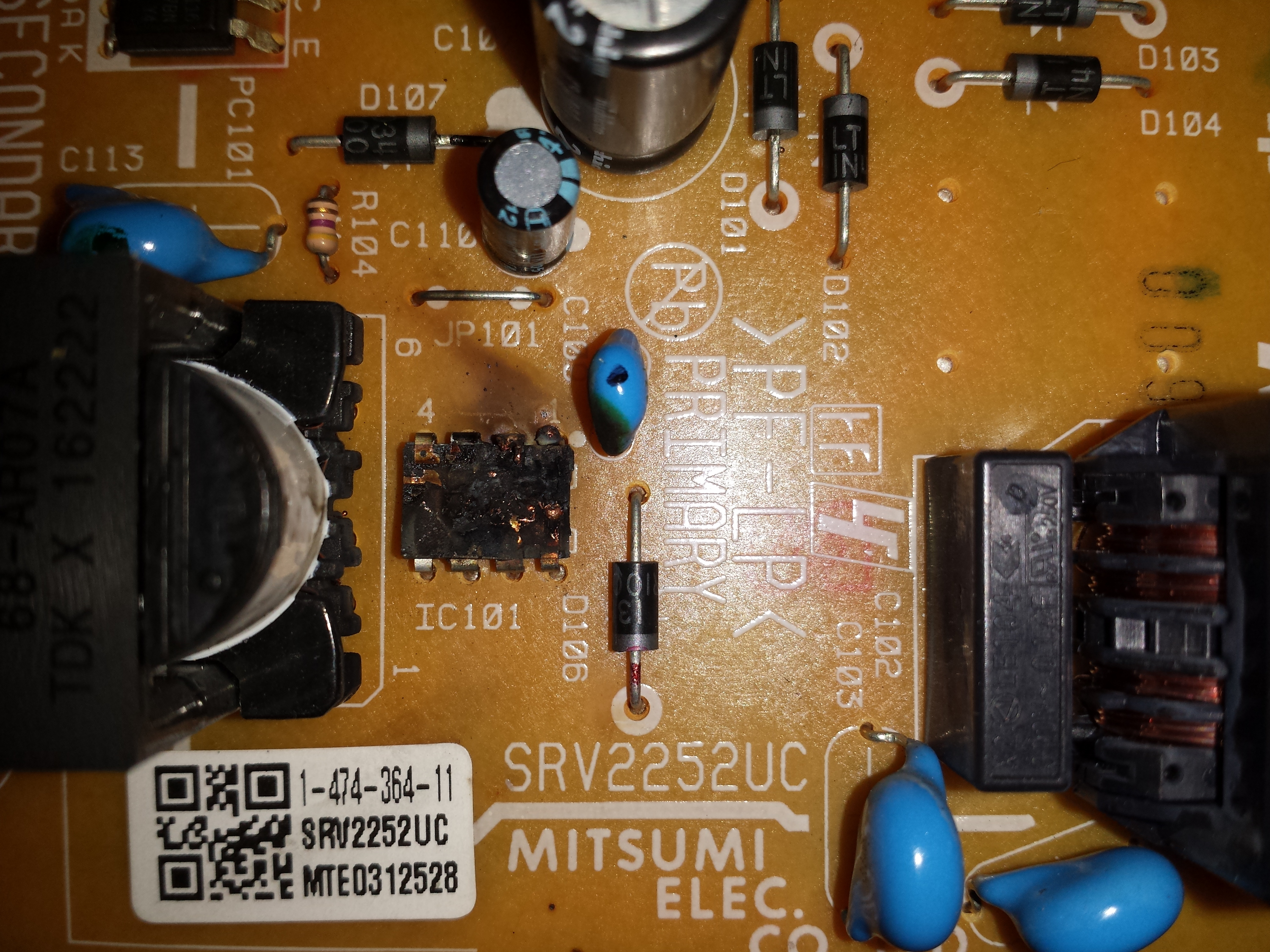

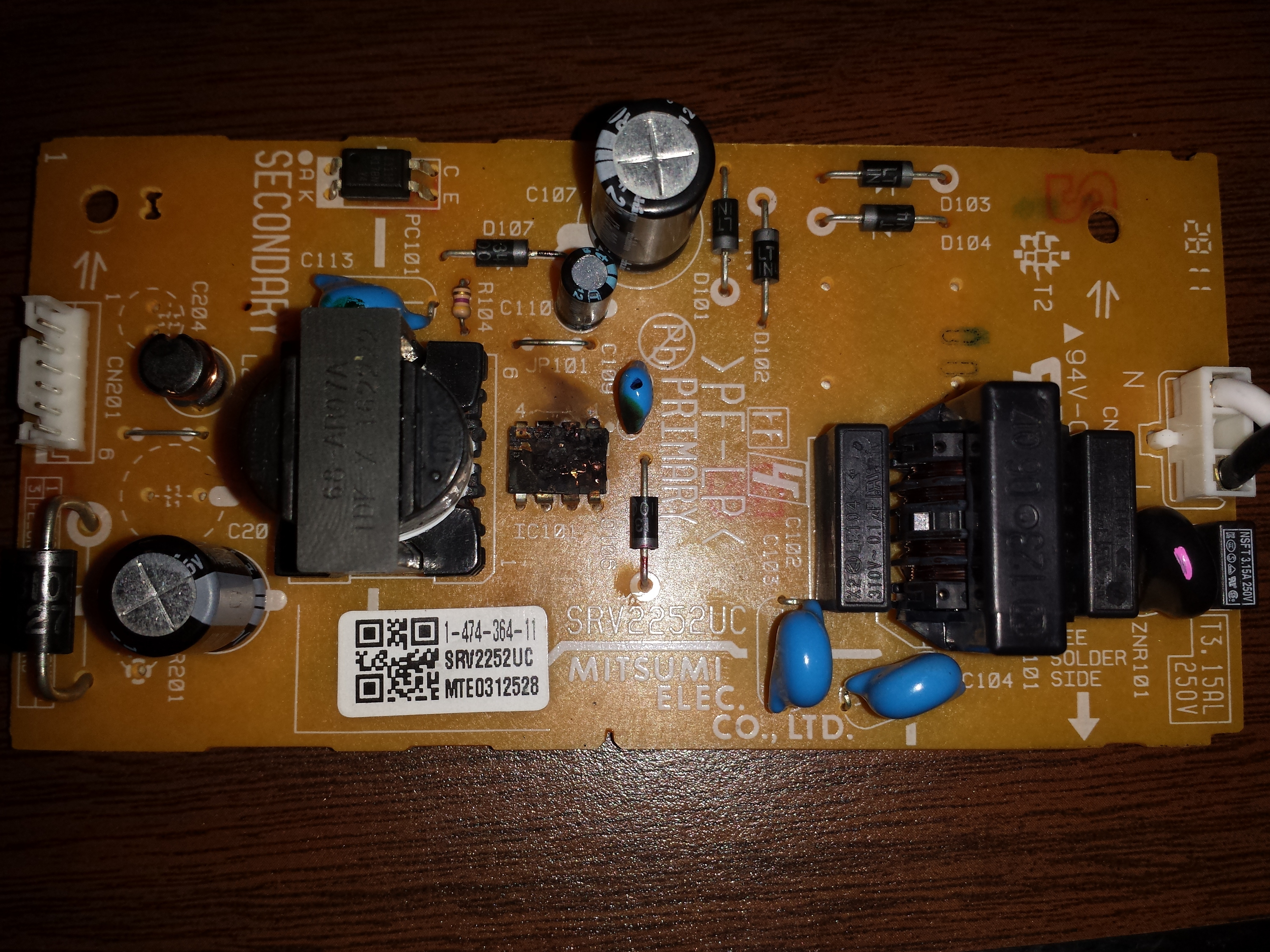

    Power supply in my blu-ray player has an IC that litterally got blown open (supposedly from last lightning storm)
    Model is a Sony BDP-S185.
    Powersupply board has the model # SRV2252UC
    I've got the service manual and I still cant wrap my head around it, but there is no schematic on the powersupply board what-so-ever. I've even talked with someone at sony and they left me on hold off and on for some time and finally told me that the part is not replaceable that you have to buy the power supply and they wanted +$100 for it.
    There are about 2 pictures ive found online of it, but not good enough to read the chip.
    I've found the board online for around $40. it's an old blu ray player... Regardless, I hate seeing the one obviously bad chip and thinking it's a few dollars...
    Anyway, here it is. IC101

    May be one of VIPER22 series, need to trace out the bottom side of the board to see how all the pins are connected.

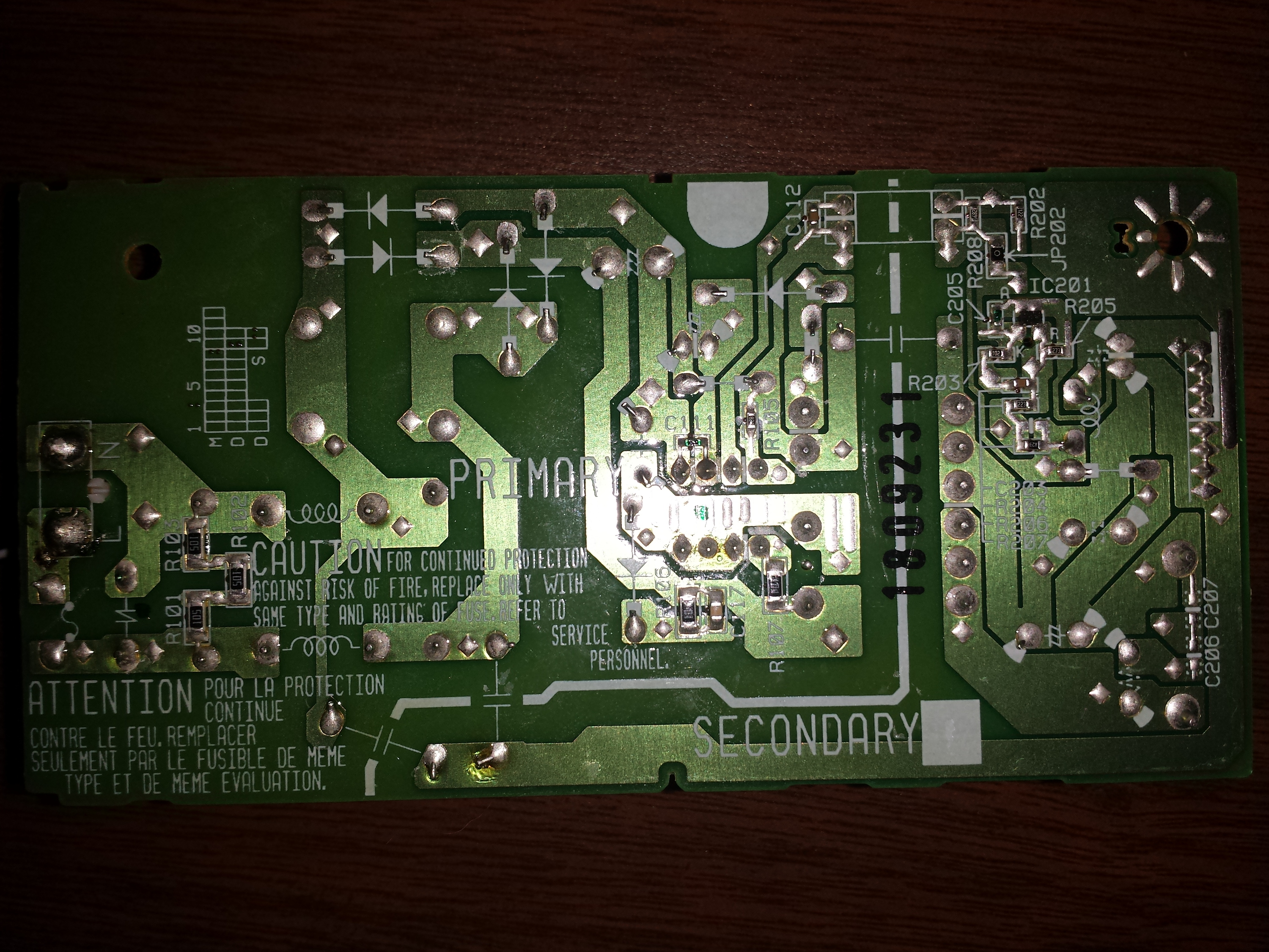

      I am all up for tracing out some pins, my on-going repair with my TV that you helped me with taught me alot, I feel like with this I could learn alot more. Im going to go ahead and post a picture of the trace side of the board.

        Here's the back. Looks like pins 6,7,8 all are on a common solder trace.
          Re: Anyone dare to try to identify this part?
          So far I cannot find any IC in my library that matches the pin out of your IC yet.
          Base on the connection on the bottom side:
          pin 1 is Ground (Source)
          pin 2 is the VCC which gets the voltage from Diode D107 and the startup cap C110.
          pin 3 is the FB from the opto for regulation
          pin 4 ?? there is a resistor R105 (SMD) to ground
          pin 5 ?? there is a resistor R107 SMD to the B+
          PIN 6, 7, 8 are Drain
          D106, R106 (SMD), C117 (SMD) are the RCD snubber network, the small blue disk cap C10? connected between S (pin 1) and D (pin 6~8) is the snubber cap.

                            The power supply module is made by the third party (MITSUMI) so it does not have the diagram in the service manual.

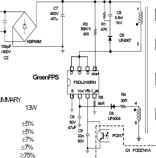

                              May be FSDL0165
                                FSDL0165 seems to match the pinout I traced out, good find KASFAMILY.
