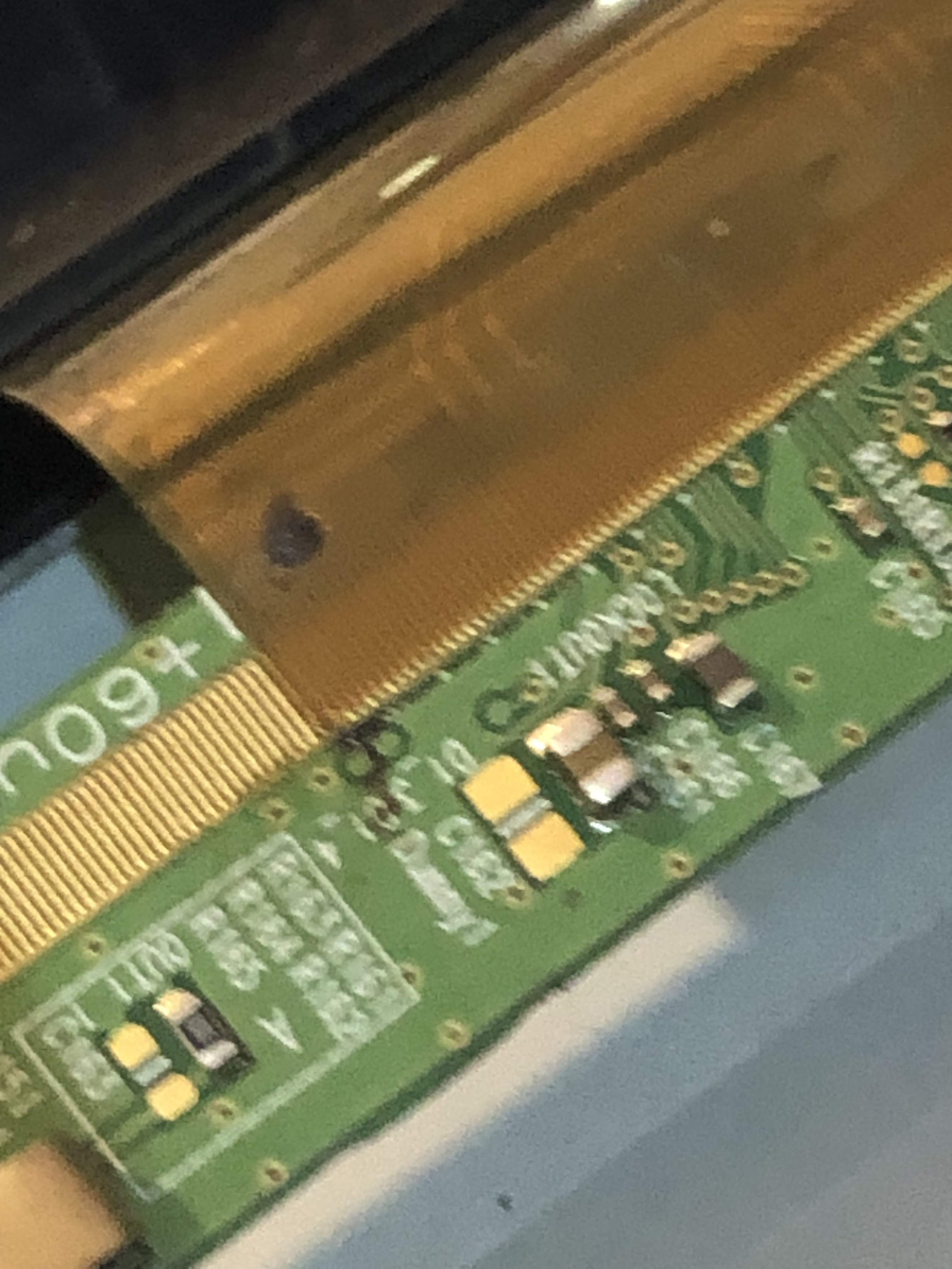

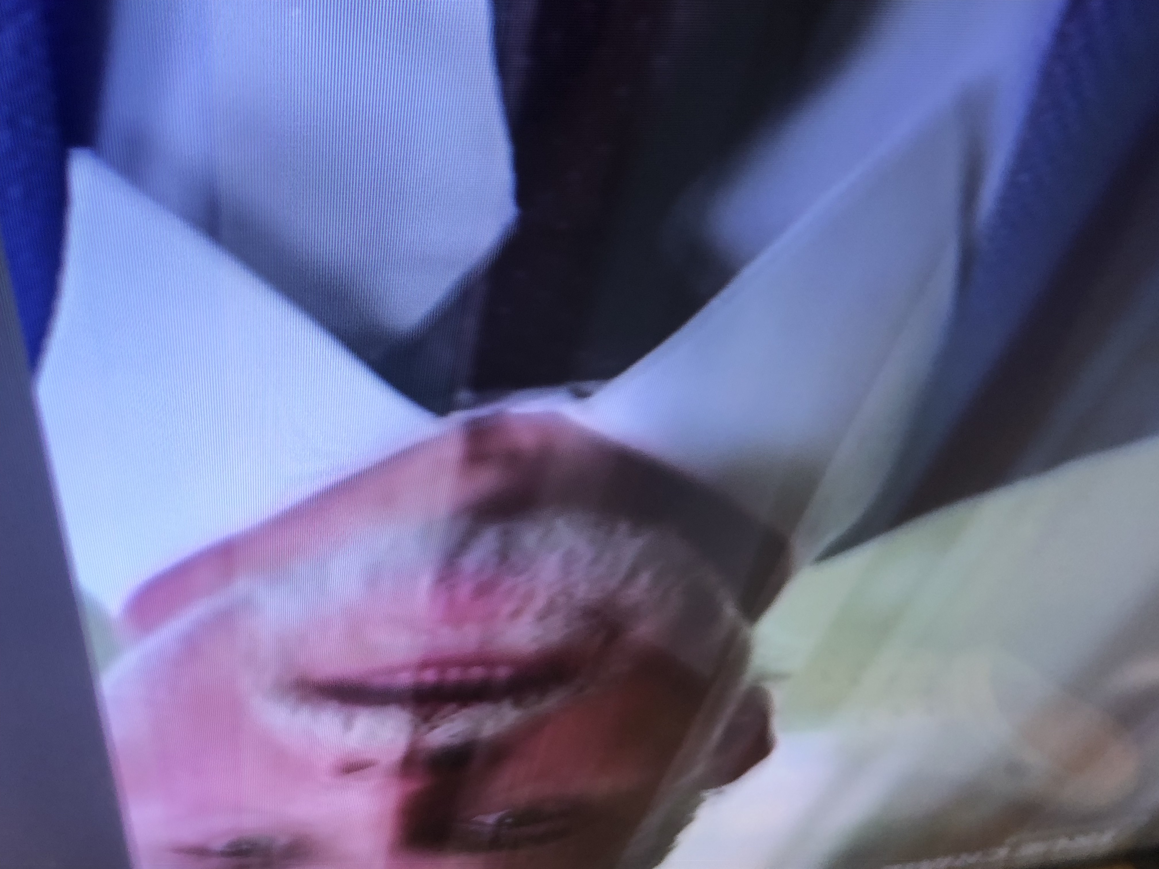

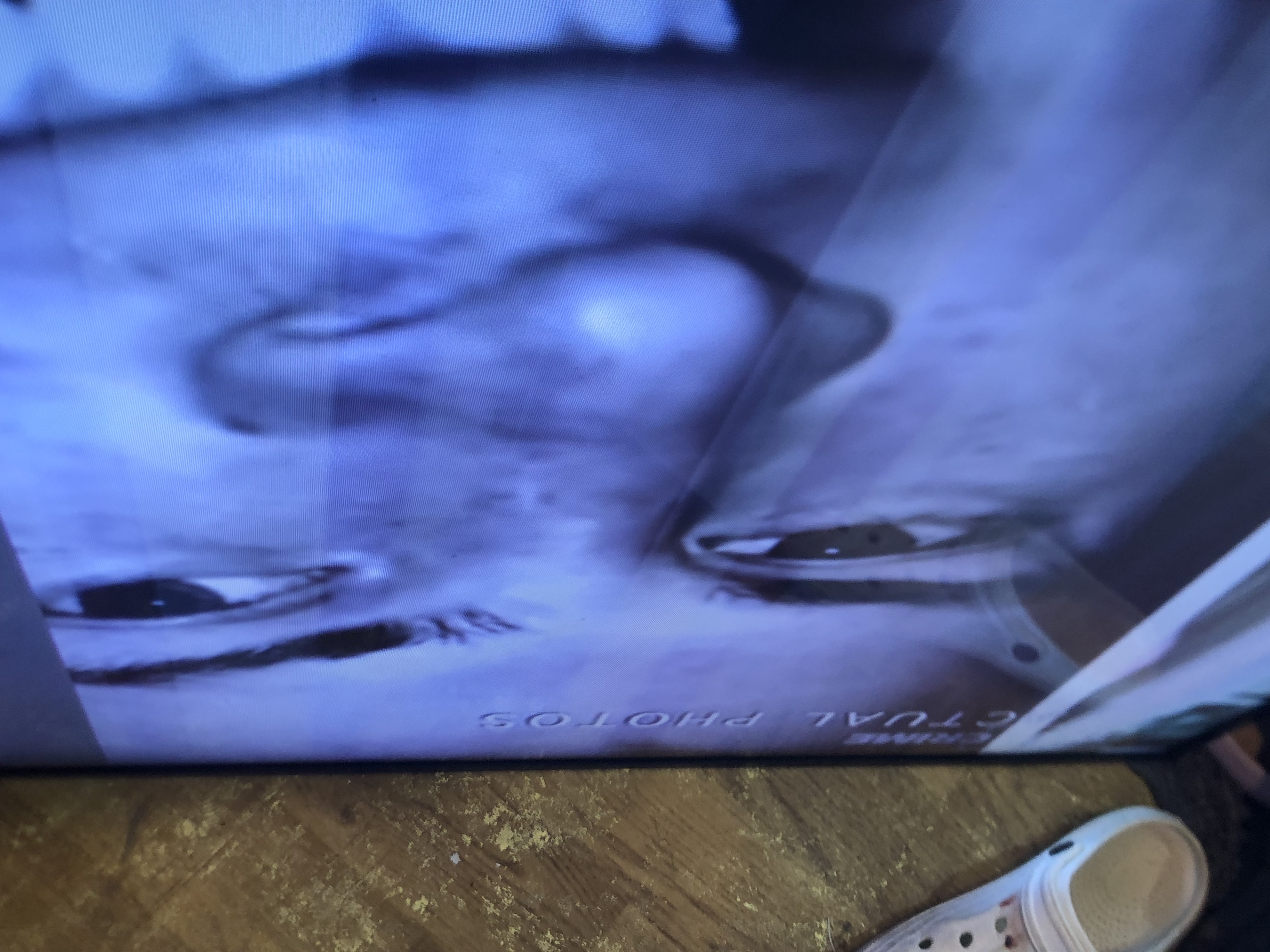

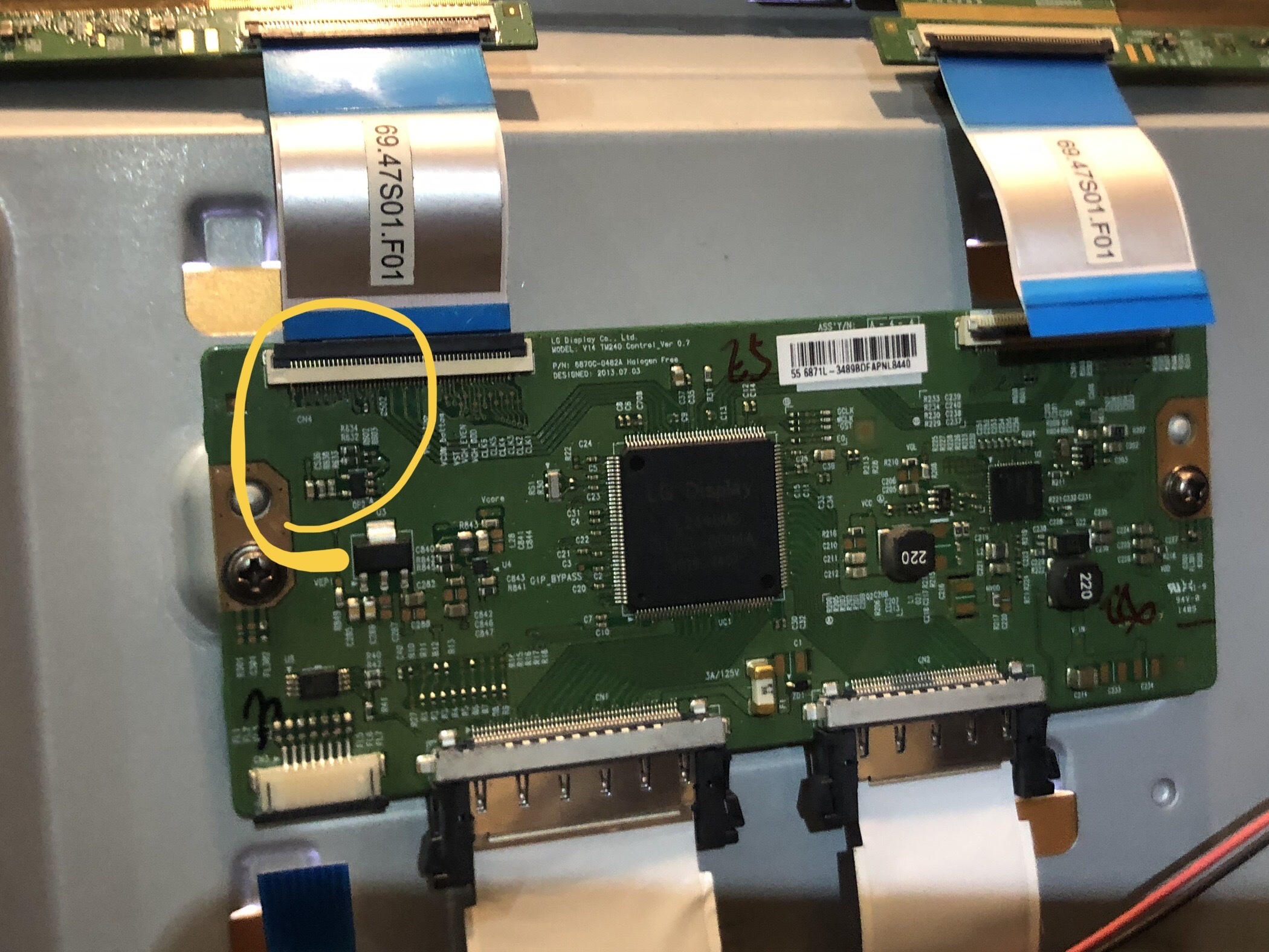

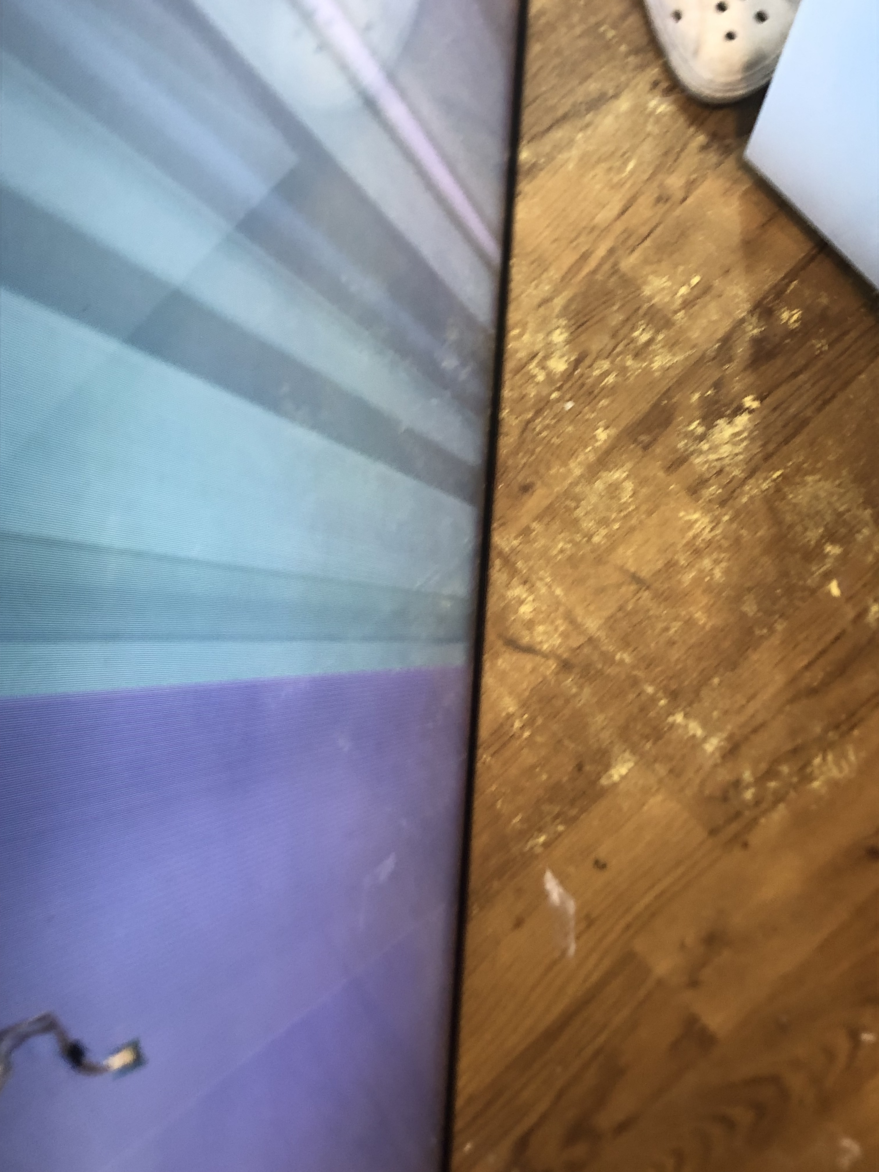

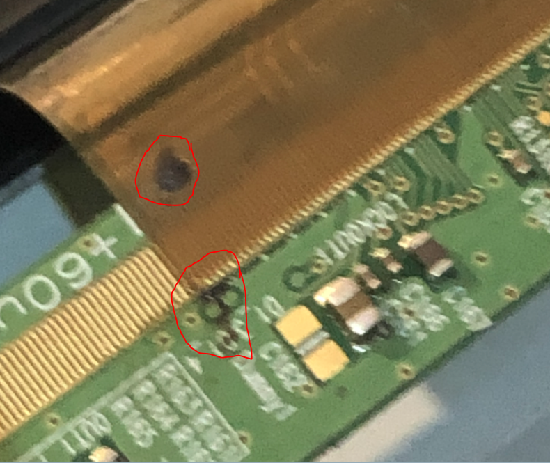

        I bought a universal remote & I got the tv working but when putting it back together I’ve managed to undo my good work, I think I’ve burned out a coff , is there anything I can do to fix this? I’ve marked the tcon board in yellow, when I touch the tcon in the yellow part Click image for larger version

ID:	3733714 I get a picture

          What are those dark spots on the cable? Carefully inspect the contact pads on the cables with a magnifying glass to make sure they're not damaged.

            Yeah they are burnt, is there anything that I can do to get around this?

              I probably used the wrong name for them, I thought they were called cofs
                It's strange, how could this happen? Something short-circuited. If it's a burnout, then it can't be repaired, only replaced with a new COF (Chip on Film), but this can't be done at home; you need specialized equipment.

                  No way, I think it was either the remote receiver board or the standby light board, I was putting it back together & I think one of those might have circuited it as they were lose when I was moving the tv , well it looks like I’ve repaired & broken another tv whilst putting it back together, usually it’s the screen that gets broken 🤬🤬
