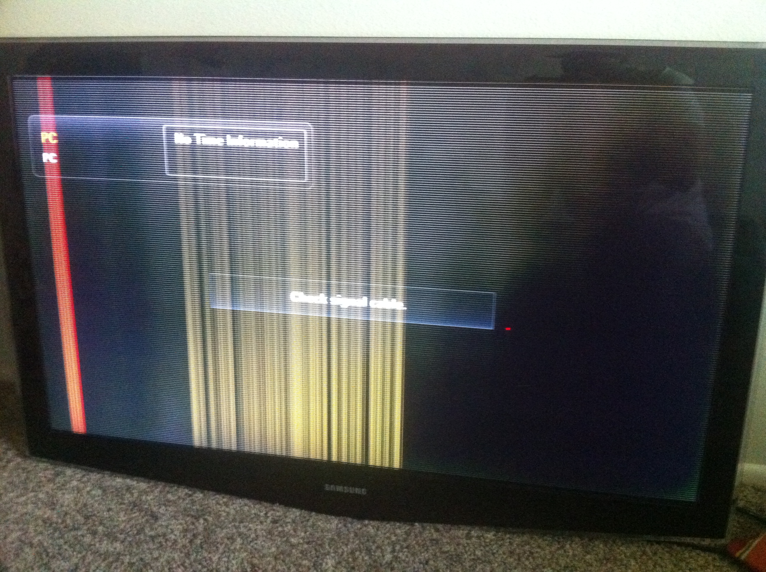

    Samsung TV with colored vertical lines and black horizontal lines.

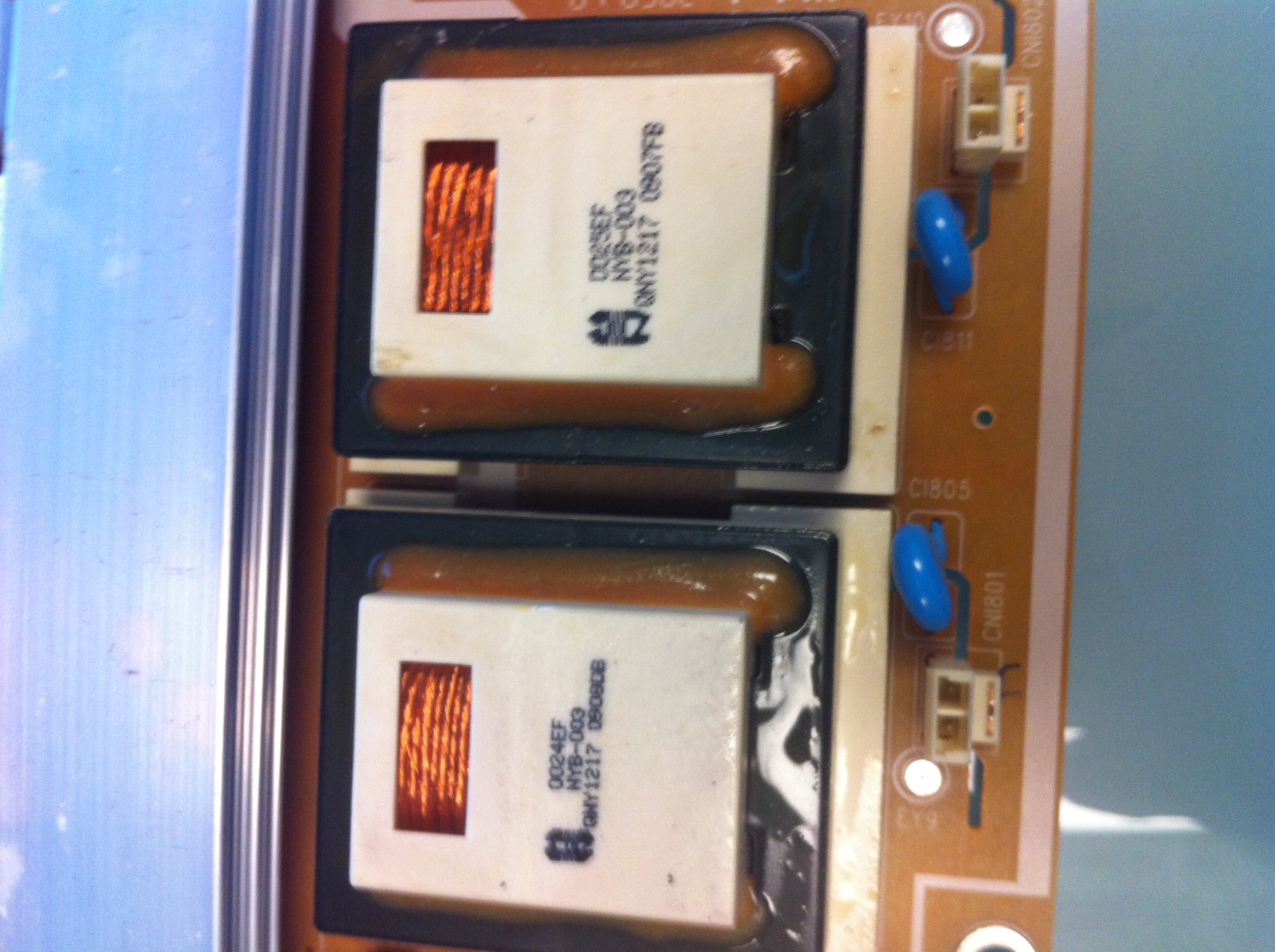

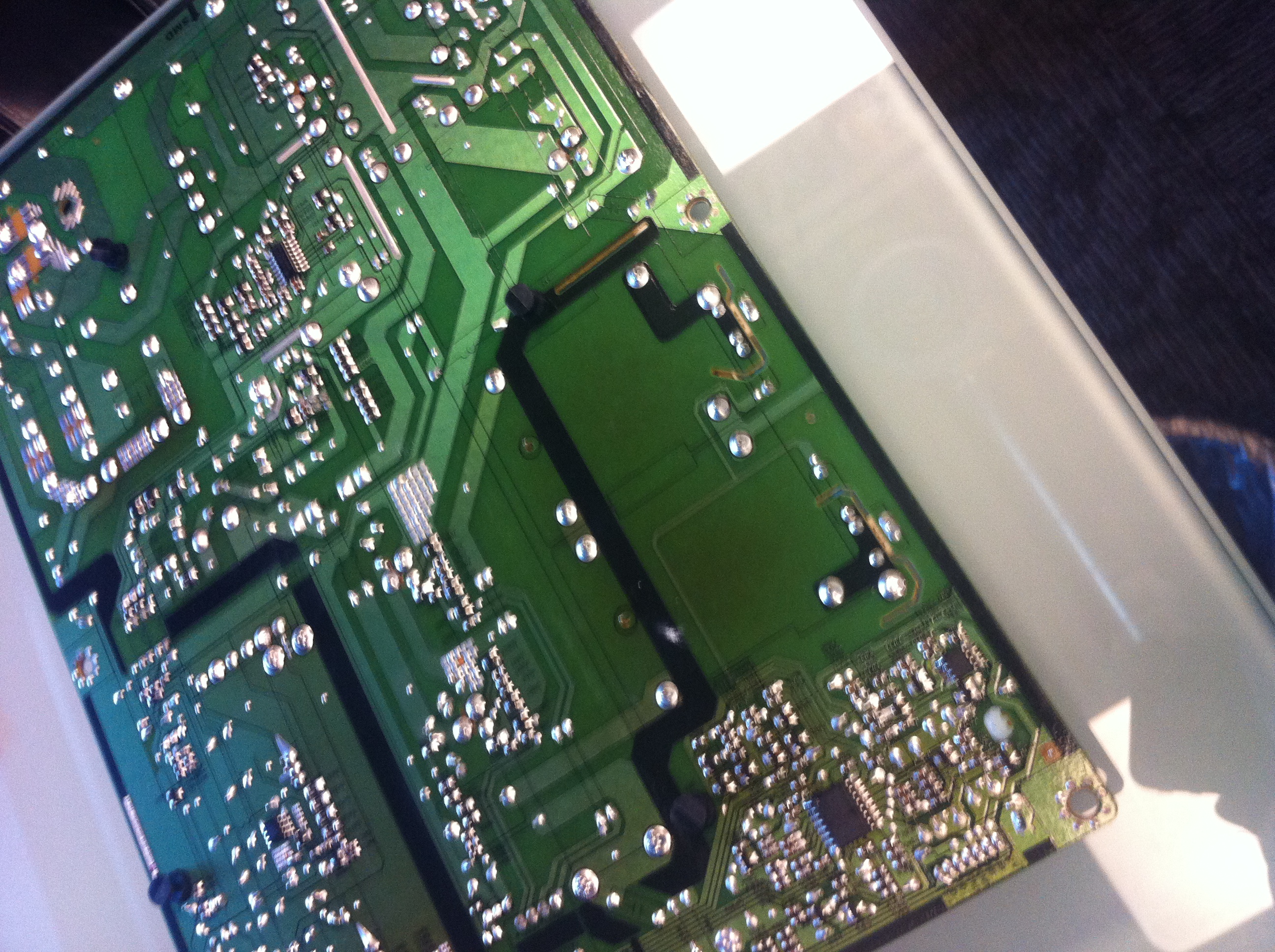

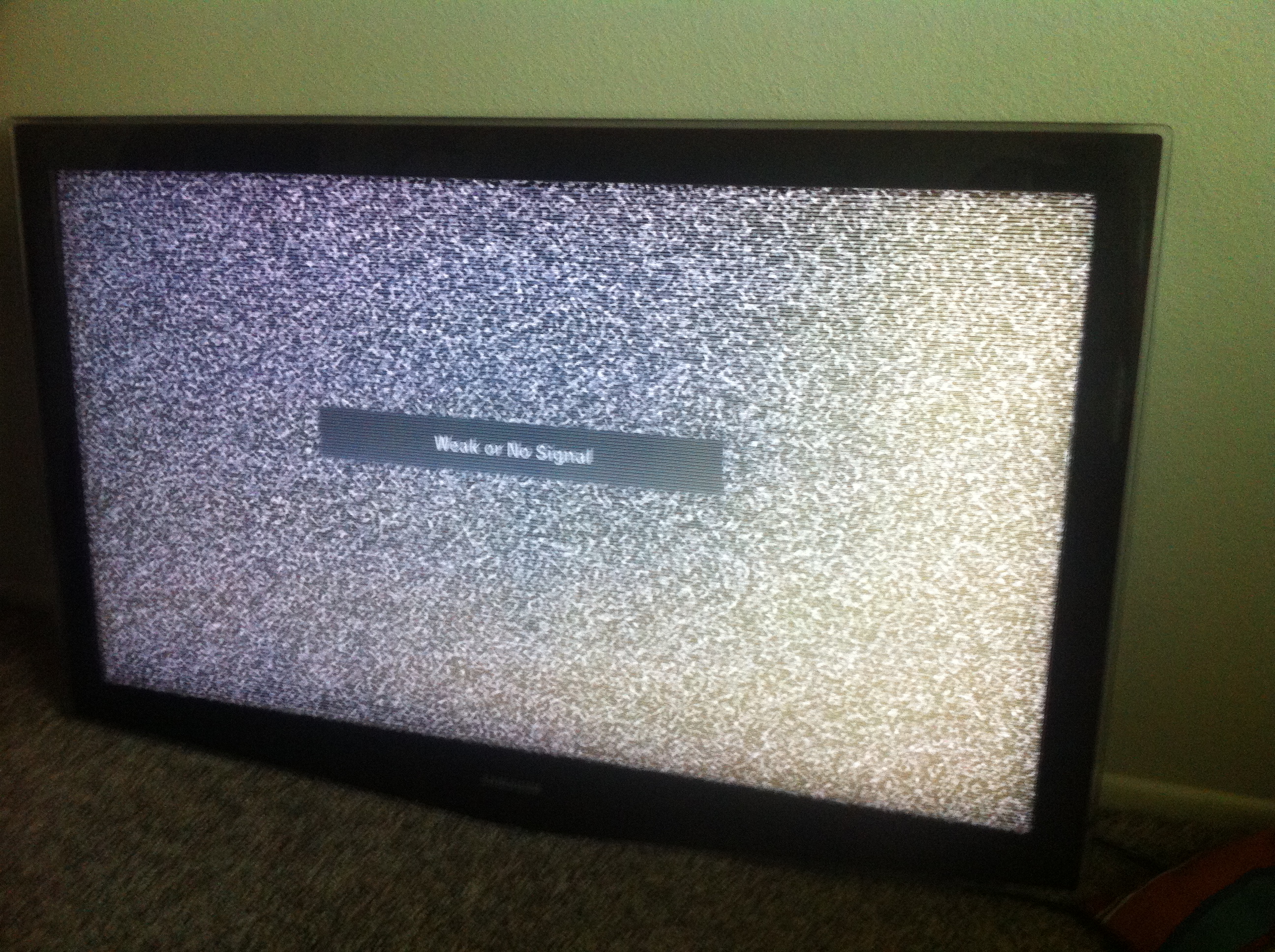

    Hey guys, I have seen a few posts with similar issues already, but none seem to come to a definite conclusion of the issue. When it is first powered up there are just the horizontal lines, then over the space of about 30 seconds the red and yellow lines appear. I have tried replacing a few caps and re-seating all of the cables\ jiggling them around to see if i get a picture back, all to no avail. The Power supply board seems to have a few faint burn marks on the back and lets off a slight buzzing sound when powered on. I am still able to play games just fine on the screen and the sound is working properly. My next step was going to be to replace to Power supply to see if that helps. Any advice would be much appreciated. Thank you in advance!
    PS, The lines are only vertical and horizontal, the swoops are just because of the camera. And the last picture are the pieces directly above the burn marks.
    Re: Samsung TV with colored vertical lines and black horizontal lines.
    Sorry but to me this looks like a bad LCD panel which would not be fixable. It is extremely common with Samsung conventional LCD and LED-backlit LCD TVs.
