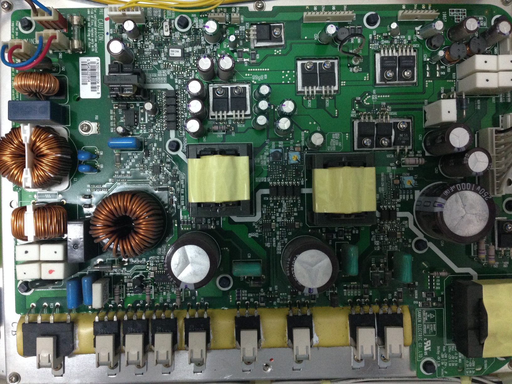

    hi all I need help

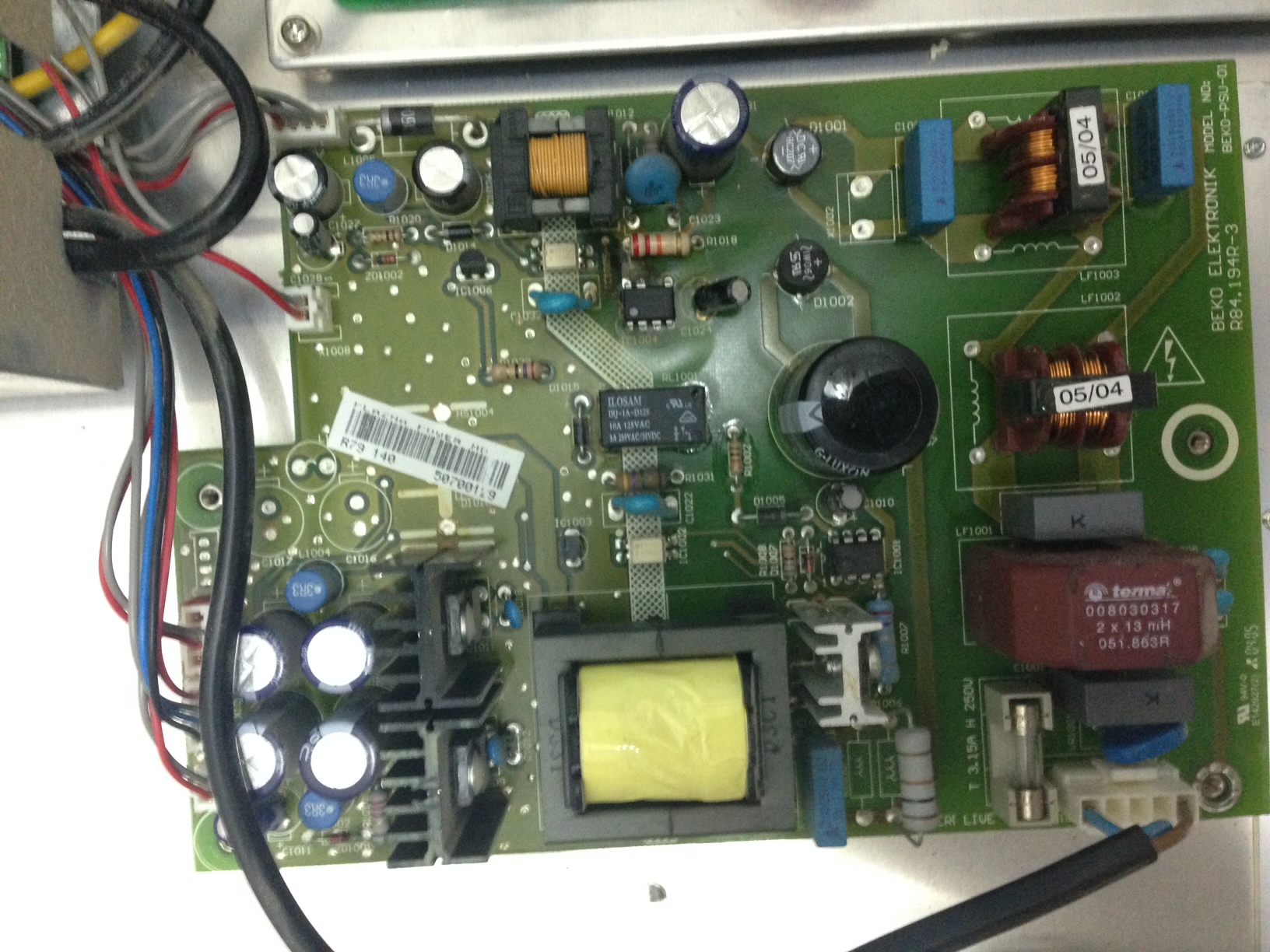

    I replace fsd200 and diode bridge and 2.2k ohm
    You will see a small fire on the side.
    the plasma is blinking no green led
    Re: grundig 42 pw 110-5510 blink
    this is the pic
    vs is ok
    va is ok
    5sb is ok

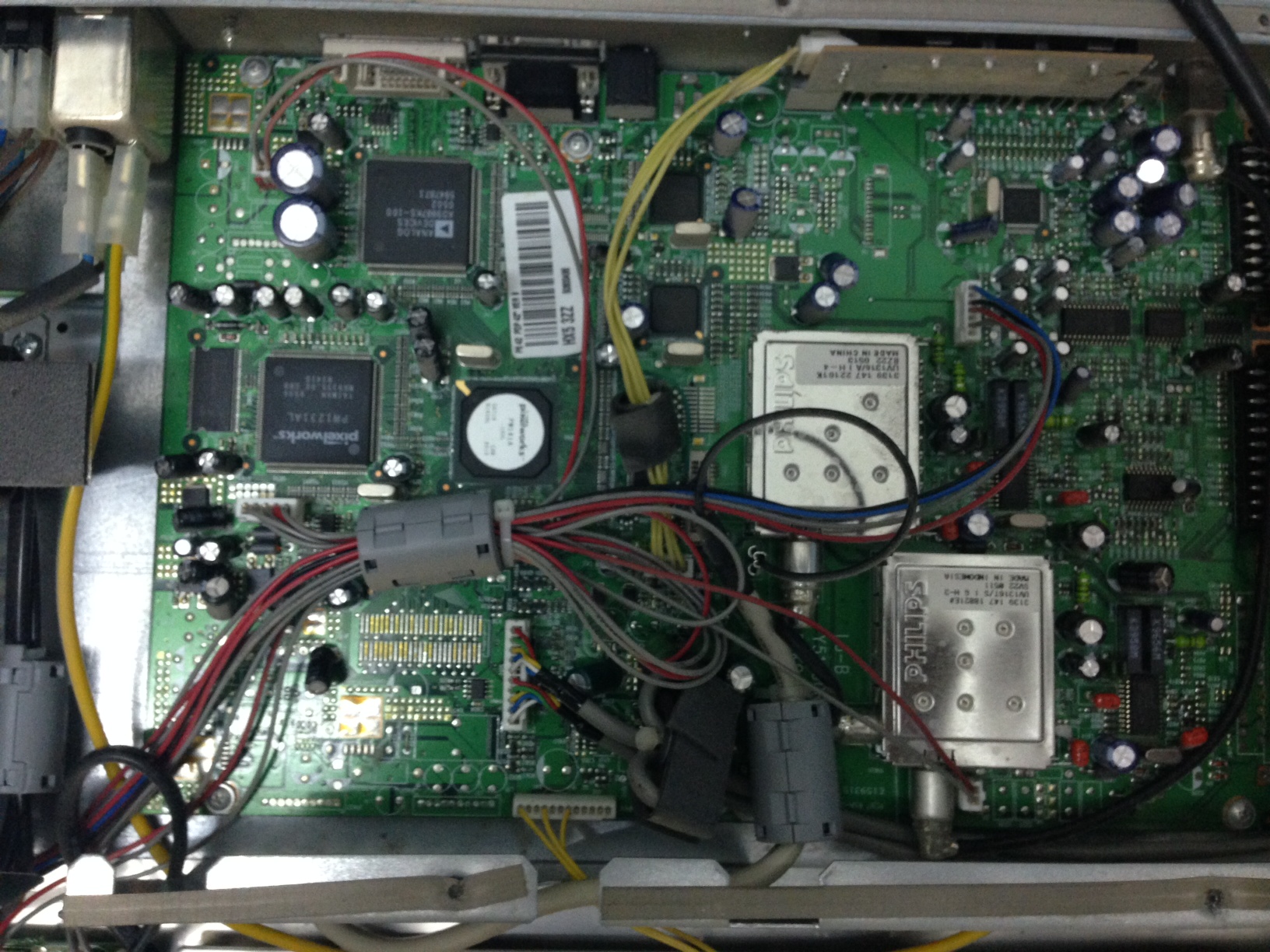

    all the voltage is fine so I think it is the video board .
