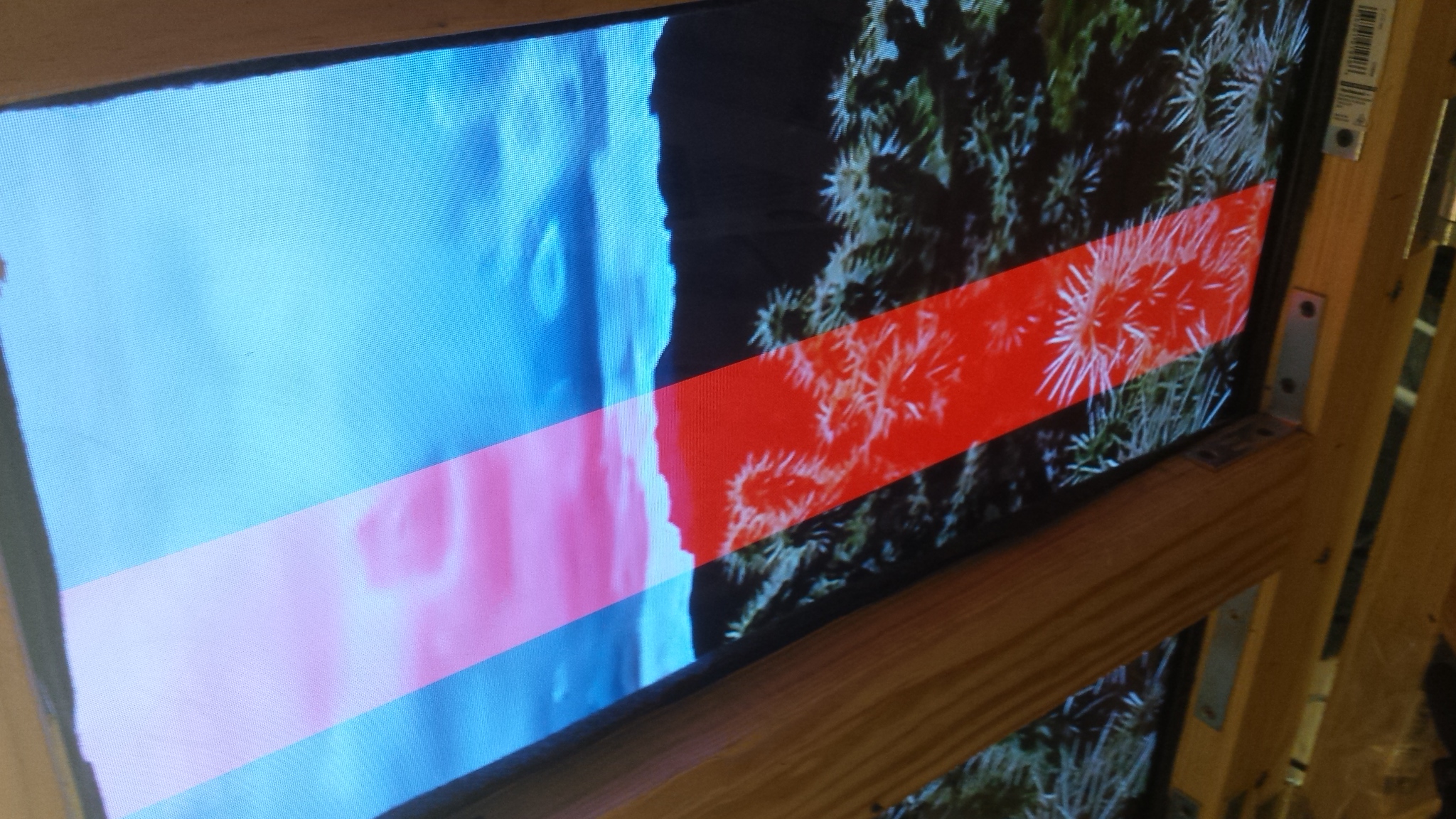

    LG 60 45 Red Vertical Stripe from Water Damage

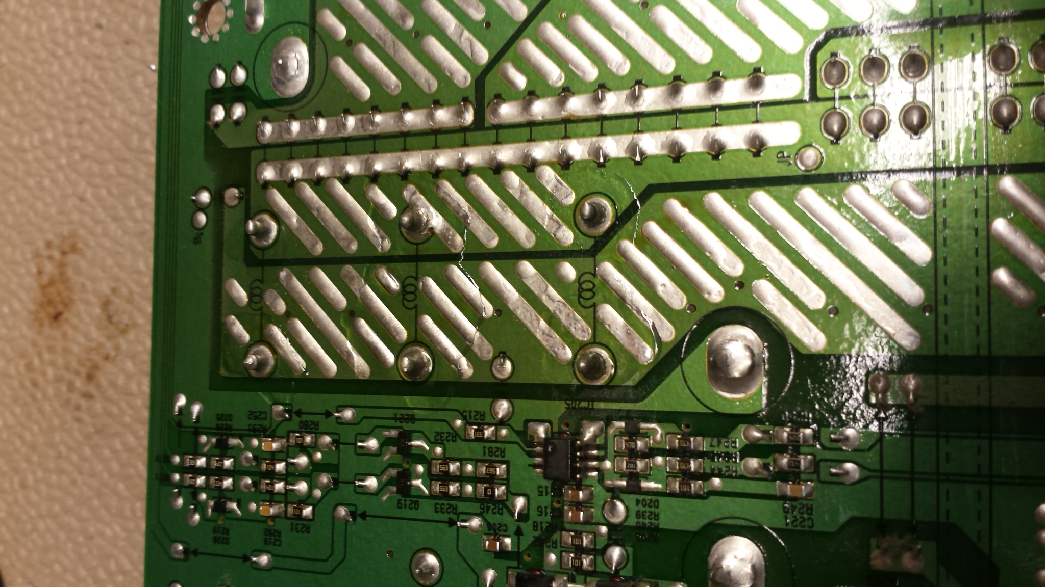

    Set had water drip into set. It works but has a Red Vertical Stripe from top to bottom of screen. I don't see any water damage or burnt boards. Is it the Panel?

    Yes - you need to check the tab bonds on the panel

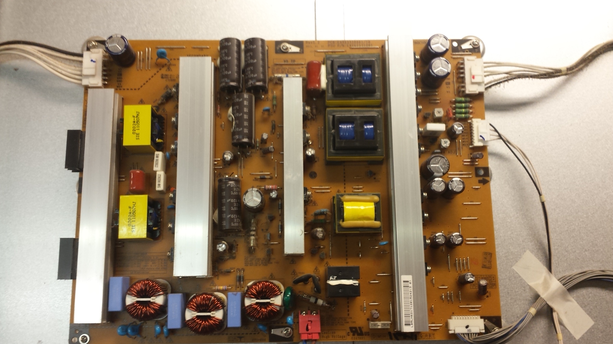

      Re: LG 60 45 Red Vertical Stripe from Water Damage
      I saw no problem with the tab bonds. Found bad solder joint on coils, re soldered them but same problem. Checked Shotkey diodes and mosfets and capacitors

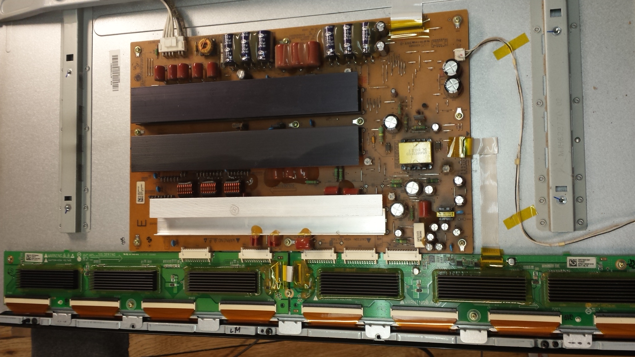

          Check bottom of panel - COF connections must be seated on XL/XC/XR boards. Reseat only with power OFF.
            I repeated them. No apparent damage anywhere.
              Check the ribbons from the control board to XL/XC/XR boards.

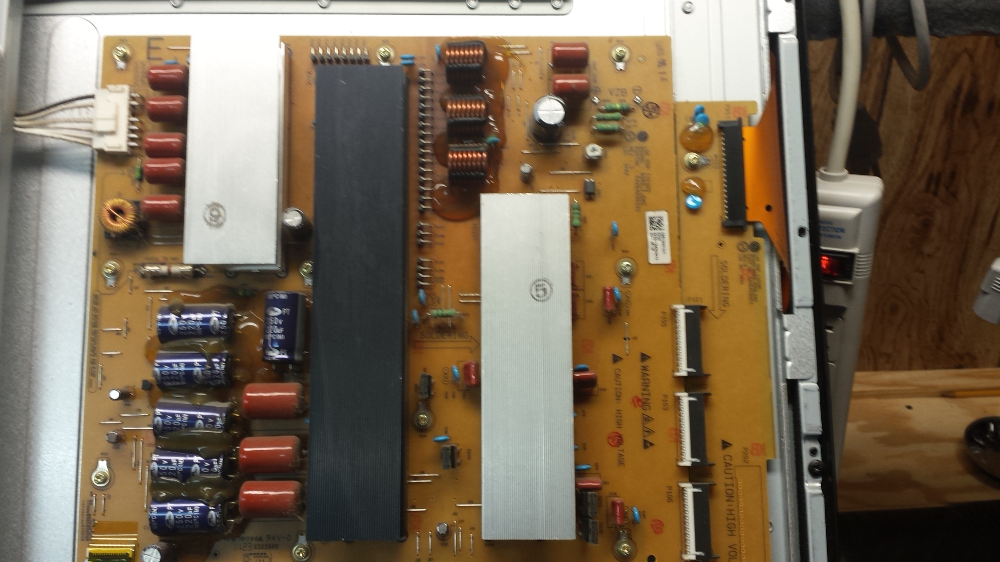

                I repeated all of them. Would the Y-ZUS cause this?
                  No, it can't.
                  I would try, if possible, swapping around some of the control board ribbons going to XL/XC/XR.

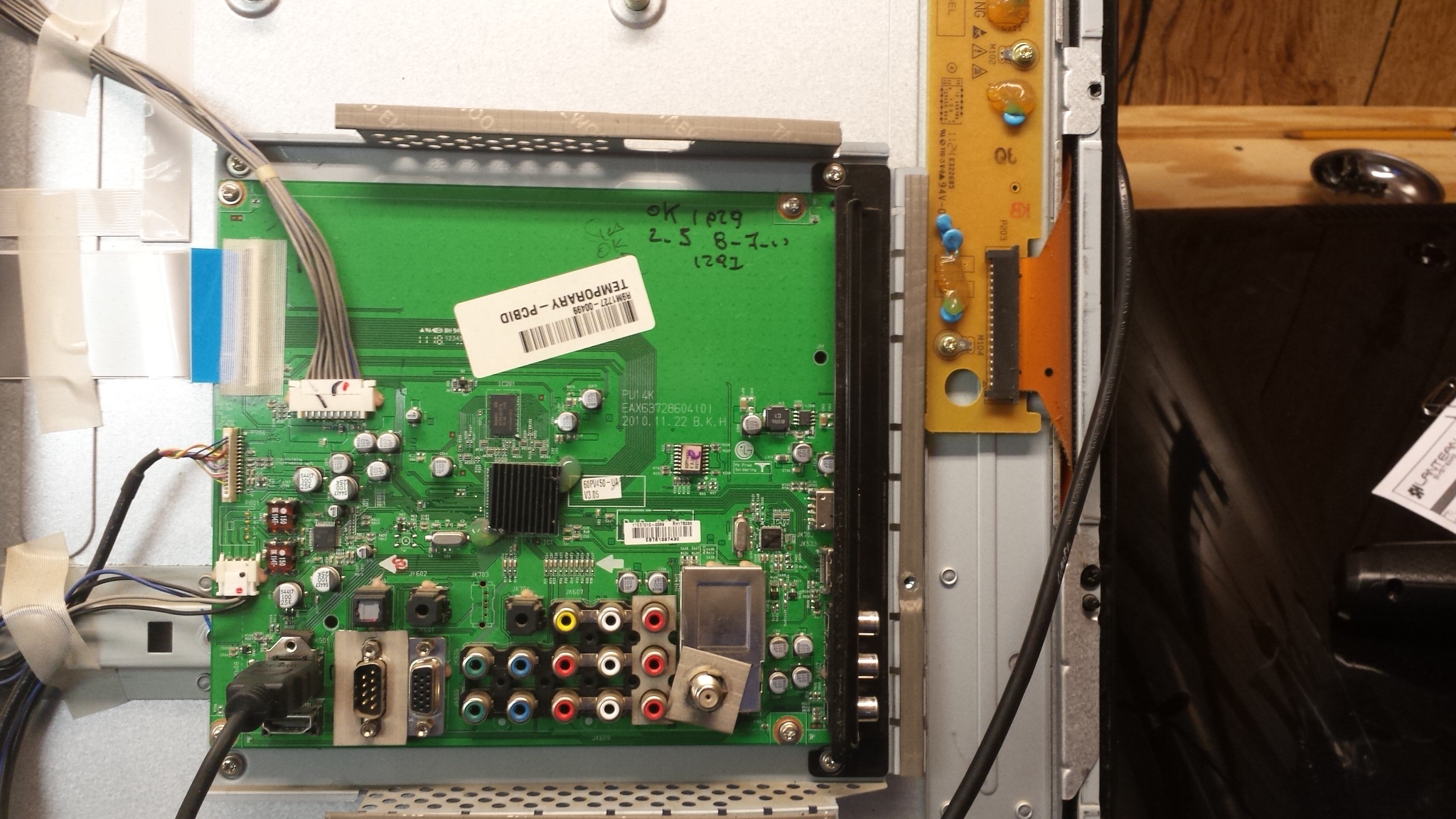

                    When swapping the cable from the control board and the red stripe moves to another position on screen tells me the control
                    Board is bad and the Panel and xl/xc/xr are good? Changing the
                    Control cables won't make it worse? I guess I am worried about
                    Making it worse. I was not aware I could do it. This is the first time I was aware. Thanks I will try it.
                      To me, it sounds more like a cable is worn, broken or corroded. I'd try getting a replacement ribbon.
                      You can swap the ribbons only if they are the same size. After all, they are only cables, they do not have any "cross-over" connection. It is direct point-to-point.
                      What I meant was to move the actual cable, so unplug it from both ends.
                        Remove the cables on at a time and check for corrosion on both the cable and it's socket, I have seen these corroded before, if the socket is also bad you will probably need to replace the board it's connected to. You can check continuity on the ribbons as well.
