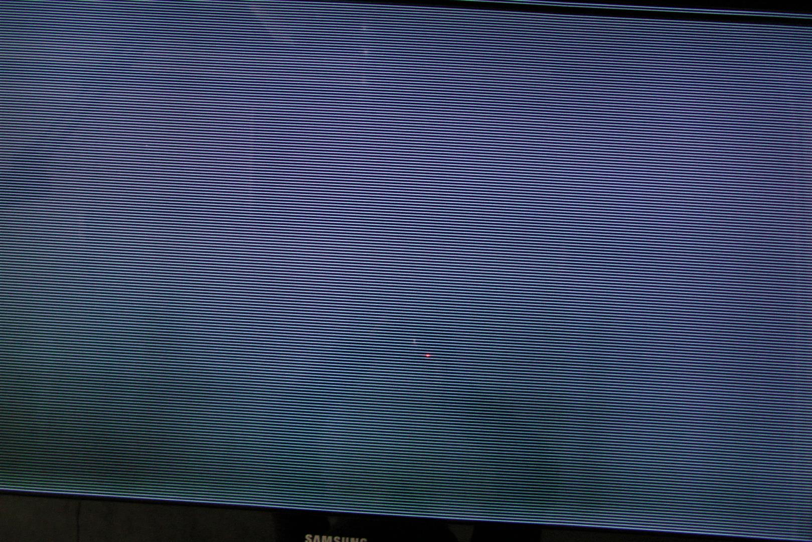

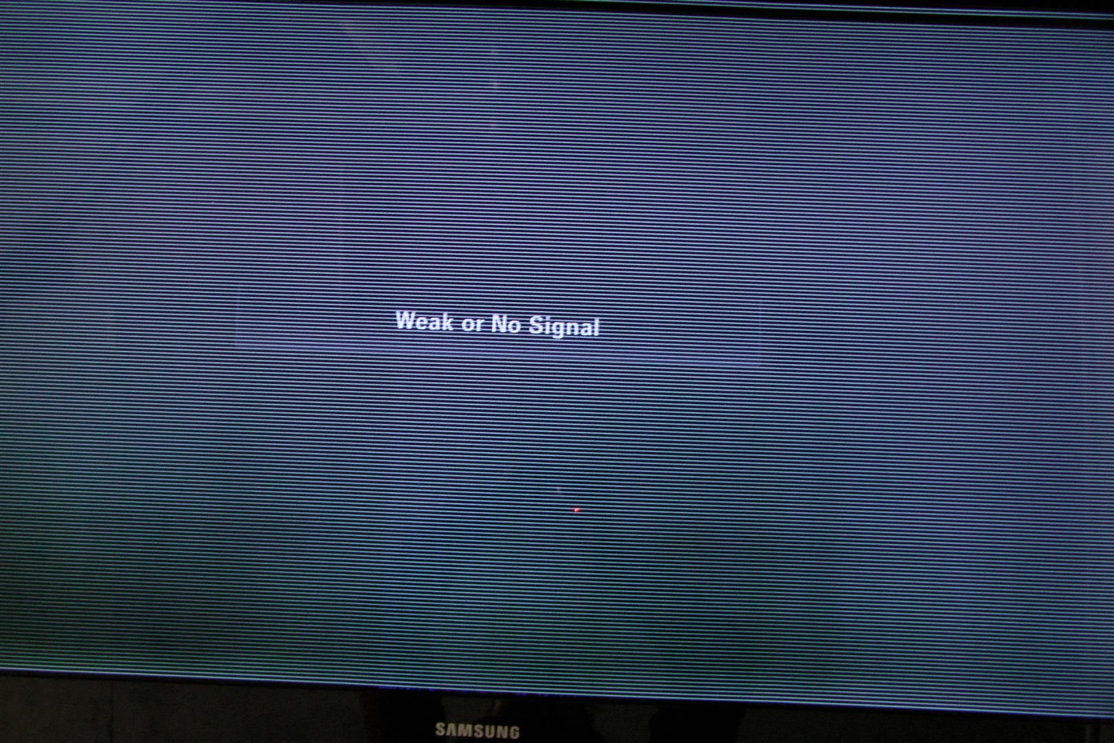

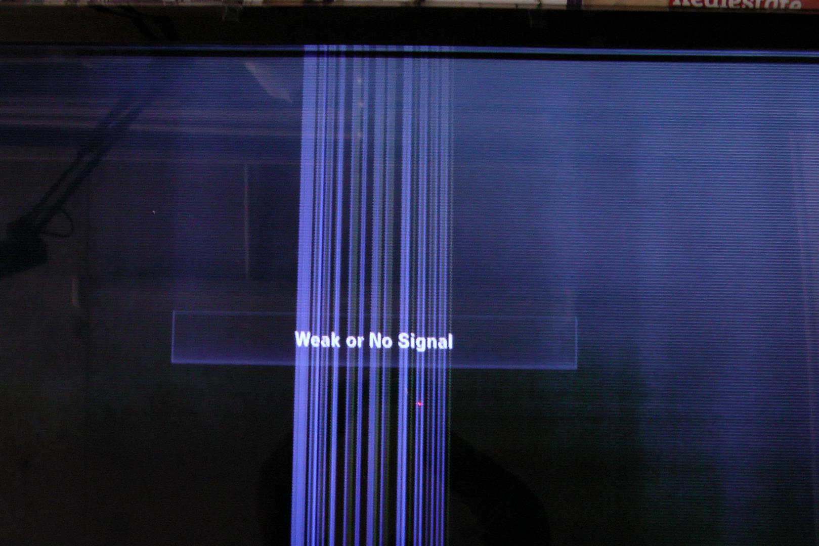

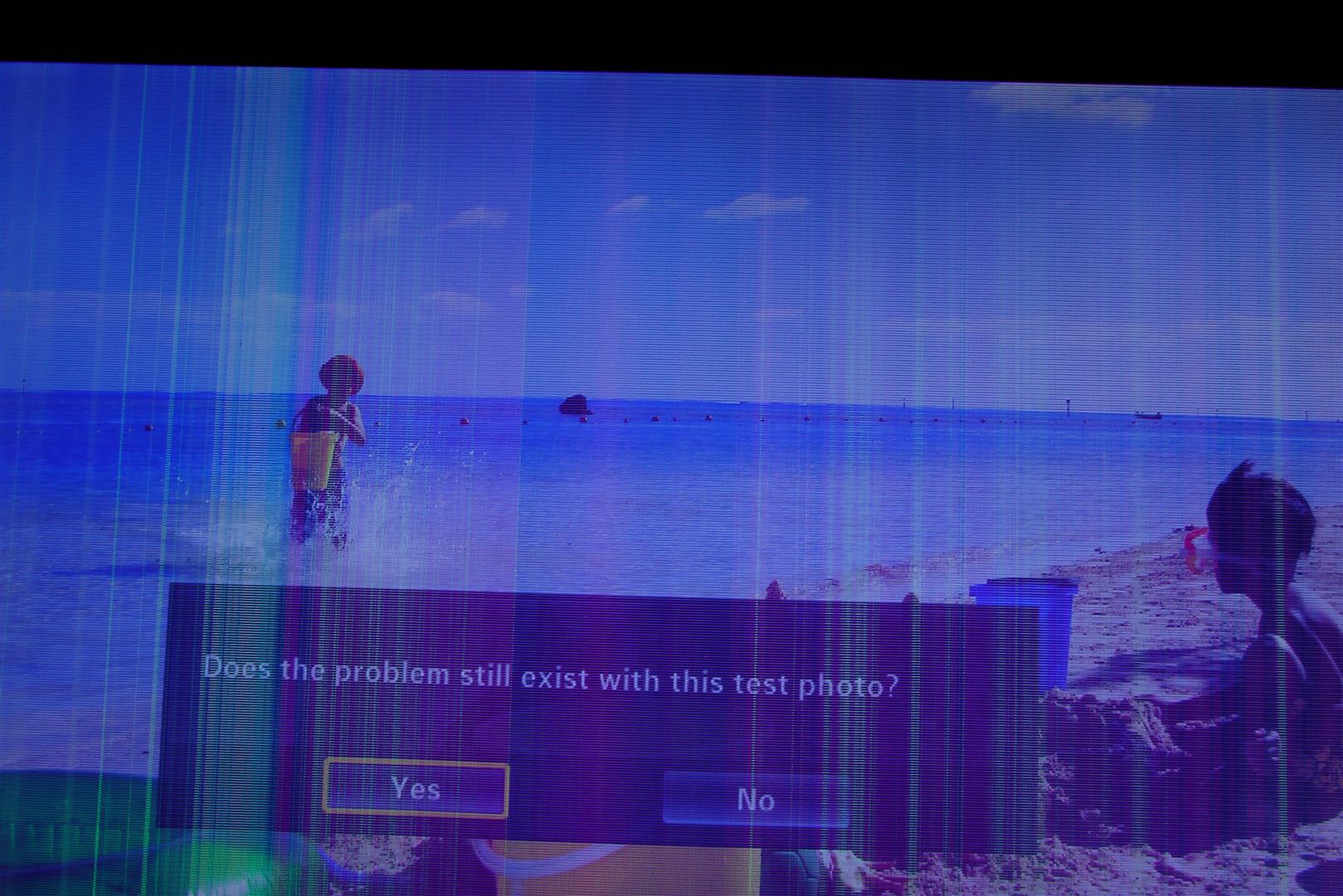

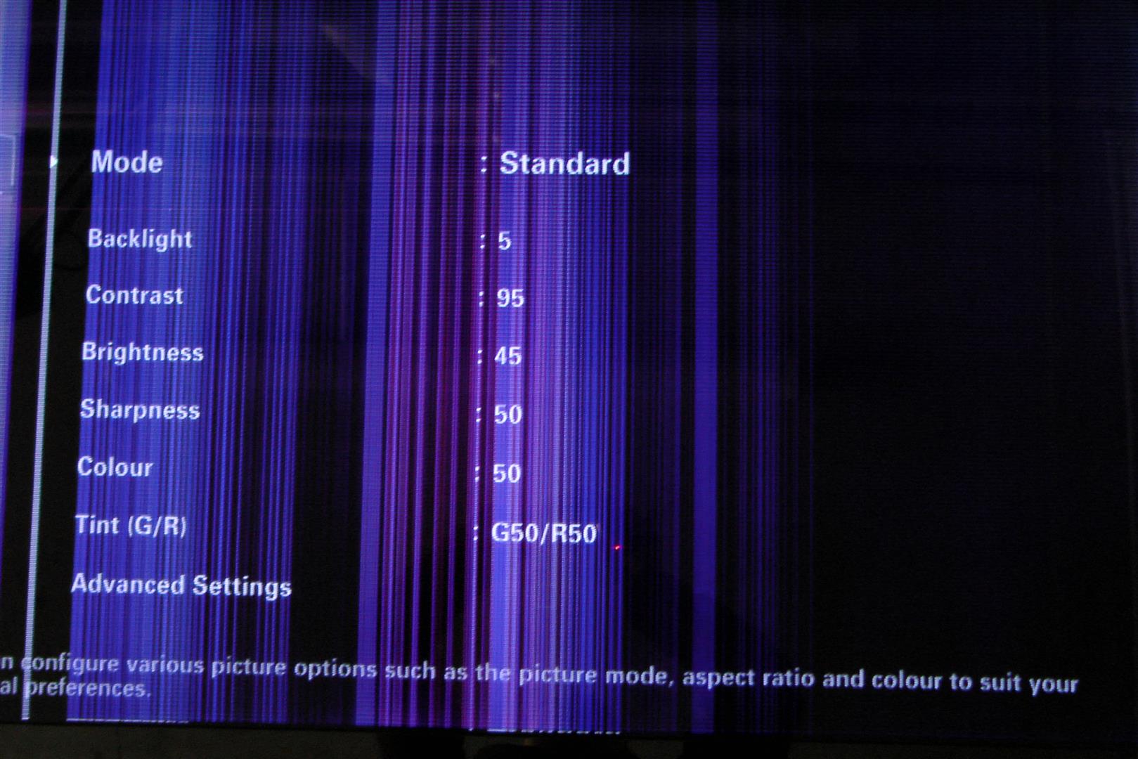

    This TV is 5 years old and has some picture problems (lines) which I am hoping to solve. Attached are some pics of the problem(s). I have labelled them with a basic description as the problem(s) can vary a bit from initial turn on and after warmup. This warmup behaviour is very repeatable.
    I have had the back off and had a good look at all the board components, but cannot see anything suspicious. I have reseated all ribbon cables and cannot get the problem to go away. I am thinking it could be either a bad LCD panel or possibly a bad T-con board. Before I purchase another T-con, I was hoping to get some expert opinions from you guys.
    Cheers
    Dave (Sydney)

    Re: Samsung UA46B6000VF LCD Picture problem
    I saw it's a bad panel but you could try reseating the Tcon connections.
