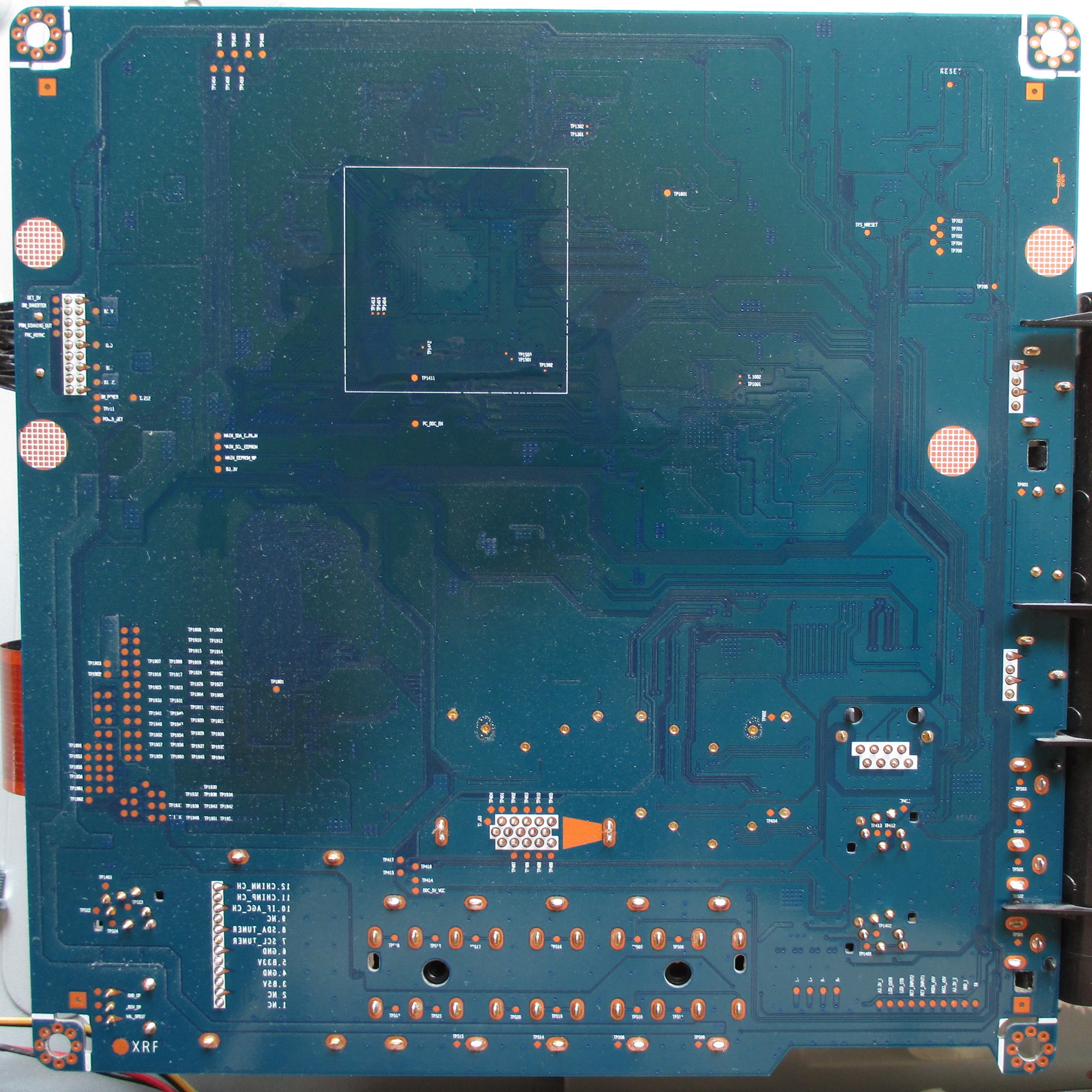

    Recently inherited a nonworking Samsung LN40C630 with no signs of external damage to either the screen or front and back body.
    While this is the first LCD I have worked on, have been taught to check for burnt and broken components and PC boards, and count flashes and beeps when turn unit on/off.
    To date I have only plugged the set in and turned it on and off with these results.
    When plug in the AC cord the set makes a short musical sound(MS) and the power light(PL) flashes 6x then off.
    When turn the set on get shorter (MS) and (PL) stays on but there is no screen light.
    When turn the set off get shorter (MS) and (PL) flashes 5x then off.

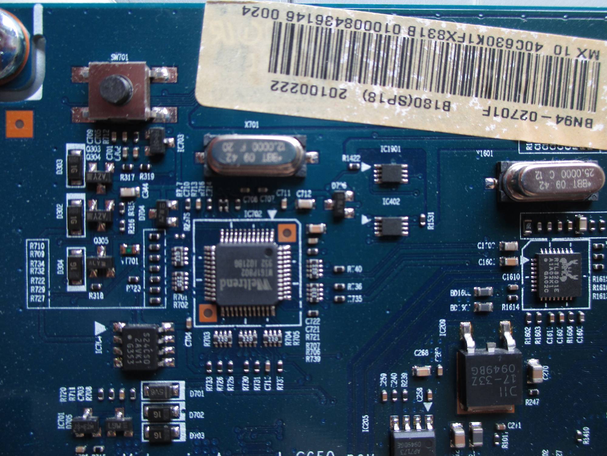

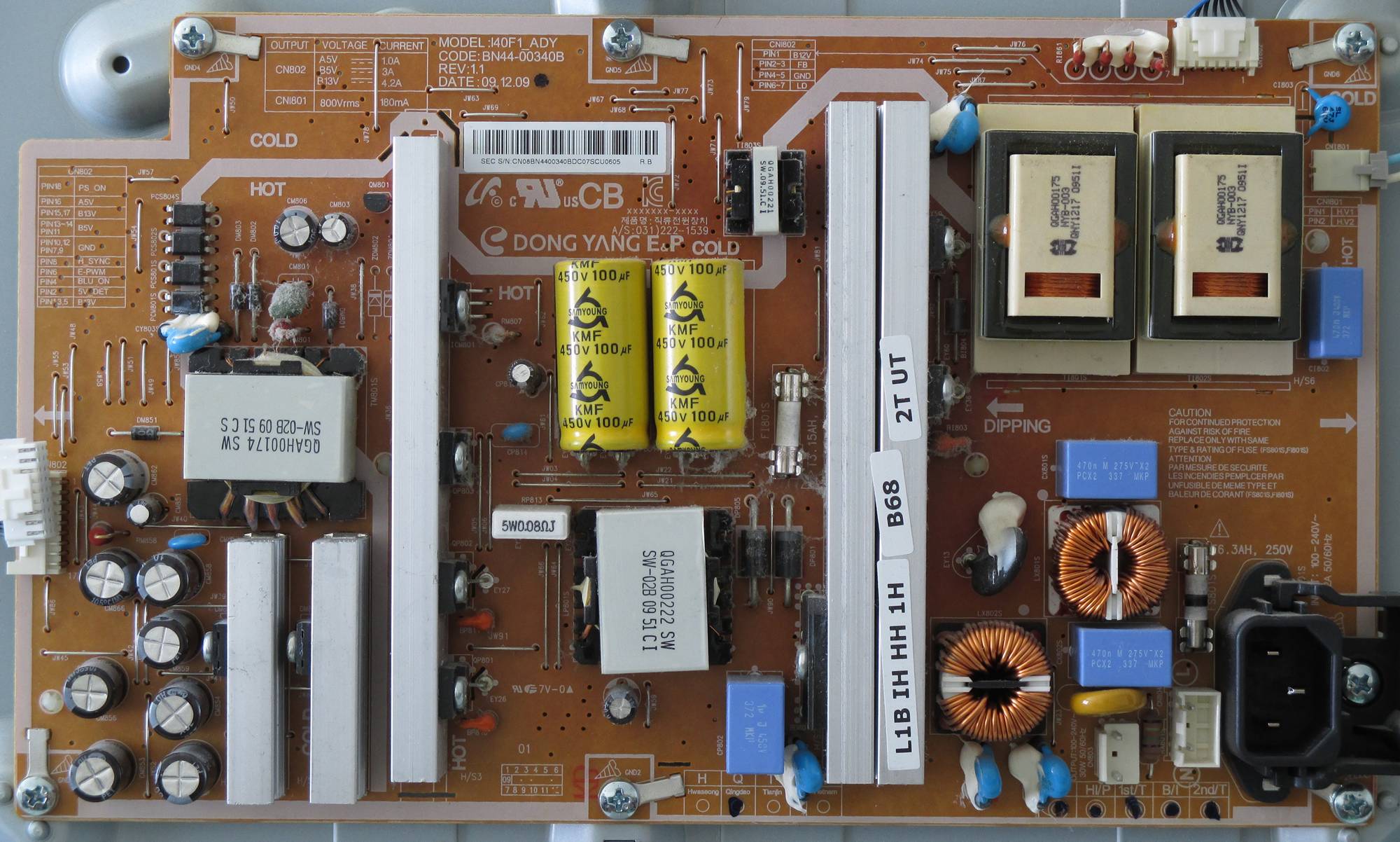

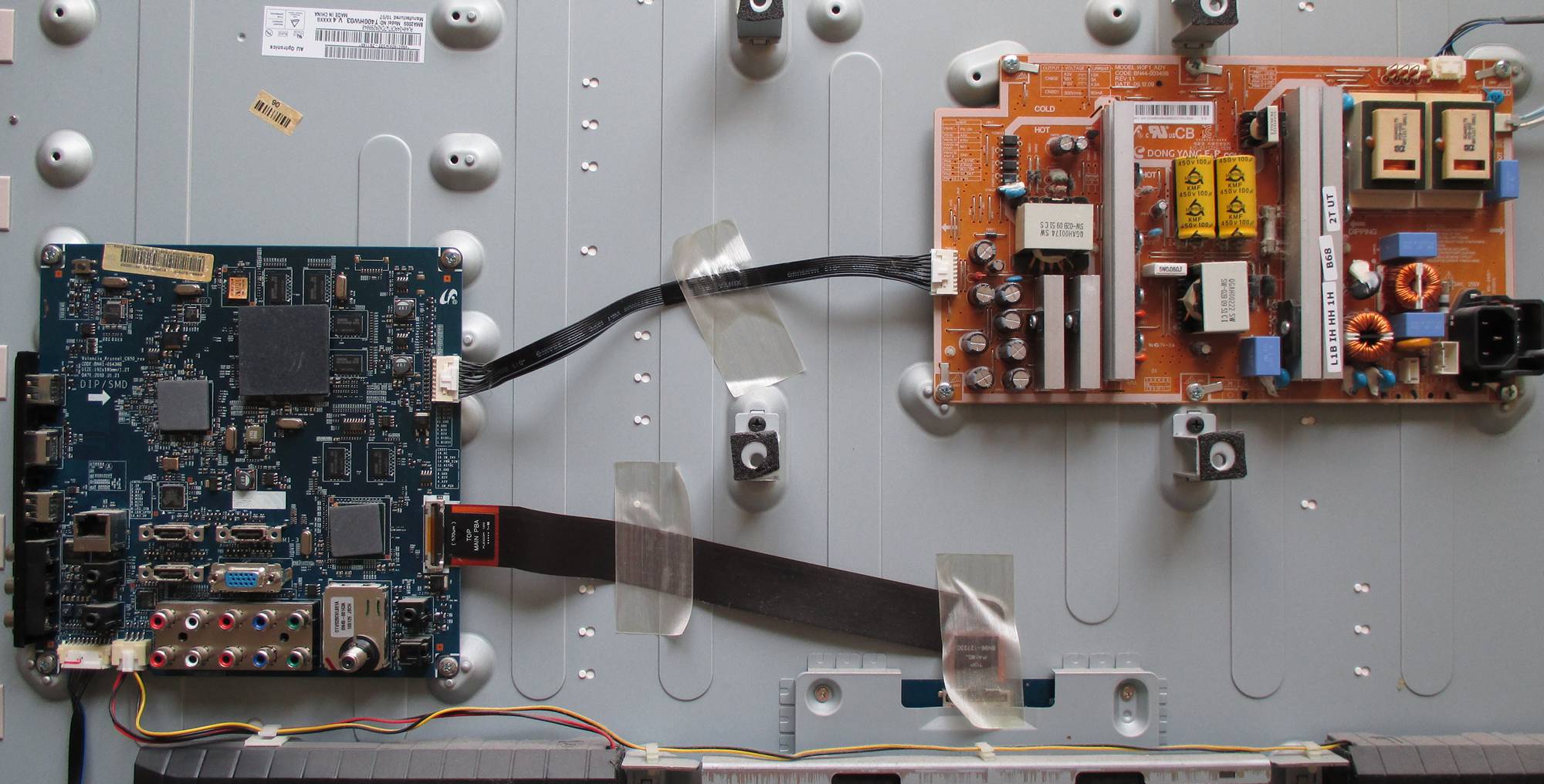

      After opening the back checked the 2 fuses and the front and back sides of the Power Board (PB) and Main Board (MB).
      The 2 fuses were OK and I did not notice any burned/broken components or traces on either board. Upper left of MB noticed Switch SW701.
      Then removed the MB connector and plugged the AC cord in and the LCD back light came on.

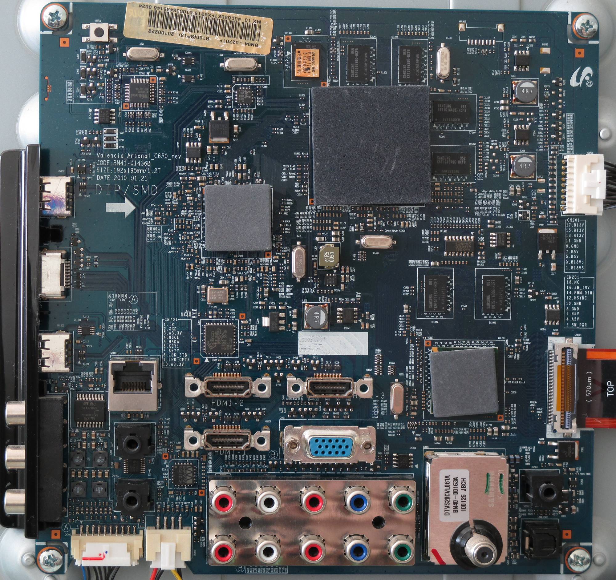

      Pushed SW701, reconnected MB and when connected AC cord got 5 power LED flashes and short music, touched power and LED came on and stayed on (no flashes) but no screen came up and the Input Mode and Menu did not work.After ~ 1 minute touched power and got 5 flashes and short music and set turned off. Also got same results with a DVD player connected to AV2.
      Wonder if these flashes are same as PC BIOS "No Boot" beeps?
      Appreciate any comments!

        On Samsung tv's the flashes mean nothing. Do you get audio when you cycle through the inputs with the dvd player connected ?
          Re: NonWorking Samsung LN40C630?
          At this point it is the main board problem (the backlights come on when cable between main and power supply is disconnected which means the power supply is OK).
          I never have luck fixing Samsung main board. You can contact shopjimmy to see if they have any suggestion.
          You can also report the DC voltage readings on each pin of the connector CN802, just to see what you have.
