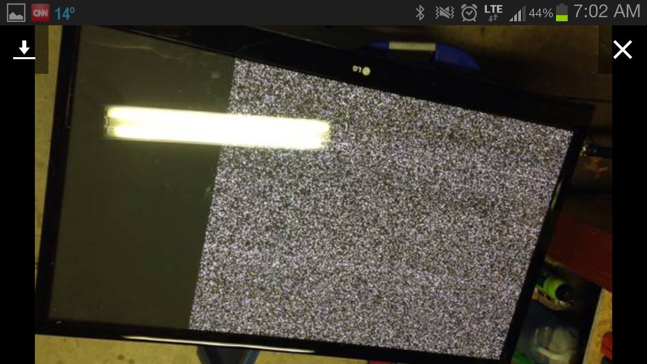

Bad Panel 2 ?
  • mmartell
    • Oct 2013
    • 3189
    Bad Panel 2 ?
    This is an LG 50PK540. Is this a bottom buffer ribbon that needs reseating or is the panel on its way out ?
    Re: Bad Panel 2 ?
    It's rare for plasma panels to fail in such a way, check ribbons & for Va on that board. Careful do not reseat with power applied or shortly afterwards.
