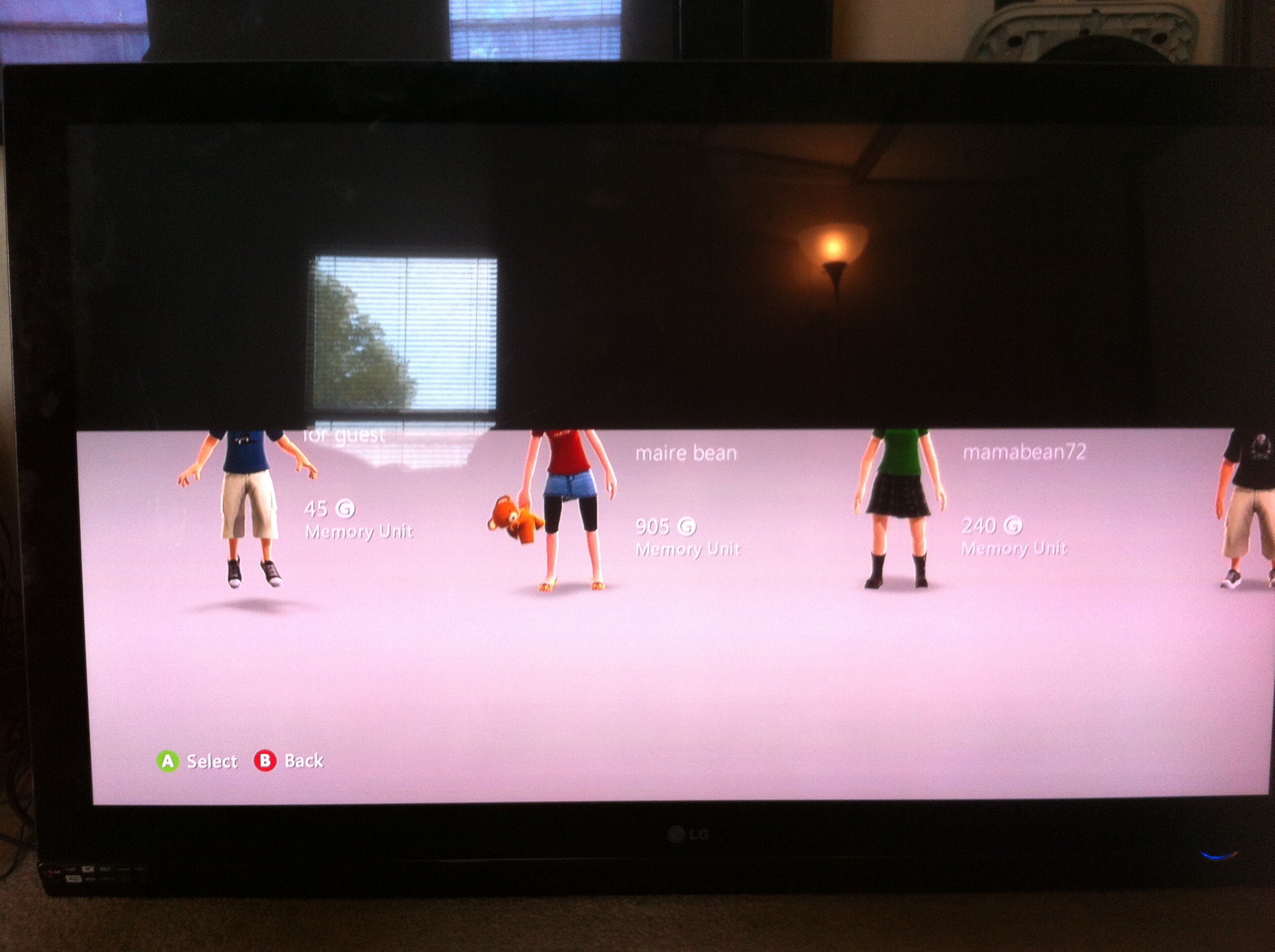

    Hello all,
    I have inherited an LG 60PG60 plasma TV that has the following problem.
    The complete top 50% of the screen is dark, while the lower half works perfectly, shows picture on all inputs and internal menus, etc. If I turn out the lights in the room and turn the set on, both top and bottom halves of the screen are glowing, but the bottom half is slightly brighter, and shows a picture.
    I have repaired 2 other plasma sets (a Fujitsu & an older LG), and would assume that this is an upper buffer board failure, but the upper half of the screen is glowing. Not sure if that could still mean the buffer is the culprit? I am still learning as far as Plasma repairs go...
    I checked all rails of the power supply on the main large connector on it, while the set was on and noticed all connections had power (5v, and Va/VS were spot on)? Not 100% sure how to proceed here.
    Any thoughts?
    -Jeff

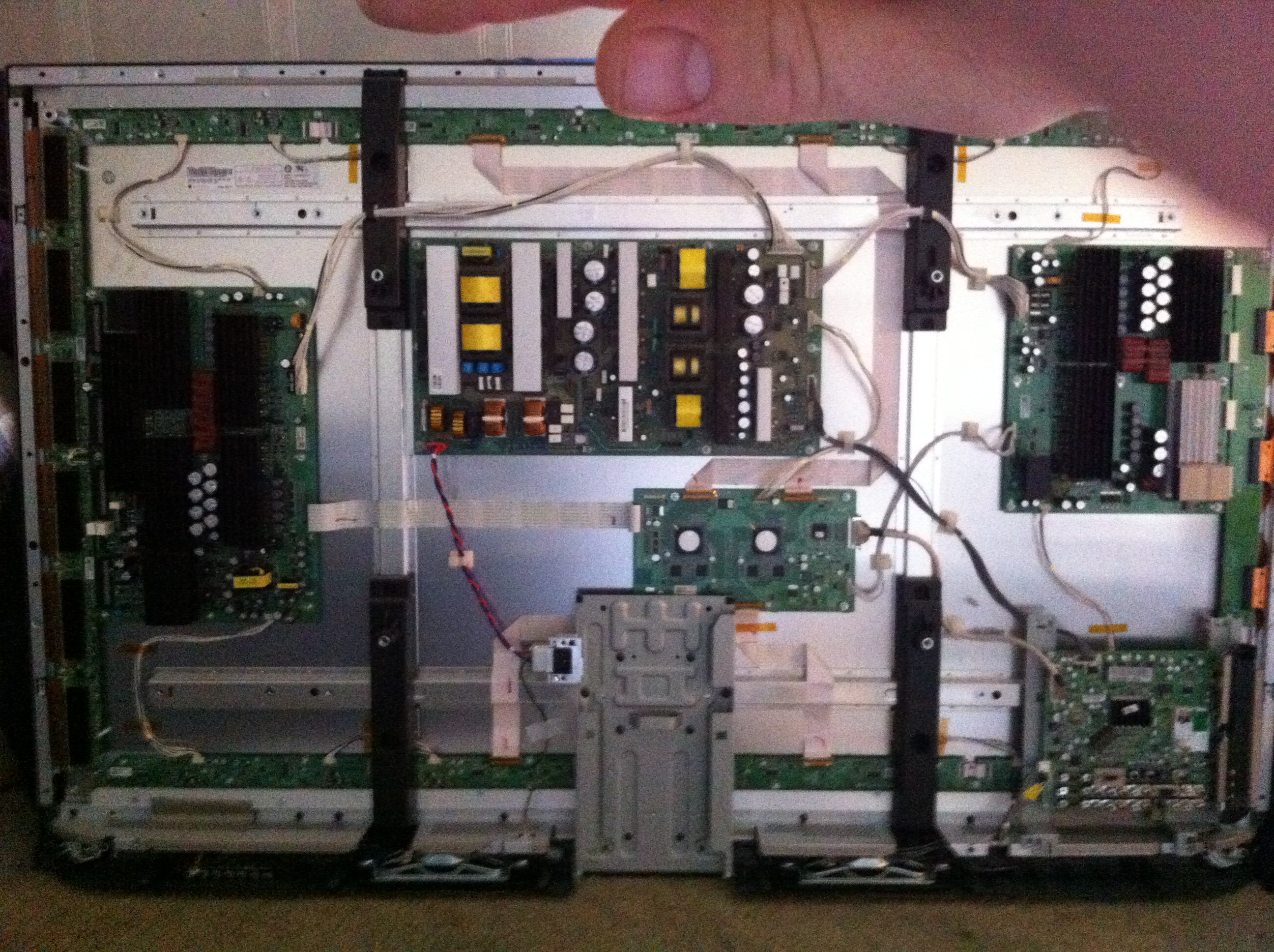

    Re: LG 60PG60 - Screen glows, but no top screen picture
    Could you supply a picture of the TV with the back cover off, so we can see how it is arranged?

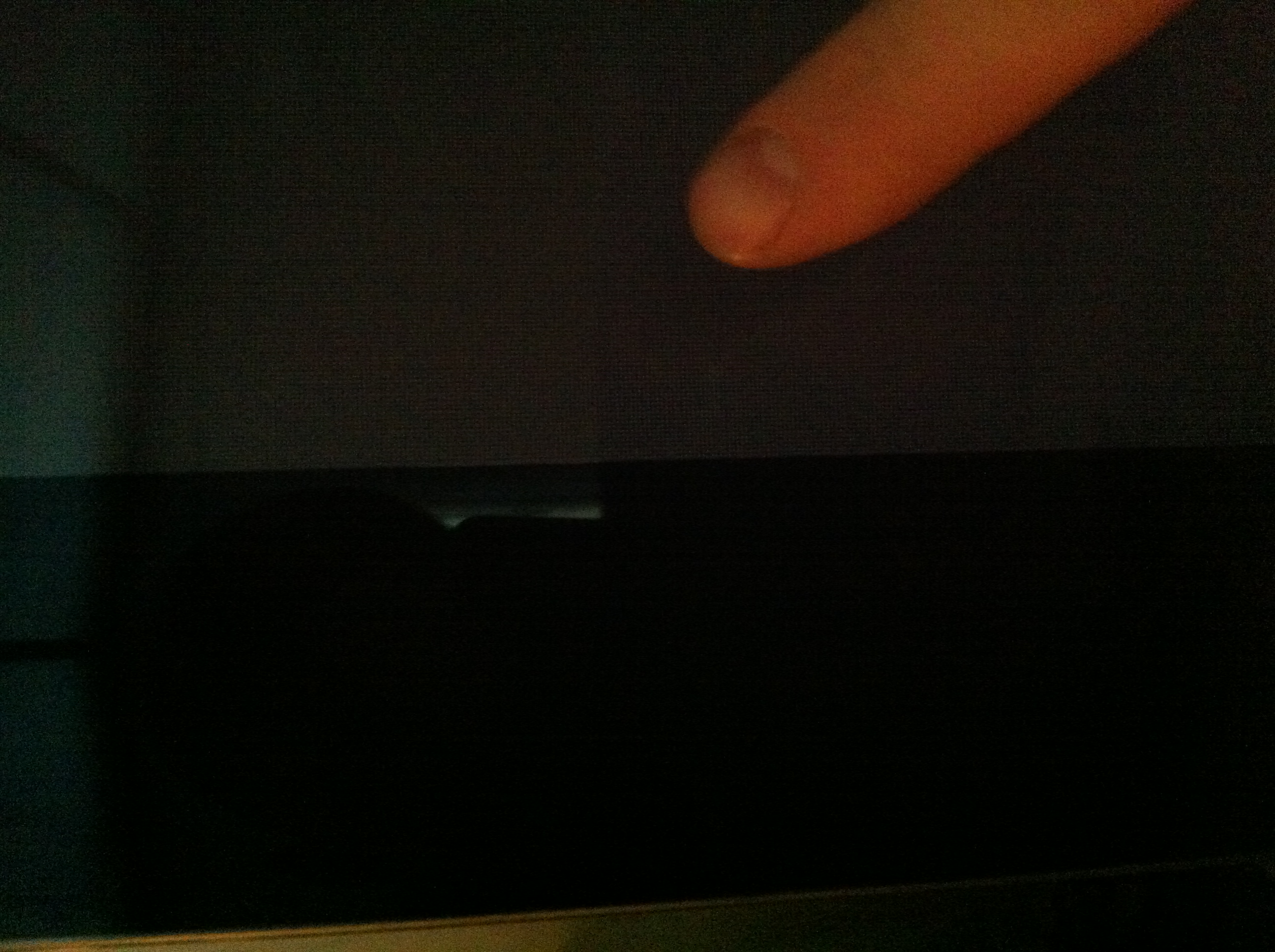

      Hello Tom,
      Just shot a couple pictures.
      First is back with cover off. Others are there to display symptoms.
      As a side note, I did disconnect and re-connect all cables including the ribbons to the upper buffer board just to make sure it was making good connections. Same thing, no joy. Turned the set on with no upper buffer just to double check, and of course the top half of screen is 100% dark without it there, in the dark.
      Thanks for your time,
      -Jeff

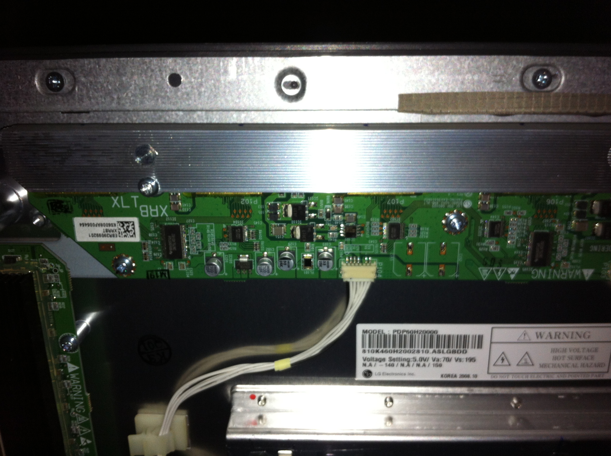

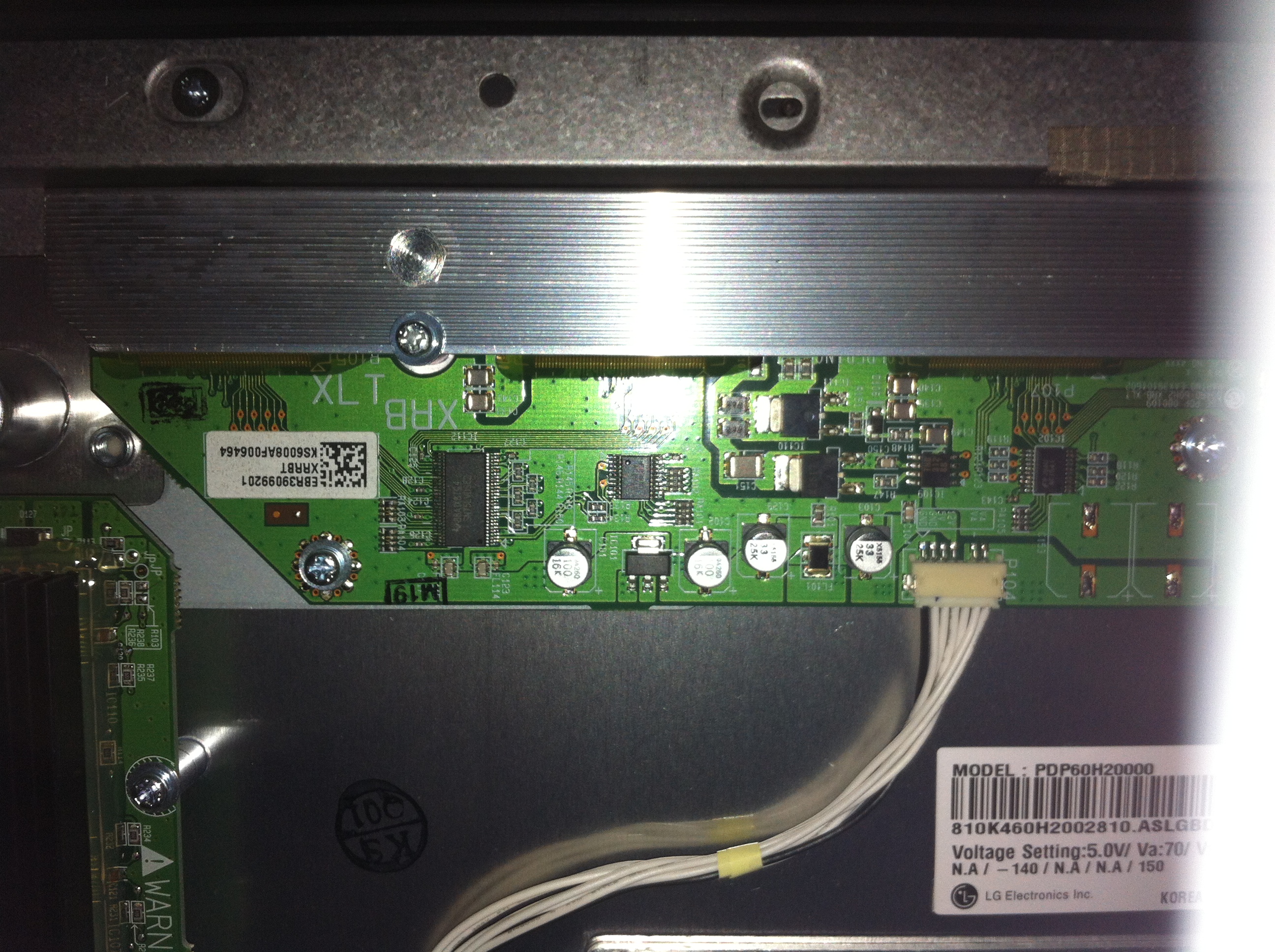

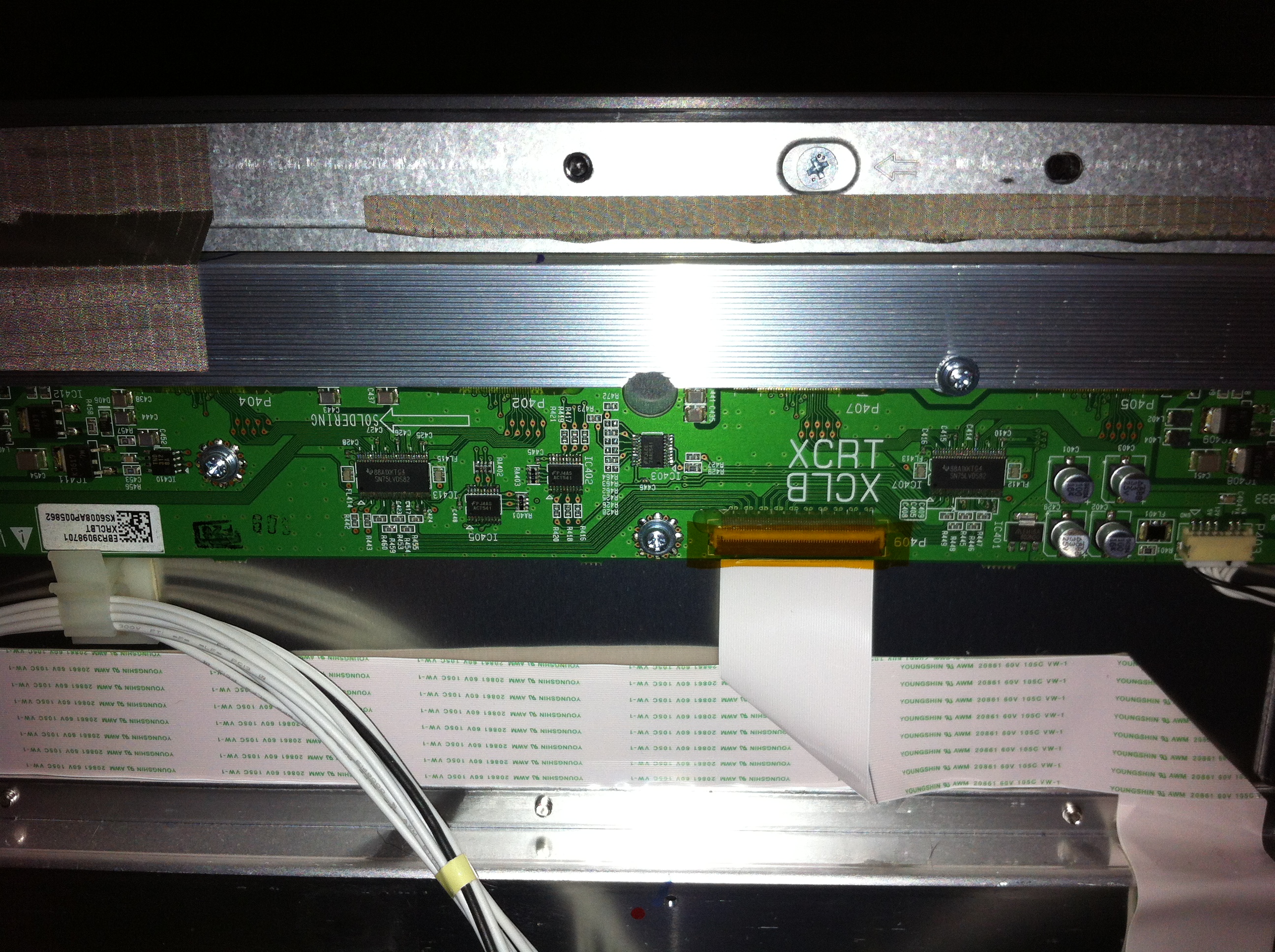

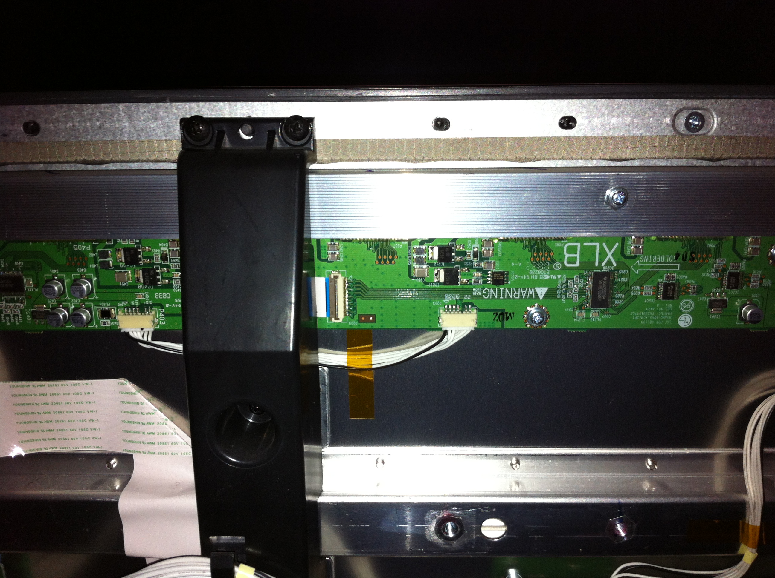

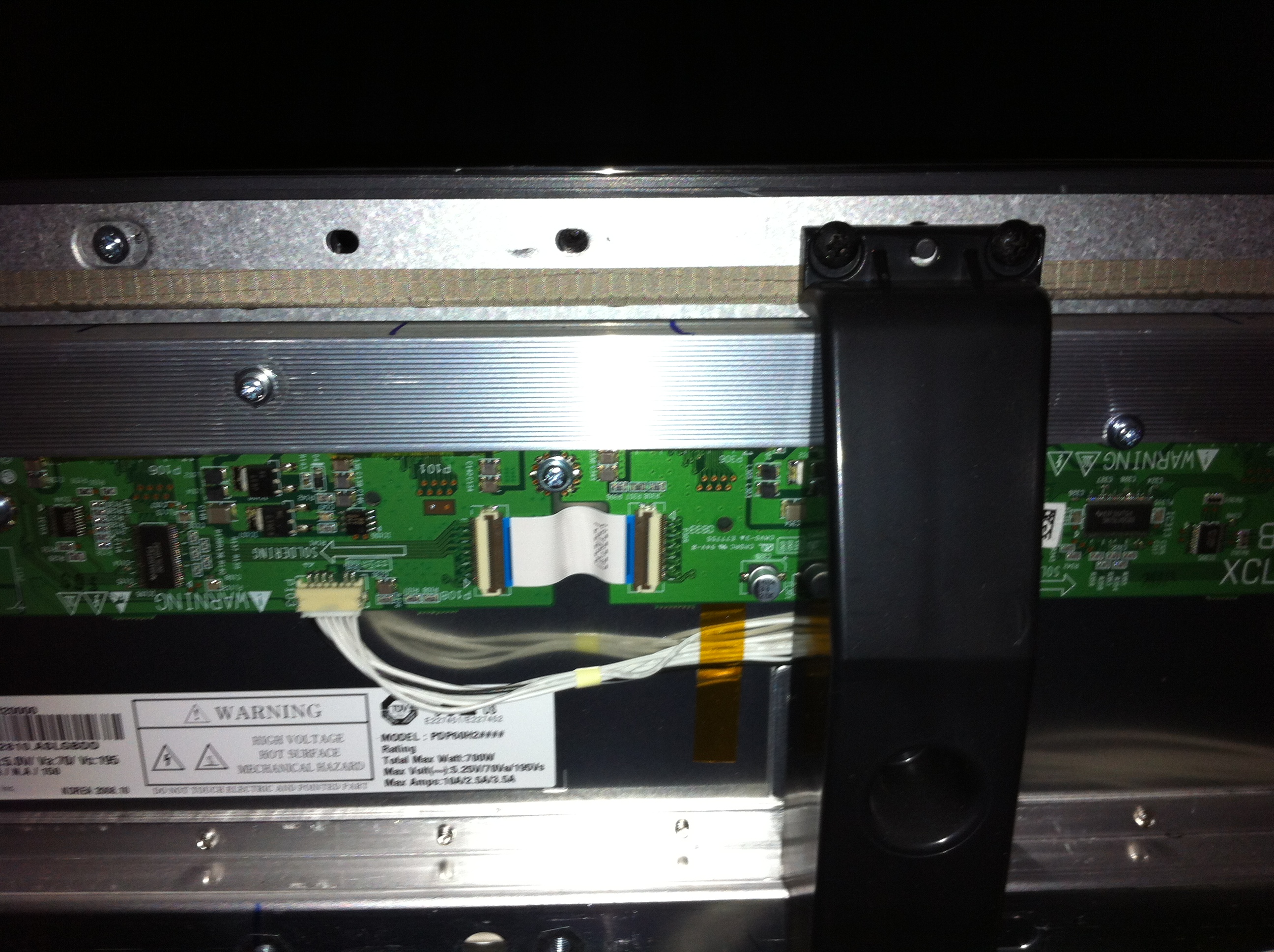

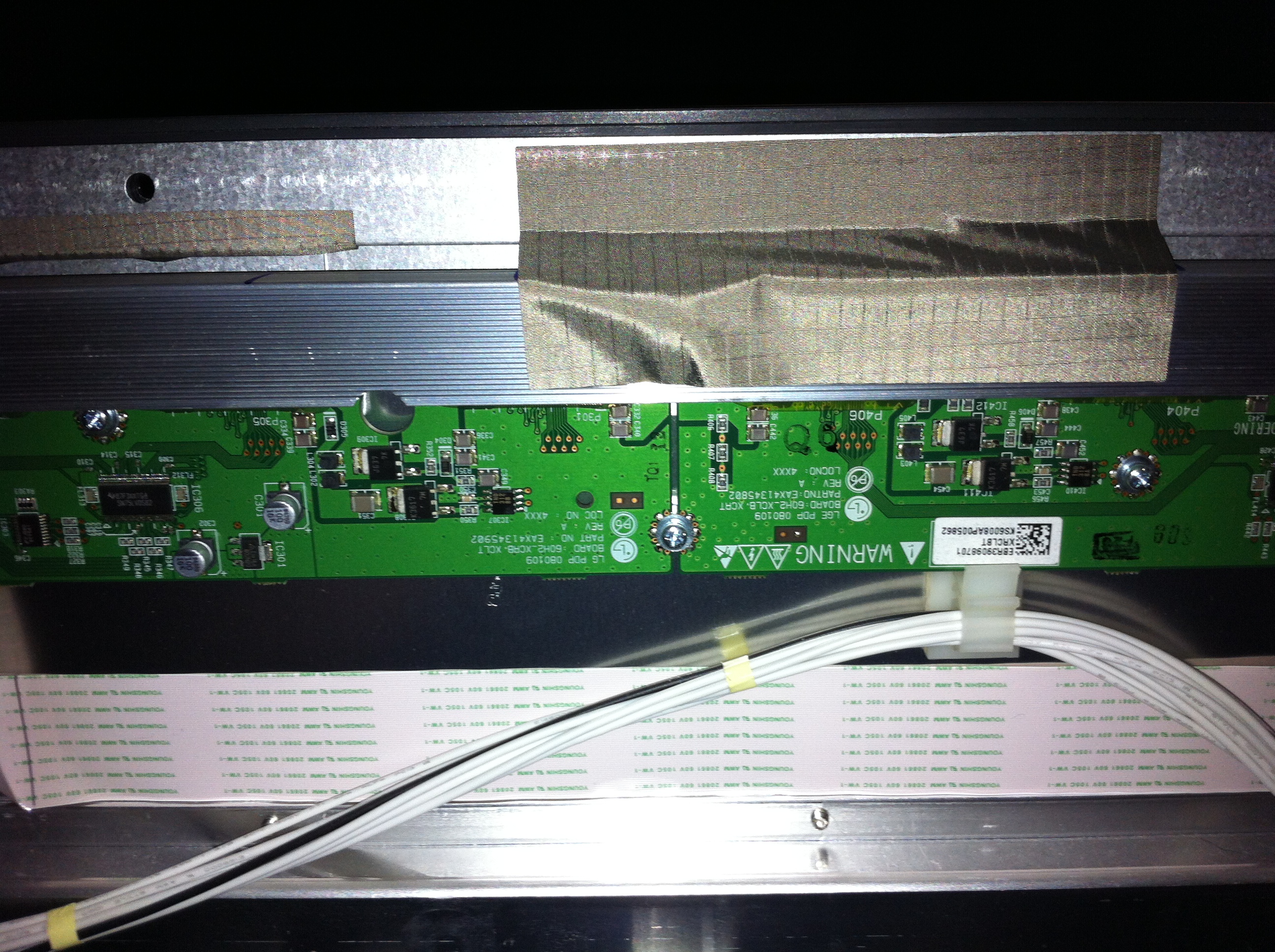

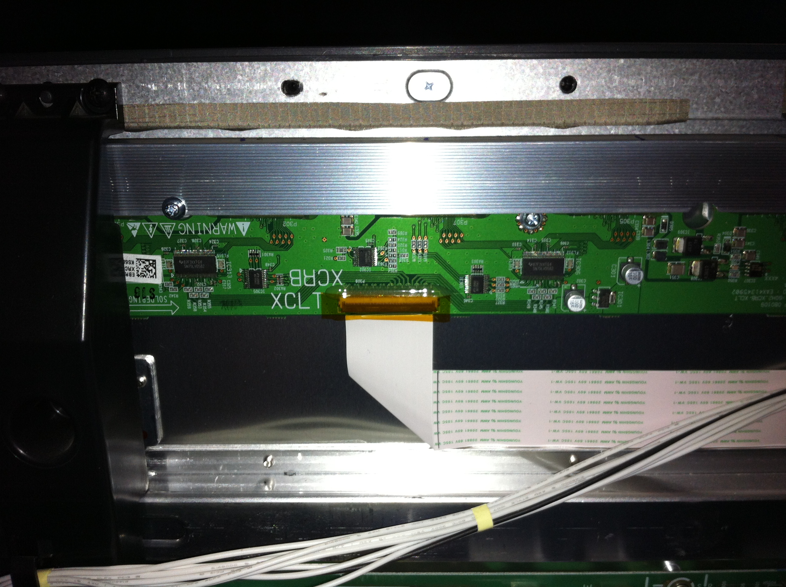

        OK, so this TV has a top address buffer. That's the long board running along the top. Can you get detailed, well lit pictures of it?
        • jtieman
          • May 2010
          • 6
          Tom,
          These are really not the finest pictures, but I hope they help. I did notice '12v' on some of the connectors, so I still need to check for 12v - I missed that before.
          Let me know what you think, and again thanks for your help!
          Jeff
