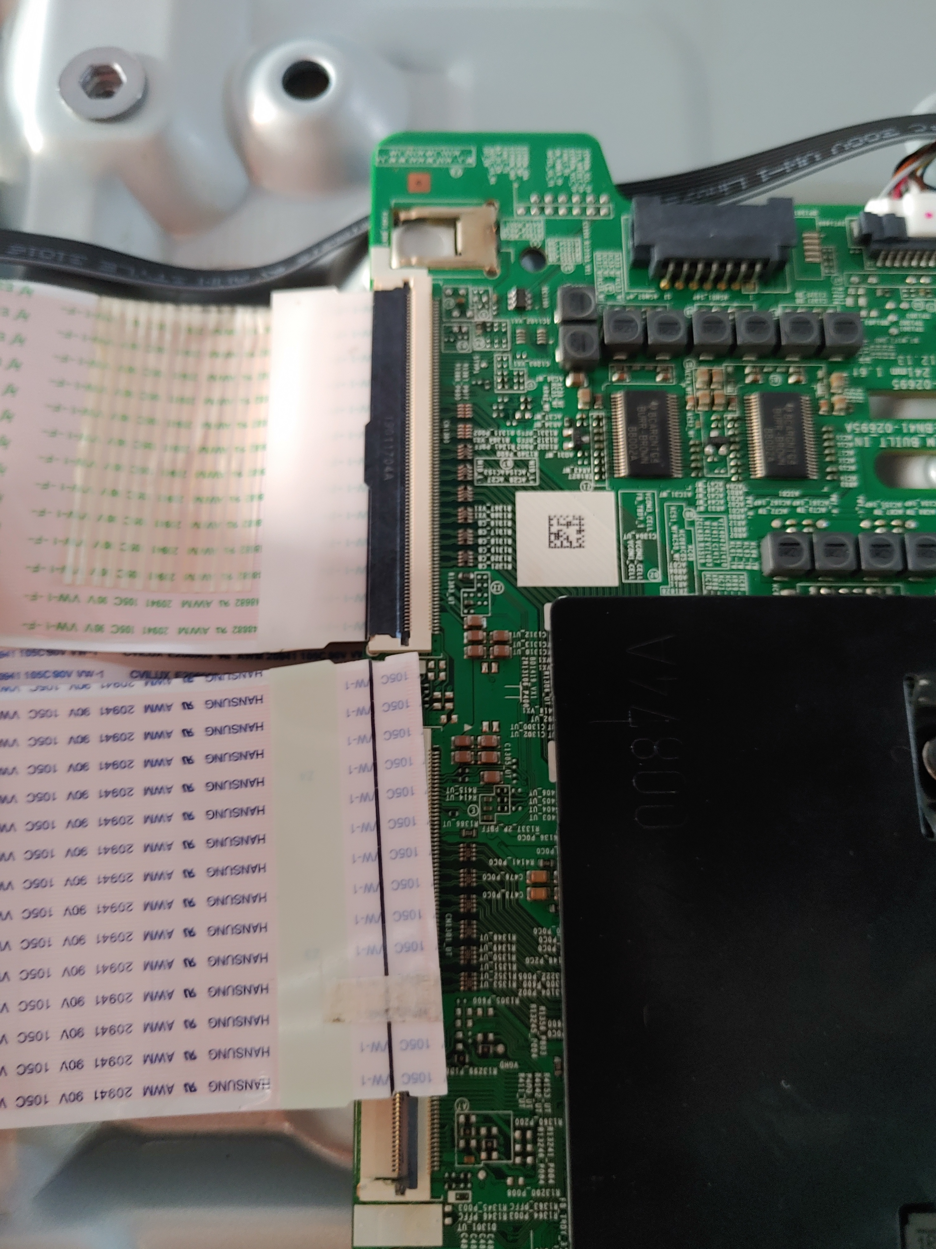

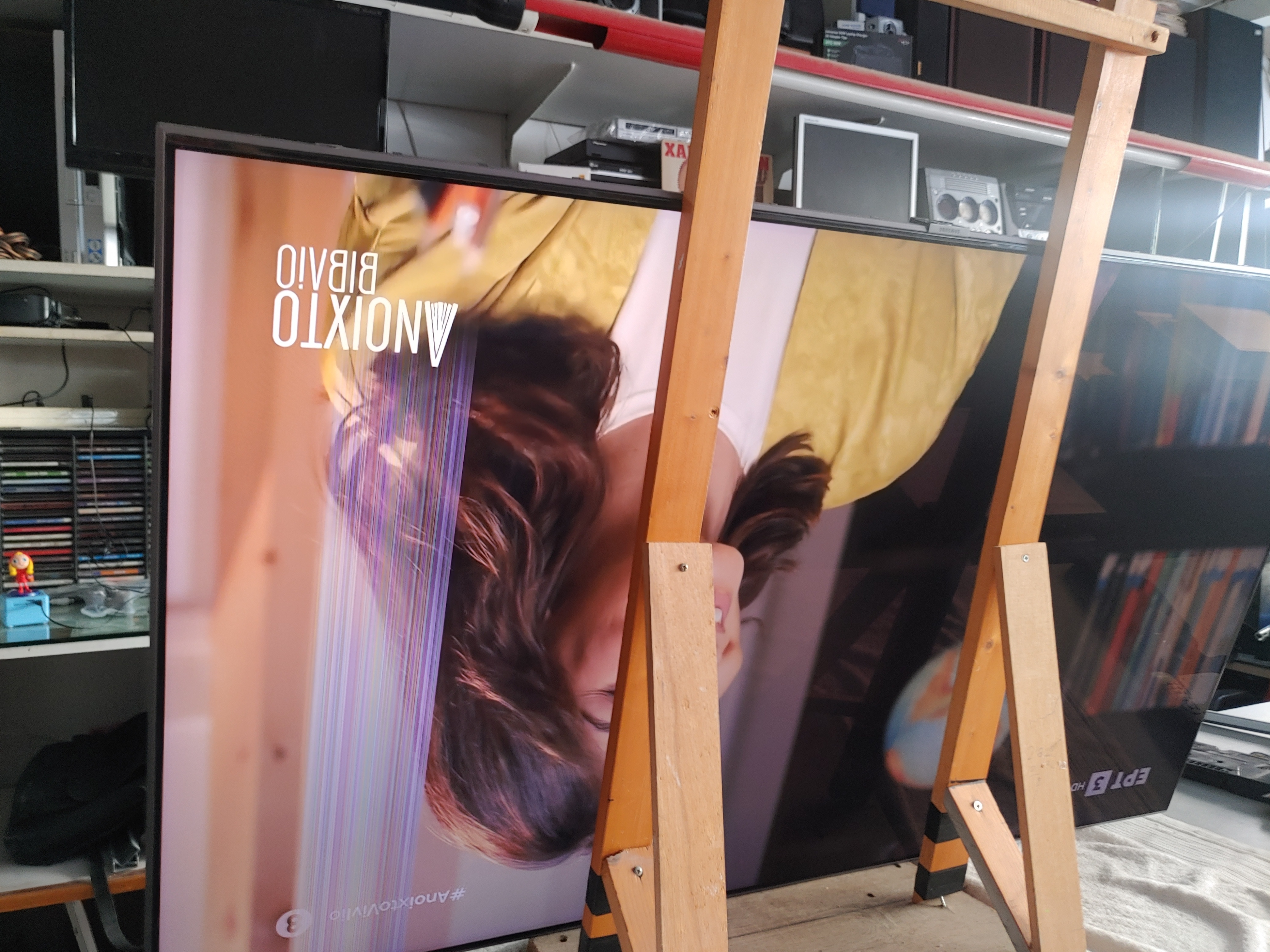

    Hello to everyone i have TV SAMSUNG QE55Q80RAT tv with reboot problem i tried to tape the cable from panel to motherboard . The tv started ok for a moment but after a while i get a line at the left of the screen . and need help if anyone know a way to fix it

    Replace the COF or the complete display. Because the COF is rarely or never replaced and the display is expensive, it will be a scrap TV...

      What you mean replace the cof. Dont get it

        COF = Chip on Flex or Chip on Film cable. It's one of the cables between the display itself and the modules you find at the bottom of the tv.

          But in order to Change old cof you need a special tool. It is not something easy to do by hand
