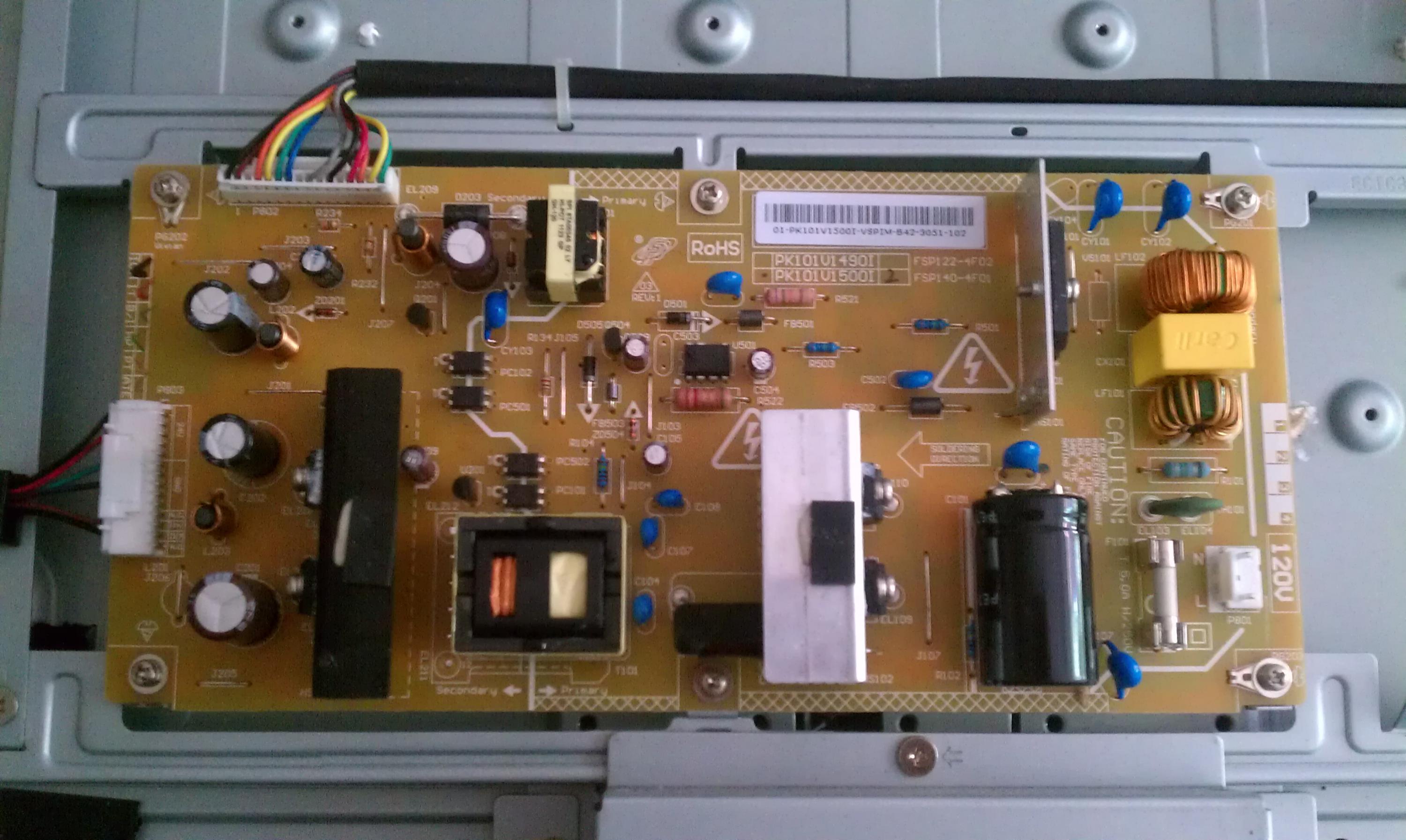

    got a Toshiba 32DT2U1 here that wont turn on.

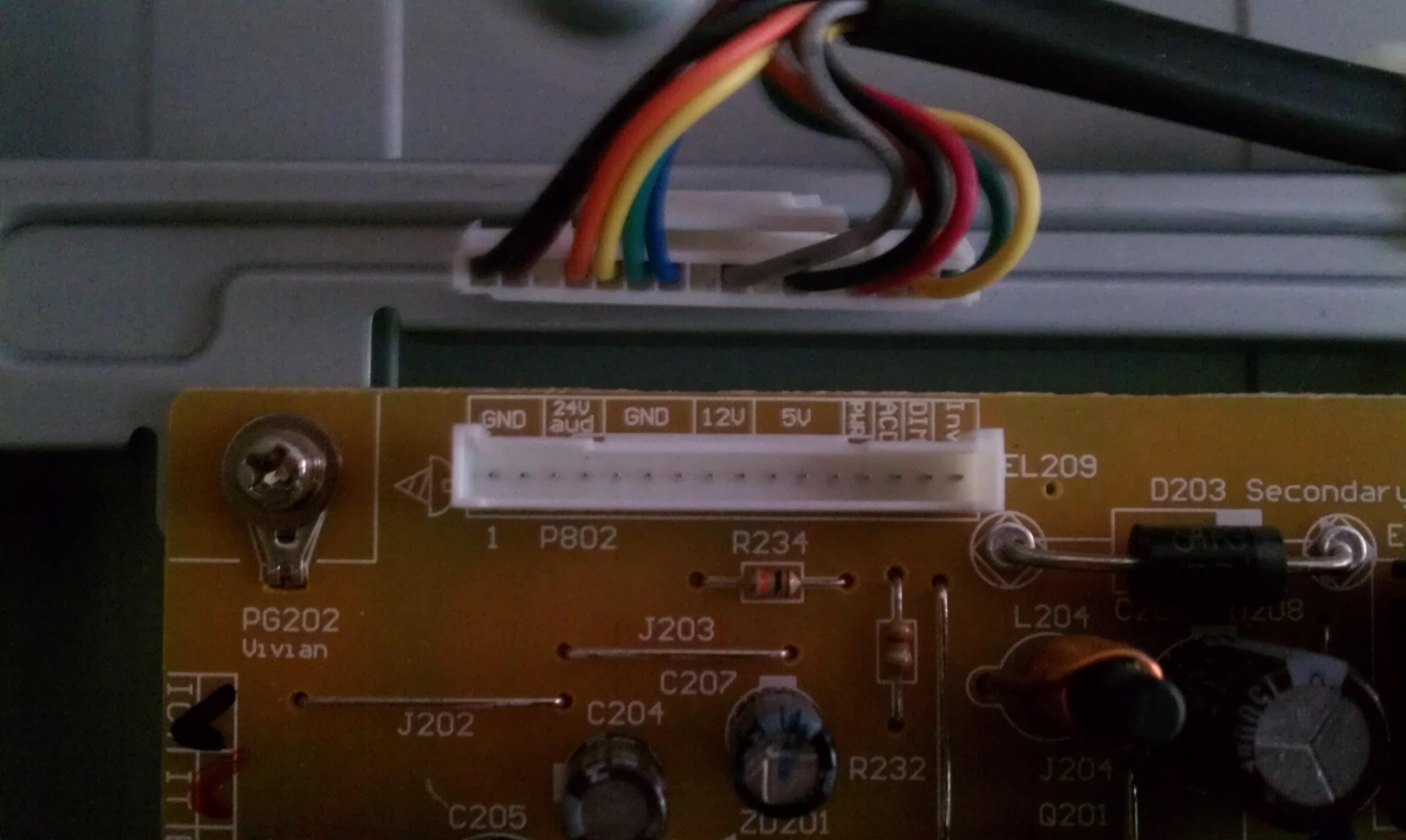

    i took it apart and tested some voltages and saw 5v and even 12v but pushing power button does nothing. no red standby light. nothing.
    im thinking power supply problem but still not skilled enough to chase it down myself apparently :/
    i have 165v at the main filter cap.
    i will measure the voltages at all the connectors and post soon

    Re: Toshiba 32DT2U1 has 5v but no stby LED, wont power on
    check the voltage at the cathode of d203
    i think that's gonna be the standby supply.
    if you dont get a voltage, try replacing the 2 small caps surrounding what i think says U501
      "i took it apart and tested some voltages and saw 5v and even 12v " If you are getting 5V STBY, then U501 is working.
      You need to check the DC voltage at the 'PWR' (ps_on) pin, it should be <1Vdc when TV is not turned on, >2V when power switch is,activated, same for INV pin. The 24V will be there when PS_ON is present and if the 12V/24V SMPS circuit is functioning.
      Since you indicated that you do have 12V, that means the 24VDC for the inverter board must be working then, so the PSoN must be present at this point if what you are saying is correct.

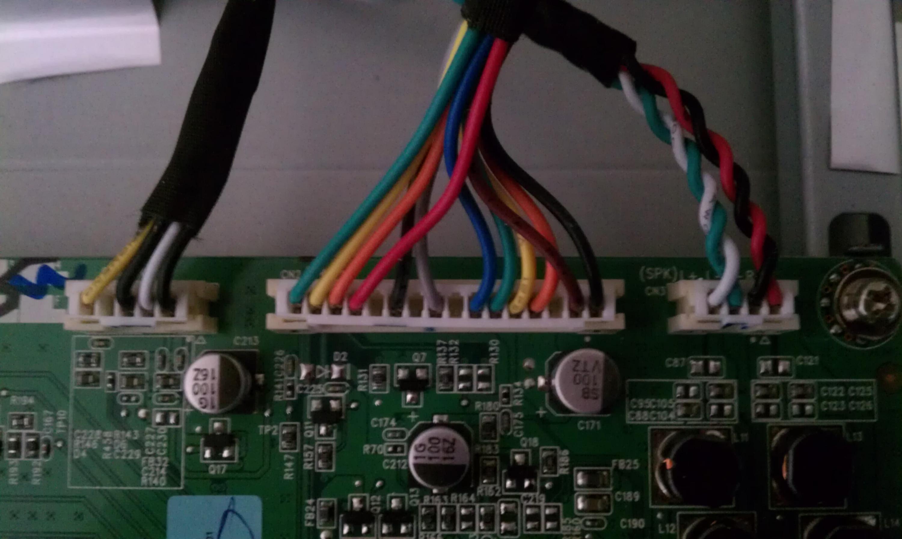

        well thats strange. now the green power LED comes on when i push power. i guess there isnt a red standby LED.
        anyway in standby i get 0v on all the pins except the 5v
        when i turn on the power i get the 5v and the 12v, and also where it says INV i get 3.3v
        that doesnt seem like enough to power an inverter...is this the problem?
        on cathode of d203 i see 5v in standby and when powered on
        what is DIM? that is 0 in both cases
        and ACD is like .06v
        PWR is 3.3v when power is on
          ok i was being dumb the 3.3v on the inverter pin is just telling the inverter to turn on.

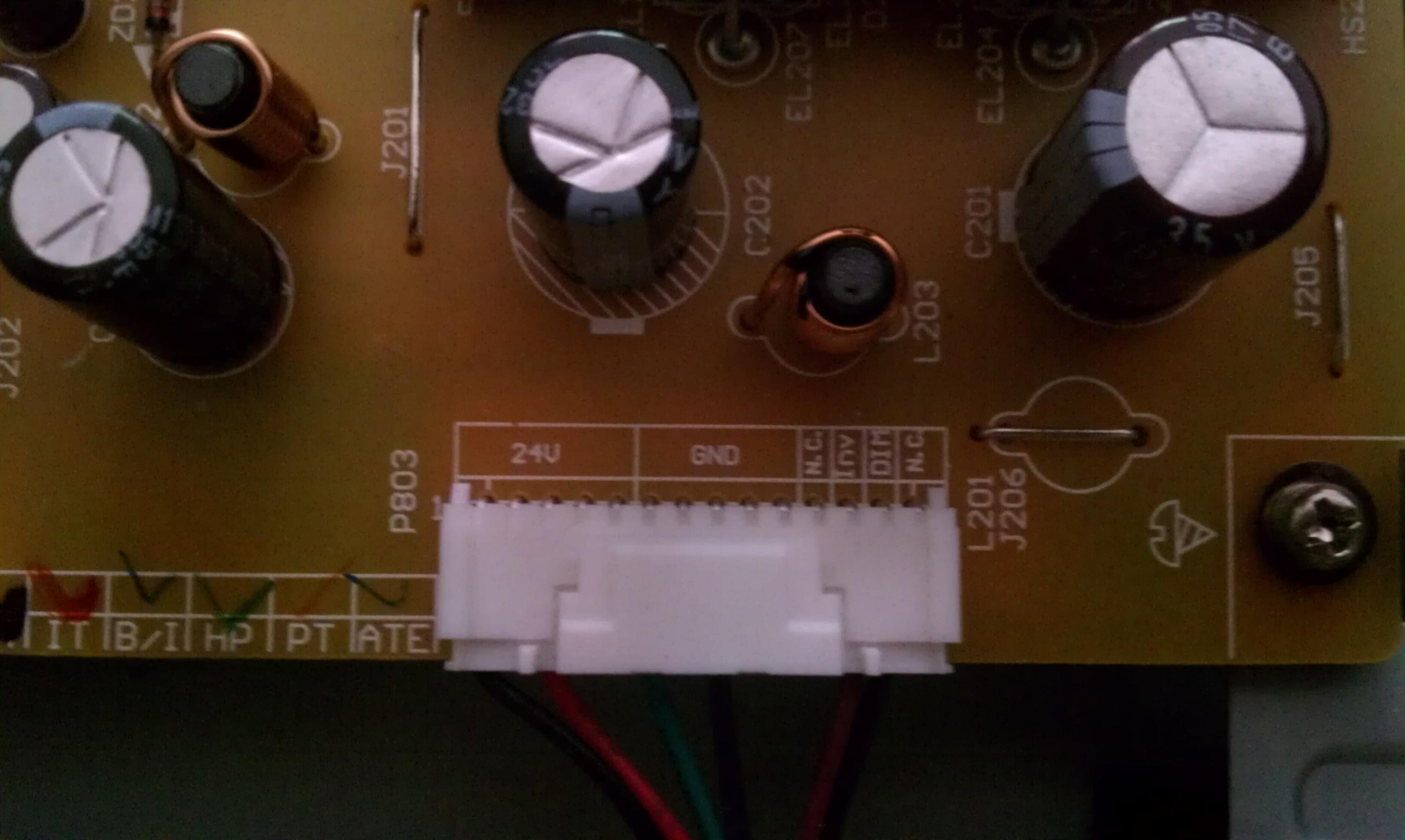

          i see 26v on the connector that goes to the inverter, and the inverter side connector.
          i notice DIM is there again and i see 3.3v on the inverter side but oddly, 0v on the PSU side?
          so the inverter is getting 26v but i am seeing no backlight flashing
            OK, let get this straight again when power switch is activated:
            What do you have on P802:
            5V: ??? This one should be there ALL THE TIME.
            12V: ???
            PWR: ???
            INV: ???
            DIM: ???
            ACD: ???
            P803:
            24V: ???
            INV: ???
            DIM: ???
            ACD: ????
                P802
                5v: 5v
                12v: 12v
                PWR: 3.3v
                inv: 3.3v
                dim:0
                ACD:0.6v
                p803:
                24v: 24v
                inv: 0
                dim: 0
                ACD: 0
                but im not getting anything now. it went back to not turning on the green light.
                im stuck in 5vstby...
                it was doing strange things. earlier it was stuck in green light mode and i couldnt turn it off. as soon as i plug in the power the green light would come on and i had to unplug the set to get it to turn off.
                now it wont turn on again.
                for a moment there it was working almost normal. plug in, turn on, turn off... i was about to test if i could hear audio when it started bugging out..
                is this now looking like motherboard issue?

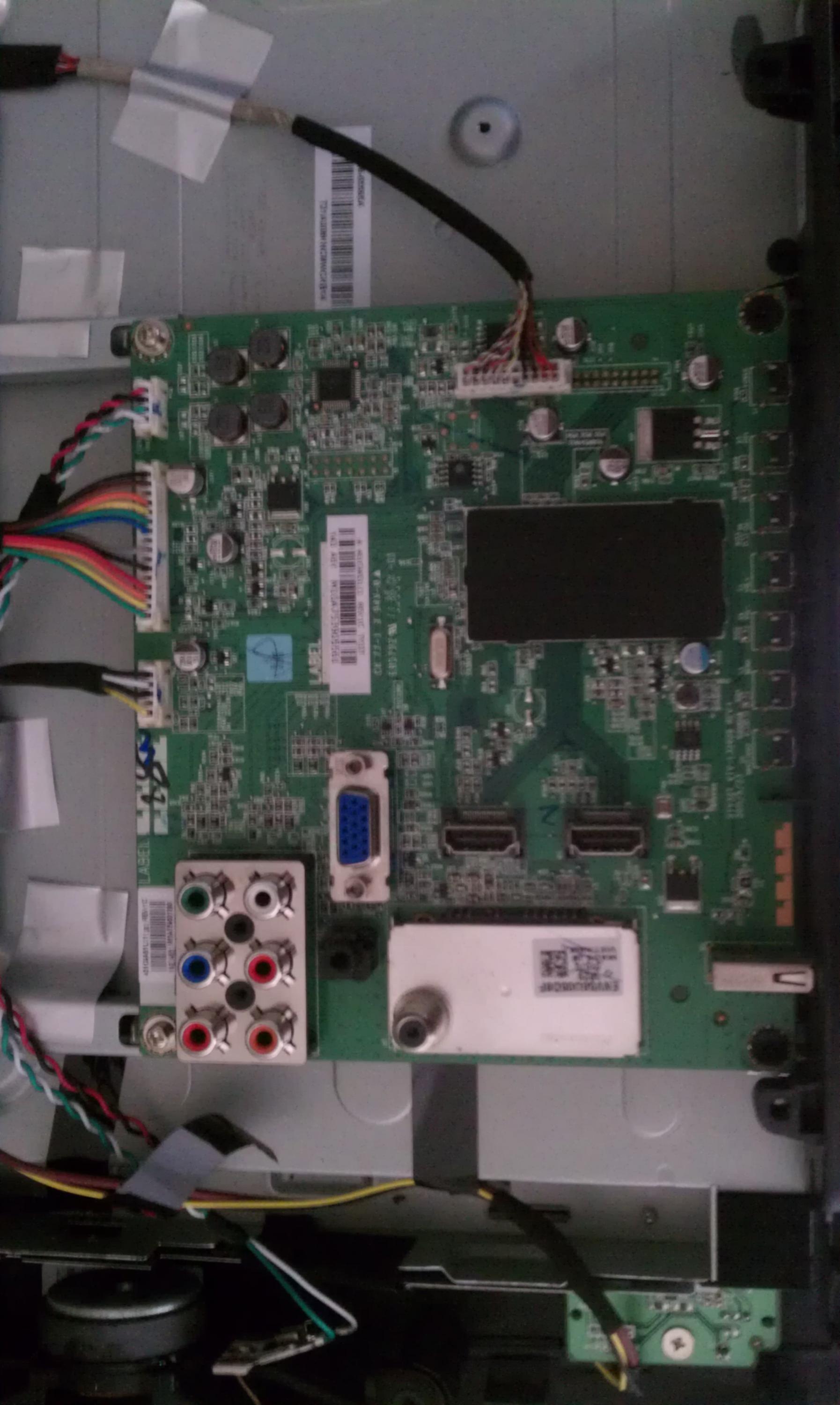

                    1) So PWR is stuck at 3.3V and when power switch is toggle on and off it does not change state?
                    2) That inv 3.3v on P802 but not at P803 is not right since the connection of the INV pin of P802 is connected directly to inv pin of P803. The power supply board is used as junction point only to transfer signal from main board feeding into P802 and come out at P803, it is done like that to make clean wiring. So you need to verify that.
                    It seems to me you may have main board problem. Is board hit by surge or lightning? What is the history of this TV?
                      no idea on the history of the TV.
                      power is stuck at 3.3v i have monitored it while pressing the power button.
                      dim is 0 on both connectors
                      inv is .25v on both connectors.
                      i must have been seeing zero cuz i was on 200v on my meter or something....
                      Don't fear the repair...

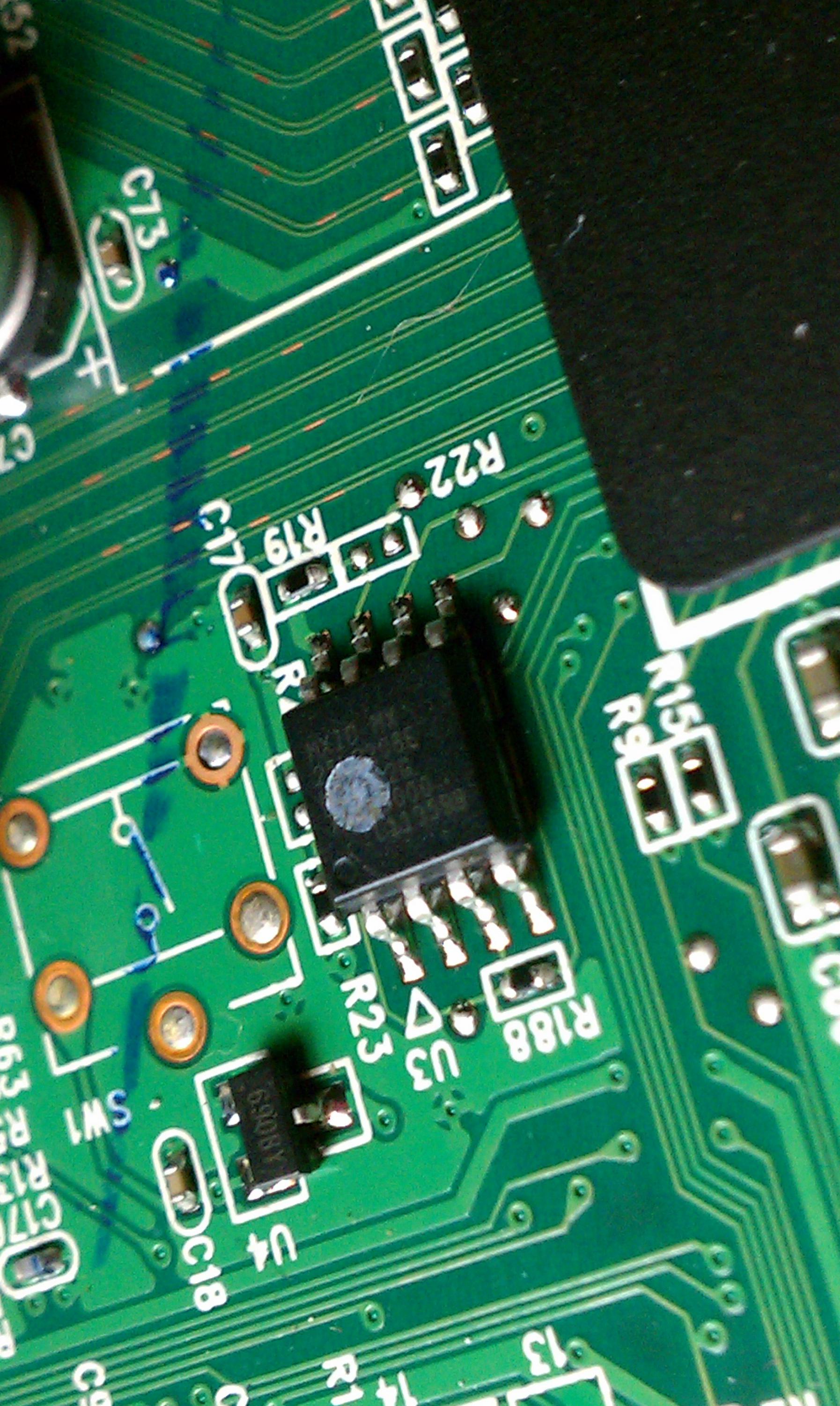

                        If the PWR signal is stuck and cannot be toggle HI/LO by power switch, then it is the main board problem. Then you need service manual to find out how that PWR signal is generated.
                        • mmartell
                          • Oct 2013
                          • 3189
                          The mainboard is remembering its last state (on) but probably malfunctioning beyond that. Any voltage regulators on the mainboard ?
                          • triplefour
                            • May 2014
                            • 1747
                            yeah there are some... guess i better test em
                            i see on ebay an eeprom chip for sale and the problem they say it fixes sounds kind of like one of the things it was doing (though it was mostly doing other things)
                            " Toshiba 32DT2U1 TV that experiencing intermittent or permanent dead set
                            failure symptoms
                            When the TV is turned on, the green LED lights up for 3-5 seconds, then whole TV shut down with no display. This will happen more and more frequently until finally completely dead
                            Only is an EEPROM Programmed
                            The eeprom you receive may be different from your original but it is a compatible replacement.
                            All sales are FINAL and NO RETURNS will be accepted. "
                            :/ and i really cant find a service manual...

                                nope no scope..
                                how would i tell if that eeprom is bad before gambling $11?
                                http://www.ebay.com/itm/EEPROM-FOR-T...item3ce1824fe7

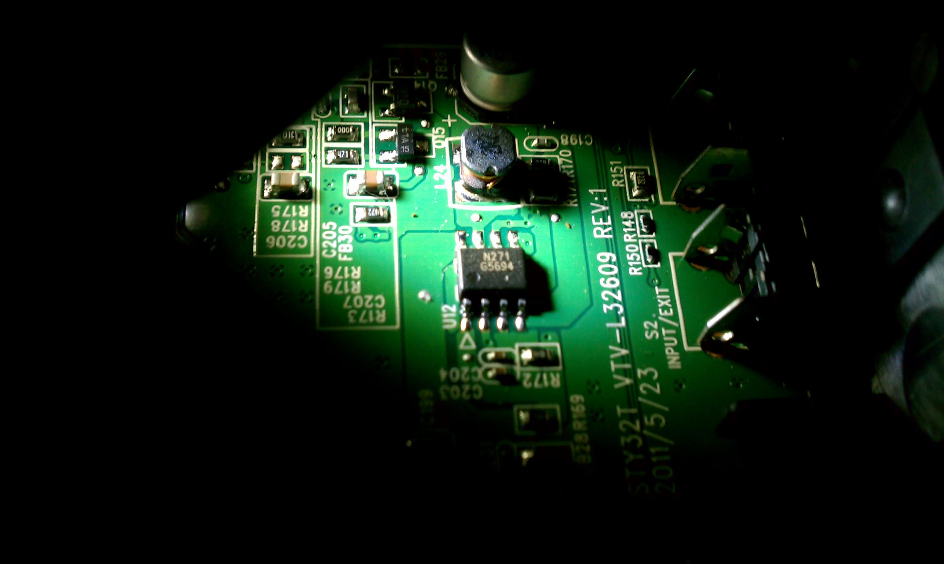

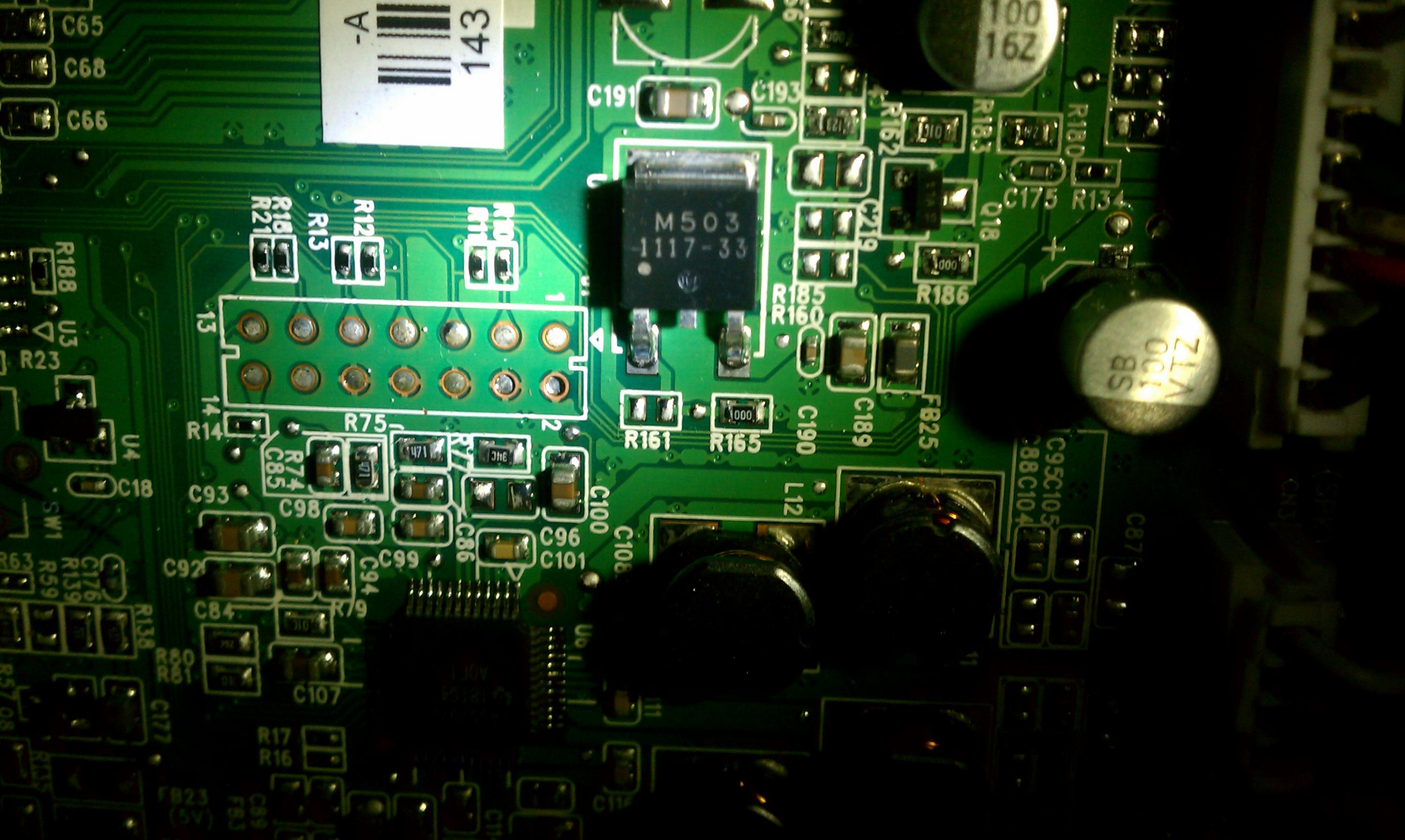

                                heres the pictures of the regulators. voltages coming soon
                                  ok heres the voltages
                                  N28A
                                  9117-50
                                  1)0
                                  2)5
                                  3)11.93
                                  M503
                                  1117-33
                                  1)0
                                  2)3.3
                                  3)5
                                  N282
                                  G1084
                                  1).54
                                  2)1.79 (-.54 = 1.25 so this ones good)
                                  3)5
                                  N271
                                  G5694
                                  1)5
                                  2)0.8
                                  3)0
                                  4)0.8
                                  5)0.5
                                  6)0
                                  7)1.19
                                  8)5
                                  EEPROM
                                  1)3.3
                                  2).02
                                  3).18
                                  4)0
                                  5)0
                                  6)0
                                  7)3.3
                                  8)3.3
                                  B20
                                  P03
                                  CDF0415
                                  1-4) 11.9
                                  5)0.4
                                  6)0.4
                                  7)0
                                  8)0.4
                                  need to lookup datasheets on the IC's but the regulators seem fine to me.
                                  • triplefour
                                    • May 2014
                                    • 1747
                                    i cannot find the datasheet for N28A 9117-50 no matter how i break it up...
                                    seems like a normal 5v-12v regulator though
                                    cant find N271 G5694 either...
                                    cant find the b20 p03 cdf0415 either...
                                    grr
