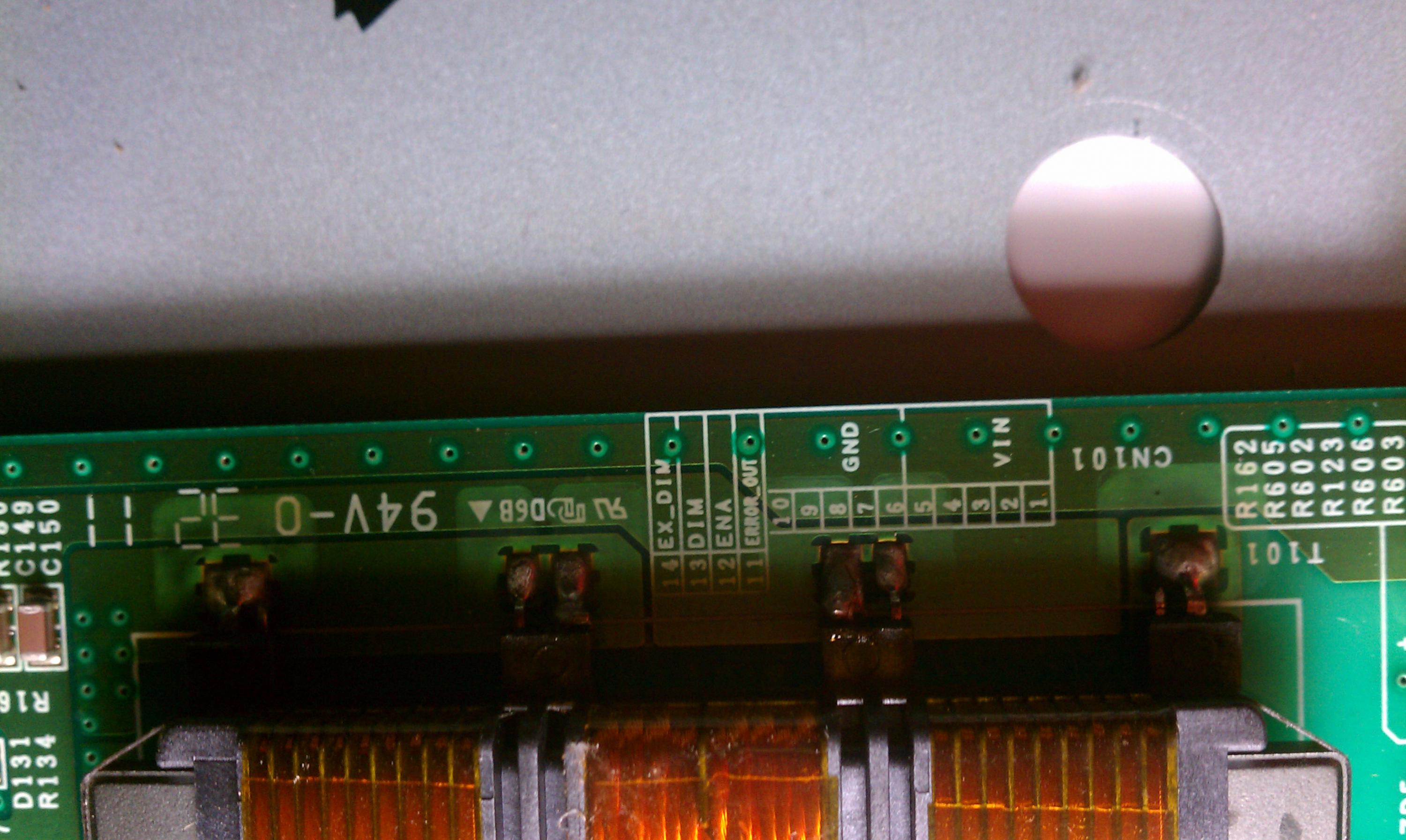

          well i revisited this one today and i guess it just needed to rest because now its at least turning on when i press power. steady green light. and i was even able to hook up my n64 and hear some sound and when i shine a bright light at the screen i can see the graphics. i have 24v going to the inverter, but im guessing the inverter is just not doing its job.
          i dont even get a flash.
          there are 4 voltage regulators on the inverter, 2 of them read all zeros, the other 2 read all zeros except the middle pin/tab which reads 24v
          does that seem right?
          Don't fear the repair...
            Re: Toshiba 32DT2U1 has 5v but no stby LED, wont power on

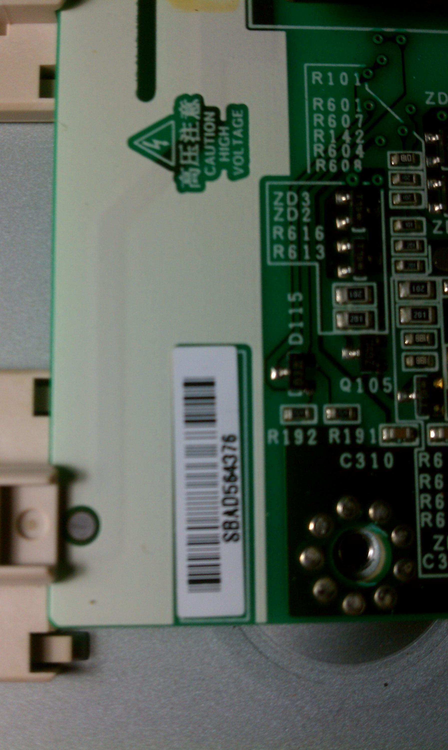

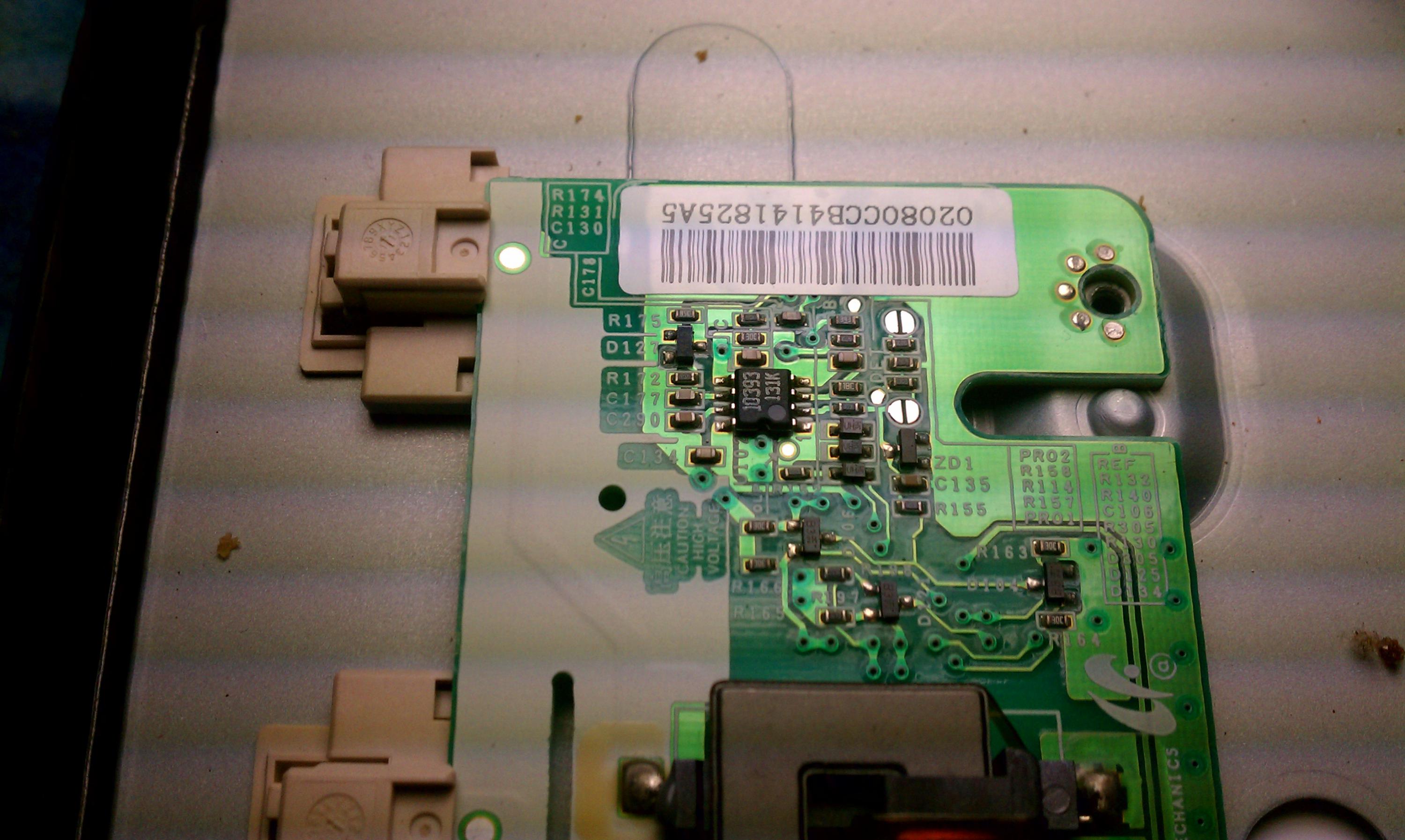

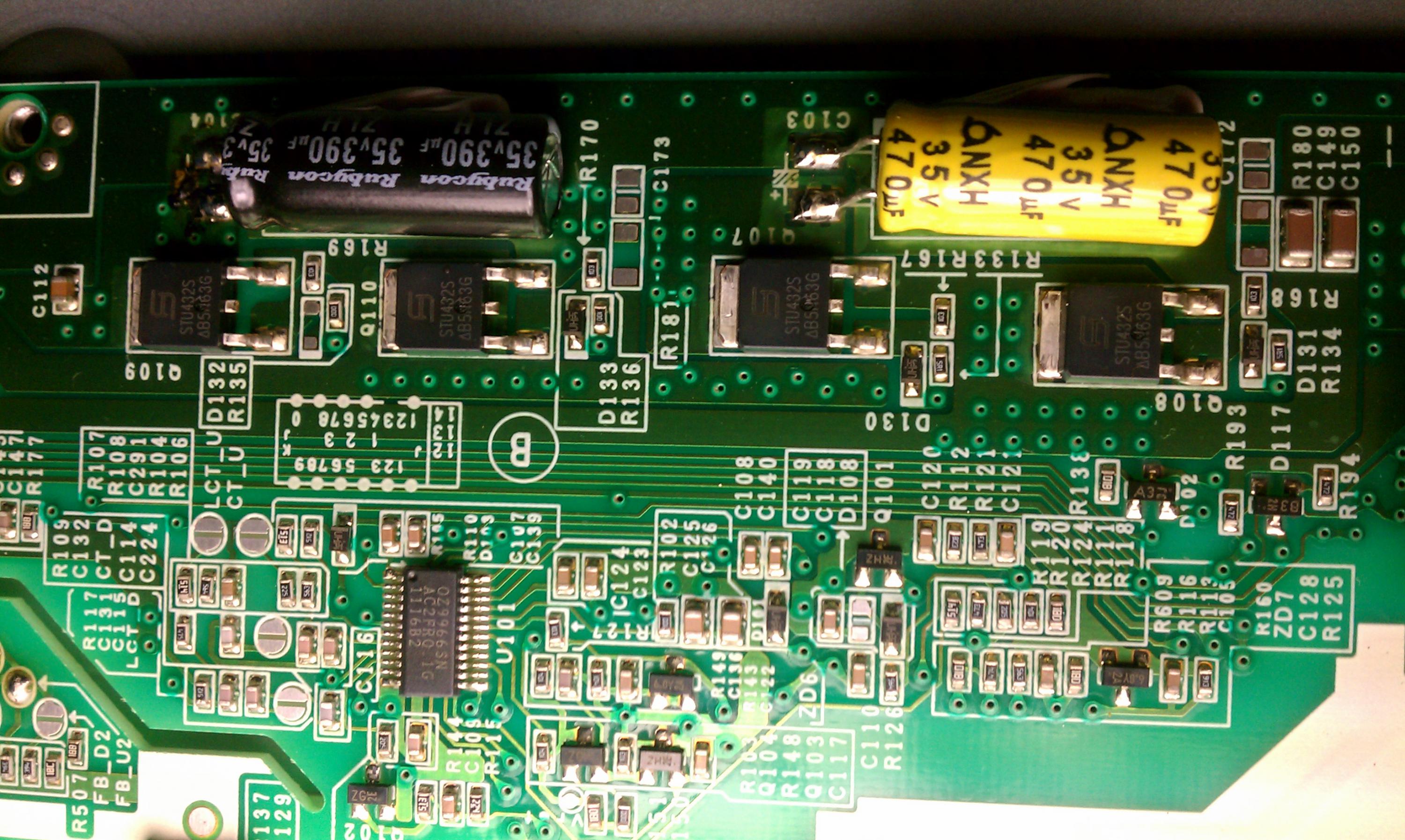

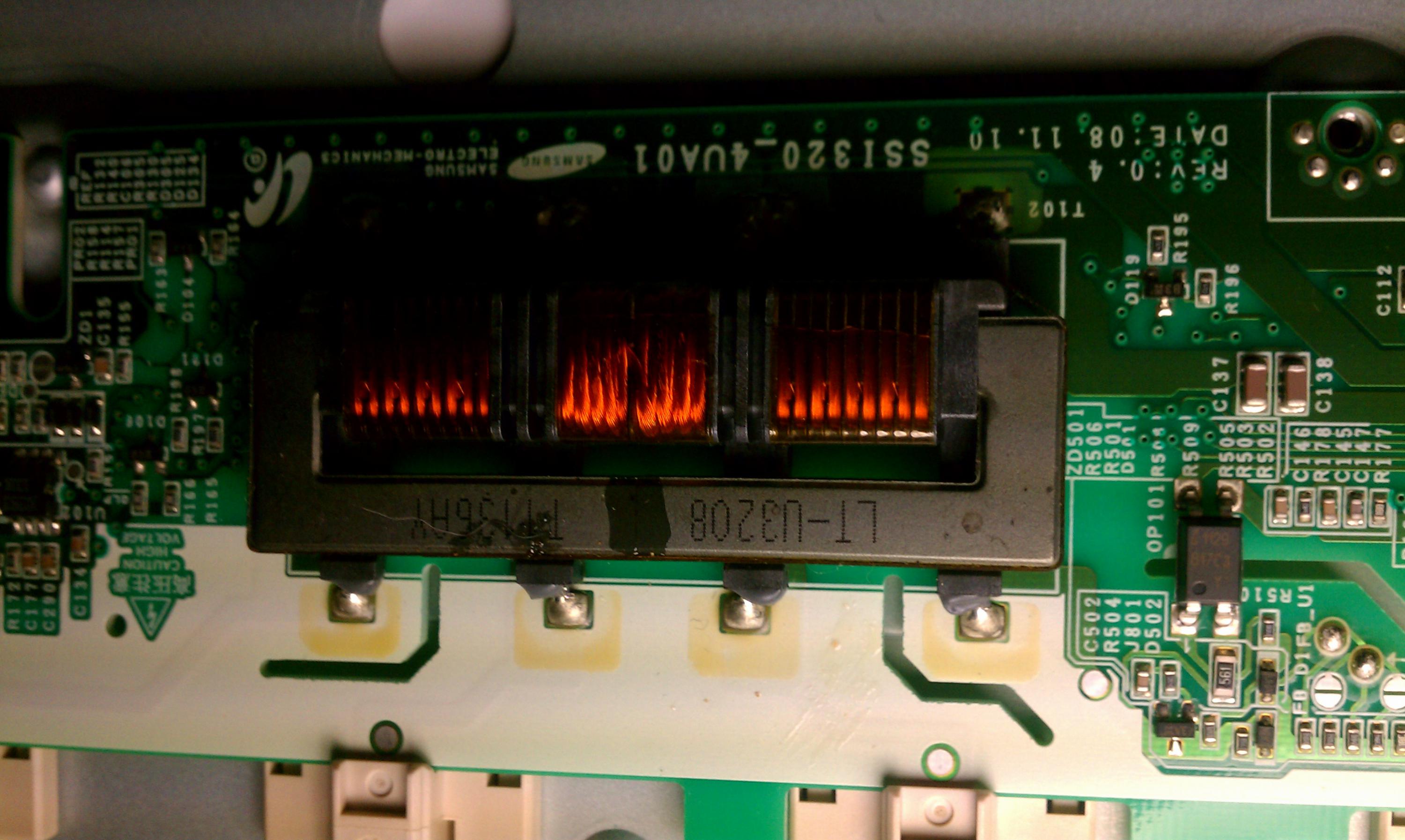

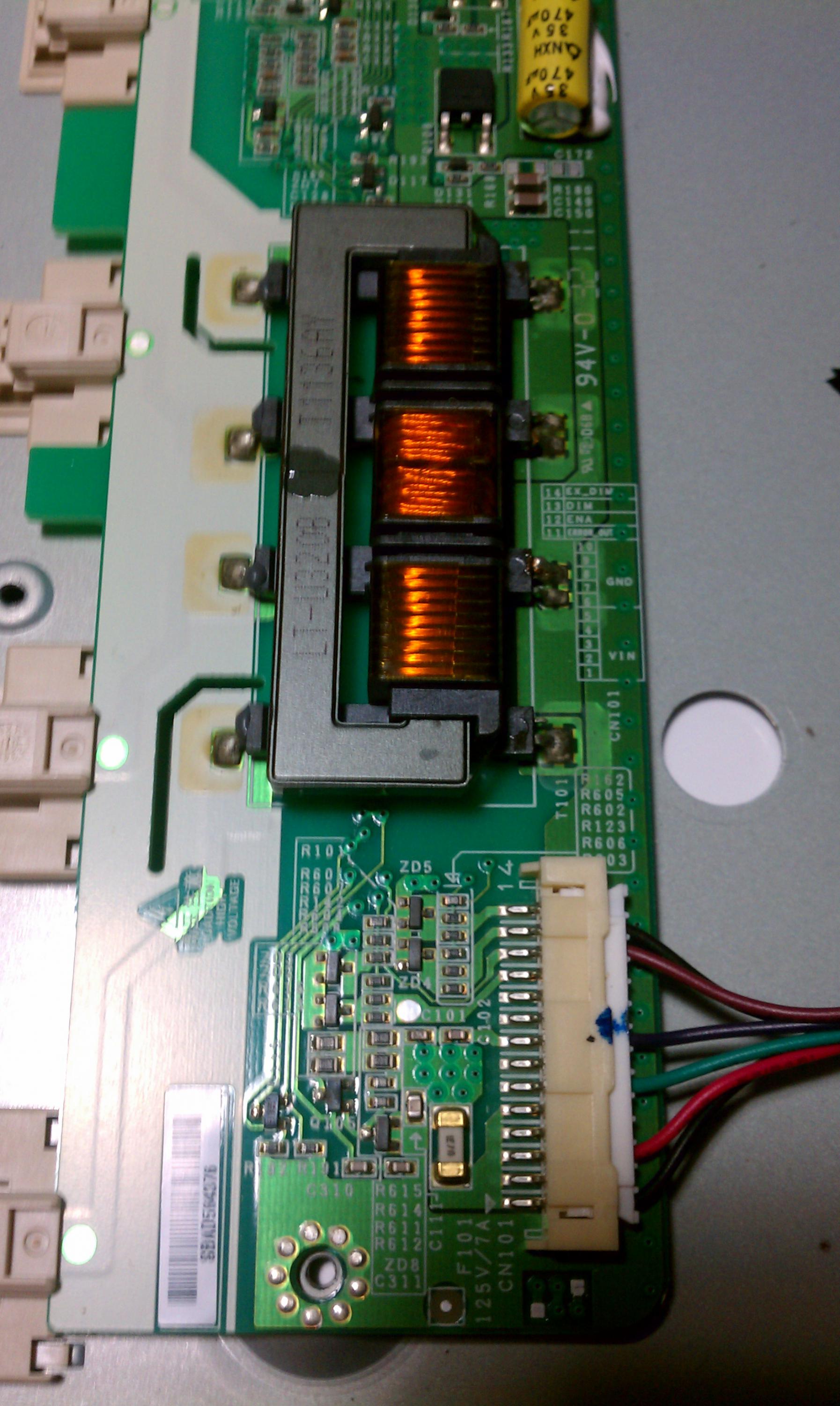

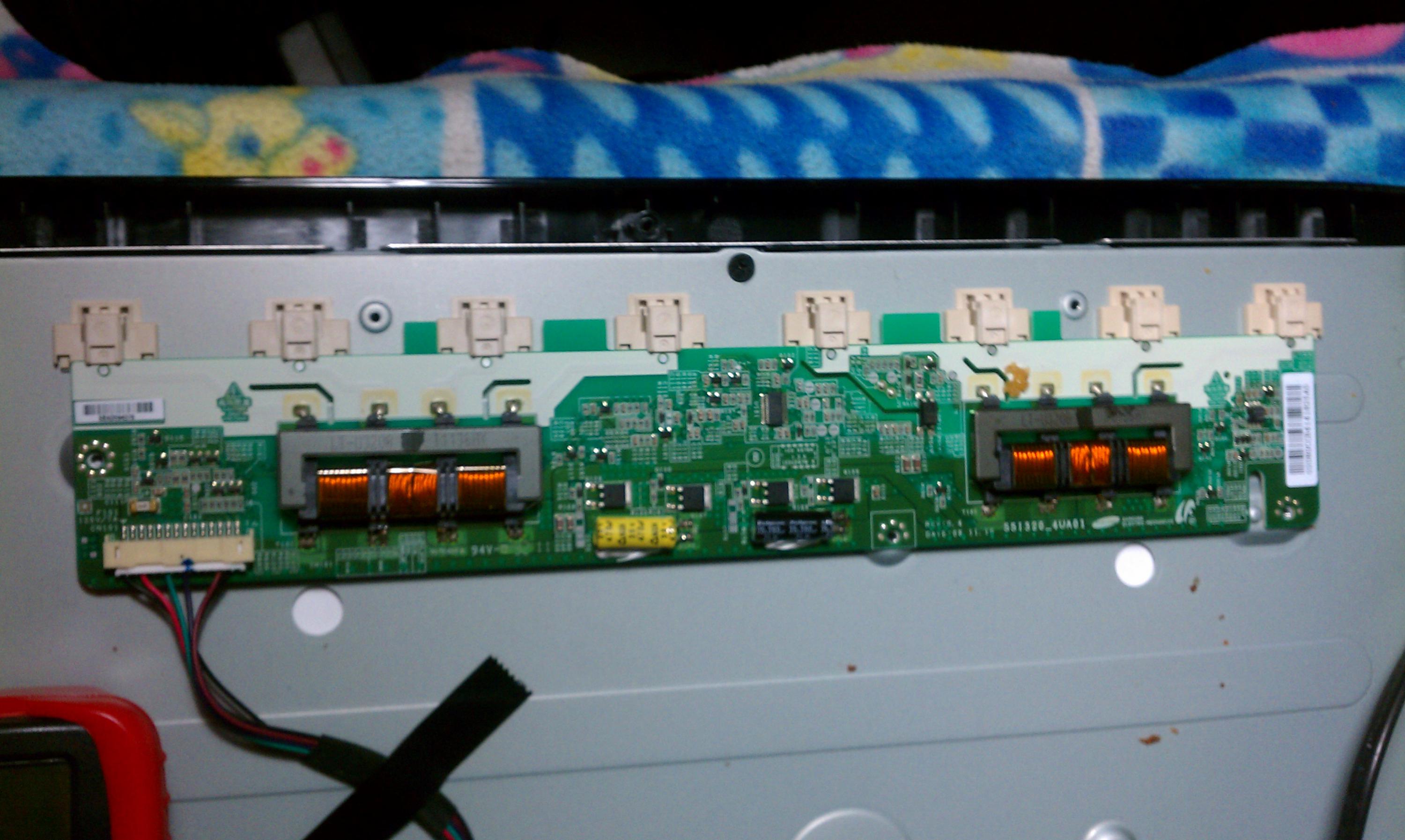

            heres some pics of the inverter.
            i got 24v on the positive legs of both electrolytic capacitors
            i got 24v on the fuse
            i got 0v on the smd capacitors
            i got 0v on all the legs of the IC's except 15v on one of the legs of the 4 leg IC
