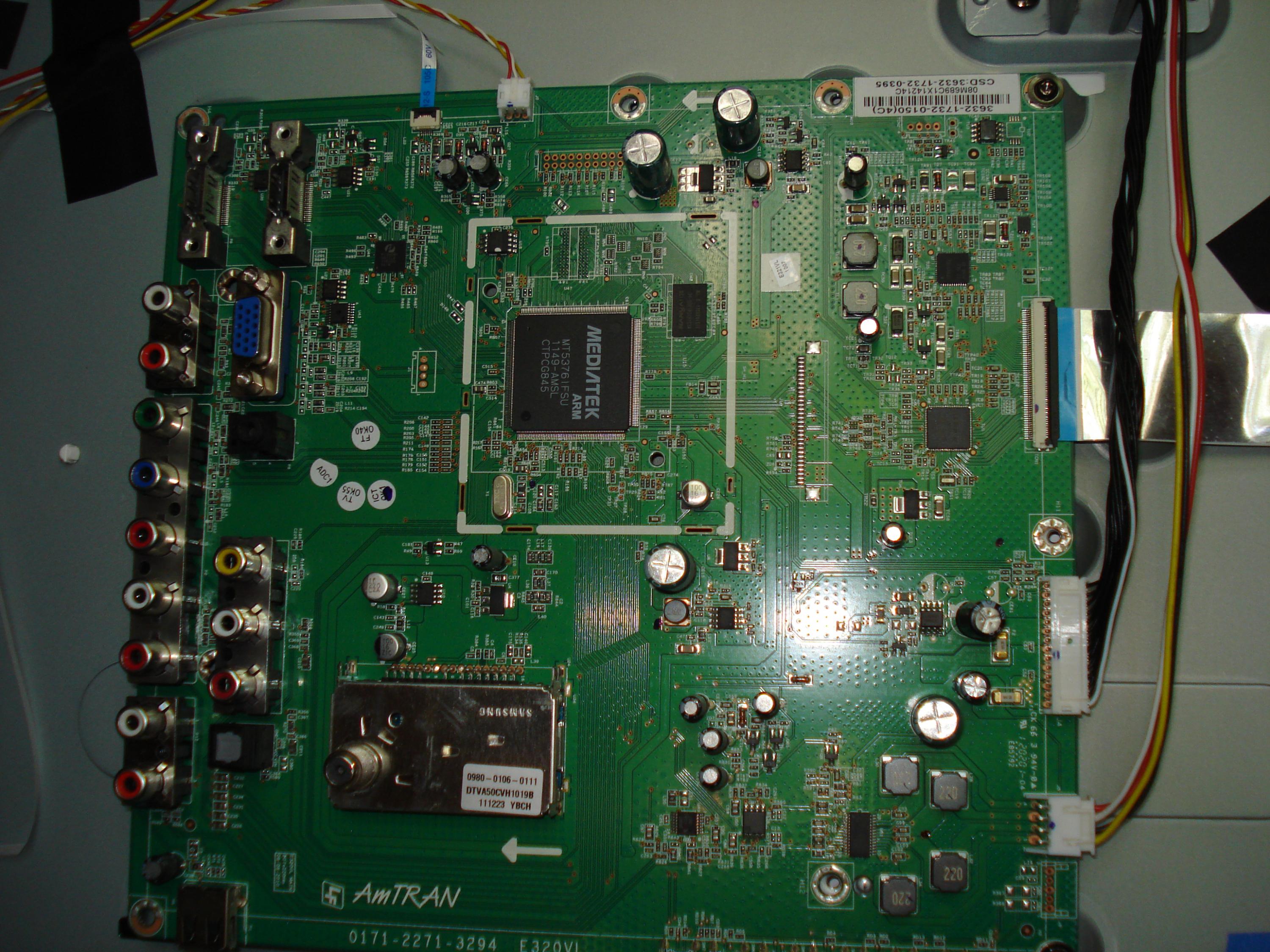

    How about upload good clear pictures of the board so we can see what we are dealing with.

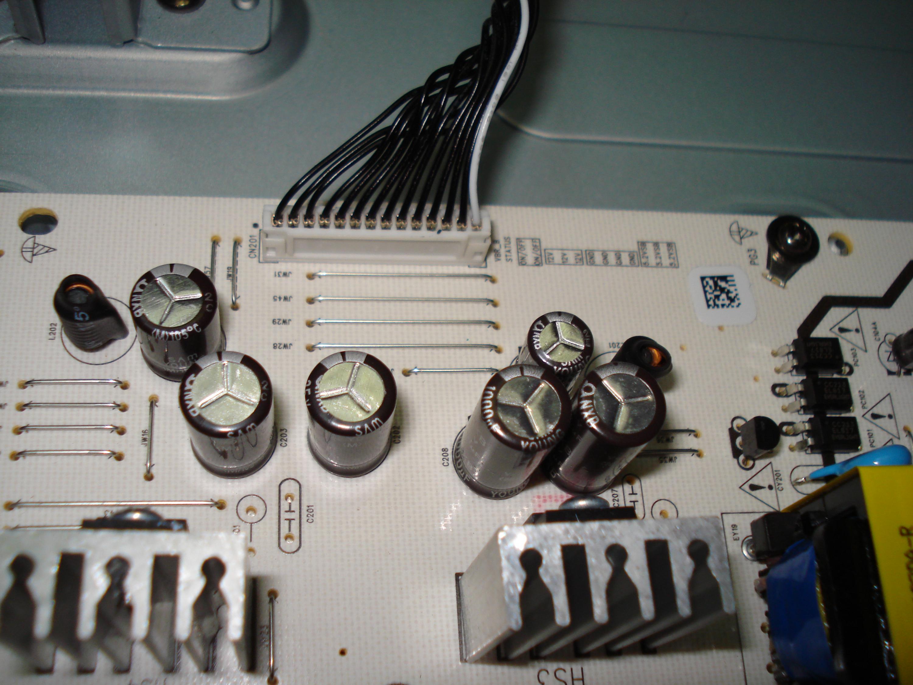

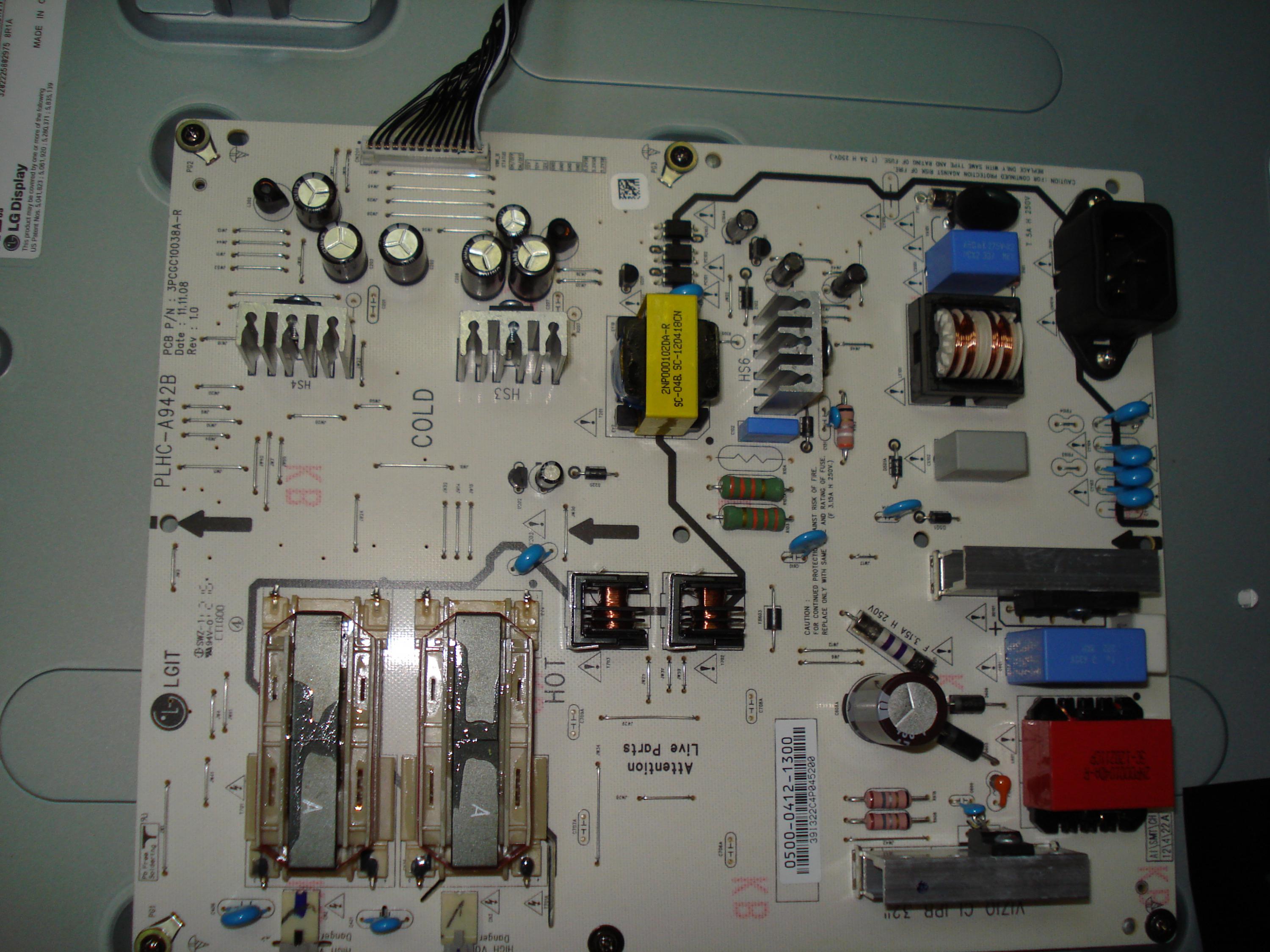

      Sorry, I could not find my camera and my phone takes lousy photos. Attached are requested photos. The power supply is a replacement but both look identical and none of the caps appear to be blown. I know what they look like when bad. I have changed about 50 over the past few years fixing LCD monitors.
      Thanks for having a look. I was hoping to find a way to measure something with my meter to confirm the bad board or jump something to kick start the power supply. I have an analog scope if that helps.

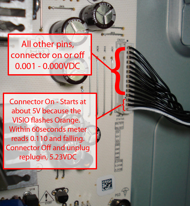

                Re: Vizio E321VL no signs of life.
                Give us the voltage readings on each pin that connector CN201 when TV is plugged in but nit turned on and when power switch is activated.
                List the name of each pin with its reading.
                  Immediately after plugging in the power cord, the visio light goes to orange for about 200ms. So ... flash on then off. The meter jups up and doesn't have time to read the voltage because it is falling very fast. Within 60 seconds the meter reads 0.110VDC and a minute later was 0.090VDC.
                  If I remove the connector the power starts creeping up but if I unplug the tv and replug it back into the wall, then the power jumps back to 5.23VDC and remains steady.
                  I replaced the tuner board/mainboard and it does exactly the same thing as the original board. I unplugged the IR cable from the main board and this doesn't change anything either.
                  See attached photo.
                    Last time when I had a creeping up voltage on one of these/or similar Vizio TV, it was one of the capacitors in the power supply.
                    I believe Bud or Tom suggested, to look at the start up capacitor by heating it up and monitor the voltage.
                      Actually it is creeping down and not up. Is the start up cap the big electrolytic or is it a ceramic, one of the little guys by what are probably the regulators?
                          C105, C104.
                          Heat them with hair dryer, then apply power to TV, no need to turn it on since that is the standby power supply which is always on.
                          http://www.shopjimmy.com/media/catal...1010-front.jpg
                          It can also be that the main board is drawing too much current, you can also use 10 Ohms resistor to simulate the load to see if it can handle 1/2A load.
                            With everything connected and I heat the capacitors 104 and 104A on my board, 0.053VDC steady. When they cool back down the voltage jumps up and starts dropping. My meter starts registering at .5V and is quickly dropping and after a couple minutes 0.05v.
                            With a 10 ohm resistor, 5.20VDC and heating brings it up to 5.24VDC. I could not run this very long because my quarter watt resistor was getting hot. It was the only size that would fit in the connector and for a short test it was ok to get hot. I have plenty more.
