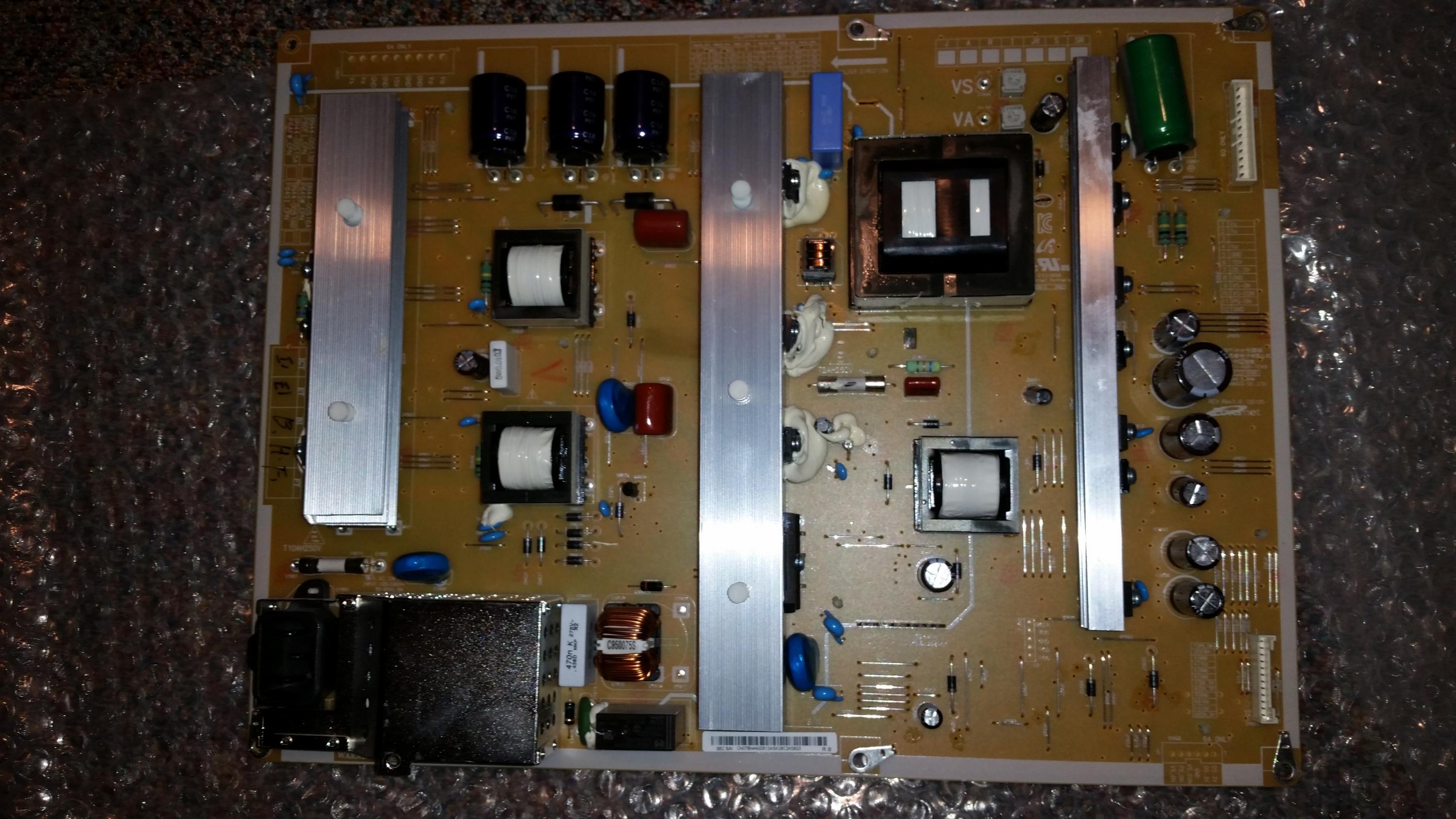

    The other day I was watching TV and all of a sudden my power strip turned off, turns out the circuit breaker was tripped some how. When power was restored I plugged the TV in and it made a loud buzzing sound for a second and then died. I don't get a standby light or anything. I took the back off and looked at the power supply board thinking that was the problem, and I did see a small burn mark on the back of the board. Thinking that was the problem I got a new board, but my TV still doesn't turn on.
    I was hoping somebody here could help me try and figure out what is wrong and if it is something I can fix. I attached a picture of the power supply and the model number is BN44-00513A.
    Thanks!

    Re: Samsung PN60E6500EFXZA no power or standby
    well my first question with is this the new board or the old board?I would check the pin out voltages on that then test if it could be your main board. if you read your pinout charts and short out the on off switch to turn on the board and short out your inverter on pin you can get the board to turn on the screen and test the supply. Then you know its the main board.
    I'm not sure what your level is. But if you don't know where the charts are they are next to the ribbon cable ends On your board which I can see in the picture and it should list pins one through 20 and whether or not there is, no connection, voltage or gnd.
    on most of my samsung boards I short 1 and 3 for power on.
      I'm fairly new to this but work in consumer electronics and see people doing this kind of stuff all the time so I think I can figure it out with some guidance. I just got a multimeter and started testing parts. It turns out the fuse in the bottom left corner of the picture is blown on both boards. So does that indicate a problem on some other board?
      I see the on the pinout chart the on switch and it matches up with your suggested 1 and 3 pins. What is the inverter pin though?
        The blown fuses could have been from the surge on off. Replace them or short them(like we do lol)and see what happens. I use a piece of solder wire because it will melt if its too hot from amp flow.
          DON'T SHORT A FUSE! WTF? That is the stupidest thing you can do. You want to blow a crater sized hole in whatever's shorted, and send shrapnel flying out of the PSU? Because that's one easy way to do that.
          Brentosmith, since both your new board and old board have blown fuses they are both defective. It is likely the seller did not test the board when it was pulled, so you will have to send the board back for a refund and get another one... hoping that the seller tests them next time (go for a different seller if you can)
            Thanks tom, I did plug the new board in to the tv first before I tested it. Is it possible that some other component on my tv could cause that fuse to blow, or does that indicate that the problem is definitely on the psu? I'd hate to send it back if the problem was mine and not theirs.
              If there was such a fault, you would have heard a loud "pop" from the fuse. Regardless it's essentially impossible for any attached board to blow a fuse on the power board - the protection circuit would kick in well before then.
