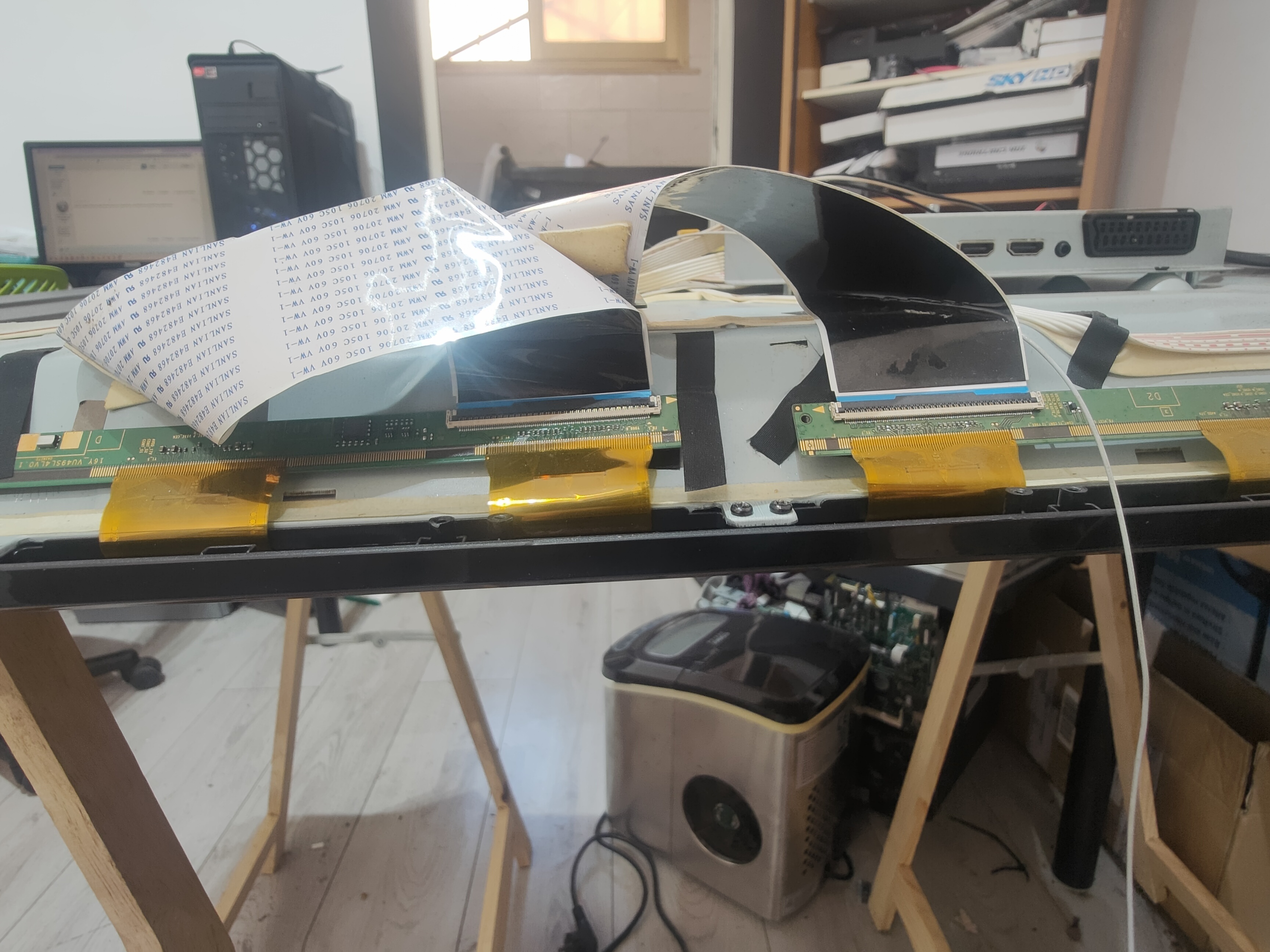

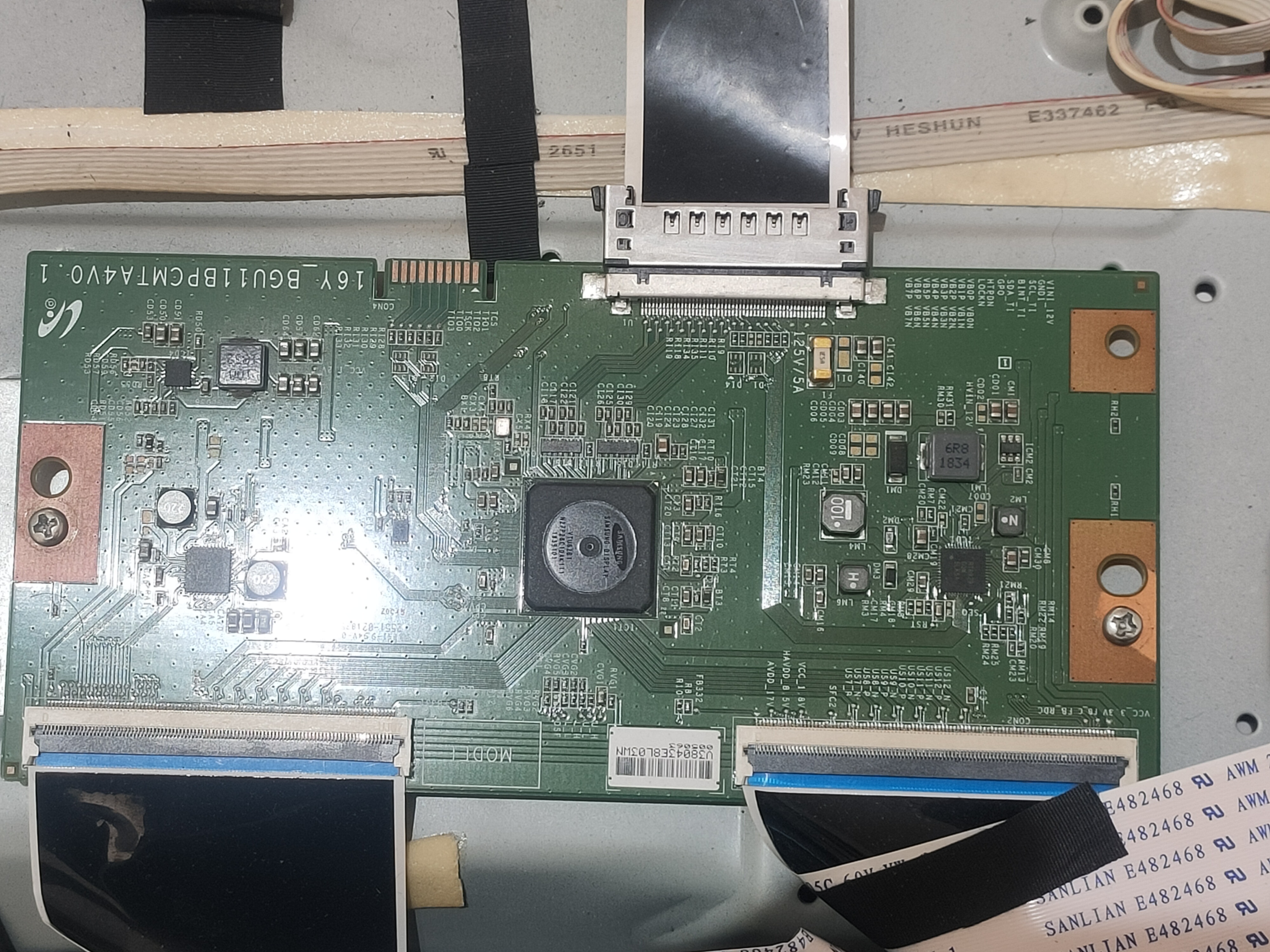

    Hi everyone,
    I have a TV with a black screen but working backlight.
    Thinking it was the T-Con board, I replaced it, but the problem persists. I tried unplugging the flat cables connecting it to the panel, first one and then the other, but the screen remains black. I also tried masking the pins, but nothing, I don't know what to do.
    Thanks everyone.

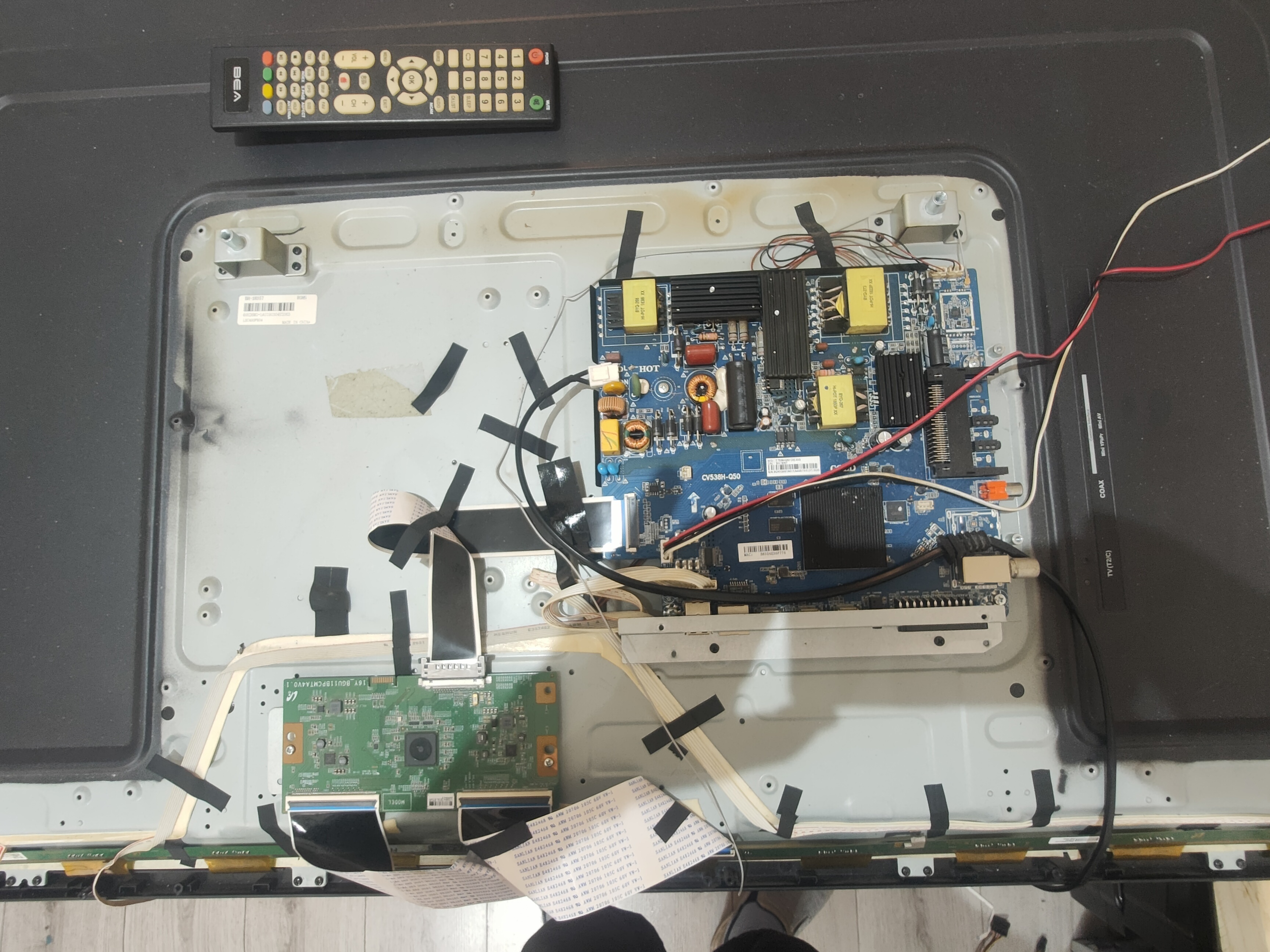

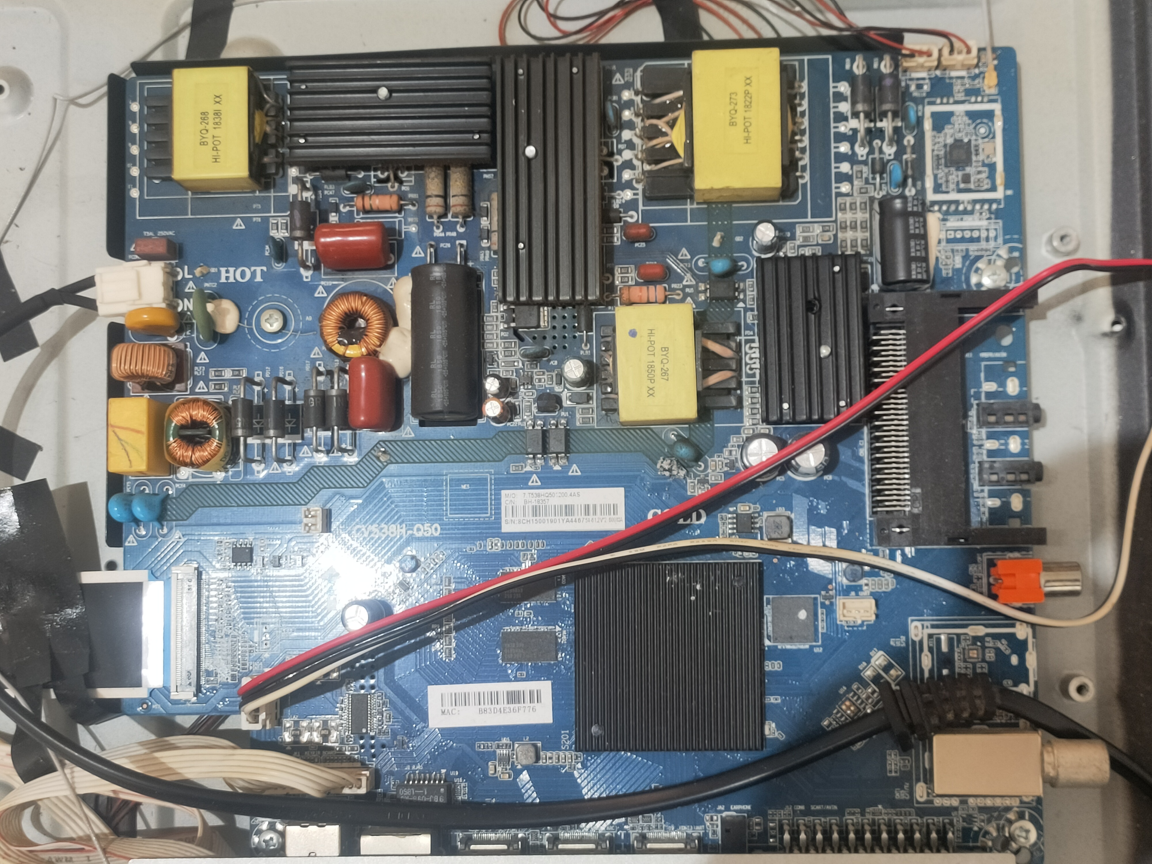

      Pictures would help, need good focused pictures of each board and one of the whole back as to see how everything is connected.

        Sorry for the delay, here are the photos of the TV

        T-Con Main Full view Connecting to the panel
          It is necessary to install a jumper on T-CON between points FB331 - FB332 and then disconnect one LVDS cable at a time.

            I had a similar situation with a TCL once before. The screen was blank no matter what I did. I gave up for a while and left it sit in the corner and then one day brought it back out for one last try. This time I actually got a half screen when disconnecting one of the ribbons. I found the pins for clock signals and blocked them and it's been working relatively fine in my son's bedroom since. It has noticeable lines from the missing signals, but from a few feet away it looks normal.
            I suggest you keep trying with those ribbons. Also check near the HDMI and inputs for a reset button. If it has one you may need to hold that in/press it a few times. Short of this there could be an issue with the main board not out putting any video. In this case there *may* be a way to get the tcon to display a test pattern with the main board unplugged. I've never accomplished this, but some other members may be able to help with that.
              With jumper and the right flat cable removed I have half a screen, while with the left flat cable removed I have a black screen.

                Thanks guys, between the jumper and the pin masking, the TV works now. It has some subtle horizontal lines, but they're only visible from very close up.
                Thanks again.
