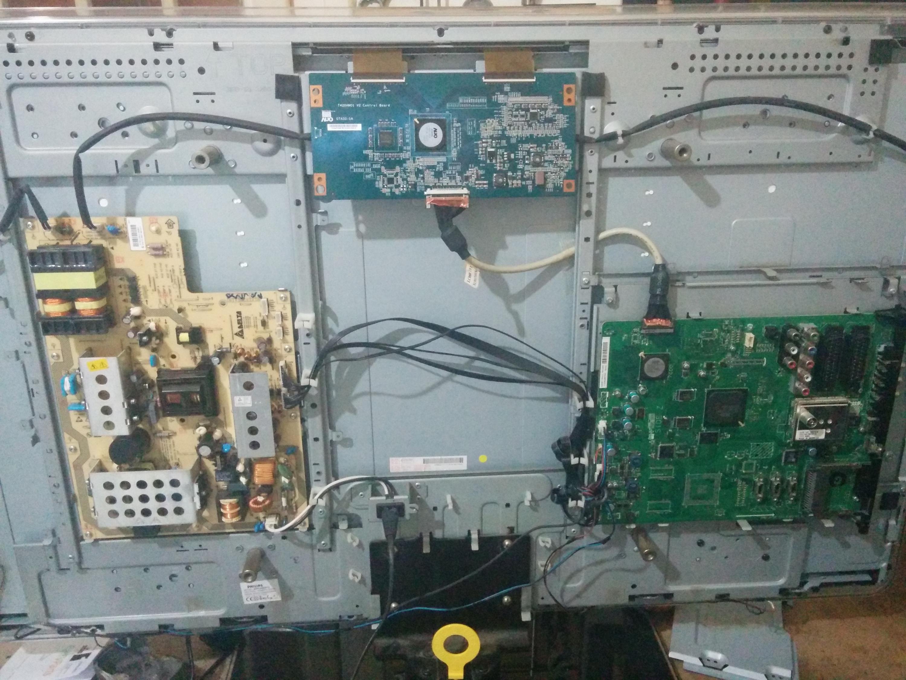

      Upload GOOD and CLEAR pictures of the whole backside of the TV so we can see what we are dealing with. Did you check the DC voltage at both ends of the SMD fuse on the T-CON board. Any one work on this TV before you? Did it just go out by itself or was it hit by the surge? The more info we have and the pictures will help, hard to troubleshoot something remotely without having the TV or the board in front of us to look at, I hope you understand that it is not easy doing remote troubleshooting with not much information.
      A lot of people will skip the post when they do not see any pictures of the TV, the boards, etc.

        Damn i knew i've done something wrong on first place and thank you so much mate for enlighten me on this.
        Yes i measure the fuse twice, it's not blown and i got 11.77v on both sides with panel ON.
        Also no leaked/blown caps or any other visible damage on all three boards.
        I also checked the set without T-Con connected and i got exactly the same behavior, only backlight on and the white led.

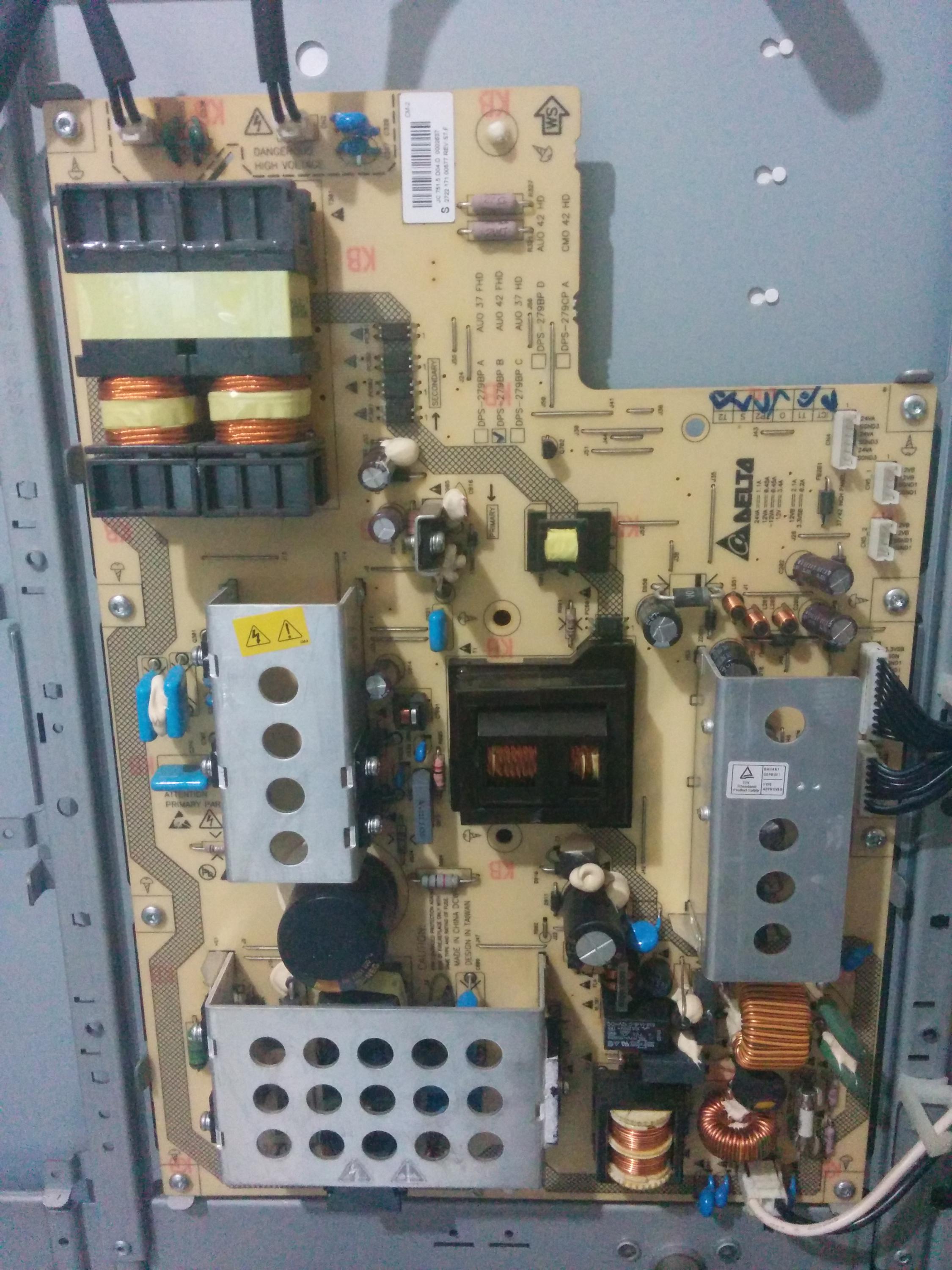

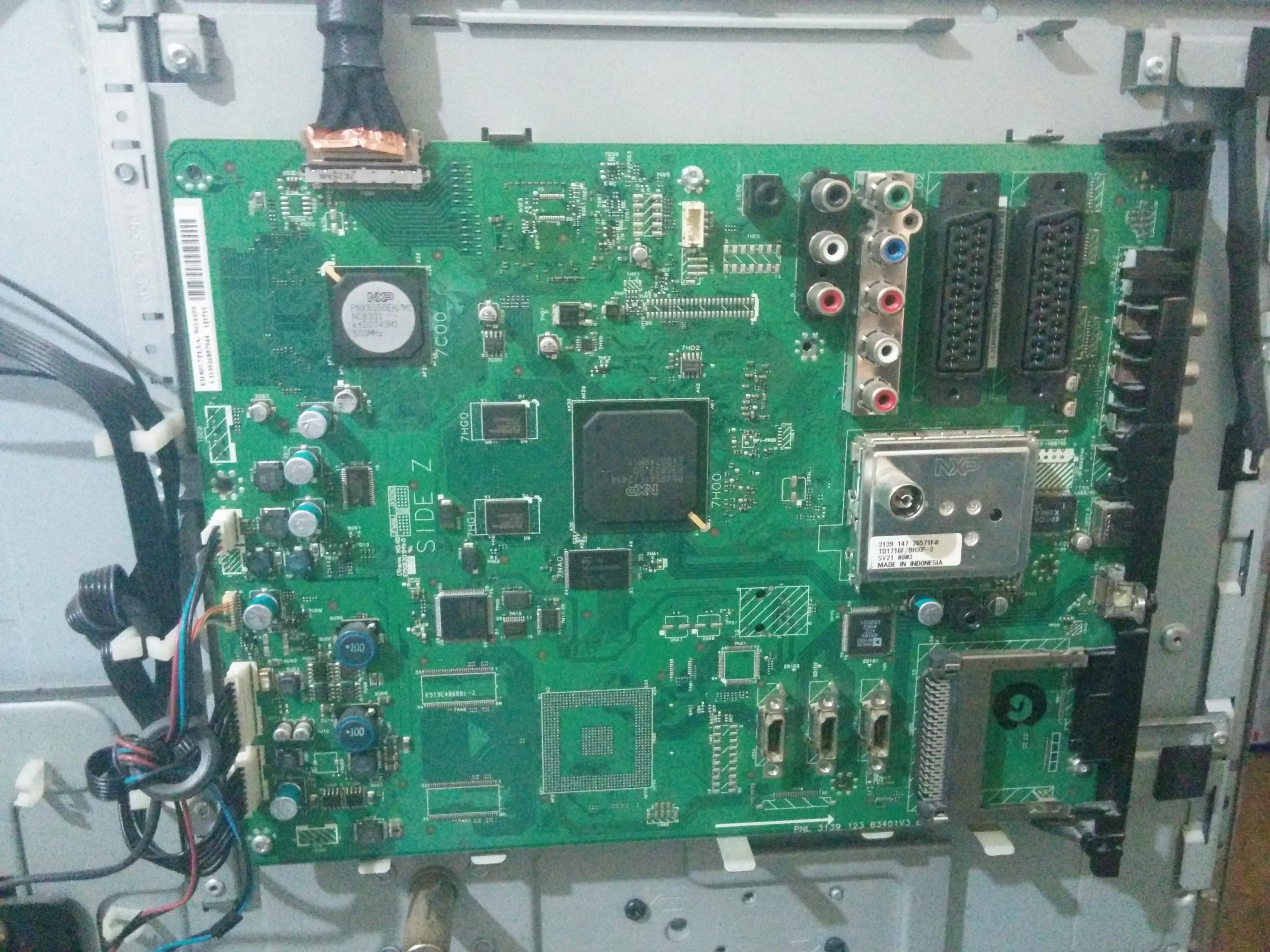

        I wanted to upload photos on the First post but it's impossible now so here we are :

            Ok photos uploaded. let me know for any other request or measure.

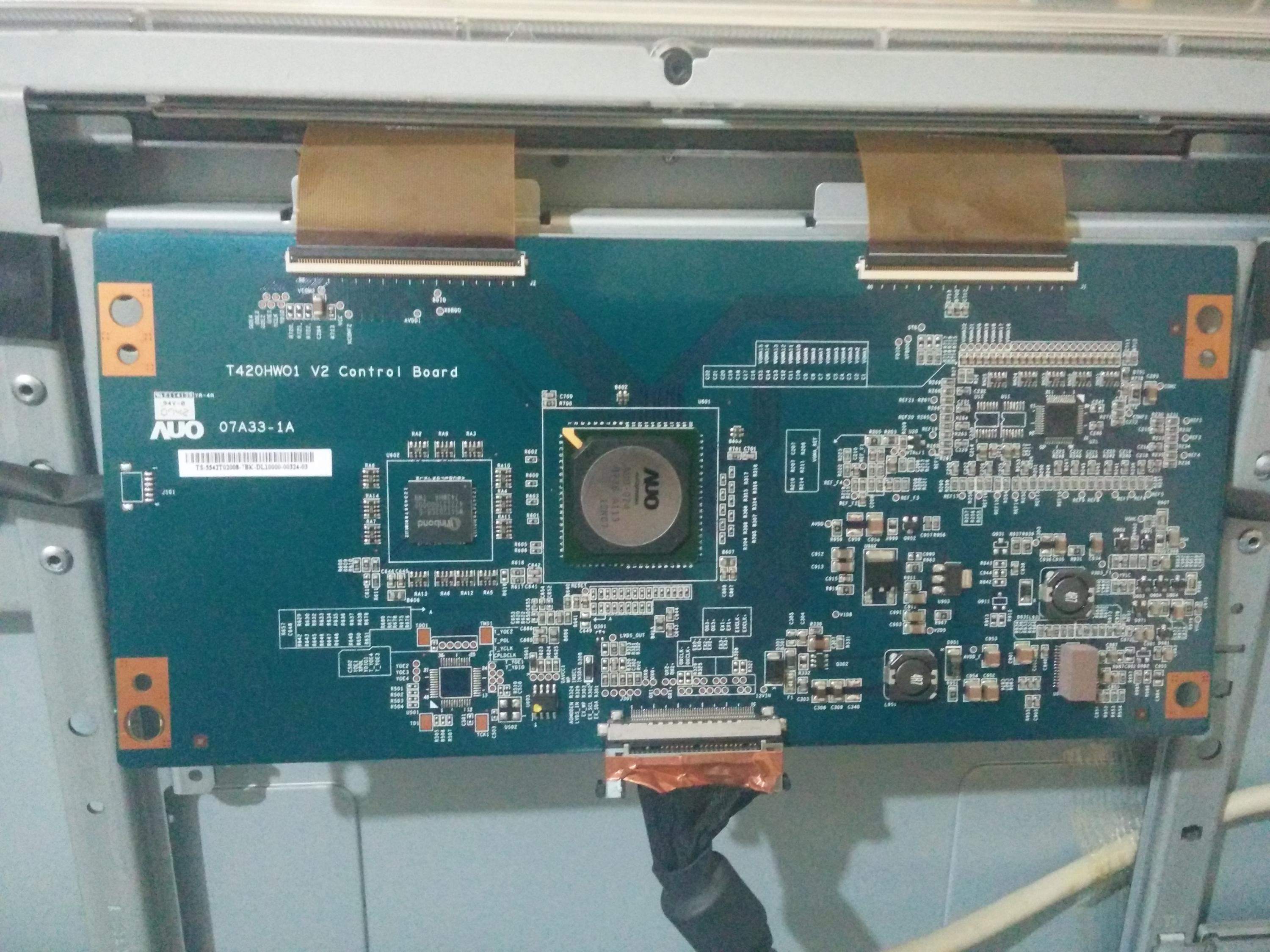

              Pictures could be clearer - I think I see 2 voltage regulators U992? U903?
              can you test those and say what the part numbers are

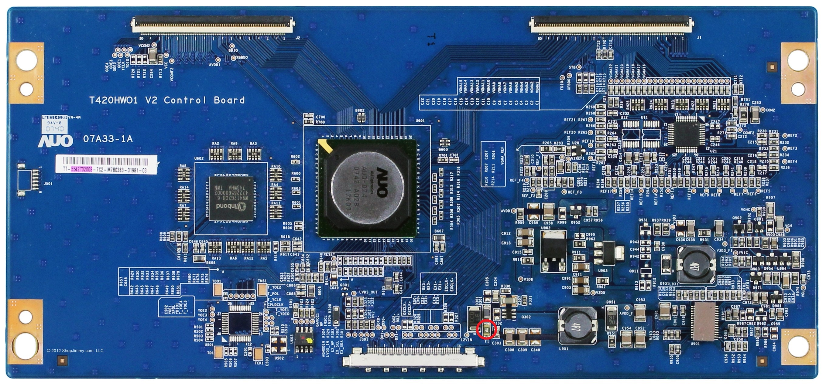

                  I checked the T-Con yesterday but i found only one fuse that unfortunately wasn't blown and had 11.77v on both sides.
                  Are you sure the T420HW01 V2 T-Con has two fuses ? I made a red circle on the one that i found, please point me the other one.

                    Those VRs are on the Tcon U907 and U903

                      I've zoomed in and looks more like U902 and U903. Not 907?

                          By both, I meant both T-cons. Not 2 fuses on one. Could be something else dead on them I suppose but that was the case with both mine.

                            ok got the measurments, the U902 has 0v on the left pin, the middle is on the air by default and the right one has 3.315v on it.
                            The U903 has 3.319v on the left pin, 0v on the middle and 2.841v on the right.

                                Doesnt sound right You still measure the stub - it gets its voltage from the pad
                                thogh 3.1 may be correct but as I asked I need the part number to confirm
                                The other one U903 seems to be off - looks like it gets pin1 voltage from the
                                U903 but pin 3 doesnt seem right if its measnt to be 3 its too low and if its meant to be 2.5 its a bit too high again need the part number.
                                What are the vgma readings on the 22 test points - should be between 20 and 0 vdc

                                  The U902 writes "50117 B-G 72175" and the U903 writes "APR 738" although i can't find anything about it on google, strange.
                                  Sorry but i don't understand very when the english electronic dictionary, what do you mean by "vgma readings" ?
                                  Thanks for helping mate
                                  • selldoor
                                    Slow Learner
                                    • Dec 2010
                                    • 7870
                                    Re: Philips 42PFL5603D Only backlight and white led.
                                    I cant see them either - perhaps the 902 IS a 1117 so 3.3 would be correct
                                    903 is still a mystery.
                                    VGMA - See top right of the tcon pictures there are 22 test points with
                                    capacitors underneath som have the labels above otherlabels are to the left.
                                    Just start at one end and list the voltage on each one

                                        Ok got them, measured from Left to Right.
                                        The pins 1 until 10 have 0.38v the 11 has 0.50v, the 12 0.20v (suspicious) the 13 until 21 have 0.5v and the 22 has 0.097v (suspicious too).
