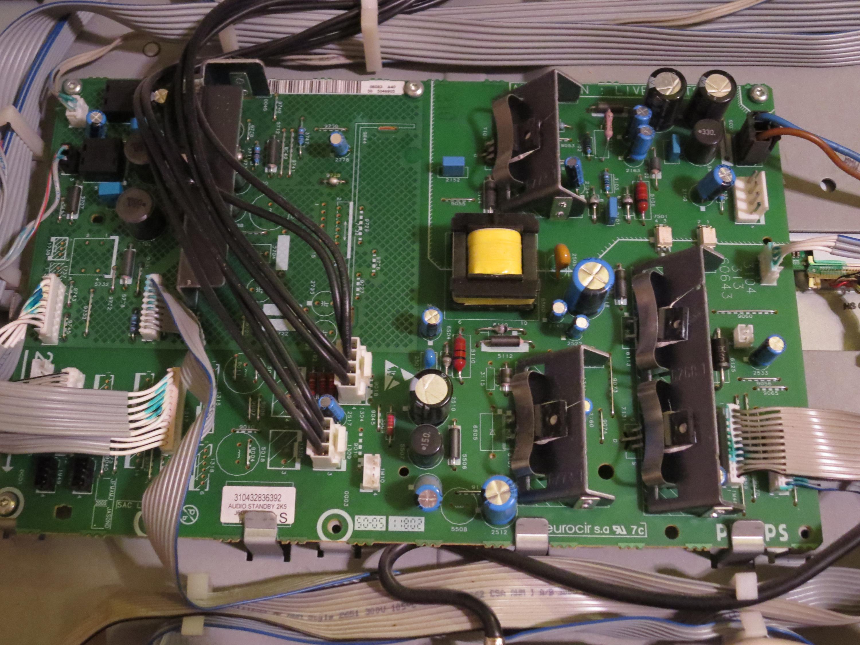

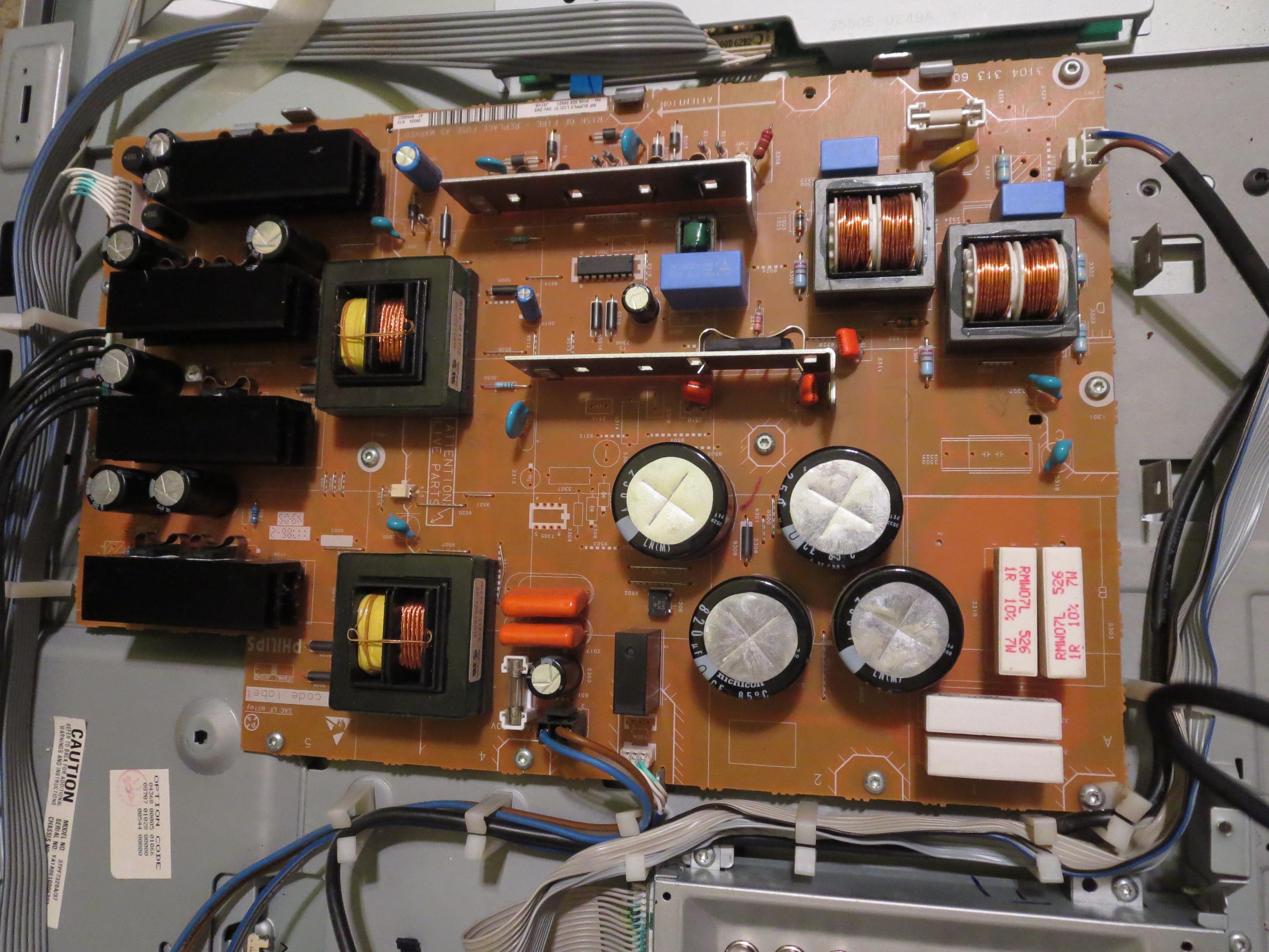

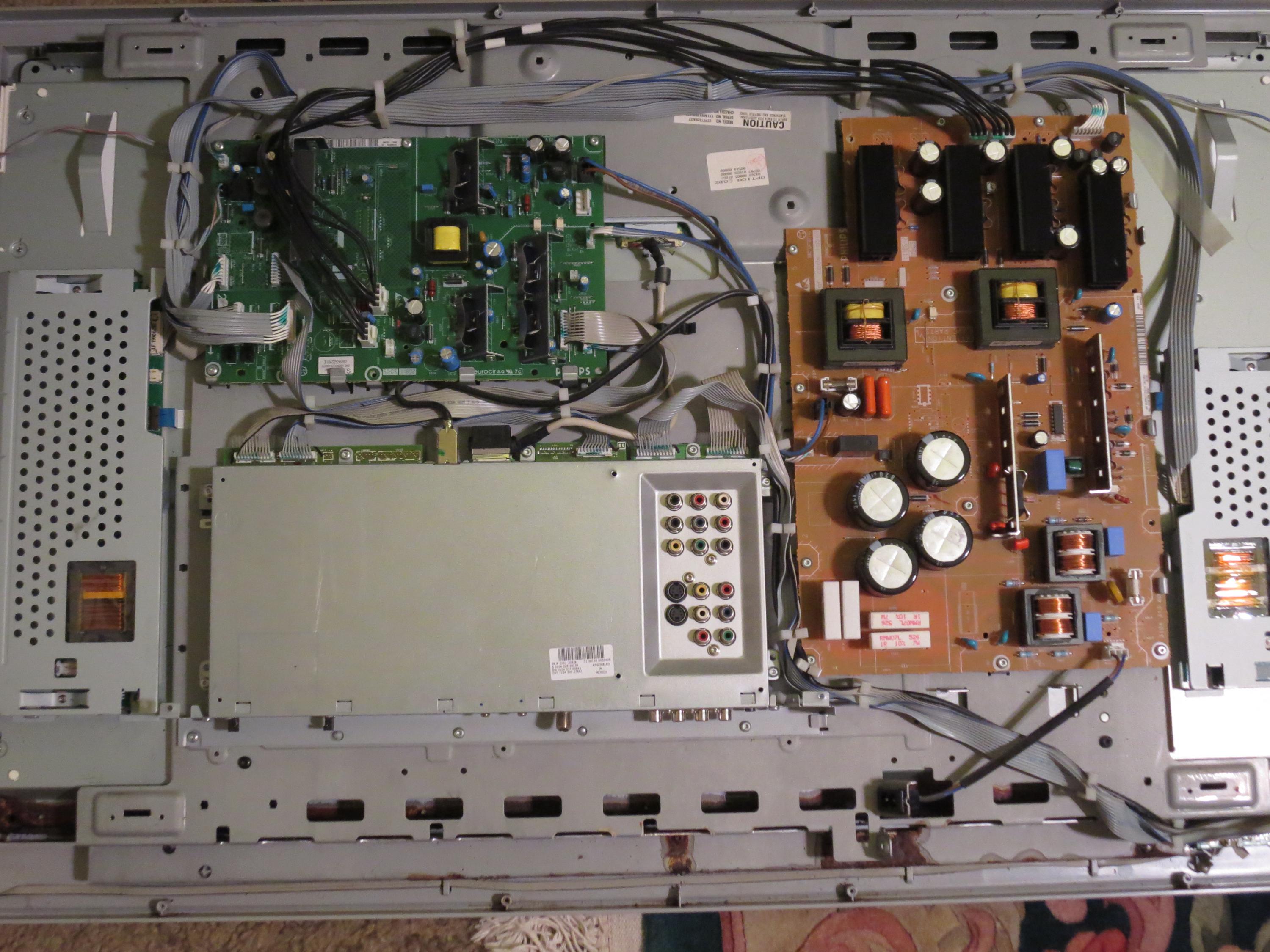

    I have a strange power issue with my 37PF7320A/37B LCD tv. After plug in the tv, I can hear one click, the red led flashes once, the green led lights up for a couple of seconds, then another click and every thing goes dead. Press power button, nothing. A funny thing is if I turn off power (unplug) to the tv a second or two after the first click, the back light comes on for an instant. But if I turn off power to the tv a few second after the second click, no flash of back light. I already checked resister 3318 and it is fine. All caps on power board and AUX power/audio board look fine. I also measure AC at the main rectifier and it is 0V after the second click. Please help, thanks.

      Do you know the chassis numbers as printed on the model sticker?
        Re: strange philips 37pf3720A/37B LCD power problem
        Here are pictures of my tv. The chassis is BL2.3U AA
