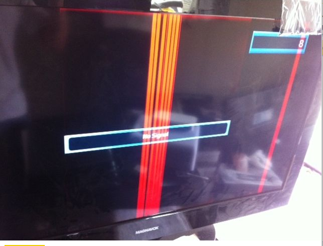

Panel problem? Magnavox 40MF40
  • tucocaps
    • Apr 2013
    • 331
    • United Stated
    Looks like another misdiagnosis from someone on ebay. He bought a mainboard to try to solve this, and it allegedly "didn't work". Thanks for any help, as it looks like I'll be losing again.
  • tucocaps
    • Apr 2013
    • 331
    • United Stated
    Re: Panel problem? Magnavox 40MF40
    just want to confirm if this looks like an obvious panel or tab bond problem?
    • Clydeuk
      • Jan 2012
      • 193
      Looks like the panel, may be worth removing the metal surround and applying gentle pressure at the tab bonds to see if any improvement. I assume it's an LCD.
