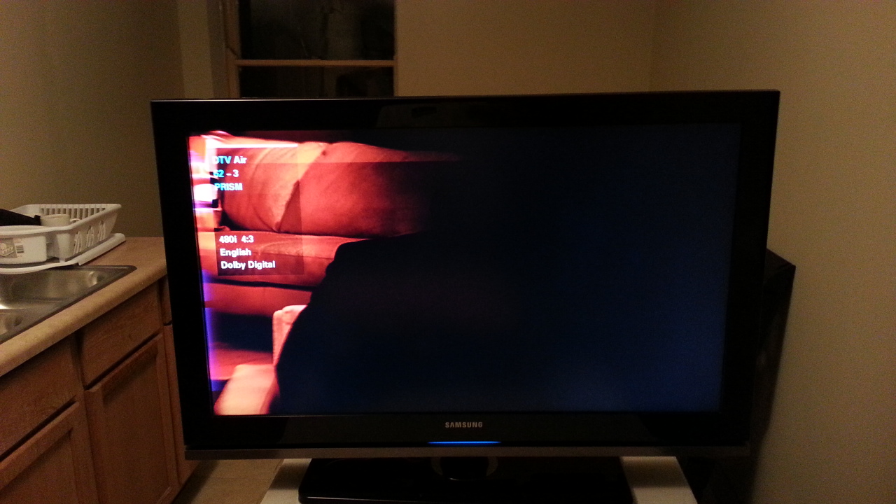

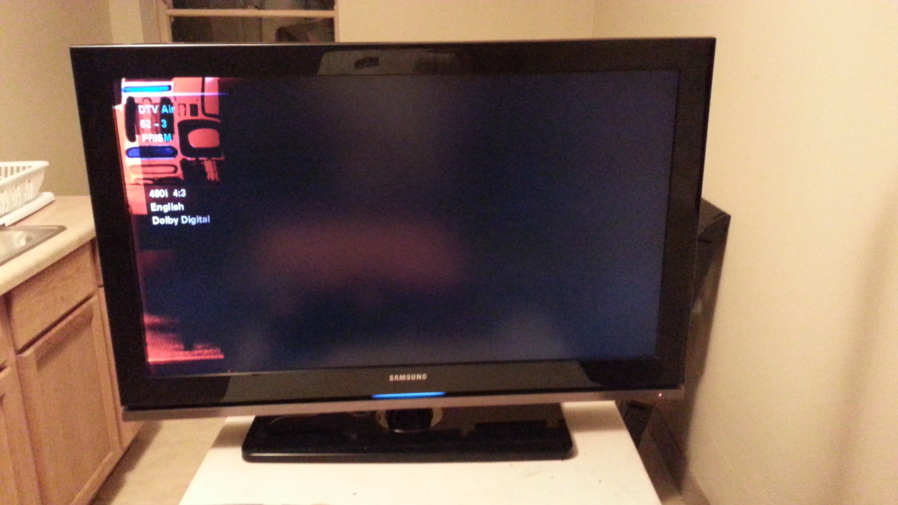

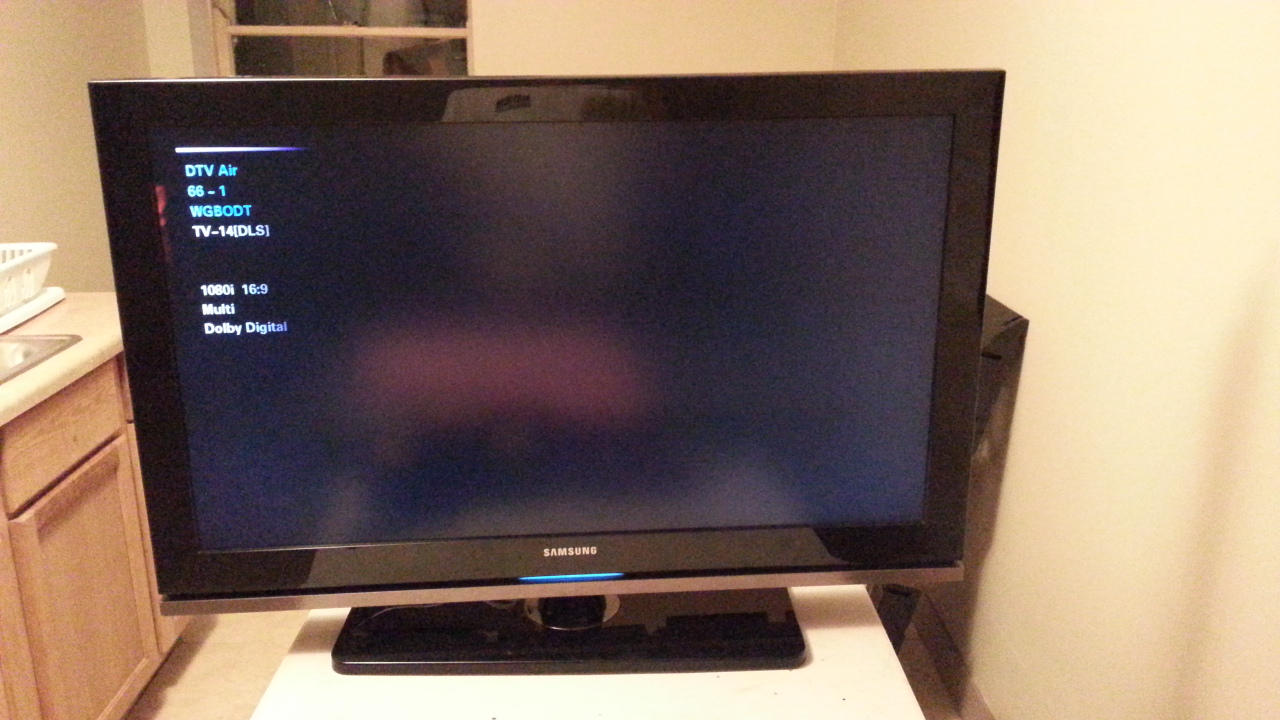

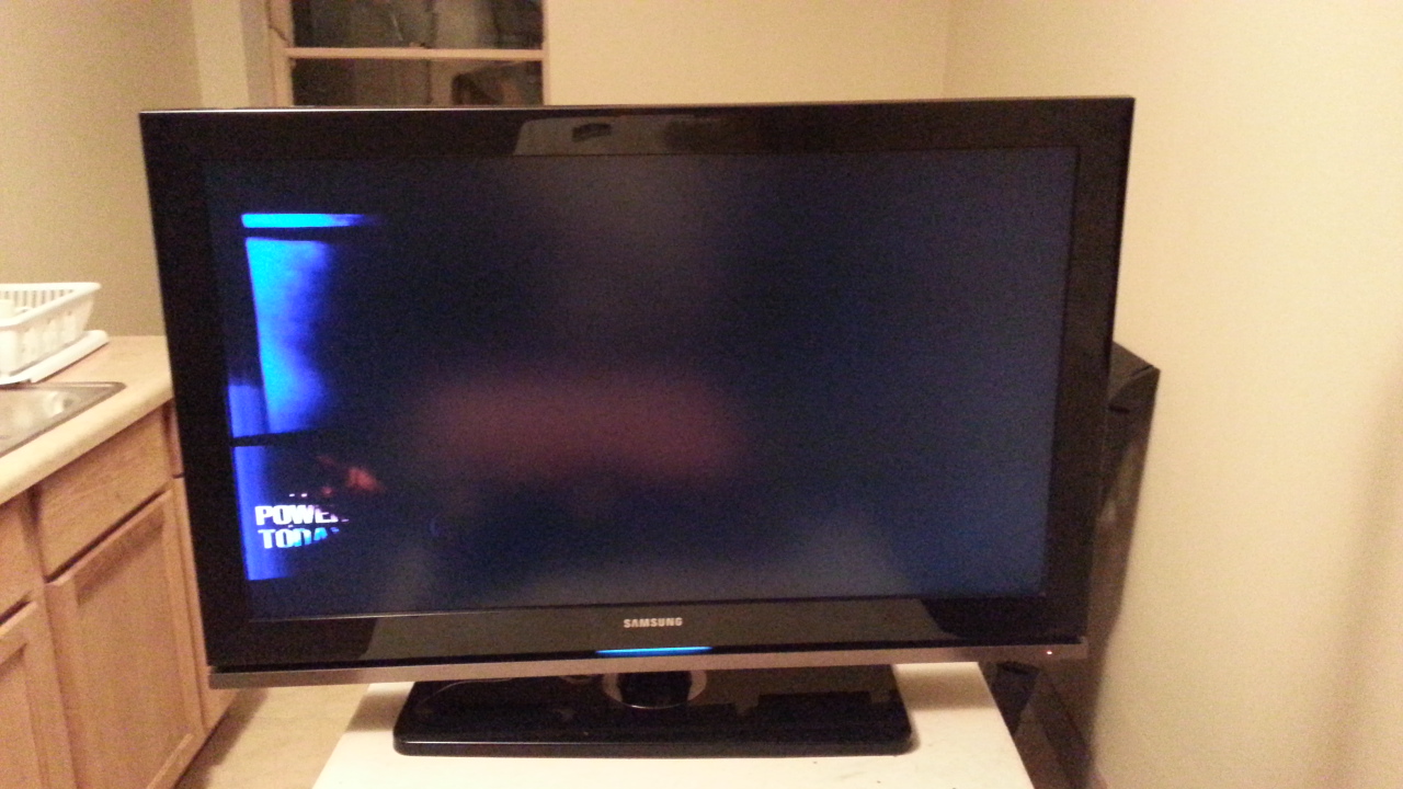

    samsung LNT4069FX/XAA poor pic quality and fading
    I picked up this set at a garage sale for 20 bucks
    I figured it wasnt much to try to fix it
    Anyways when I power it on the pic quality is poor and when I change the channels it fades to the left
    When I change the channel the previous image is left behind then the new image catches up
    Hopefully im making some sense and you guys understand me

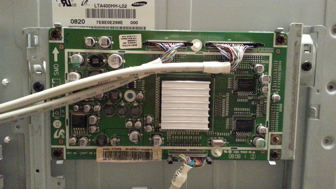

    Re: samsung LNT4069FX/XAA poor pic quality and fading

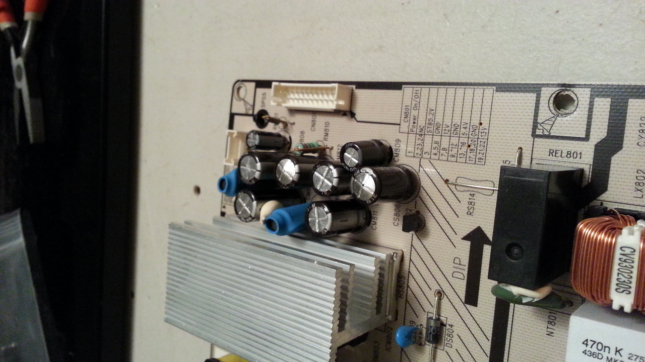

    I found a couple of bad caps on the psu
    I ordered new ones so hopefully I get these by Saturday
    What else should I test or does anyone know the problem?

            Ok so I replaced the caps and I still have poor picture quality and fafing to the left when I change the channels
            So should I take it down to the panel and press on the tab bonds or should I test other components before I do so?
            Thanks for the help
              For sure, that is a bad panel/tab bond issue, so you will need to take it down to the panel to see if you can fix it.

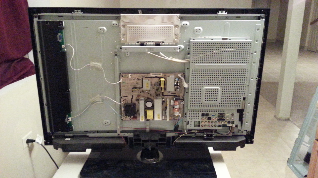

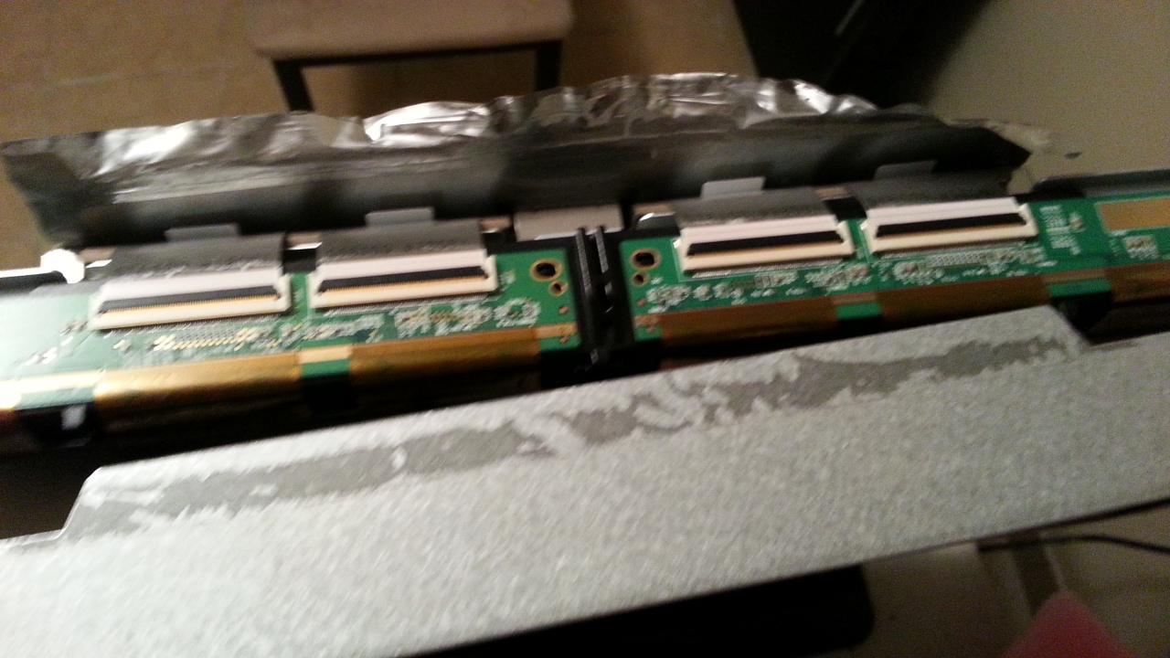

                  Ok so im back on this tv
                  I have taken off the plastic bezel and have removed the screws from the metal frame
                  Are there only tab bonds on the top?
                  Do I have to fully remove the metal frame?
                  So do I just press on these with my fingers?
                  • AFajitas
                    • Dec 2014
                    • 183

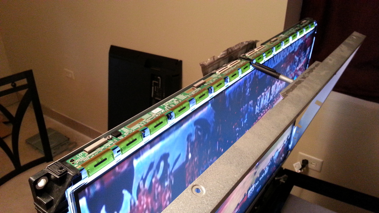

                    You can press them with a piece of cardboard or something. They get pretty hot. If you find one that makes the image change, power the tv off and back on while applying pressure to it and see if it makes a difference.

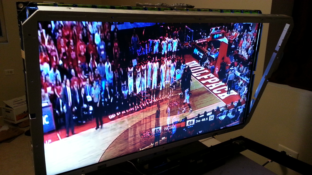

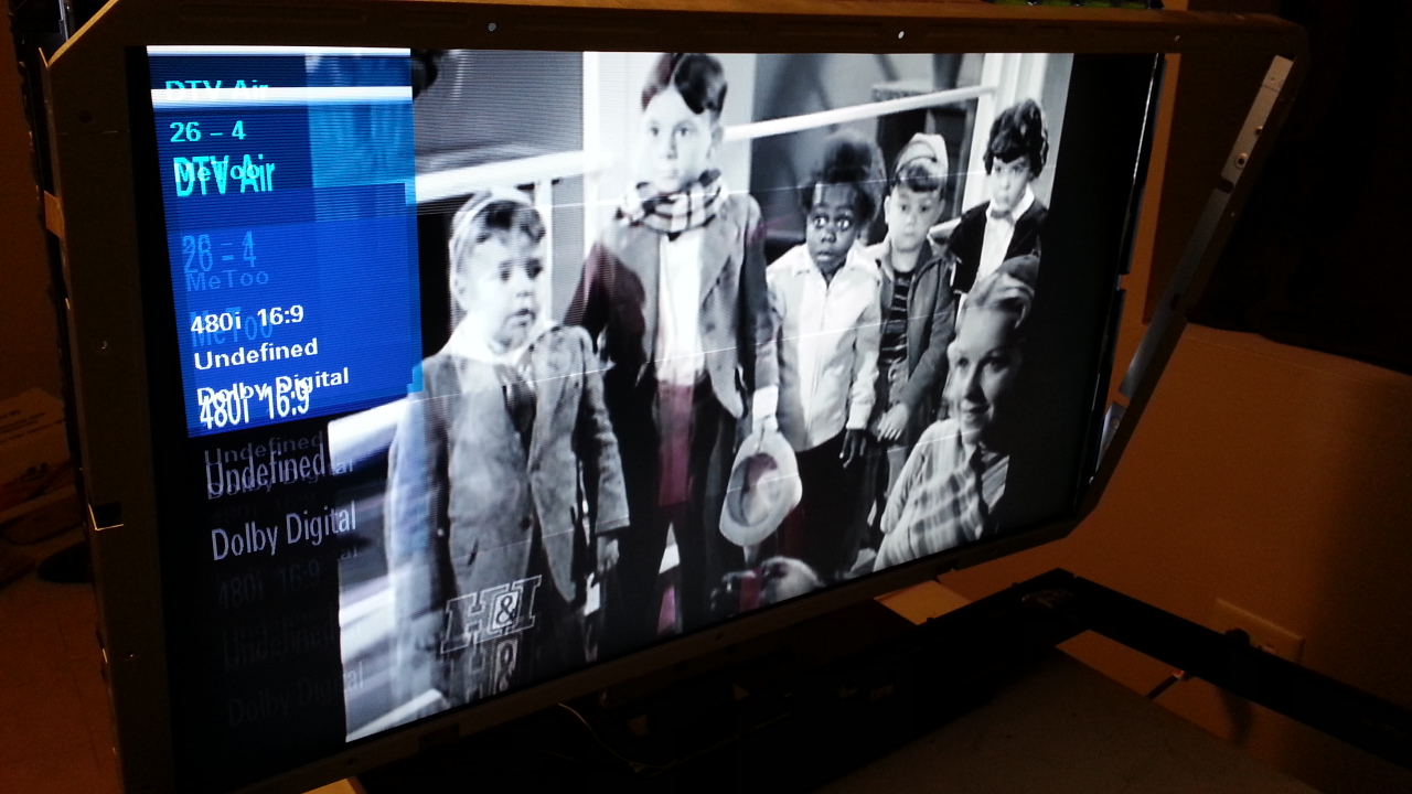

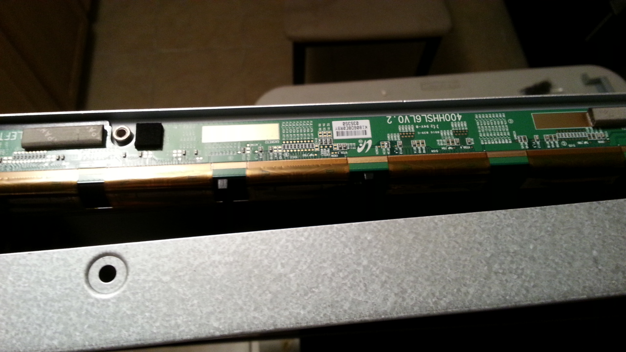

                      Ok so I pressed on the tabs where they make contact to the board.
                      There was no change in picture quality as you can see from the pics
                      There is still double images
                      Also what about the tabs on the side of the panel?
                      Do they do anything?

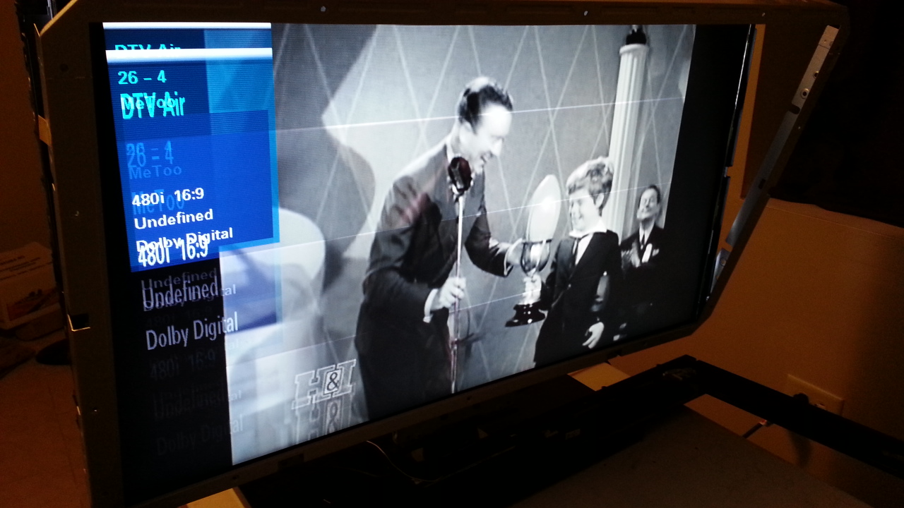

                      • jose6326
                        • May 2013
                        • 707
                        As the tv warmed up it developed horizontal lines
                        These were not there before
                        When I change the channel they go away but reappear once the image shows
                        • AFajitas
                          • Dec 2014
                          • 183

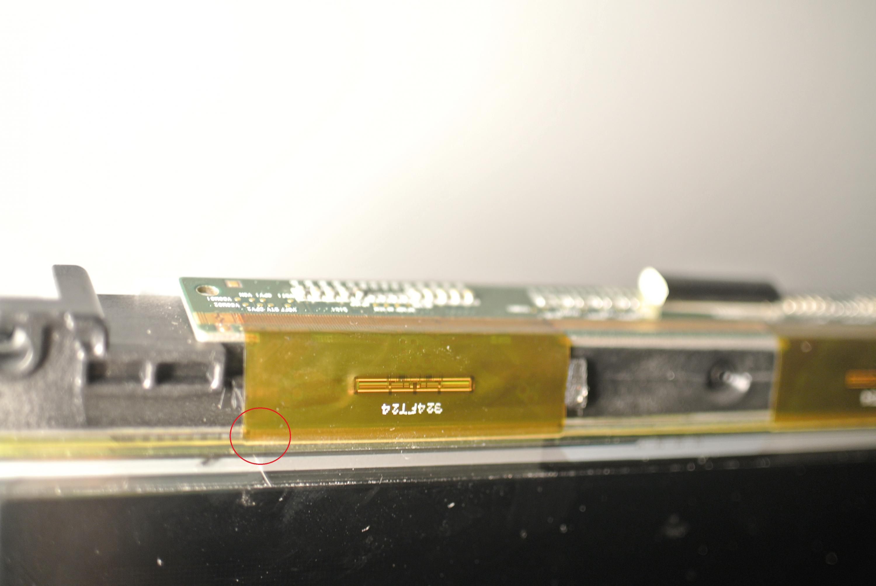

                          Jose, this is a tab bonding issue for sure. I can see the lines that separate the areas of the screen that each tab controls. The ghosting is also a symptom. It seems once the ghosting starts, the TV needs to be power cycled before it will correct itself, even if pressure is applied to the proper tab. My samsung has the same issue. I had to play around with the tabs for quite a bit before I got any results. I managed to get it working, but still have one of these annoying lines in the screen. It seems from my reading that it is usually either the top left or the top left tab that is affected. In my case it was the top right (if you are facing the screen). I actually have to apply pressure to the part of the cable between the screen and the controller board to make a difference.

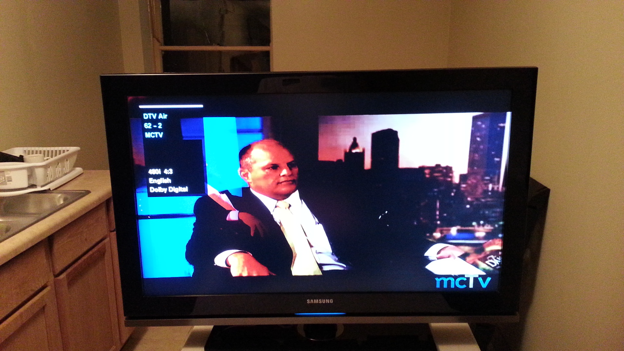

                              • jose6326
                                • May 2013
                                • 707

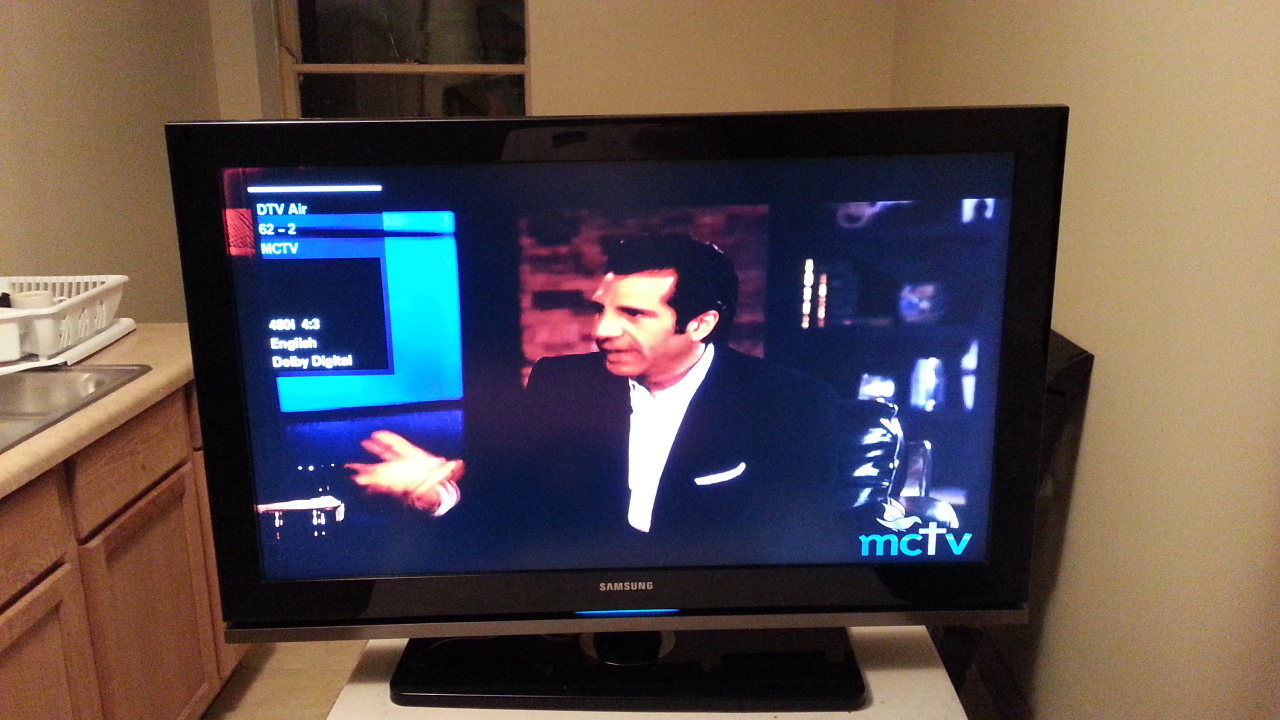

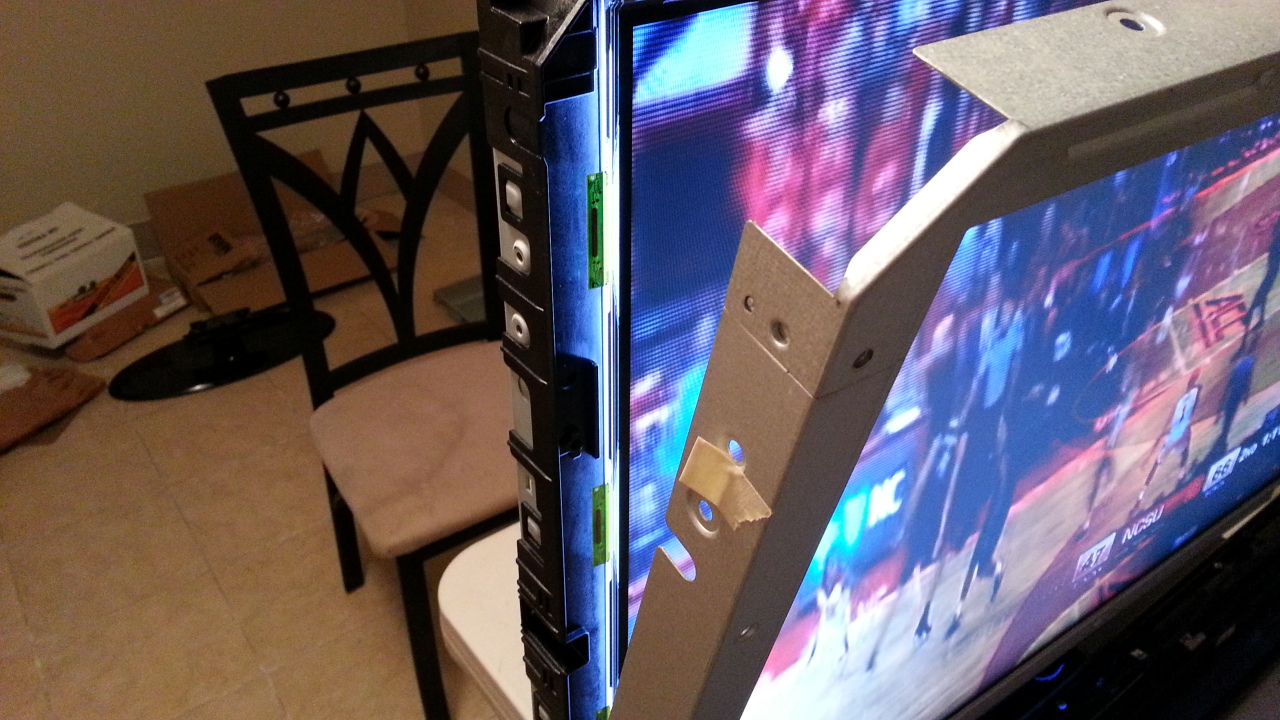

                                No need for the video

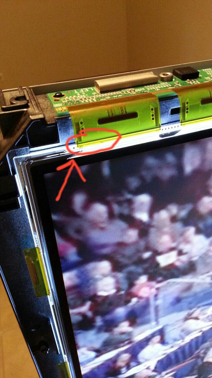

                                I found the faulty tab bond
                                It is the top left when you face the screen
                                It is actually the part that connects to the panel

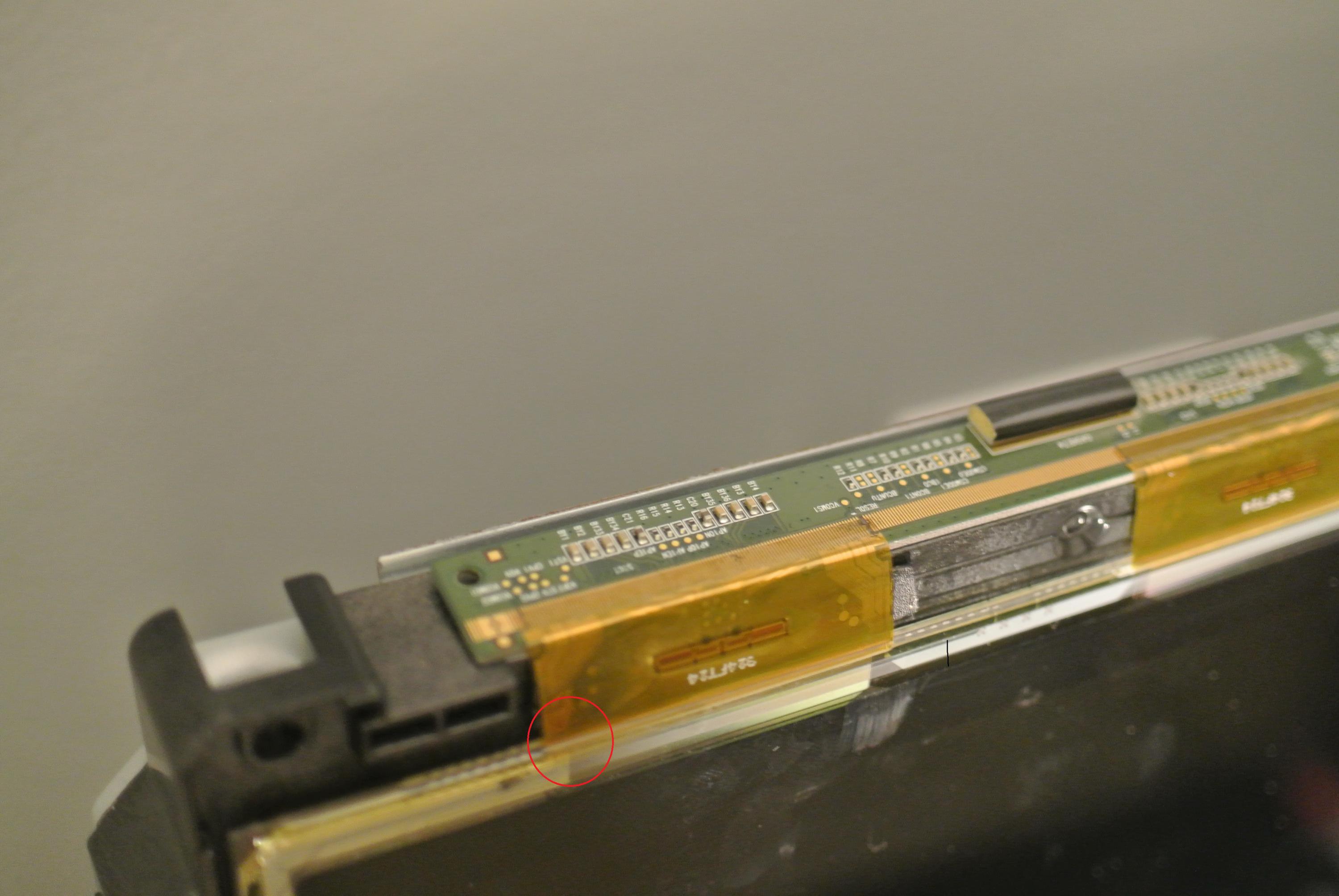

                                    Wow, what a night. I took my Sony KDL-52VL150 with the tab bonding issue apart to take pictures and post them here only to find that the problem persisted after removing my make shift electrical tape pad and reapplying it. I then spent two painful hours removing and remounting the metal frame and touching various parts of the tab trying to get rid of the ghosting but to no avail. I was pretty sure I broke it permanently at one point. Finally, I pinpointed the exact area where I need to apply pressure and I fixed it once again by readjusting the position of my padding. I just rolled up a 4 inch length of electrical tape into a small wad and then electrical taped that to the inside of the metal frame making sure to line it up with the spot highlighted in my pics. Too tired to post any more pics or the video, might do it tomorrow. Still have a small 1 pixel line that goes halfway across thescreen that is bearable. I suspect it's a single failed trace on the tab that Im not going to be able to fix. Also getting some slight noise in the panel that comes and goes, subtle rolling horizontal waves that are most noticeable on light backgrounds. I am making my wife and kids use this as their main tv until I fix it completely or part it out. It's still very watchable but I'd feel weird trying to sell it like this.
                                      Oh, I just saw your reply after posting! Exact same area as me, how funny.
                                        I fixed that one two years ago, I am using it every day in my living room.
