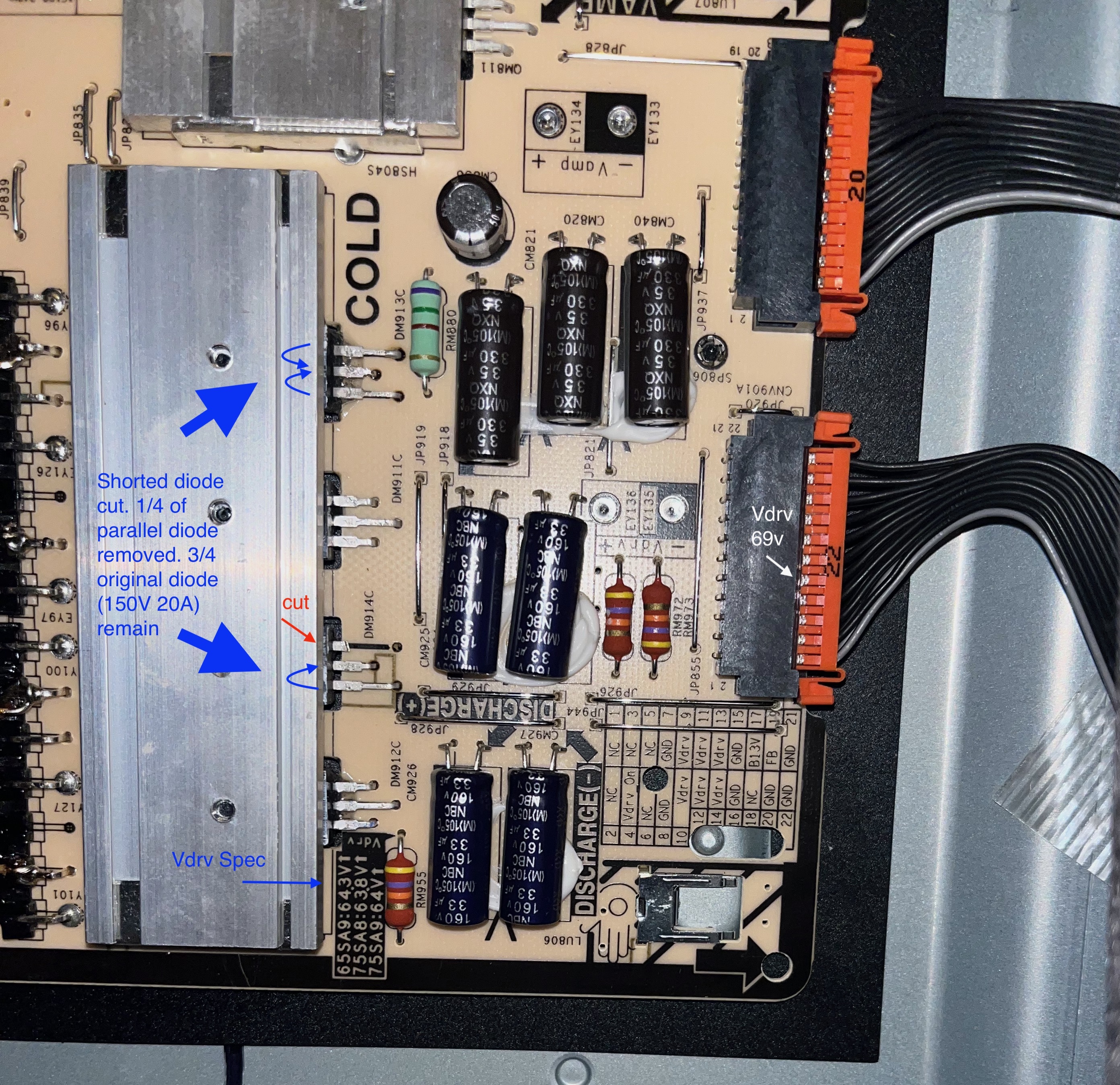

      UPDATE : Got the backlight to turn on...
      Studied the circuit of the shorted barrier diode rectifier array. There are 2 arrays (2x 150V 20A diode in each array) with total of 4x 150V 20A diode working in parallel. Since only 1 diode failed, I guessed 3x parallel is reasonable design margin to test the TV. Cut the shorted diode leg and TV backlight turns on.
      Click image for larger version  Name:	IMG_4588.jpg Views:	3 Size:	1.92 MB ID:	3675303 Click image for larger version  Name:	IMG_4586.jpg Views:	3 Size:	2.88 MB ID:	3675276
      Now I notice likely the original problem. LED driver voltage is 69V while the board has printed ~64V with up arrow. I also notice its 69V constant regardless of content brightness. Ran black video and dimming zone test on youtube and dark area backlight does not dim/turn off. This maybe the original problem that caused the PSU to fail.
      It appears zoned dimming is not working and mini LED backlight maybe on full brightness. Changing brightness doesn't change any brightness. Tried local dimming with standard and high (settings are low, standard, high) doesn't have any local dimming with above youtube tests.

        Wonder if they just didn't use components stout enough to handle the loads, those samsung bean counters like to save pennies at the consumers expense.
        • Diah
          • Feb 2013
          • 6439
          you need now to replace the diode complete not just cut..
          • howardc64
            • Jun 2017
            • 636
            yes of course. Just did this to test until replacement part arrive.
            I don’t know this diode would cause 69v instead of ~64v spec printed on the PSU. Don’t fully understand the circuit. The 4 diode’s anode are on the PSU <-> driver board ground plane. Also I’ve seen wrong voltages printed on PSUs before although this board prints 1/10 volt resolution.
            Will go through service menu in detail. Other Samsung’s have settings for lower backlight level.

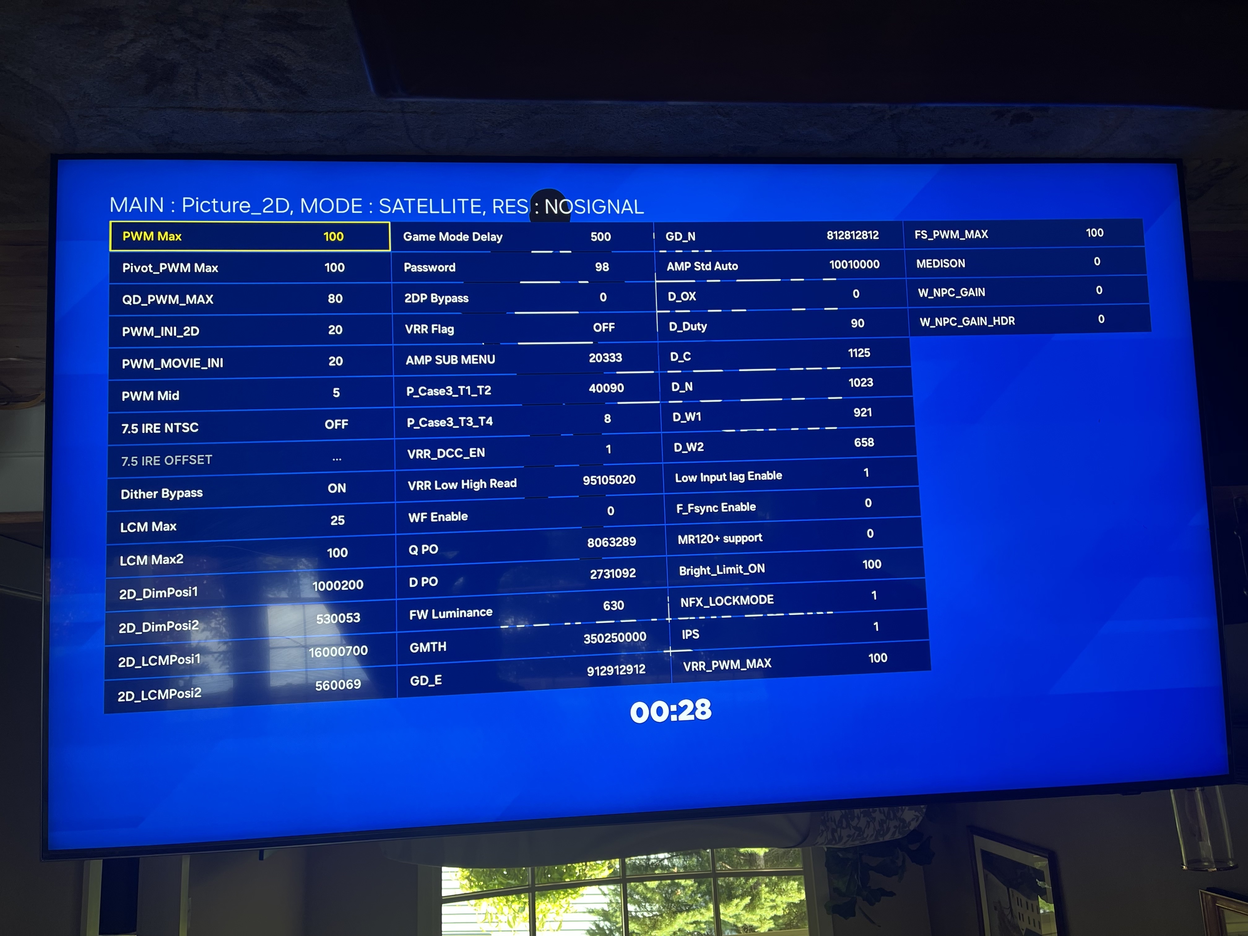

              Looks like many Samsung mini LED backlight TV owners are struggling with local dimming not working. Some owners (gamers?) dislike local dimming so I wonder if Samsung may have turn it off as default in a way that no one can easily turn back on in recent firmware updates.
              Tried lowering PWM_INI_2D and PWM_MOVIE_INI (both 100 default with latest firmware) to 20, no difference with youtube dimming/black screen test videos. Did find someone posting their SubSetting menu (in service menu) and a couple of differences from mine
              • Mine has no PWM_MIN
              • My 2D_DimPosi1 is 2x bigger. Didn't dare to change this not knowing if this is related to different number of mini LEDs of different size TVs.
              Here is my Service Subsetting menu
              Here is another persons ( link )
              Anyway, nothing is causing LEDs to dim and PSU LED voltage rail is always 69v

                    #29
                    Probed all pins between PSU and LED driver board
                    pin 4 = Vdrv On = 3.067v
                    pin 7,8,15,16,20,21,22 = GND = -0.011v
                    pin 9,10,11,12,13,14 = Vdrv = 69v
                    pin 17 = B13V = 12.83v
                    pin 19 = FB = 2.139v
                    FB signal looks like goes through side B of the LV358G op amp (IC 280), then to the main board connector (CN 250) and the Samsung chip nearest that connector (IC 2100)

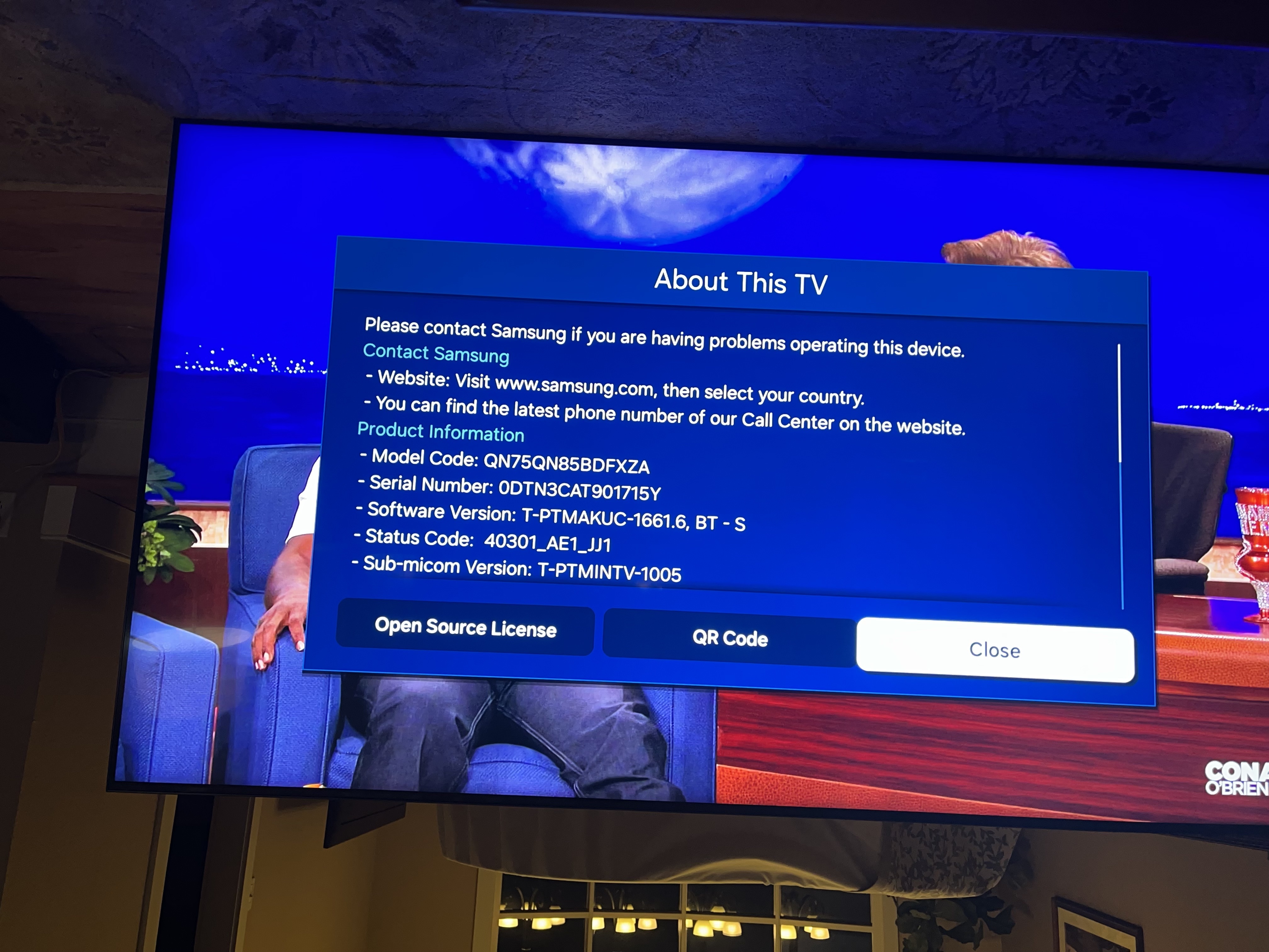

                          An update on this Samsung local dimming LED TV. Newer firmware from last 2+ years ruins the TV's picture quality. Can't go back to older firmware and can only repair by getting older firmware main board.
                          After I fixed the shorted PSU and turned on the backlight. TV is on latest firmware (1661) Picture brightness doesn't work (on full bright) and local dimming zones not working. This is a common problem for this TV in this Samsung support forum thread ( link ) Samsung fixed OP TV by replacing main with older firmware main.
                          shopjimmy had a complete board set (main+PSU+LED driver+wifi) for $105 including tax + shipping with 10% coupon. Took a chance main board had older firmware, installed the board set and TV works great (brightness + local dimming (~1000 zones!) working perfectly) Main baord firmware was 1304.1
                          Just info for anyone encountering this newer firmware problem on this TV.
                          Also Vdrv on the replacement PSU is 68v. Maybe this is the correct voltage instead of what is printed on the PSU. Maybe LED array aged with more resistance. Don't really know without original new TV reference measurement.

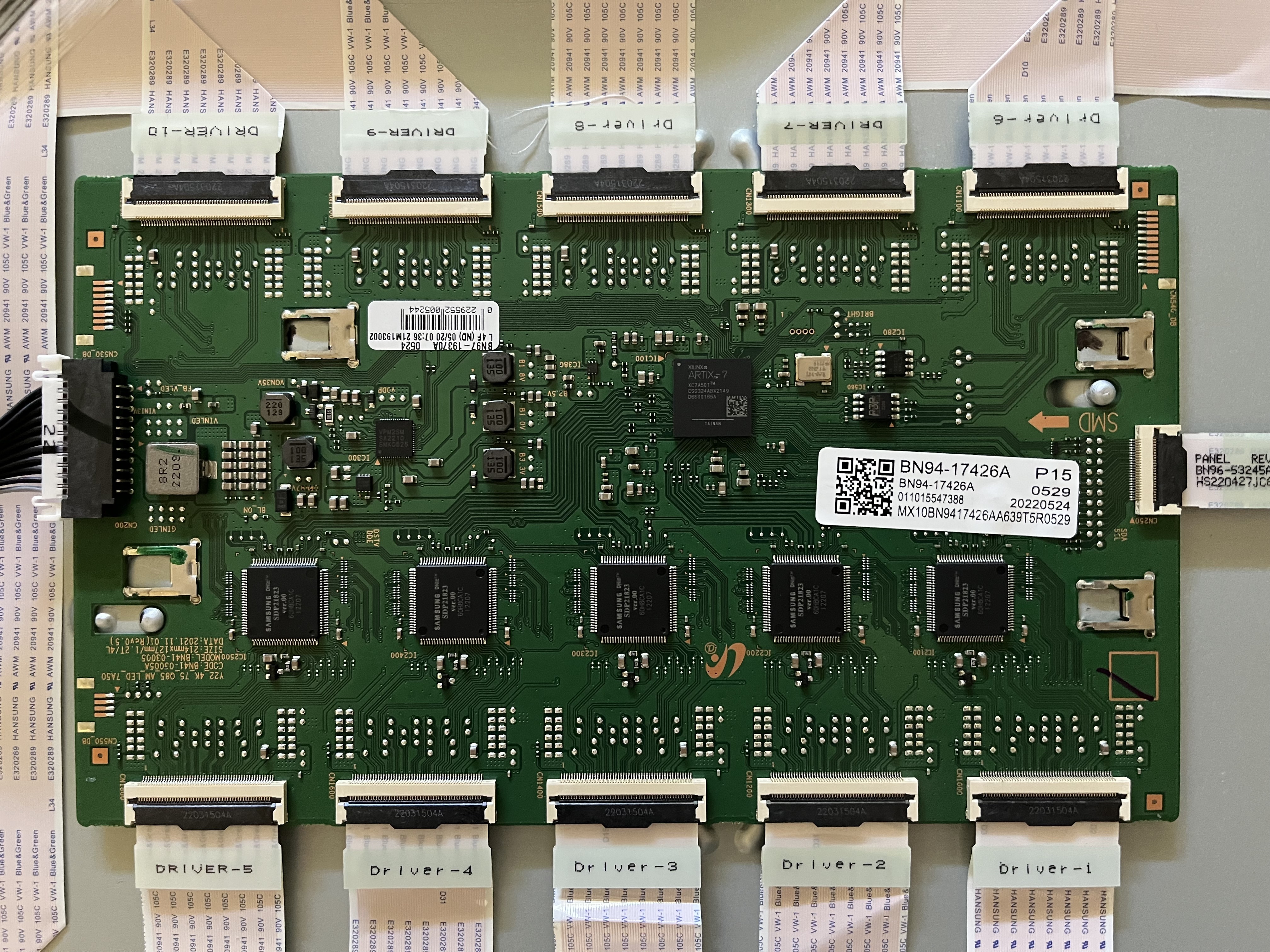

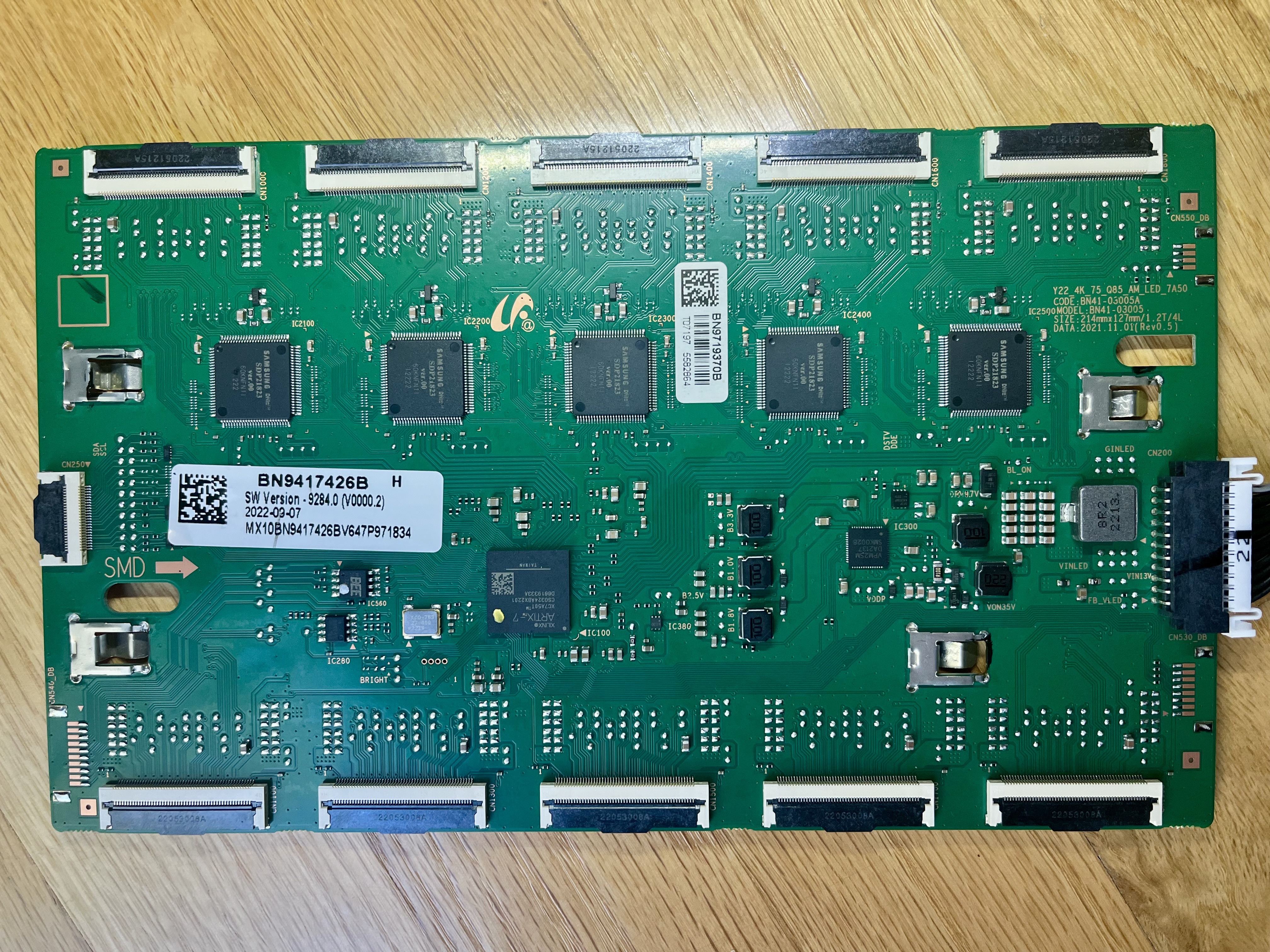

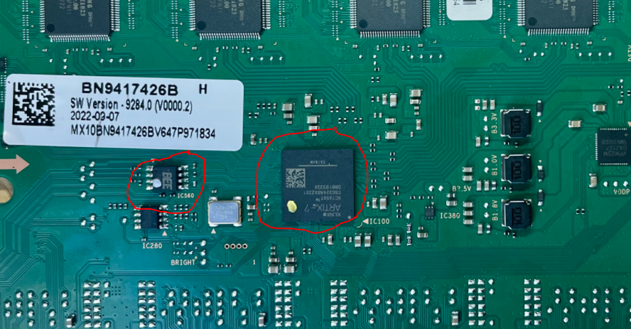

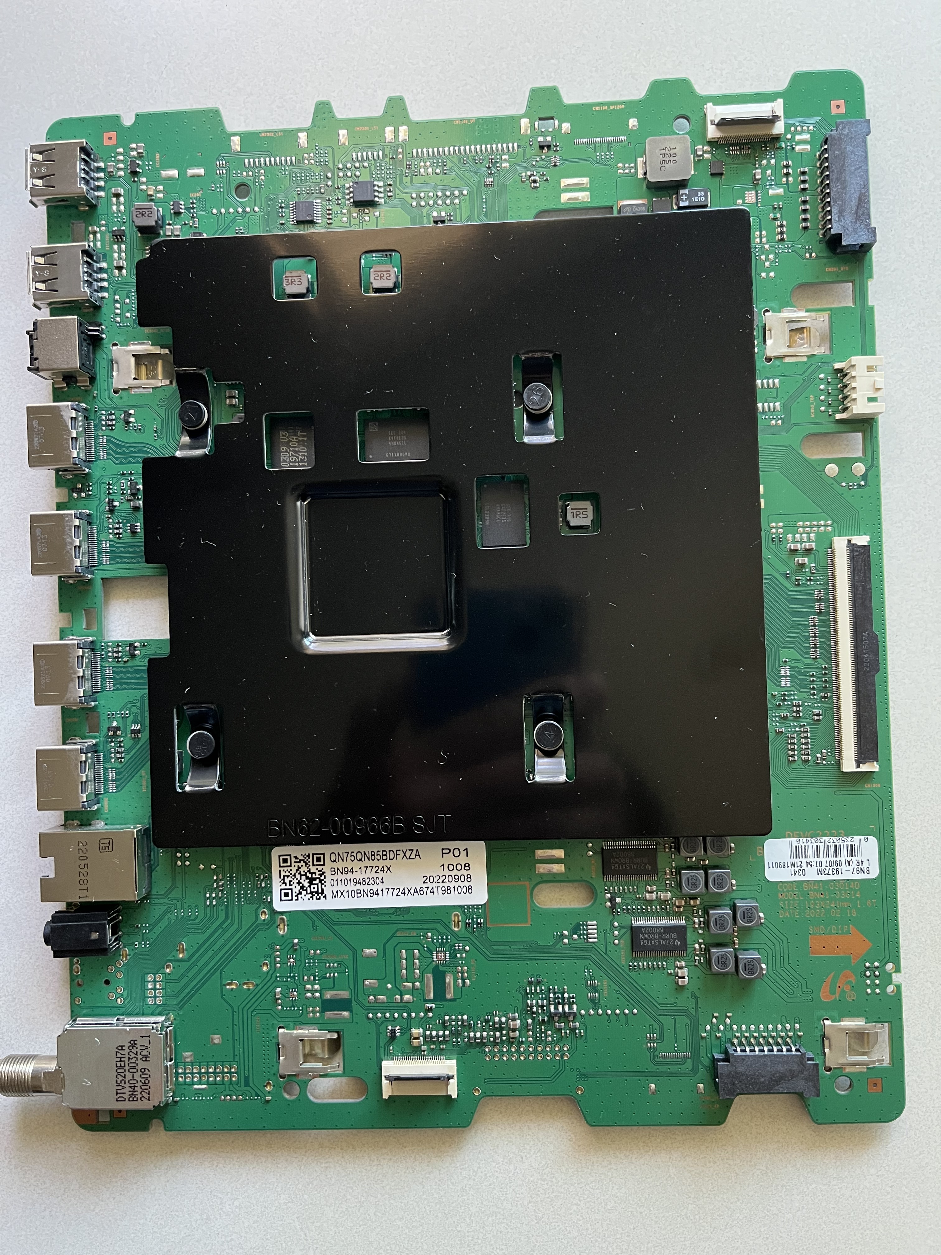

                                Dumped the Flash ROMs on the original and replacement LED driver board (attached) to compare and has many differences. This board has complex chip including processors so I didn't dare to mix the old LED driver board with the new main board (in case firmware update update both boards for coordinated functions)
                                flash rom = Winbond 25Q32JV (4Mbyte NOR flash) on both boards
                                original board = BN9417426B
                                shopjimmy board = BN8417426A (shopjimmy product listing shows ...426B but I got ...426A. Brightness and local dimming does work)
                                Click image for larger version  Name:	IMG_4569.jpg Views:	0 Size:	4.45 MB ID:	3684978 Click image for larger version  Name:	IMG_4727.jpg Views:	0 Size:	3.59 MB ID:	3684979

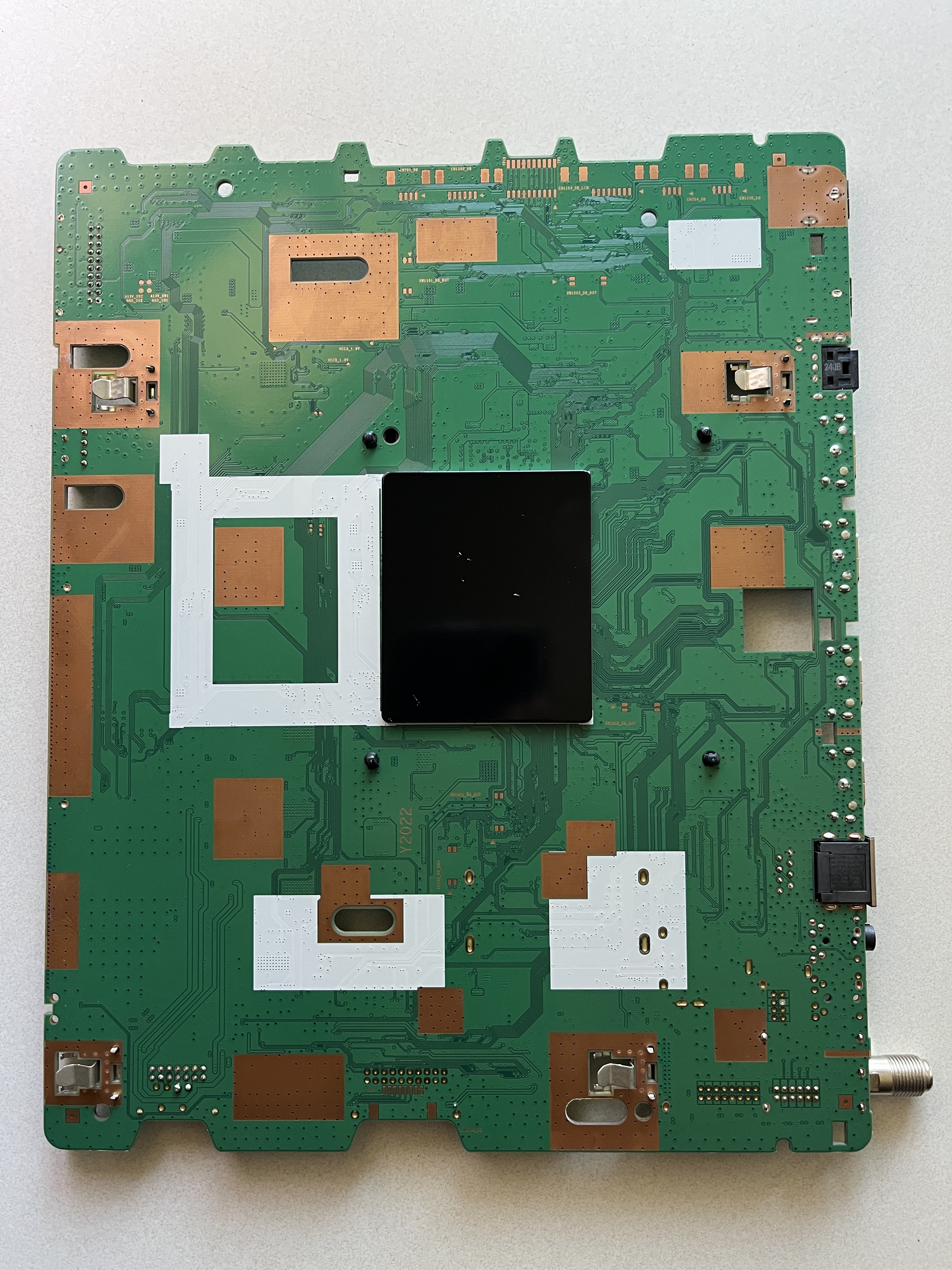

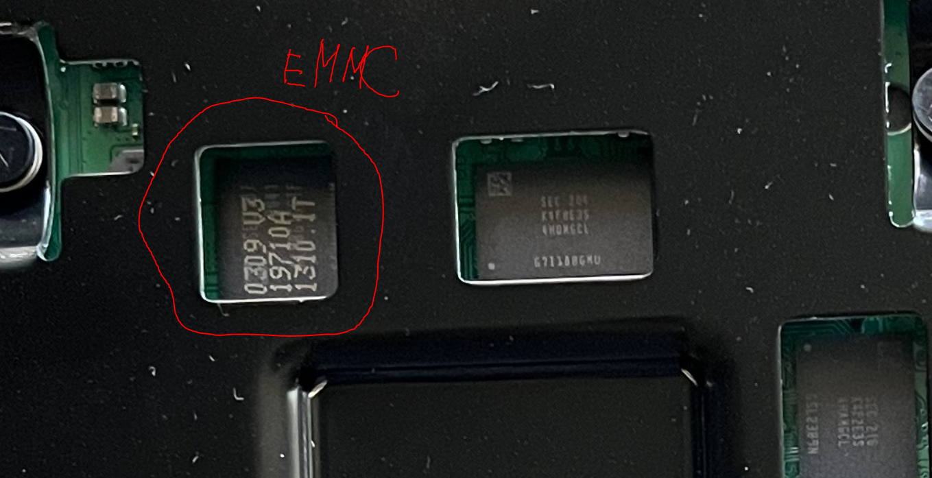

                                I assume main board has flash ROMs and eMMC (but hidden under heatsink so I didn't remove and examine). Surely eMMC is updated by new firmware.
                                Click image for larger version  Name:	IMG_4725.jpg Views:	0 Size:	3.33 MB ID:	3684980 Click image for larger version  Name:	IMG_4726.jpg Views:	0 Size:	3.70 MB ID:	3684981
                                I searched for flash ROM and eMMC on LED driver and main board incase the TV can be repaired by flashing older flash contents. But it seems unlikely due to eMMC and I also have 2 different revs of the LED driver board.

                                  #36
                                  The firmware is located here (chips with colored dots indicate that they have been programmed and tested).
                                  • howardc64
                                    • Jun 2017
                                    • 636
                                    #37
                                    Thanks, I pulled dumps from the 8pin Winbond.
                                    The other chip you pointed out that is programmed is interesting. Its a Transceiver FPGA ARTIX 7 XC7A50T by AMD (orignially by Xilinx which is a major FGPA producer acquired by AMD in 2022) Device summary below (pg3) These FPGAs are designed to transmit high speed signals across long distances (a hard problem, higher the speed, more signal delay variation from wire length even board level trace lengths ) They use typical differential signaling etc. XC7A50T has 120 differential signal pairs. I guess LED dimming is probably accomplished by this signaling and must have some hardware near the LEDs to decode and finally turn into voltage/current.
