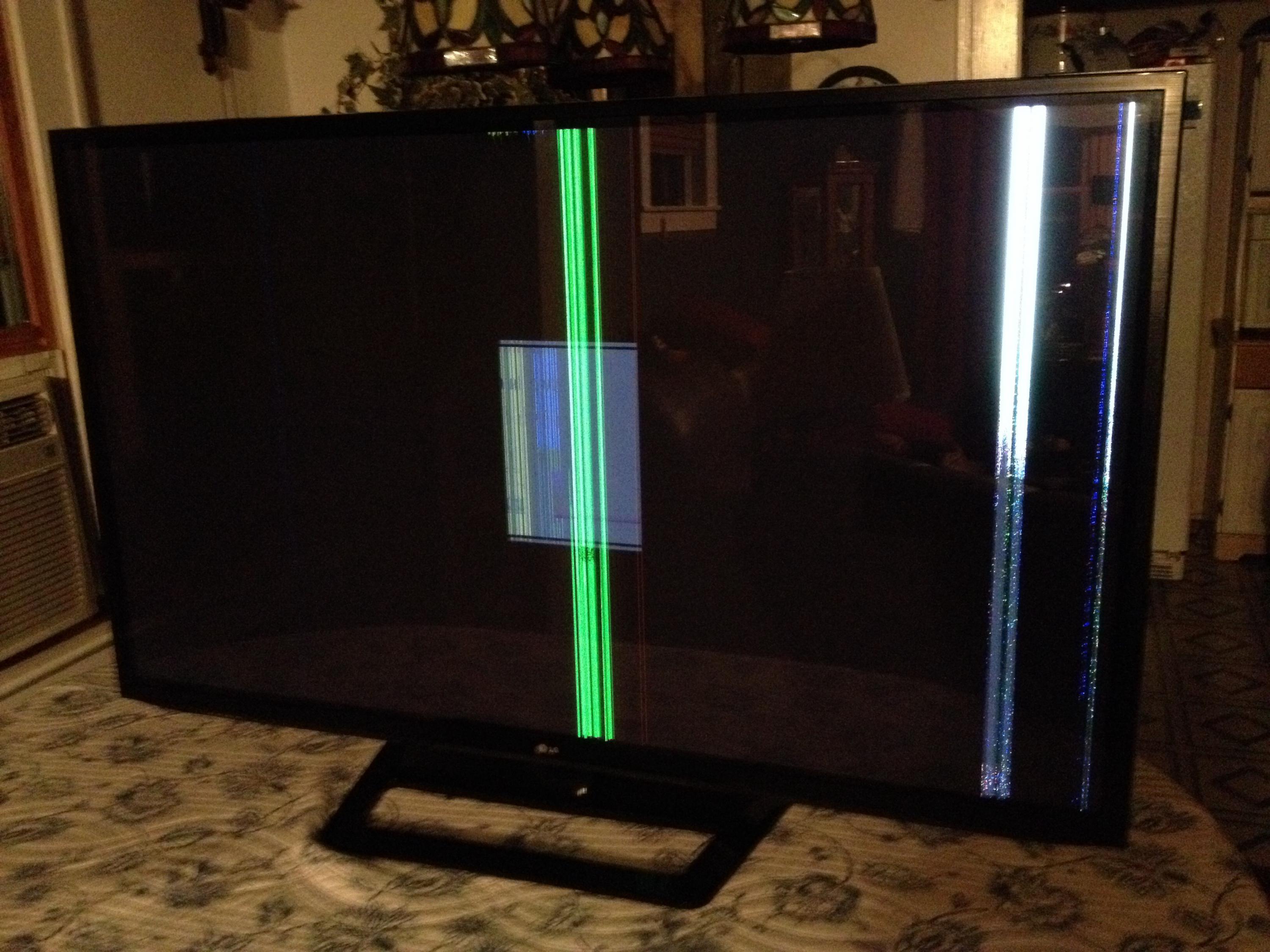

    Definite bad LG plasma panel?
    Lg model 60PA6500-UA mfg date 2/2012
    How do I determine beyond any doubt if my plasma panel is bad? I do not see any cracks, has always been handled carefully. There are thin colored vertical lines scattered randomly accross the panel with a few vertical black bands. All power supply voltages are good, it has new main, logic(twice), and all 3 address buffer boards replaced so far. All connections have been checked and panel ribbons are not abraided.
    THIS IS ONLY A YEAR AND A HALF OLD!!! Thanks for reading.

    You need to pt up a picture of it jpg less then 3mb using manage attachments
    - are the bands/lines always in the same place
    You could have asked this in the other thread where all the infor was - we dont like double posting!

      The bands seem to stay put but the lines appear to relocate at times, when I get home I'll check again to make sure, it's been a few weeks since I've messed with it. I'll see if I can get some video, I may need some help getting it posted, I'm new to forums and tech!
        All those boards replaced under wty?
        I'm thinking if you've replaced all that, especially the bottom address boards, sounds like bad panel. Black bands with coloured noisy vertical lines sounds like the ICs embedded on the bottoms ribbons have failed.
        I guess LG don't want to help out of wty?

          Sorry Selldoor, I really don't know my way around a forum, Im new to this. I'm guessing you've seen my other more detailed post. I tried to get a 30 sec video of it with the test pattern terminals jumped, but I couldn't get the video to upload. I did get a still picture without test pattern jumped, not much different. In a dark room, the rest of the panel is lit a slight greyish color. I cycled it on and off a few times with the same results on the same sections.
          tw2005, would the ribbon ICs show any pits or burns? I looked with my #2 reading glasses and a magnifying glass and couldn't see any problems. As for warranty, it was out by few months at the time it failed. From what I've read, talking to manufactures about problems is useless. Can a plasma panel be damaged electrically, as in a bad board, electrical surge, etc? If it had a crack wouldn't the gas escape and have no reaction at all? If a surge or lightning should there be some blackening or burnt spots? All other components plugged into the same surge protector are fine. Thanks!

            (PREVIOUS POST, HAS MORE INFORMATION) Thanks! I'm trying to figure out what went wrong. It originally started with not turning on, checked and had all voltages, checked all connections, no burn marks or pits or holes in anything. replaced the main board after Shop Jimmy helped me decide. It would then turn on with sound but no picture. Replaced logic board, had two thirds of the picture and had sound. After inspecting the suspected address buffer, I had thin vertical colored lines and a few vertical black bands. The sound also went away but with the panel distorted I can't see the settings. The logic board LED blinked a pattern of short-short-long-short. I took a chance and replaced the logic board again and all three address buffers. No change. Tom66 advised inspecting for abraision damage to the panel ribbons and to see what happens when disconnecting half of the left sus board. All ribbons are good, no rubbing. I can't seem to get the connectors on the sus board to come loose, I don't want to break anything, any suggestions? I'm not happy with the longevity of this tv, ONE AND A HALF YEARS OLD!!! Thanks to everyone for reading! LG plasma model 60PA6500-UA mfg date 2/2012

              Another note: before the picture was taken, at times there were more colored lines and I also found with the Y and Z sus boards disconnected, the logic board LED stopped blinking completely. It was blinking short-short-long-short. I'd also like some advice on how to get a buffer board unhooked from the Y sus. Tom66 suggested trying this as a test but the connectors are very tight unless I'm doing something wrong. I don't want to break anything. Thanks again!

                As TW2005 said, it's very likely the ICs embedded in the panel that look to of gone bad, best thing you can do is to put the Tv back to it's original condition and pursue a claim using the SOGA(Sale Of Goods Act), at a year and half old it's a joke that it's doing this already, good luck.
                  Re: Definite bad LG plasma panel?
                  Unfortunately, Americans don't have any kind of SOGA act or anything similar. The best you can do is petition LG. Or, if you purchased the TV with a credit card, they may offer an extended warranty.
                  Bad plasma panels are pretty rare, but LG seems to be the worst offender. In the LED-LCD arena, bad panels are a lot more common with Samsung seemingly amongst the worst.

                    If the panel is cracked, would it still have the dim grey glow over the entire panel in a dark room? I figured a crack would let the gasses out and wouldn't light at all. Just curious.

                      It's cracked? Well, with modern plasmas, they do still work with cracks. Uh... picture not so good though... Case in point Pioneer Kuro...

                        I'm just assuming mines cracked now, I guess it's time for me to cut my losses. I do thank you guys!

                          If a plasma panel is cracked, you can always see it in the glass. In your case, it is probably just a panel failure.

                            It's probably those ribbon ICs then as others said, YOU GUYS ROCK!, Thanks!

                              I would say definitely the i.c's, I've seen this many times and it's always been the panel (or more specifically the driver ic's) to blame. The address boards at the bottom don't do an awful lot unlike the real buffers on the Y section where the ic's are on the board itself.
                              I have to say I've seen this more often on Panasonic plasma panels than LG, most LG (and Samsung) PDP's that I've seen with problems in this area have been more single pixel line type failures.
                              You could remove the panel and closely inspect for a crack, being a large display it is possible, though at the end of the day it's still a bad panel.
