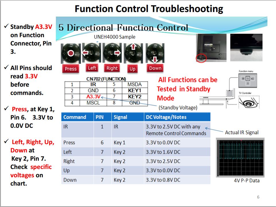

    Re: Samsung PN43E450 - Won't turn on
    Thanks Tom66, I understand what you mean now.
    By the way, here's another link to a troubleshooting document for the E450:
    ftp://helpedia.com/pub/temp/datashee...t_track_guide_[SM].pdf
    Here's a screen shot of the Power Switch connector pin function page of that document:
