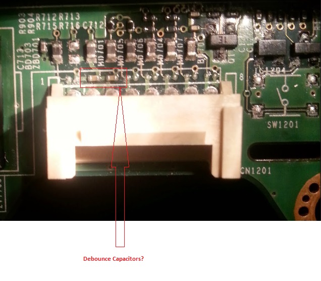

                                  Re: Samsung PN43E450 - Won't turn on
                                  OK, back to our regularly scheduled program
                                  Anyone have any suggestions on my next places to check on the board? Looks like there are debounce capacitors on those pins as Agent24 mentioned. I could try replacing them. I'll post a picture later.
                                    I'd focus on the power supply side - do you get 3.3V back with that board removed? A shorted debounce capacitor would simply cause buttons to stop working... now a shorted decoupling capacitor, on the other hand, could cause all sorts of issues.
                                    • spudnik144
                                      • Aug 2014
                                      • 14
                                      Yes I do get 3.3 volts with the main board disconnected. But I thought I had eliminated the power supply as the issue with the test I had done earlier.
                                      Here's a picture of the power button connector:
                                        In this case, I mean the main board power supply. The various rails for on board components. The 3.3V to the PSU is just an on/off command and the voltage is usually pulled up by the PSU.
