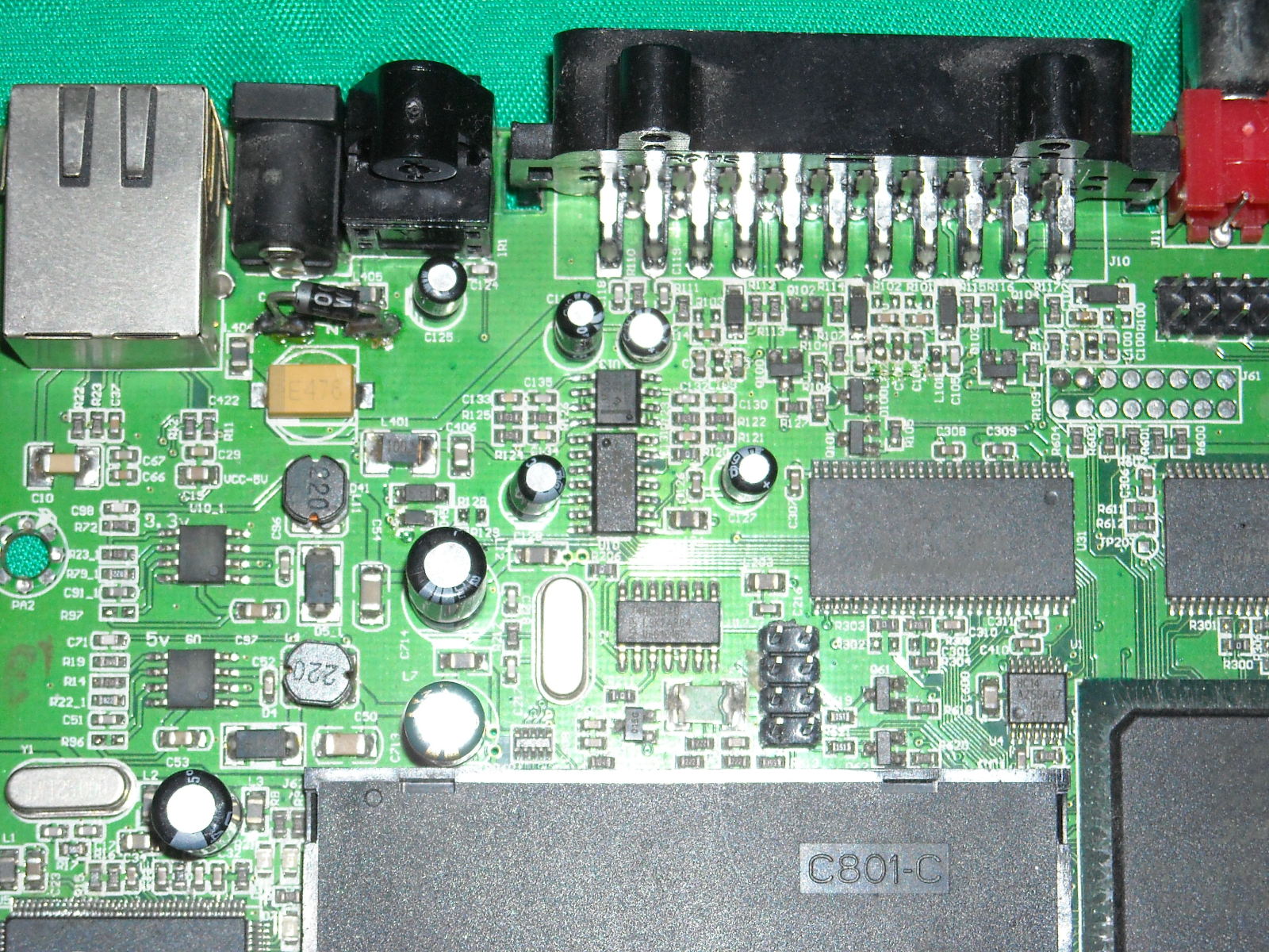

    Hello everyone, I'm struggling with the repair of a dm500s on which he smoked the D46 component which is basically the diode screen printed with 1N4000 GW immediately behind the power connector but after replacing the decoder does not give any sign of life, what I could check why the rest SEEMS everything in order, no other component burned.

    did you check the brick to make sure it still puts out power?

      That is a protection diode, He may have hooked up the wrong polarity adaptor to it, or the adaptor is bad.

        Re: Dreambox 500s no power on
        adaptor is ok and the L404 e L405 are ok
          what voltage do you have across c422?
          • joeh
            • Jul 2011
            • 26
            12v present on c422
              Do you have any of the other voltages ? +3.3, +5 ?
                @RJ... on two regulators:
                +5v ..... present about 4.9v
                +3.3v....NOT PRESENT
                    UPDATE:
                    By checking the voltage on both 3.3V and 5V regulators displayed in the picture, I read about 0 volt, then i think that the problem is here, then currently on the board and the regulators I have the 12v only, but missing the other two voltages +3.3v and 5v. I tried to replace both regulators, but the result does not change .... suggestions ???
                      both regulators?
                      your schematic just has ic40
                              update on regulator 5v i have in output 3,7v and on 3,3v i have 0 v
