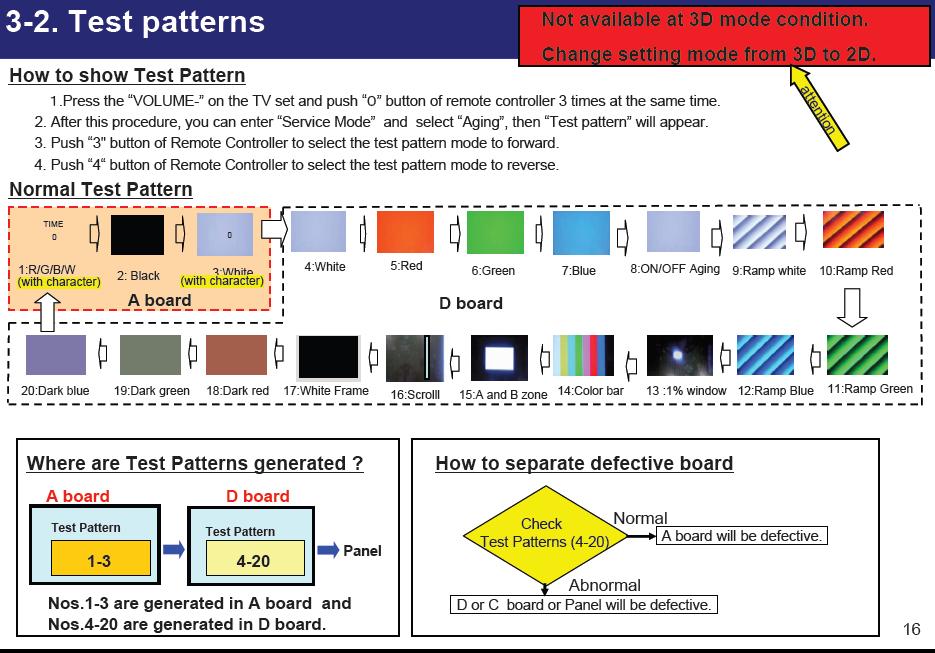

    definitely board issue, I've seen that before posted up on other panasonics and there's a youtube video of one. last I heard from that guy was the A board was replaced with no change.
    My first guess would be A board but these have a separate D board as well so since the A board did not fix it for the last bloke I'm leaning towards that D board.
    I've attached a test procedure, try it and see if that isolates A or D, it's definitely one of those.
    Also you'll need to check what revision boards you have as they are different for each size

      Thank you for the reply!
      After going through that procedure I believe it's the d board.

        Well that's good if it gives you a definite result, confirms my suspicion and hopefully you can find one reasonably price. Last 54VT25 I helped with was also D board with 1 blink SOS and about $100 from SJ.
        So yours should be TNPA5149AD or TXN/D1LWUUS but SJ is now out of stock
        search both numbers, I found this bargain

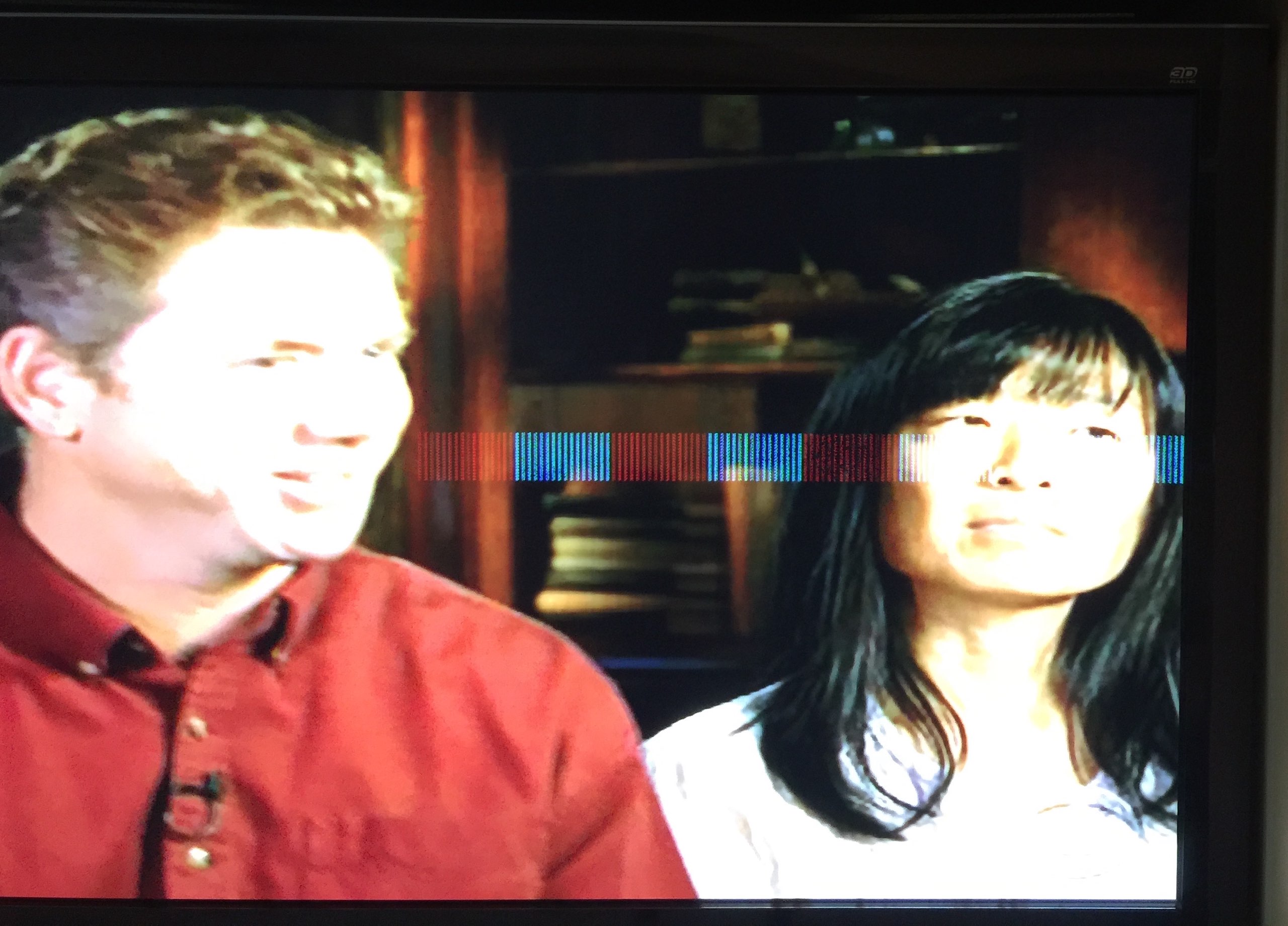

                              Newbie question here and hopefully someone still reads this thread
                              I have the same issue (red and blued lines) and I am about to order the D board from eBay
                              PANASONIC TC-P54VT25 D BOARD TNPA5149AD
                              Only question I have is around the SU and SD boards. My failure is on the upper right hand quadrant when looking at the TV straight on. Should I consider looking also for the SU-board?
                              I am comfortable replacing the board and I can try the D board first and if that does not fix it, start looking for the SU board.
                              Thanks in advance

                                If you put a picture up it would be helpful but I'd go D board first
                                Bad su would be whole of top half issue.

                                  Re: Panasonic TC-P54VT25 colored horizontal line issue
                                  Thank you very much TW
                                  Picture attached
                                  Just ordered the board on eBay and I'll follow-up on results.

                                      Won't need any buffer board for that. Should be D board otherwise A is only one left if it still is there
                                        Just to confirm, replacing the D BOARD TNPA5149AD fixed the issue of red and blued lines on my PANASONIC TC-P54VT25
                                        Not a bad $75 buy from eBay
