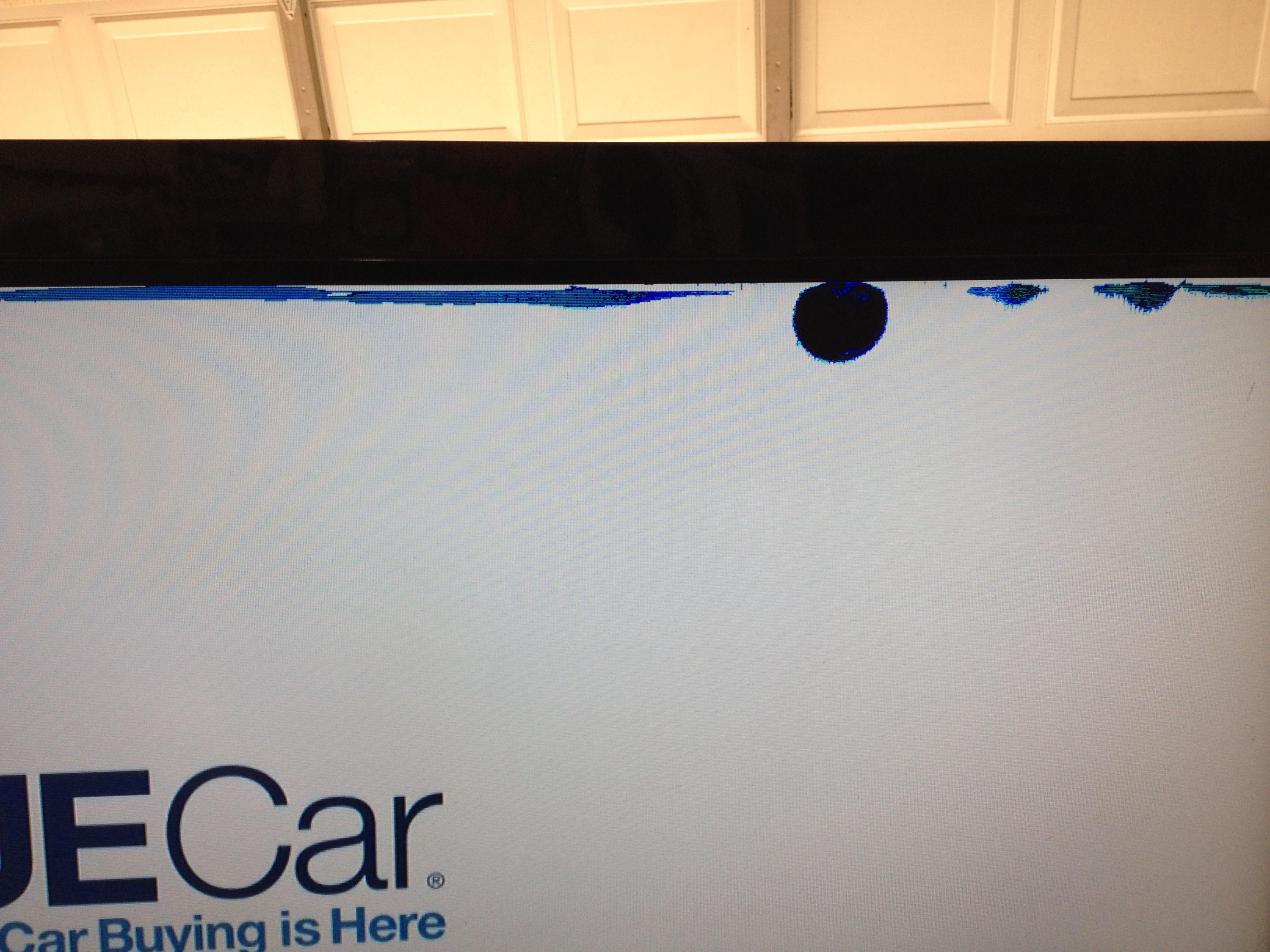

    I am new to this and got this thing going by replacing the two caps on the power board. Have left this running for 5 hours and now I get these blue broken line and black circle at top of screen. See attached pic. Is this something that can be fixed or will it get worse? Hope the attachment went thru. Thanks

    Looks like a damaged panel. Looks like too much pressure in spots. (If LCD)

      That's what I was thinking. Just wondering if it will get any worse. Gonna sell it to my neighbor for what I got in it for his garage and told him I would buy it back if it gets worse and just sell the parts. What is strange is that it wasn't there till I ran the set for awhile. Thanks for the reply.
