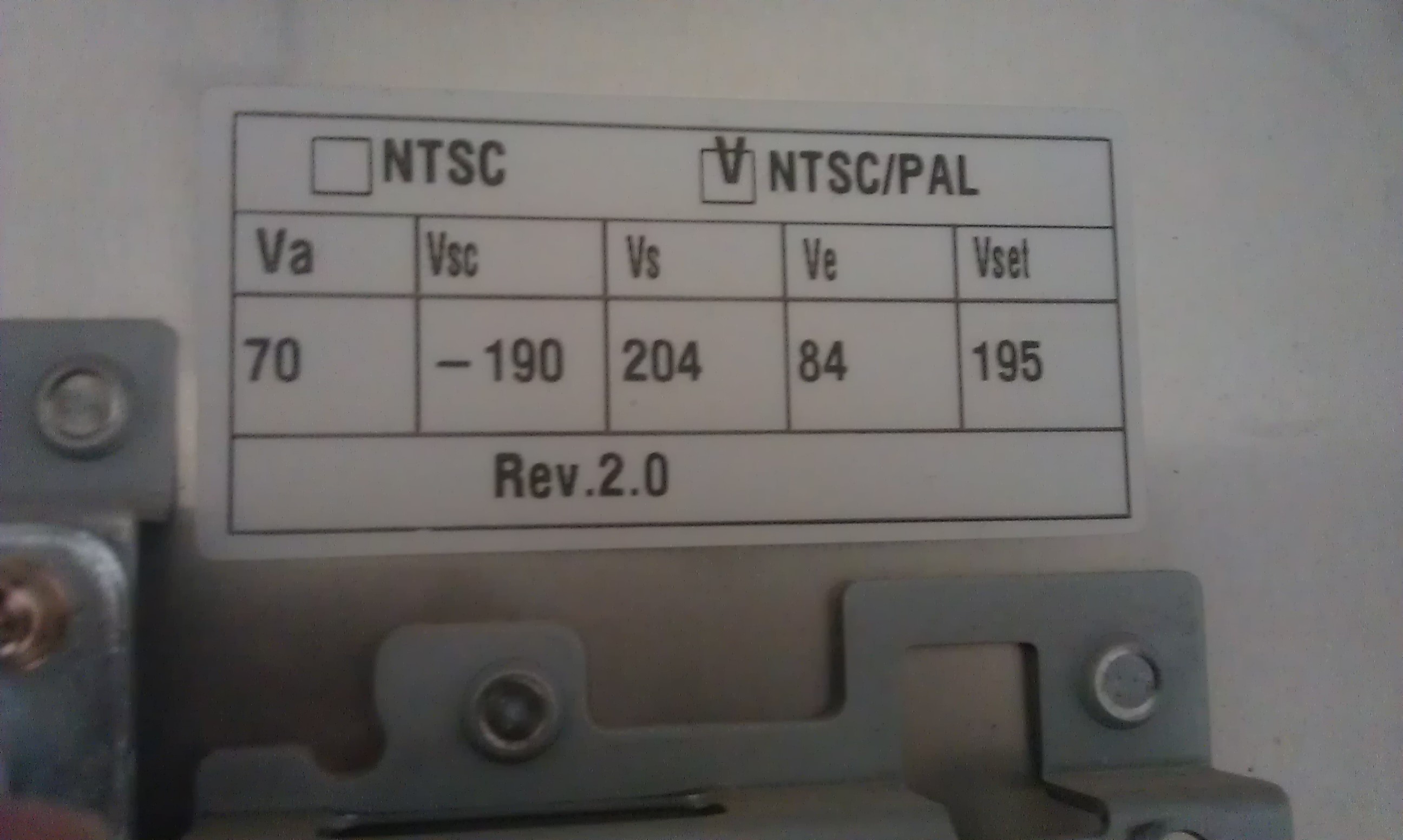

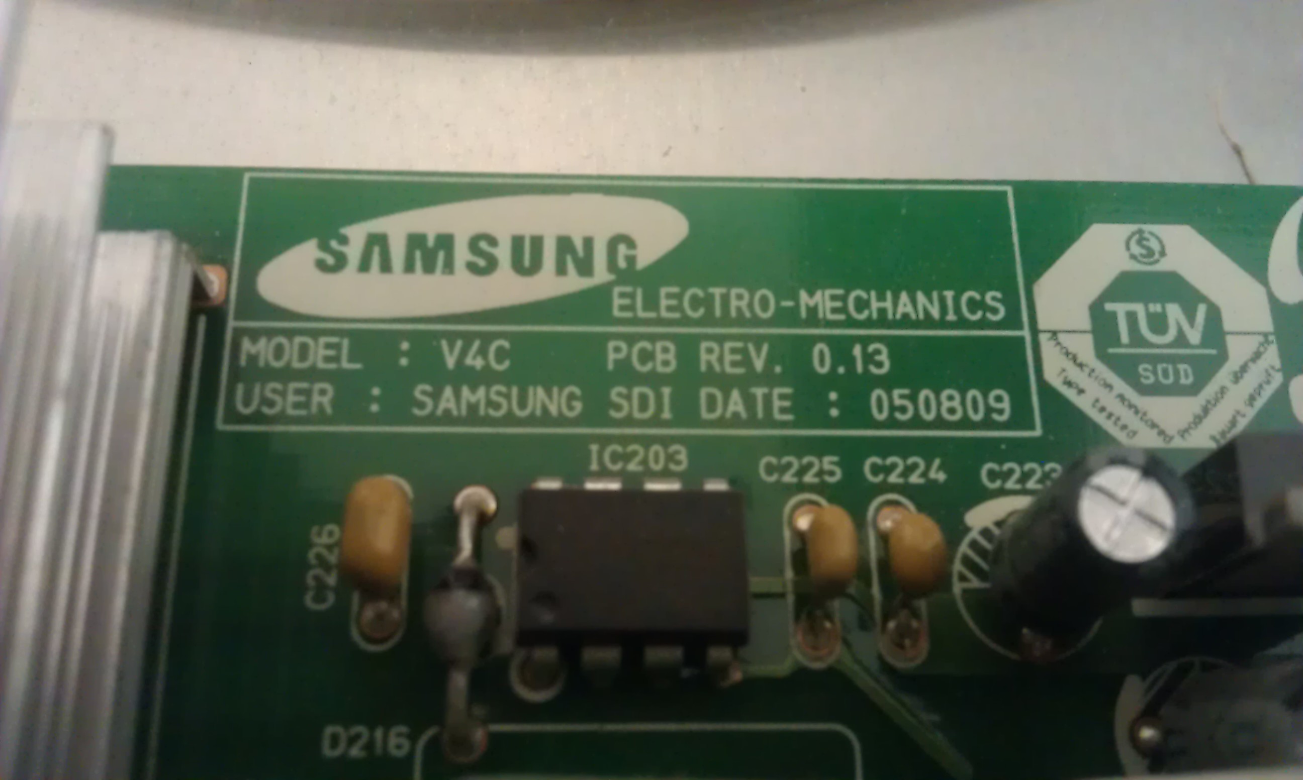

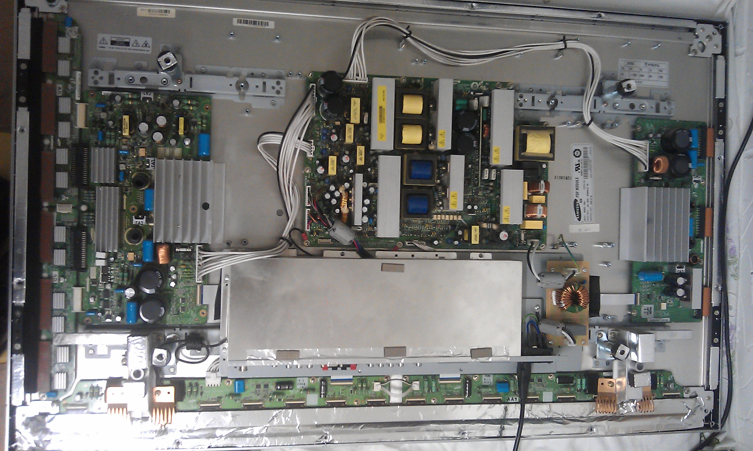

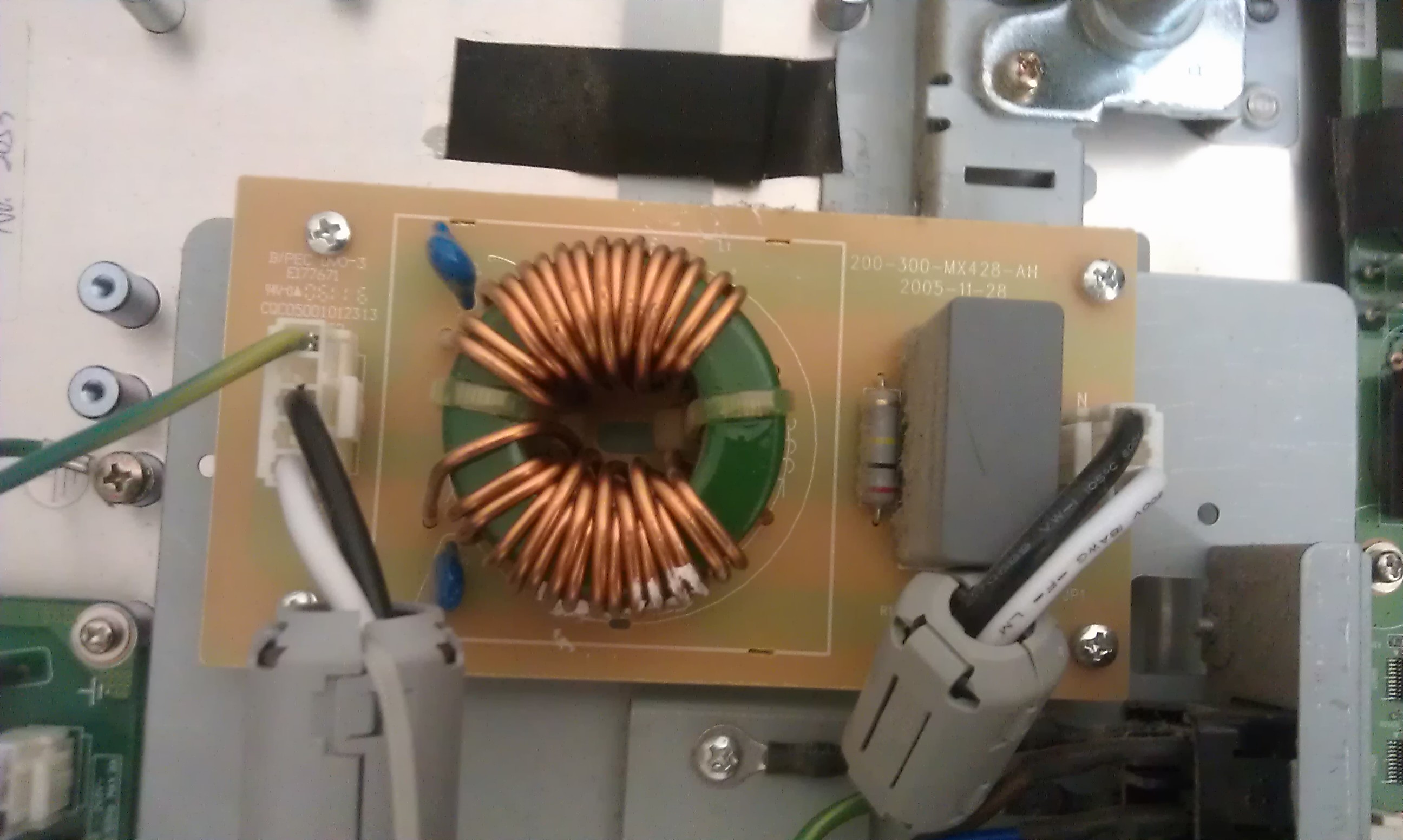

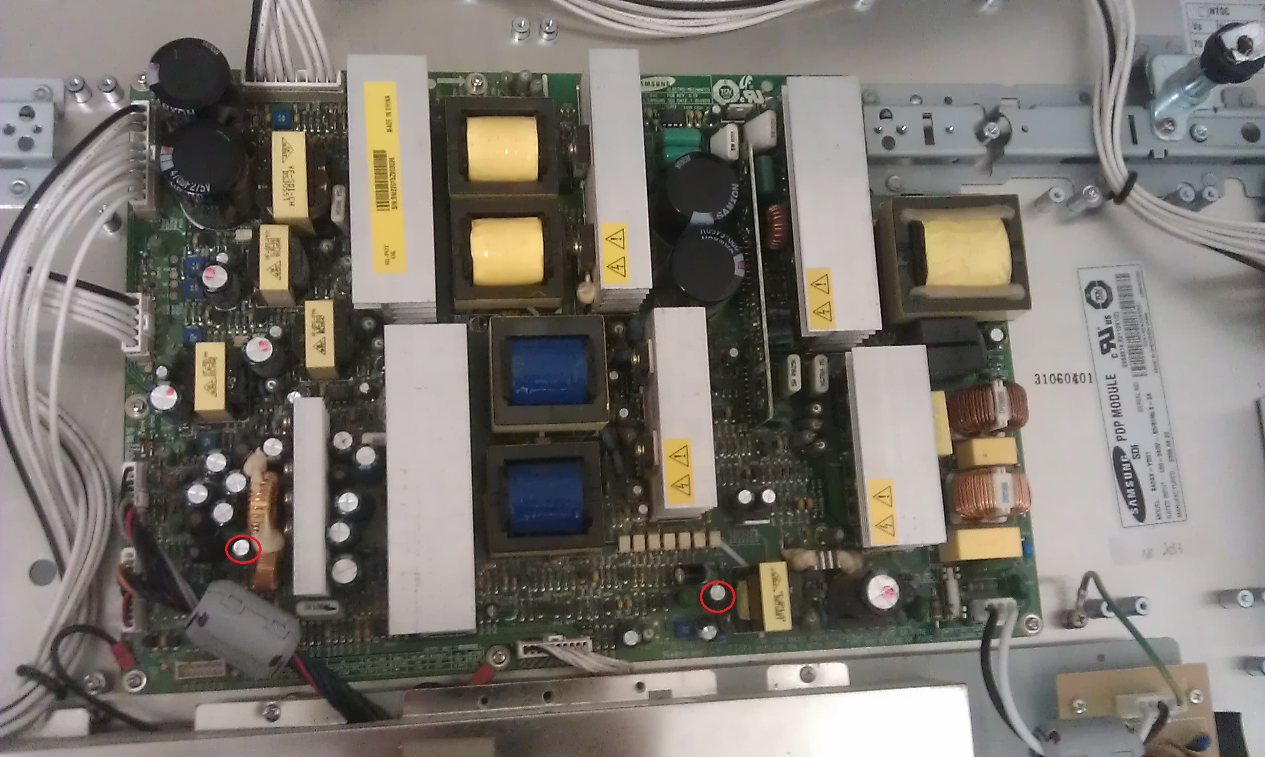

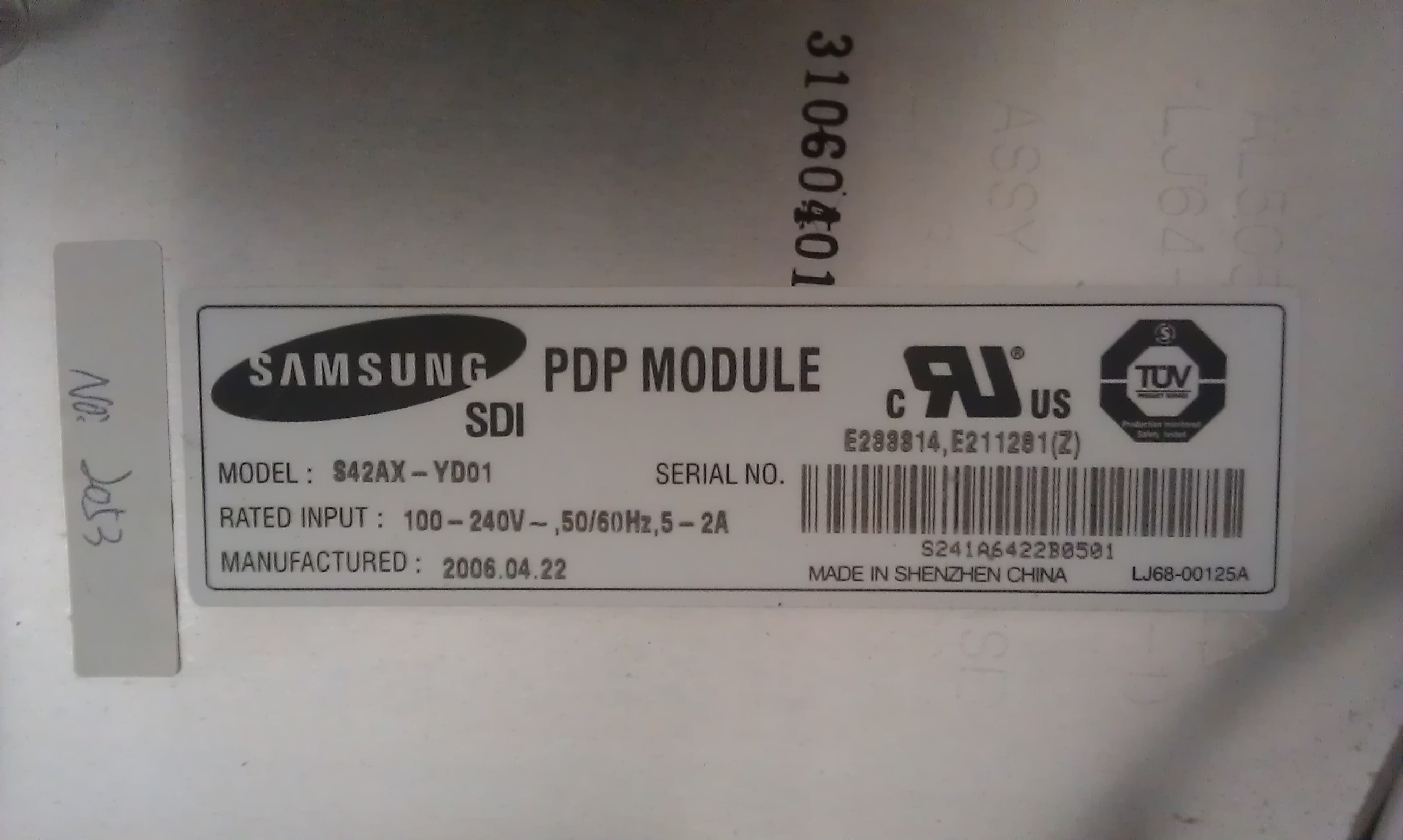

    I have a 42 inch Tevion TPDP42HP plasma and last week I went to turn it on and realised that it's not coming on at all. I checked the fuse and cable and all seemed okay so I decided to take the back off and take a closer look. I checked all the fuses and all were okay. I noticed 2 domed capacitors so I replaced them (circled in red) and tried to power on the TV but it's still not working. All the other capacitors look okay (no bulge/dome).
    I tried disconnecting the other boards one at a time but still no luck in getting the TV to turn on.
    I also tried to measure the voltage. Voltage going in the PSU is about 280V - 300V (is this normal?) I tried taking DC voltages by using the chassis as the ground but I'm getting 0V readings everywhere (tried all the connectors).

    Pictures of the separate boards are not really clear enough. can you try again probably need more light but no flash. I think I see another domed cap.
    You may need to do a bit more research before you continue, and before you kill yourself.
    Read this -it has a lot of tests most without power - any components you
    dont know look them up see what they look like

    Few simple rules:
    Test voltage with power on
    Test resistance (ohms with power off and unplugged
    To check components on the PRIMARY/HOT side use the negative leg of the BIG CAP as ground for the negative lead on your meter.
    To check components on the SECONDARY/COLD side use the chassis ground
