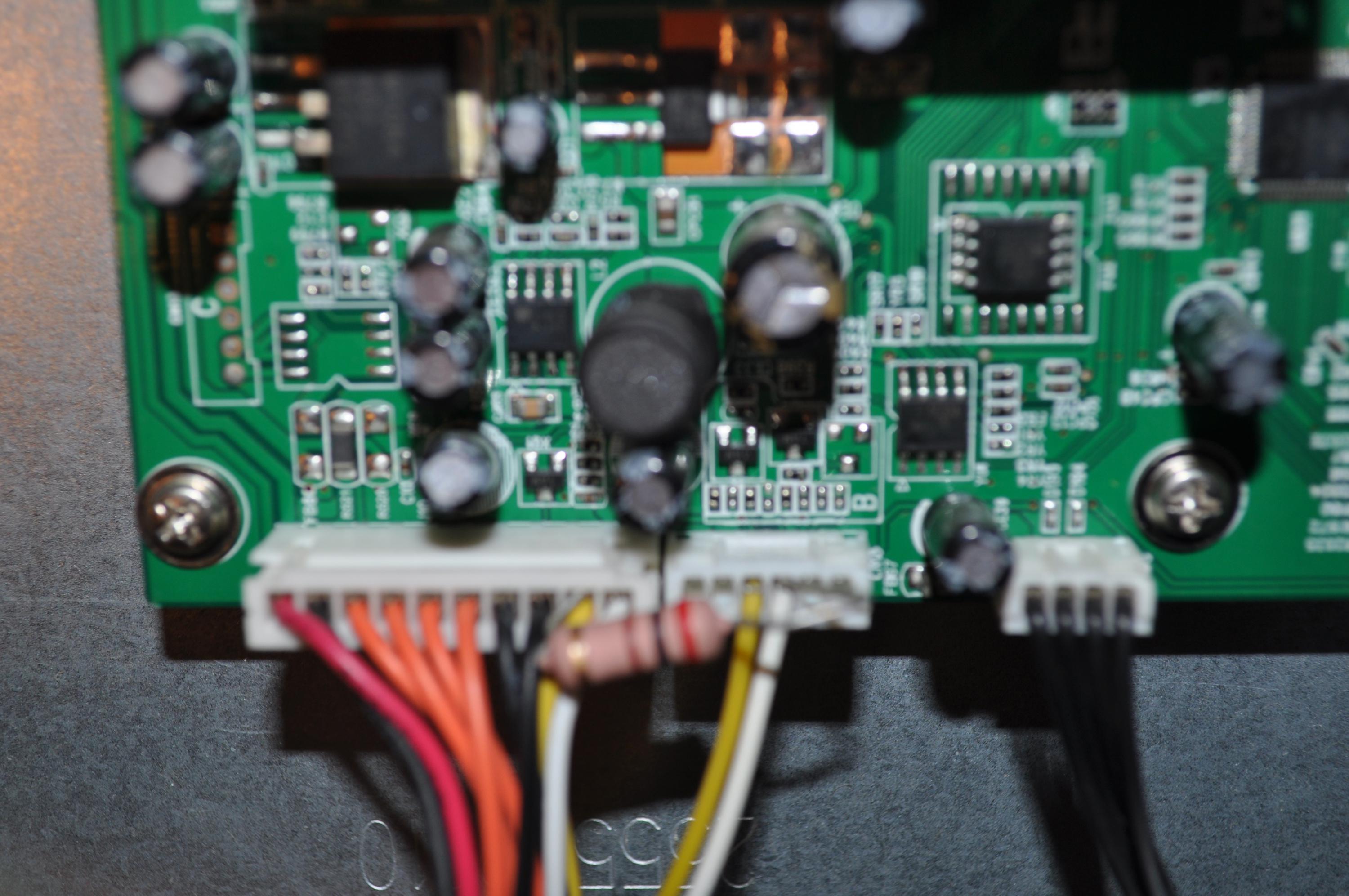

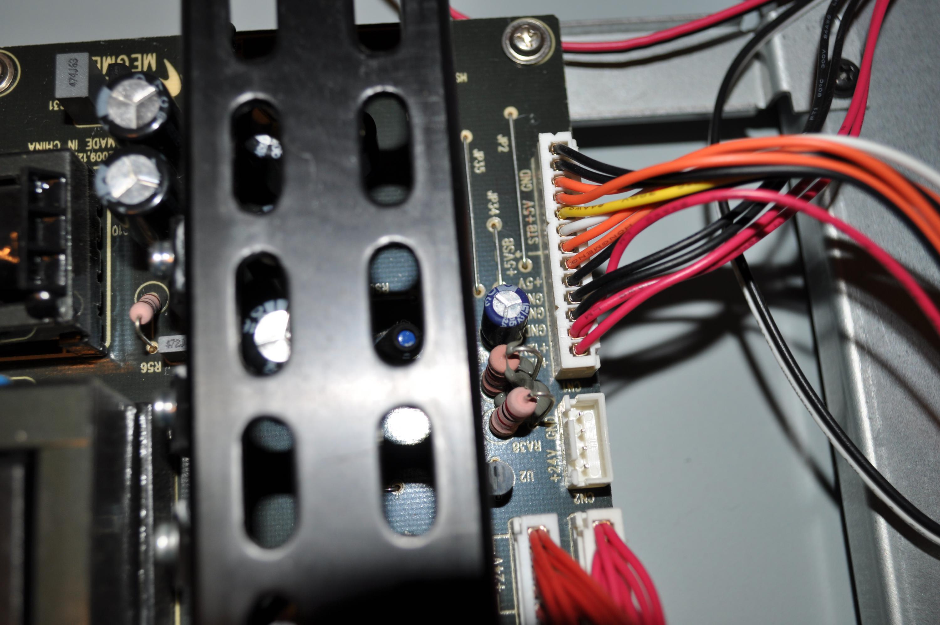

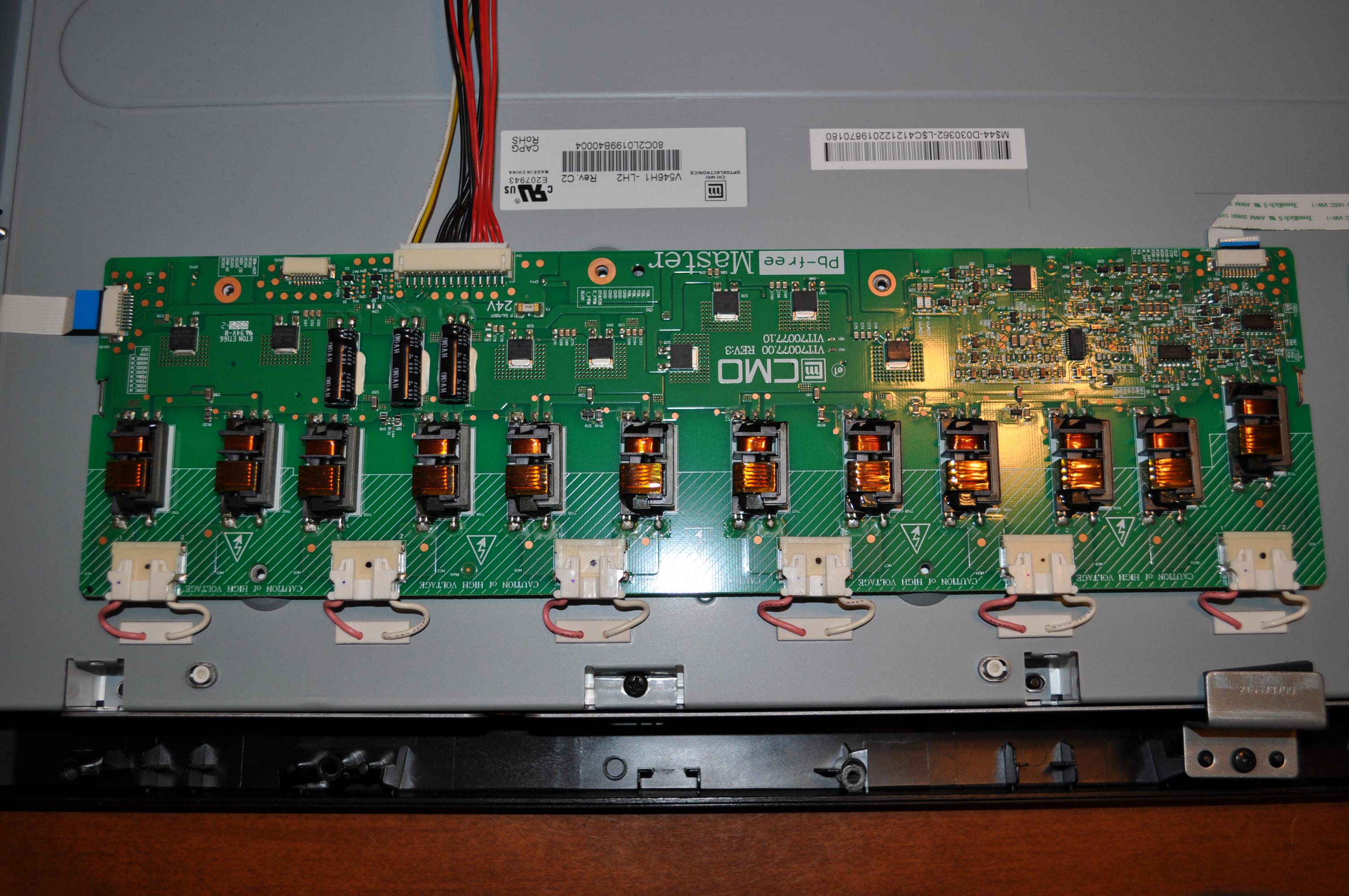

I picked up a 55" Element dead after a lightning strike. Strike also took out Cable Box. Basic troubleshooting shows that it has the 5vds and when I hit the power button (blue light blinks) I have all correct power on the power supply including the 24vdc feeding the 1 master and 3 slv inverter boards. The backlights will not come on though. I have looked at it with a flashlight and do not see an image on the panel. Ihave checked all the fuses on the Main, TCON and inverters all test 0.2 ohms

That means we know at least that the main board is not sending the BL_ON to the inverter board, so yeah, sounds like the main board is not working.Never stop learning
